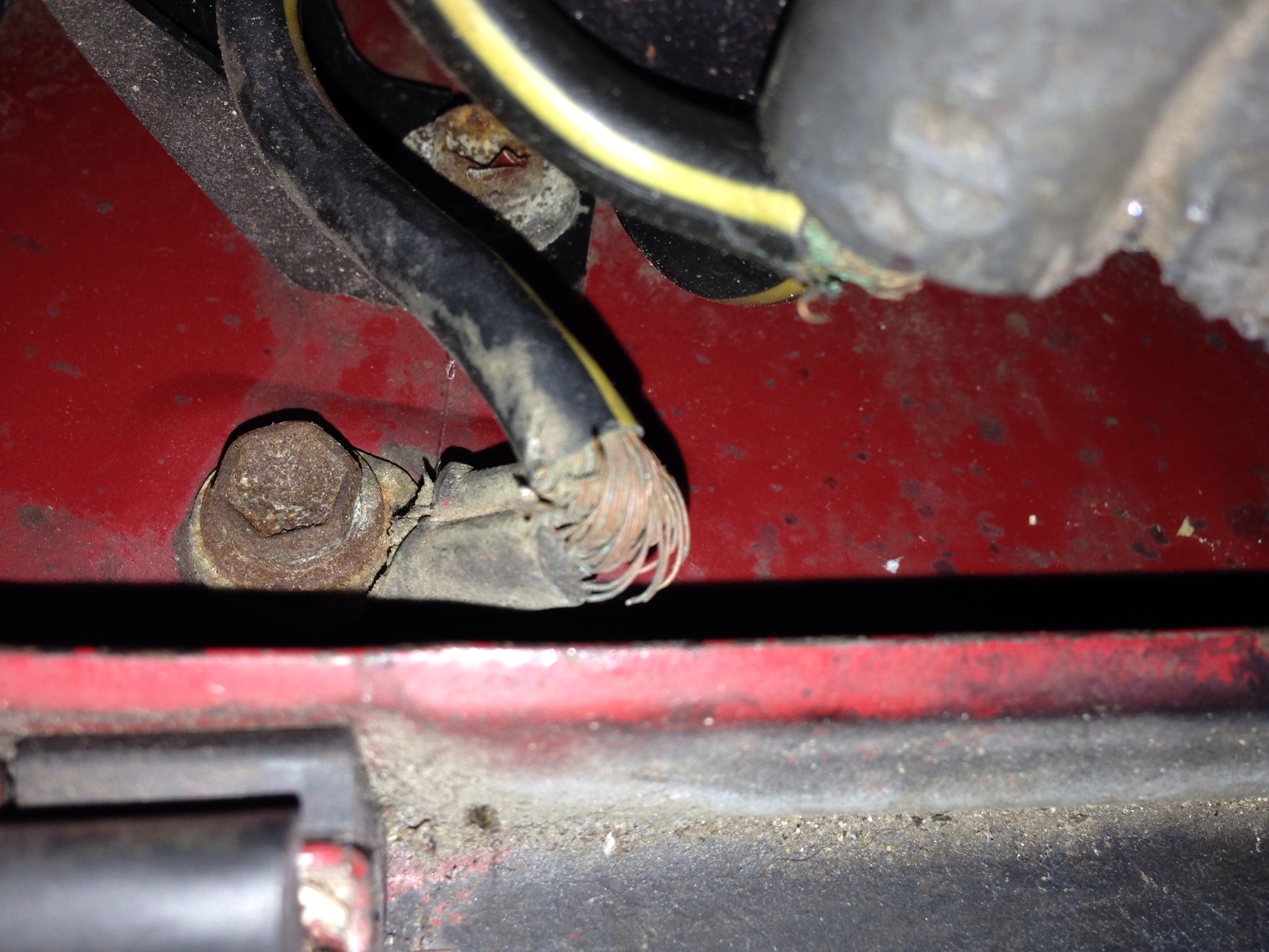

I was running into issues with timing. When I went out to try to start it again today, all I would get is a loud click, whenever I'd try to start it. Any ideas as to what would cause that would be much appreciated. And yes the battery is fully charged.

I had the same issue with the click and no start on my 4runner. It happened when I still had the 22re in it, I thought it was the starter solenoid, took it apart and checked and cleaned the contacts, ended up getting a new starter, that worked for awhile, but then it started doing it again. Then I did the 302 swap after awhile I started having that problem again, figured out that it was voltage drop I was only getting about 10 volts down to the starter so I installed the "Hot Shot Starter Relay" kit by Painless Wiring (it was around $35 at Autozone) and haven't had a problem with it since. RAD4Runner has a good right up on his build thread, I think he solved the problem with the factory starter relay without having to buy the Hot Shot relay, here's a link to his write up, https://www.yotatech.com/forums/f199...00/index2.html hope it helps you out, good luck!

Thanks for the input. I'm gonna try to relocate the starter solenoid. I think it's shorting on the header. There's about an 1/8 inch gap between them. And also I don't think it's grounded well. That could be the whole cause of the problem.
