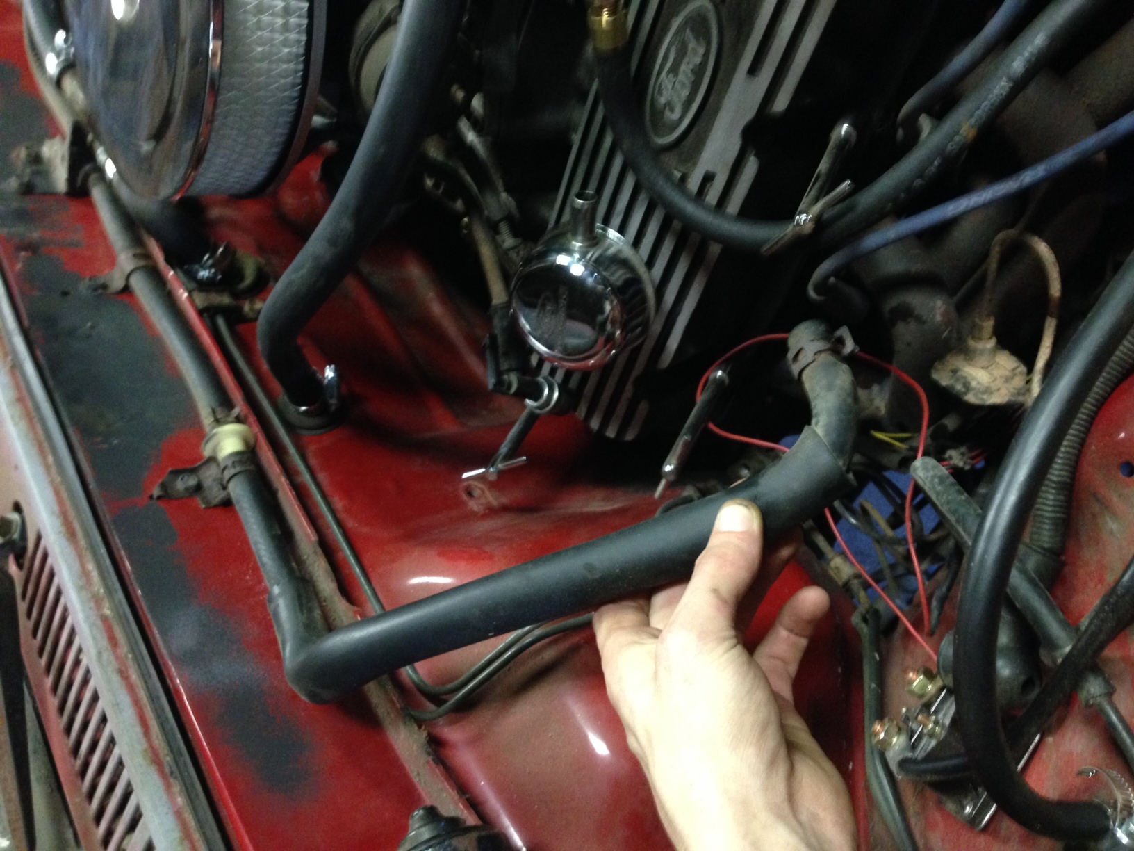

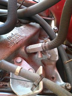

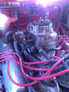

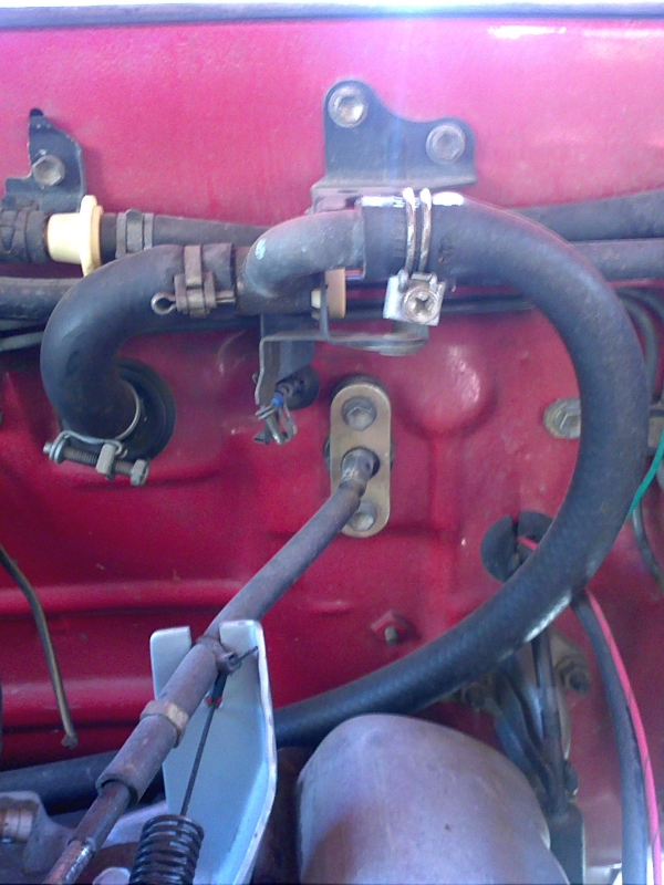

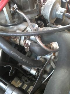

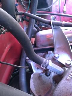

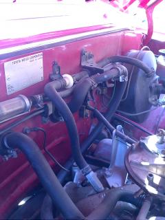

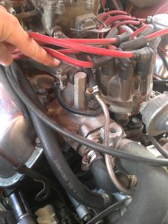

Nice work! On your lower radiator hose did you connect the 2 different size hoses with a metal sleave? If so, that's the same thing I did, I just used a shorter hose so it doesnt hang down as low.
On my motor, on the water pump, the one tube coming off the intake thermostat housing next to the main radiator hose is connected with a small rubber hose (elbow) to the closest inlet on your water pump. The other 2 are connected to your heater. I took some pics on my cellphone of how mine is connected, I'm just having a hard time importing them to my computer. If I don't get them up before going to work , I'll get them posted when I get home.
**EDIT** OK, here's some pics...

ΔΔΔ On these 2 pics you can see where the heater hose runs from the intake manifold up to the firewall, and I believe to the heater core. I don't know if you have this 90° fitting coming out of you intake? Or maybe it has a plug in it?

ΔΔΔ And on these 2 you can see where this hose goes on the driver side.

ΔΔΔ here's the short little elbow going from the water pump to the intake. Hope this helps you out some!

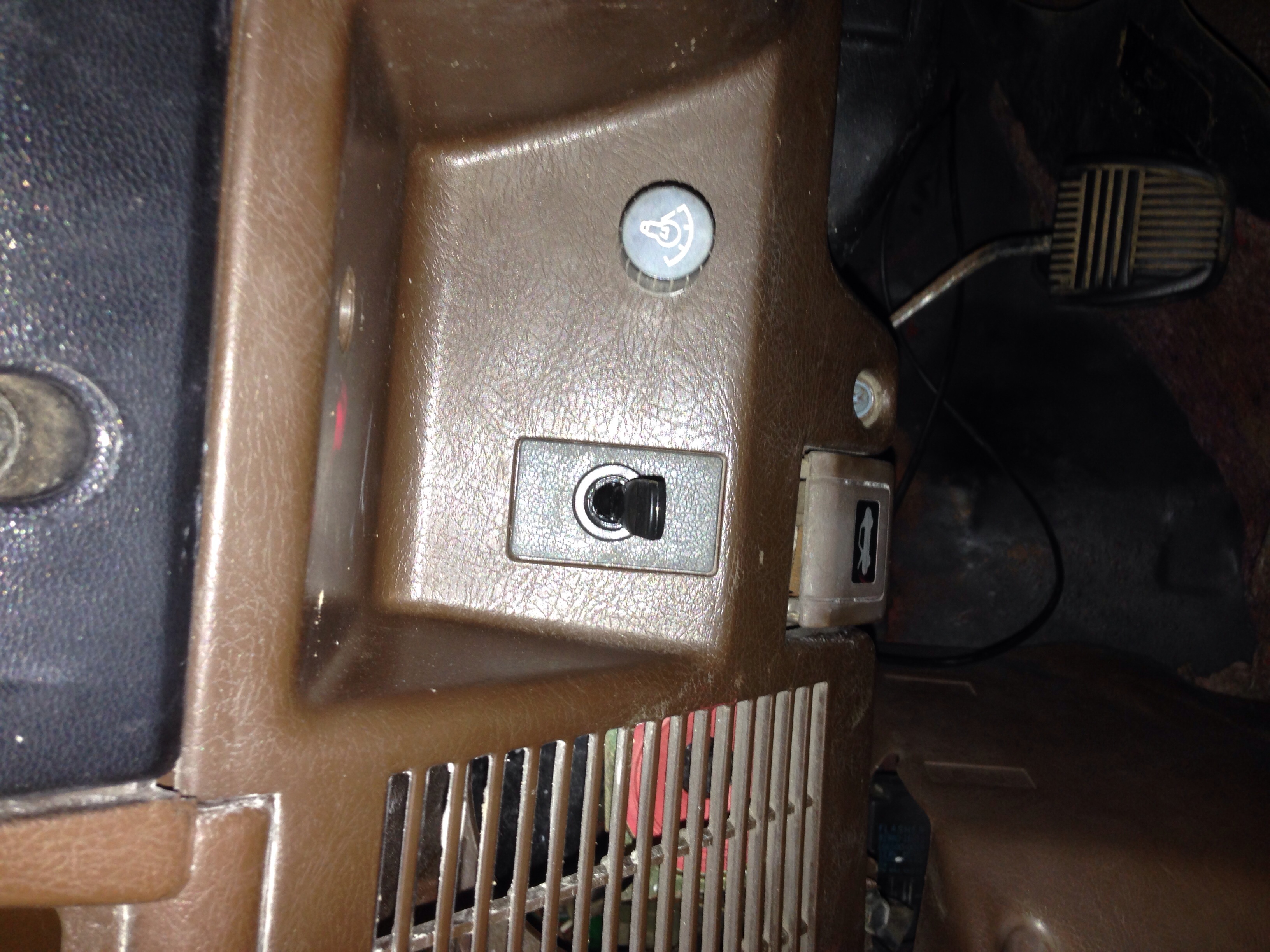

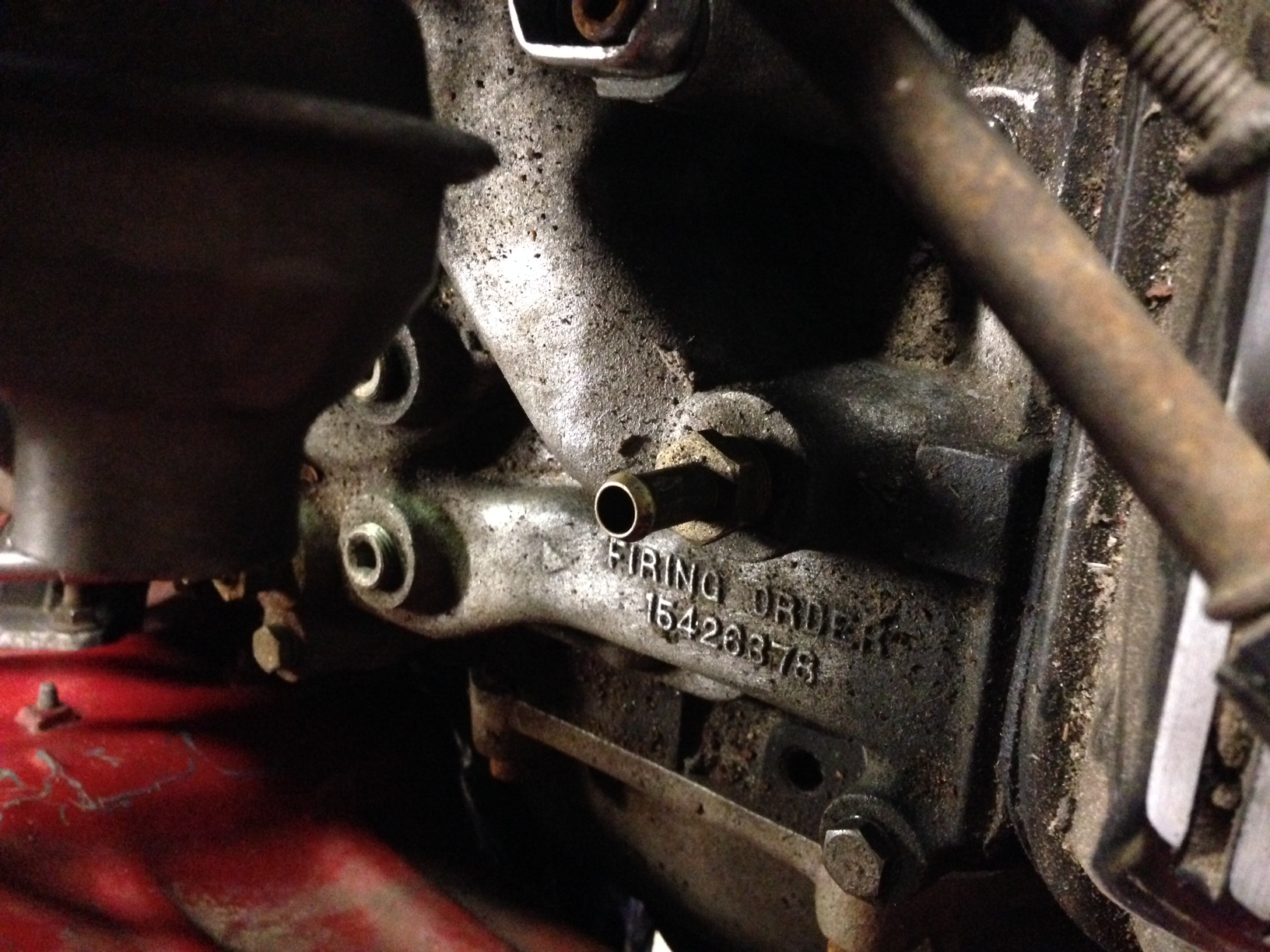

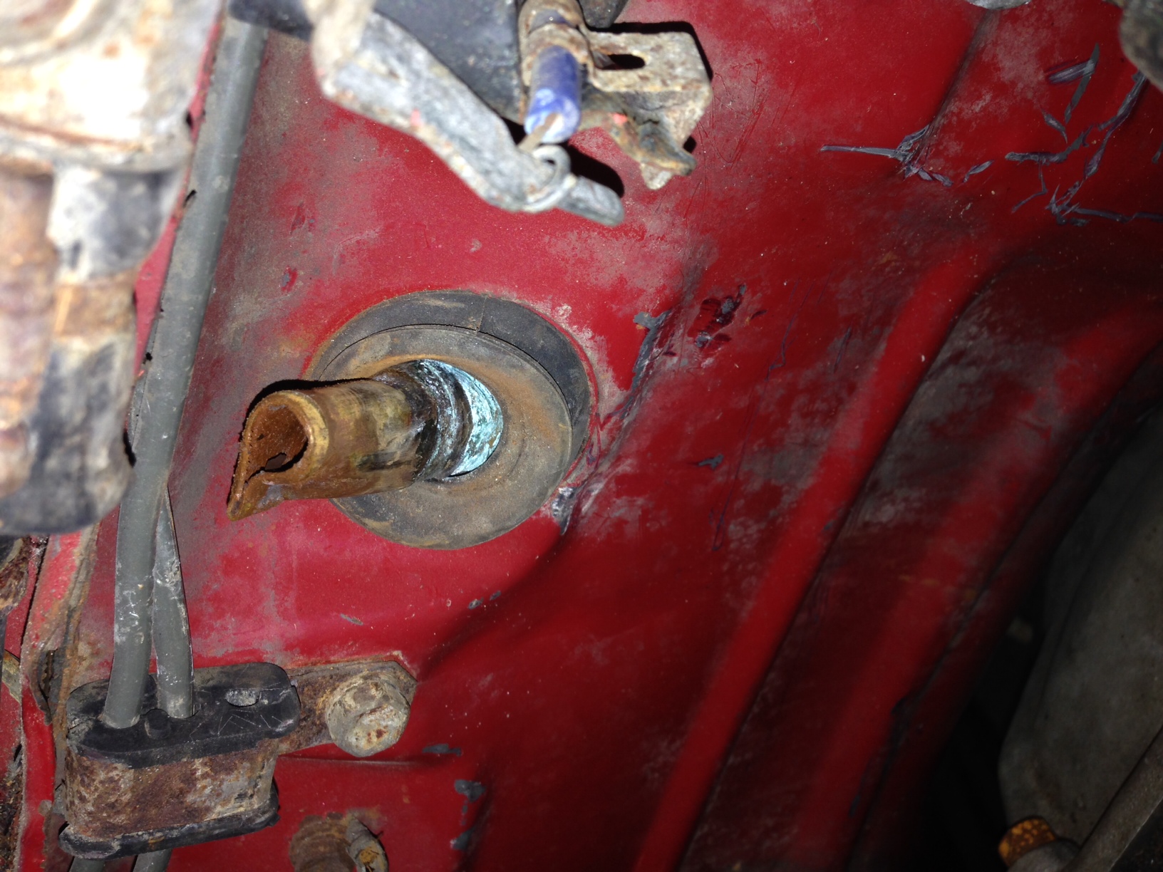

Finished the heater hose! Now I need a fan or two... Oh also, what does this go to? It comes out of the top center of the fire wall. If you are looking into the engine compartment, it is to the right (or drivers side) of the other heater hose that plugs into the intake manifold. I don't know if it needs to be plugged or what.
Thanks!

Good info on the required fan cfm. Earlier this week I ordered a 24"x16.5"x3" aluminum radiator, aluminum shroud, and 14" electric fan that puts out 2800 cfm. I ordered id through CFR Performance. Hopefully this will solve my cooling issues!
That inlet on the firewall goes to your water pump, shown in one of the pics I posted earlier above, I think my fat finger was blocking the image so you couldn't see it very good, lol. Here's another pic.

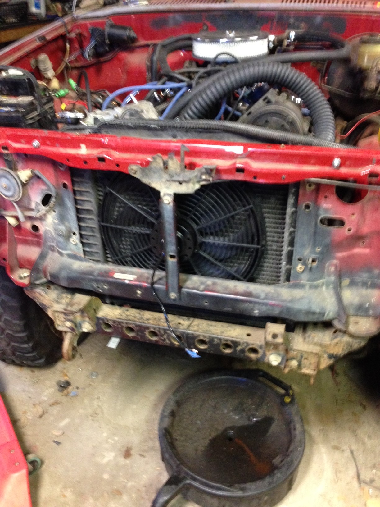

I made some progress yesterday. The radiator fan came in early and I installed it. I had to test it to make sure it was going to push air through the radiator and not pull it. I had to take it apart and flip the fan. It was a bear to put in. I ended up having to take the radiator out (which was full of fluid) to get the fan in. It took way to long for such a simple job. All that's left is to wire it up. I'm going to run it directly off of the battery and run a switch into the cab. There is a hole in the dash where a switch would be on a loaded out pickup (if that makes sense). I am going to measure the hole and get a switch that will fit in there nice. Here's a picture of it installed:

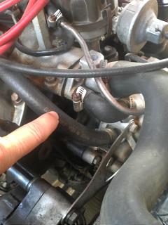

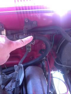

I appologize for all the where does this hose go questions, but where does this hose go lol? I looked at my other Pickup and this hose goes into the intake. Would this be the hole?
Hose:
https://www.yotatech.com/attachment....5&d=1400356561
Hole:
https://www.yotatech.com/attachment....4&d=1400356537
All I know is that whenever I pump the brakes, brake fluid leaks out of the end of the hose. I don't want to connect it to the wrong thing and ruin the motor.
Thanks!

Nice work on mounting the radiator, looks good! If I can make one suggestion, I used a electric fan control relay that came with a probe that you mount through the fins of your radiator, when the probe reaches the preset temperature (I think mine is 190*) it automatically turns the electric fans on, when I park my 4runner and shut it off, the fans will continue to run until it drops below 190* and then automatically shuts off. The relay also has a wire that you can connect to a toggle switch to manually turn the fans on and off. I would suggest using something like this just to eliminate any accidental overheating issues, I've ran electric fans before with just a toggle switch, and it's easy to forget to turn them on. The relay kit was like $30, you can probably get them at your local parts store, or Summit Racing or Jegs would have them: http://www.summitracing.com/parts/hda-3647/overview/
On the brake booster vacuum hose, you are correct, it mounts to the back of your intake manifold, that's the same way mine is hooked up.
