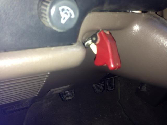

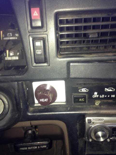

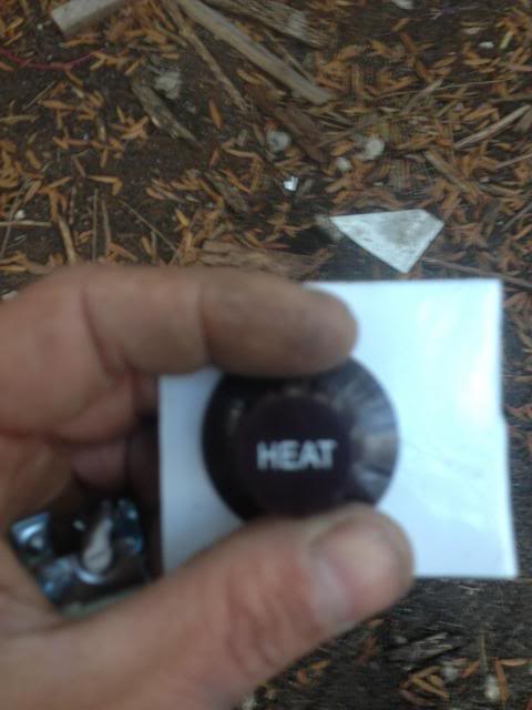

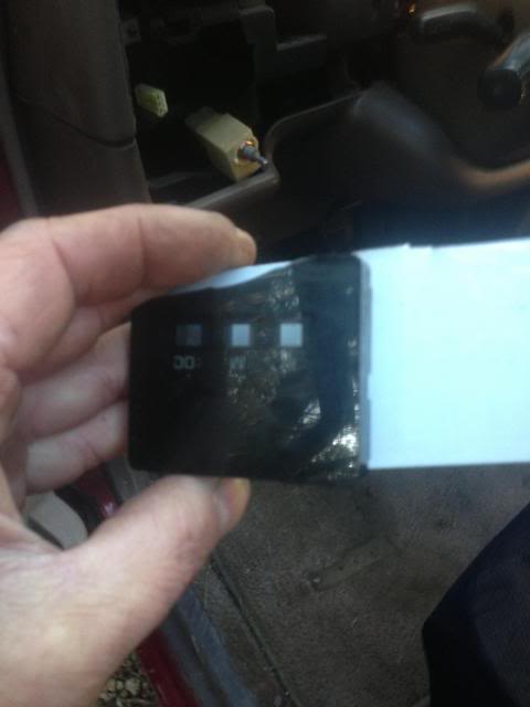

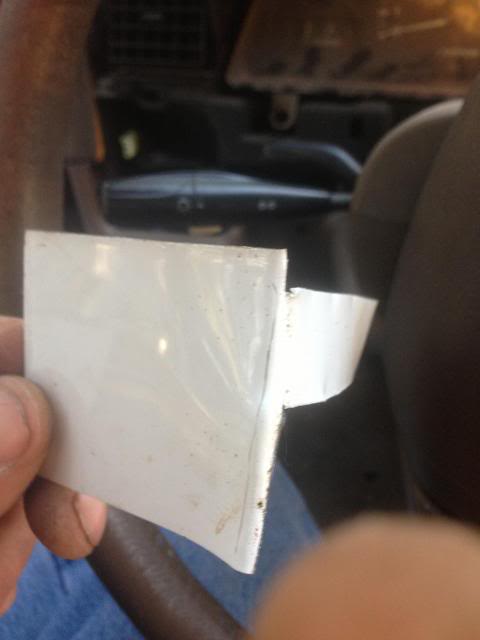

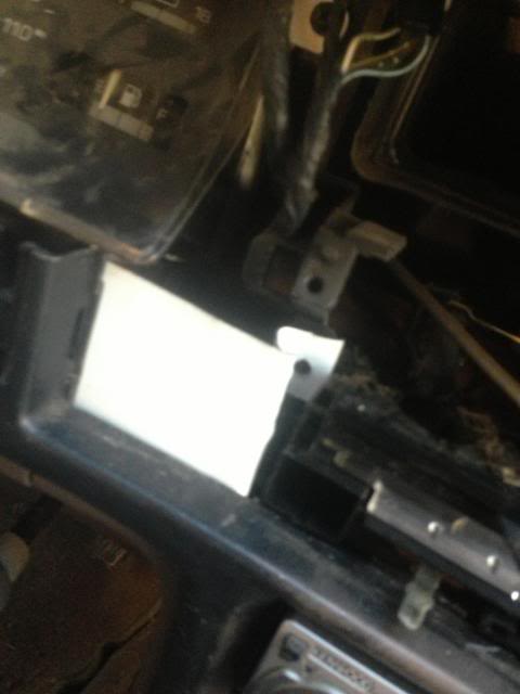

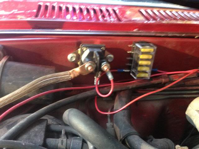

So I wired in the new fan switch. I ended up also putting in a solenoid switch, and secondary fuse block powered by it. I powered the solenoid and fuse block from an internal cab switch until I know if the variable speed switch can handle the load. Here are the pics. I removed the non working clock and put it there. Here are the pics, think its all pretty self explanatory.

Now I have 3 speeds but that little son of a b gets hot HOT hot on anything but high. I'll have to rig up a switch to the AC clutch once winter leaves. No big deal.
I also threw in a thermostat. Was no big deal till I had to play hide and go seek for the last bolt that flew out of it in the rocks and sticks. Looks like some one JB welded the intake cover for the thermostat so I blue RTV'd it and am letting it set up real good before I run it to hope for no leaks. There was no thermostat in the truck.

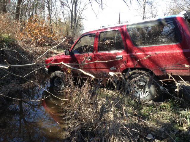

Um....Oops. Thank god for 4x4 tractors. Darn Blackland gumbo mud.

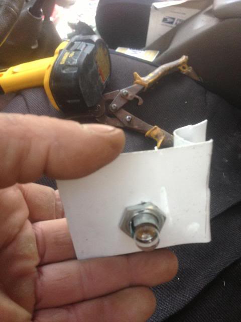

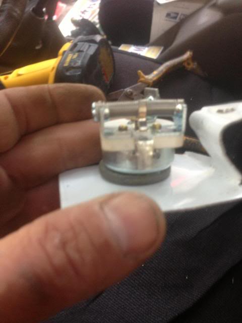

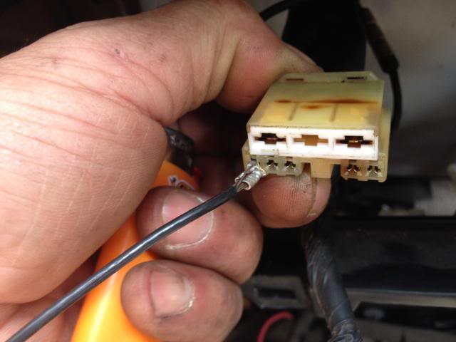

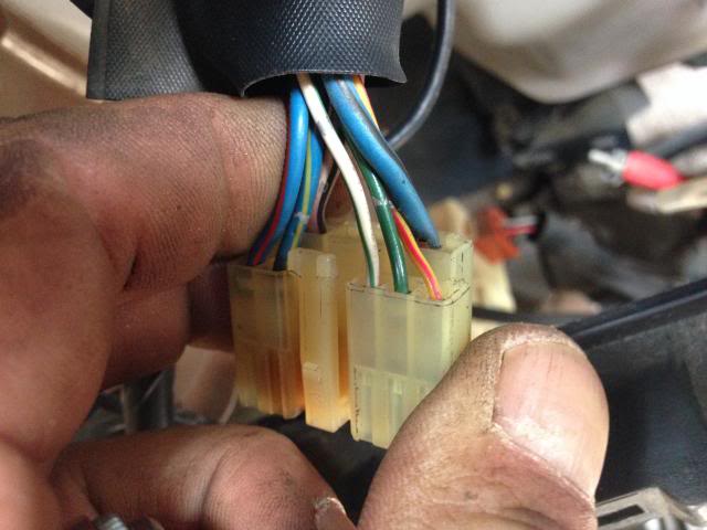

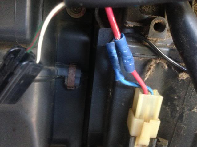

To make the AC compressor work again this is what I did...
The yellow and red wire that is in the switch block for the old main blower switch that is yellow and red is a ground which actuates a solenoid that will heat up the old AC switch which I intended to keep.
See the yellow and red wire all the way to the rt.
I stuck a blade into it and ran a wire to a switch then to ground...
And the AC works again while getting rid of the old POS factory blower motor switch which has burnt out on me 4 times now in 2 different rigs.
