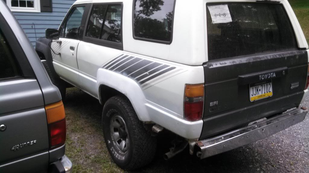

Heres some pics of her

next to the girlfriends 95

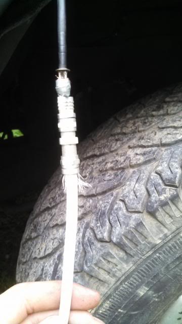

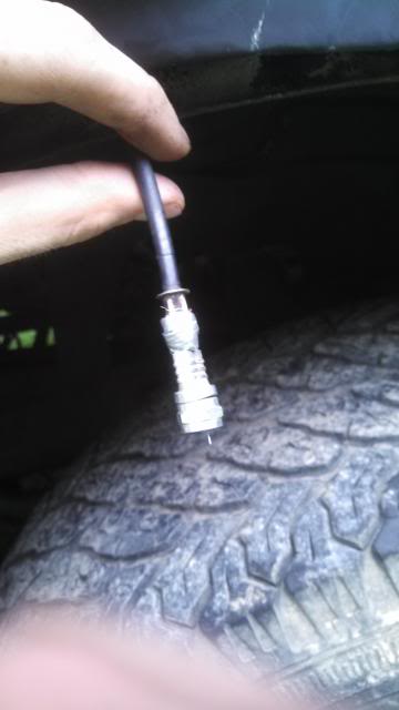

But i got an antenna wired up to the radio today(that was interesting haha). Driving around without it working was starting to driveme crazy. Someone just snipped the antenna wire while replacing the front fender with a new one
and of course it was too short so i had to rig this up with some extra co-ax cable

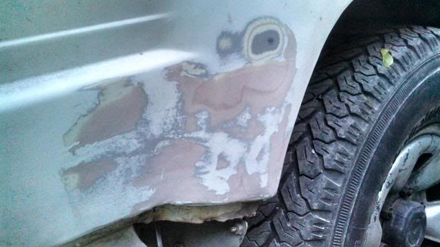

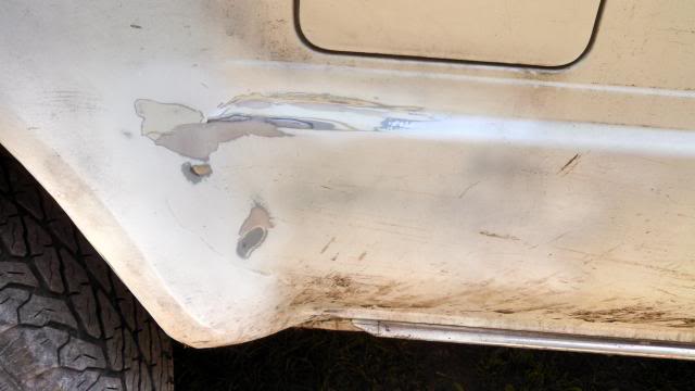

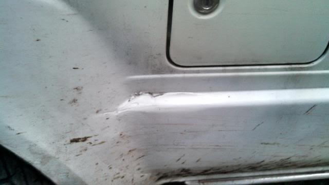

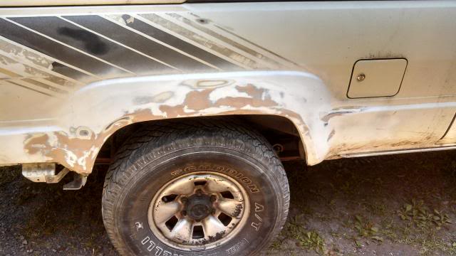

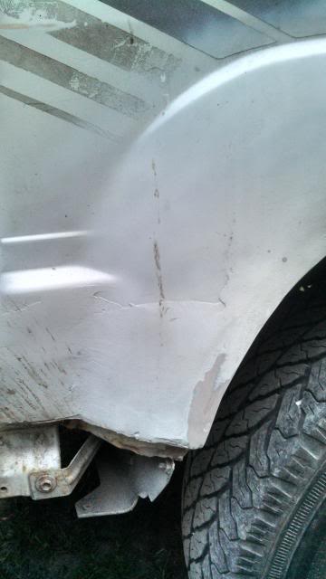

Ok so tonight after work I decided to tackle some of the PO's bodywork that he did to the rear fender above the wheel well. It appears that the sheet metal had some ripples or minor dents on both sides, not rust through (I checked it out from the backside before I started to see what I was getting into haha). I plan too start painting hopefully this weekend if the weather cooperates. It will be getting bedliner on the bottom half so it doesnt have to be perfect.
The PO had just slapped some Bondo on the sides and sanded lightly then sprayed it, here's what it looked like originally:

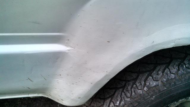

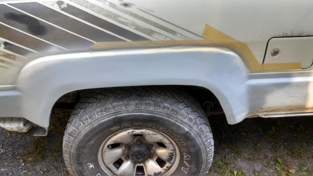

And after I started sanding all that crap off:
And here's where I stopped for the night, just put some primer on it for now

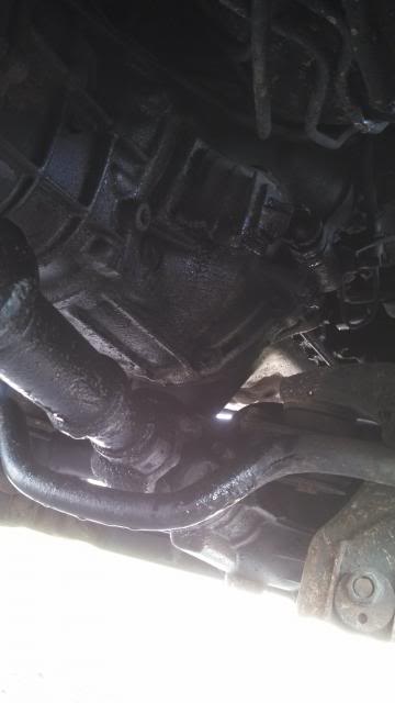

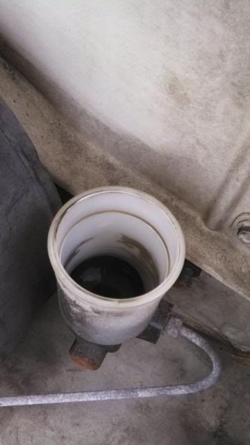

As of right now the runner is sitting in my driveway with a shot save cylinder. I noticed on my drive home that the clutch felt sloppy all of a sudden and getting stuck behind a school bus surely didnt help the matter. It finally gave out about 5 miles from home, so I crawled home in first gear and pissed alot of people off hahaha. But I did just order an OEM slave cylinder from Low Range Offroad for $36.83 shipped, pretty tickled about that!
Wasn't quite sure what was going on until I looked underneath and saw all this
And then checked the reservoir

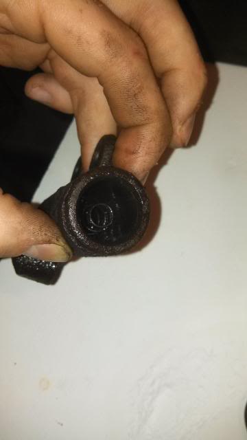

And a pic of the SC on the work bench, I had to use channel locks to get the hardline off because someone previously stripped the nut

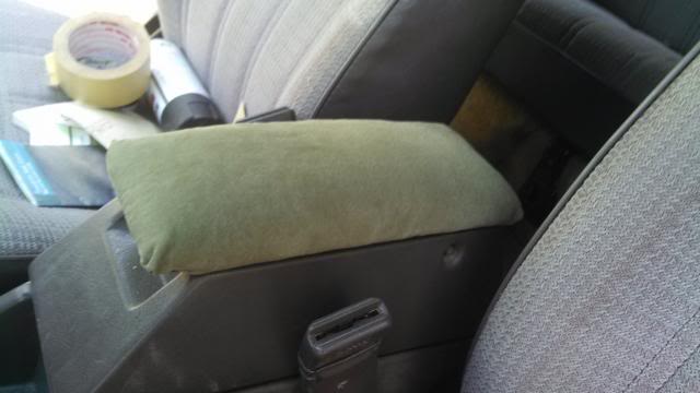

While the runner is down I thought I'd take time to fix and clean up some things that I've been wanting to do but haven't had the time for. So last night I recovered the center console armrest that was all torn up and crumbling.
Picture of what it used to look like
I tore all of the old nasty padding off and put some new padding down, then covered it with some old military tent canvas (have literally hundreds of old military pup tents laying around)
It turned pretty good I think and is alot more comfortable than that old crumbly padding

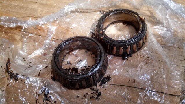

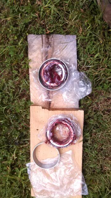

I got the chance yesterday to finally put my front wheel bearings in. Went pretty smooth and only took about an hour per side. I went with OEM Koyo bearings, bought the kit from Marlin Crawler and they were actually pretty cheap I think considering the kit consisted of the bearings, races, seals, and new gaskets. Can finally drive above 50 with out being scared my bearing is going to grenade haha. The passenger side bearings were really bad (were completely covered in filings and all chewed up).
New bearings all greased up and getting ready to go in

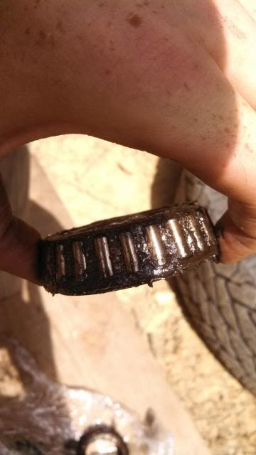

The old chewed up bearing
Note all the filings between the rollers
