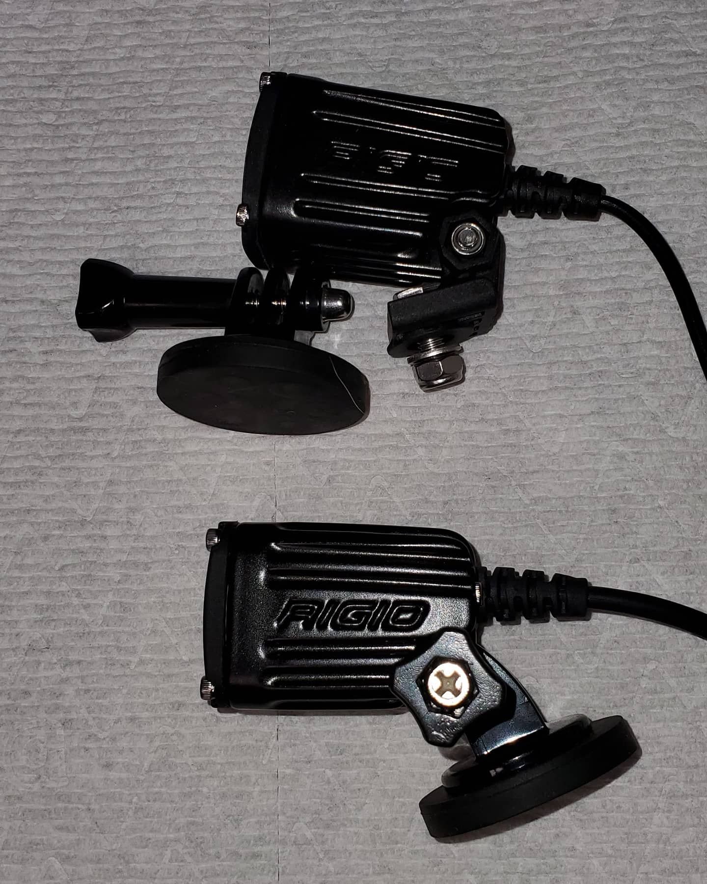

So in my never-ending search for lighting led me to find Rigid Ignites.
found out they use a go pro style mount.
Ordered a set of magnetic mounts.
Instant camp lights
when I get the truck back from Northwest Toys I'll put them to use

Ooh, nice idea with those magnetic mounts. Directionally useful even if the wiring is on the short side, so many options if it isn't.

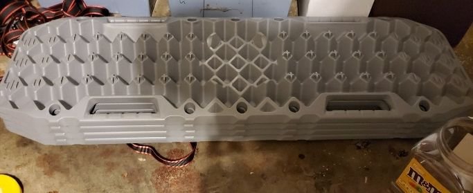

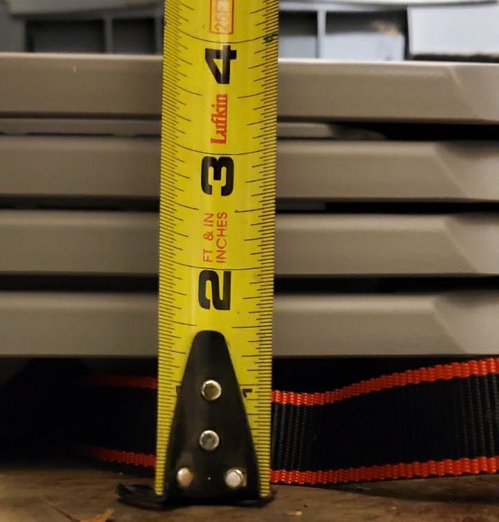

I would have like a set of maxtrax due to their reputation but at $300 a pair I decided to see if I could find a set that didn't stack a foot high.
I found a set of bunker industries ramps that 4 of them stack right around 4" hight

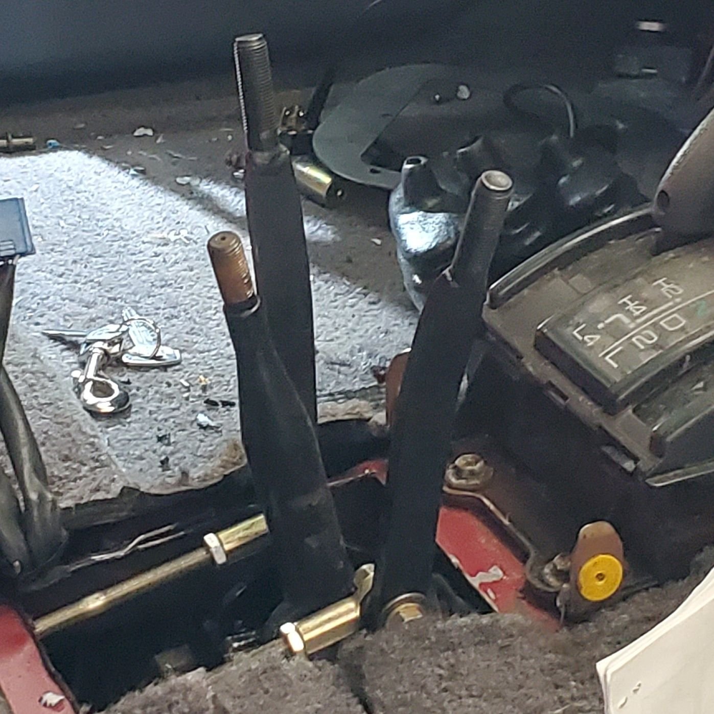

triple sticks.. I was worried these would end up s lot further back and I would lose my center console..nope..

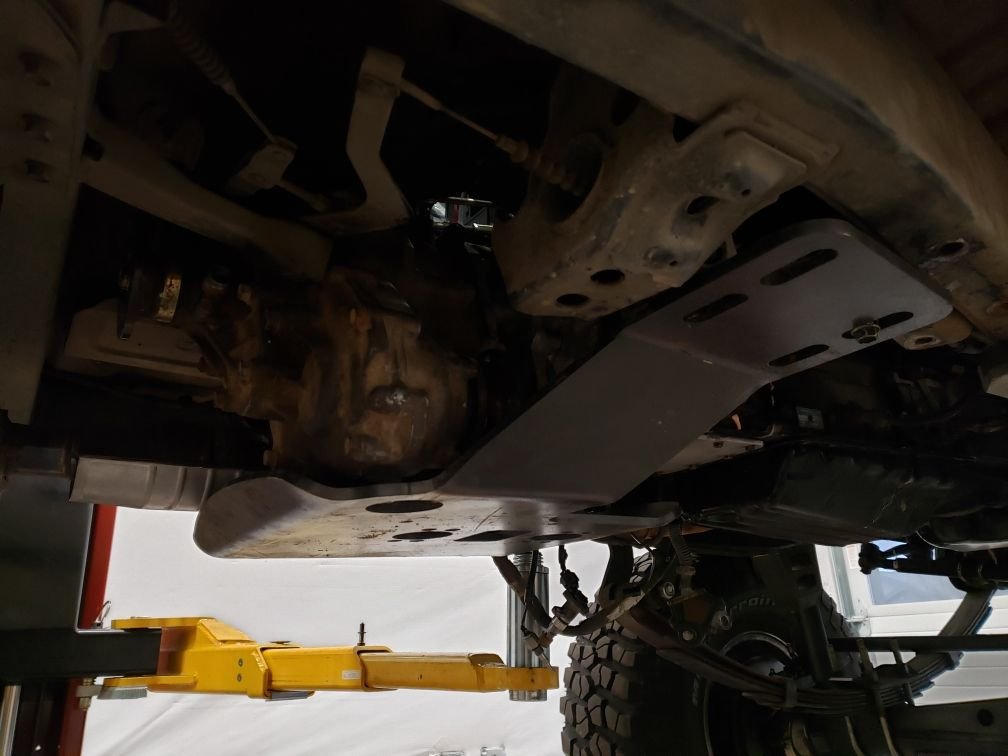

Well she is getting closer. Don sent pics of the old Trekker sliders mounted on the 4runner.
nice thing about having sliders is some of the non door opening individuals in the parking structure will think twice now about not giving a crap if their door hits the 4runner..
they are beat after protecting the Trekker for 10 years of running PNW trails
