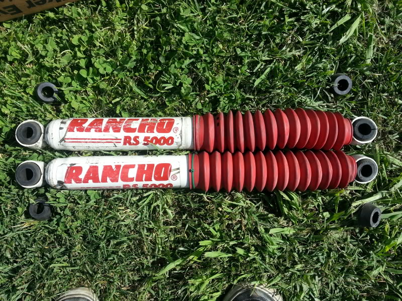

BTW i seen you noted that your shocks are gone. I have my old Rancho RS5000 rear shocks. I dont have any use for them. I bought them for $20 at a junkyard in perfect condition. If you'd like to have them they're yours for free. After all they are used. I'm not sure how far into central CA you live but if you want to pick them up i'd be fine with that or ship on your dime. up to you.
I was also planning on keeping my old set of black 15x7 aluminum rims and 31/10.5/r15 Lemans tires for my older brother for when he buys his 4runner. But i'm starting to wonder if he'll ever go that route. And i have too many sets of tires and rims sitting in my back yard. I have 3 sets of 33" tires. 5BFG M/ts that are on my truck and 2 in the back yard. and i have a set of 5 33" Sport King tires that i plan to use for street driving. and then my set of 5 31" lemans tires.
If you're interested in the tires let me know. the tires are still in pretty decent shape the rims are still black and may need to get repainted but they are all balanced already. I was thinking about selling the set for $150 or 200. Let me know if you're interested man.

Thanks man, the tires and wheels may be a really good interim solution for me; I'll think that over. It's my front end where my shocks are gone and I think I'm probably going to go ahead and rebuild it all at the same time since things are looking and feeling pretty hairy up there, my rear shocks and leafs still feel OK for now until I figure out what I'm going to do as far as ride height goes. I'm up in the air about that part since I want to be able to do stuff like that Tierra del Sol but this truck is more about GETTING to places like that and riding bikes, quads and gator type OHVs via trailers.
I have to figure out where that balance is for wheeling the runner vs using it to take dirt bikes places etc. Tires and rims would definitely help though. I was just going to look at some TRDs that some guy had for sale but didn't get there in time (and honestly wasn't sure about lug style etc since they are late model). I also don't know how big I can go with no lift and just a bit of sag in the back so far. Depending on how much work the motor needs, it shouldn't take long to get the suspension lined out though, I have most of the budget for the parts and will just need to learn how to do it all.
I can't wait to get going on some of these fixes I've been reading about. With any luck, weekend after next I'll get some time to start going through some electrical and mechanical checks to see how things stand on that front. These 16+ hour days are gettin in the way of progress!
