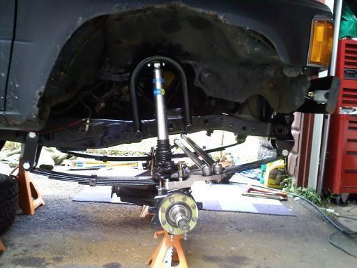

The rear is currently 2 inch stock length springs with two mini-leaves removed from the front marlin 4" pack, and also added a cut down third leaf from the stock rear pack. sits with the rear a little lower than the front, and I am sure the front will settle more, so it should work out perfect. I used 6 inch eye to eye shackles to get my pinion rolled up some (for the rear cv shaft) and to level it.
The front is kind of a mixed bag. FROR hangar, which seemed to have the least drop off any non-custom ones. 5" eye to eye Marlin shackles. Marlin's hi-steer. Marlin 4" springs with the bottom two leaves removed. The shackle tubes I placed 50mm up from the bottom of the frame, and 50 mm back from the inside of the front part of the body mount. The hangar is mounted flush. 10 inch bilstein's (I am happy with these) mounted to Marlin's hoops.

Now, time for

For the front, since I didn't really want to run wheel spacers, and to be honest, I am not sure that they are legal in Jersey, so I went with IFS hubs. To do this you need:
IFS hubs
SFA manual hubs
rotors from late 80's Landcruiser
IFS calipers
IFS pads
wheel bearings are the same for SFAA and IFS, so no worries there
You have to re-drill the rotor to the 6 bolt pattern that bolts it to the back of your IFS hub, just the way your old rotor did.
You have to mount the calipers on the outer side of the ears on the knuckle, instead of the inside. I drilled out both the ears on the knuckle and the caliper, and used a 9/16 - 18 thru bolt with red loctite and a lock washer. This also requiresa grinding a little extra clearance on the inside of the caliper, because the rotor will not be 100% centered in the caliper. I also had to grind a slight bit off the ouside of the caliper to clear my stock toyota aluminum rim. Stopping power is the same as stock setup, feels great.

For the front, I rebuilt the knuckles, used a backing plate eliminator, and felt rock ring protectors. I got all new hardware, studs, nuts, cones, etc, from Marlin. I highly recomend this to anyone rebuilding an axle.
I still have to do bumpstops in the front, and lift the back a hair, but its getting there

and now it's level
I used the downey 2" stock length springs, took out the overload, put in the 3rd leaf from my stock packs cut down, then the two small leaves I pulled from the new marlin front pack.
