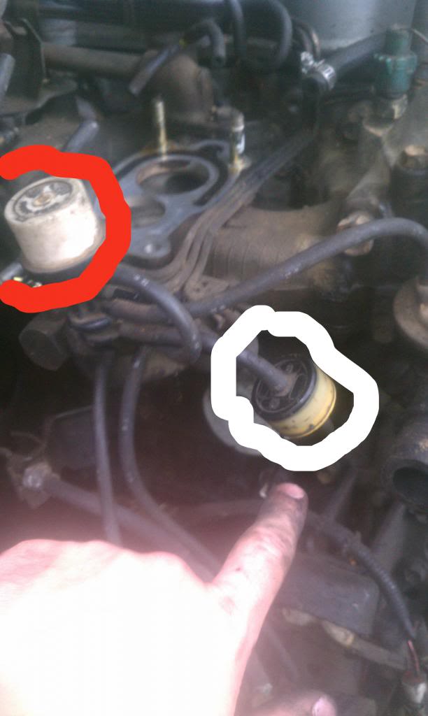

I'm def gonna check it out Mark. Wanna check everything out if possible haha. Can you clarify for me, the dashpot is the white circle correct? What is the red circle?

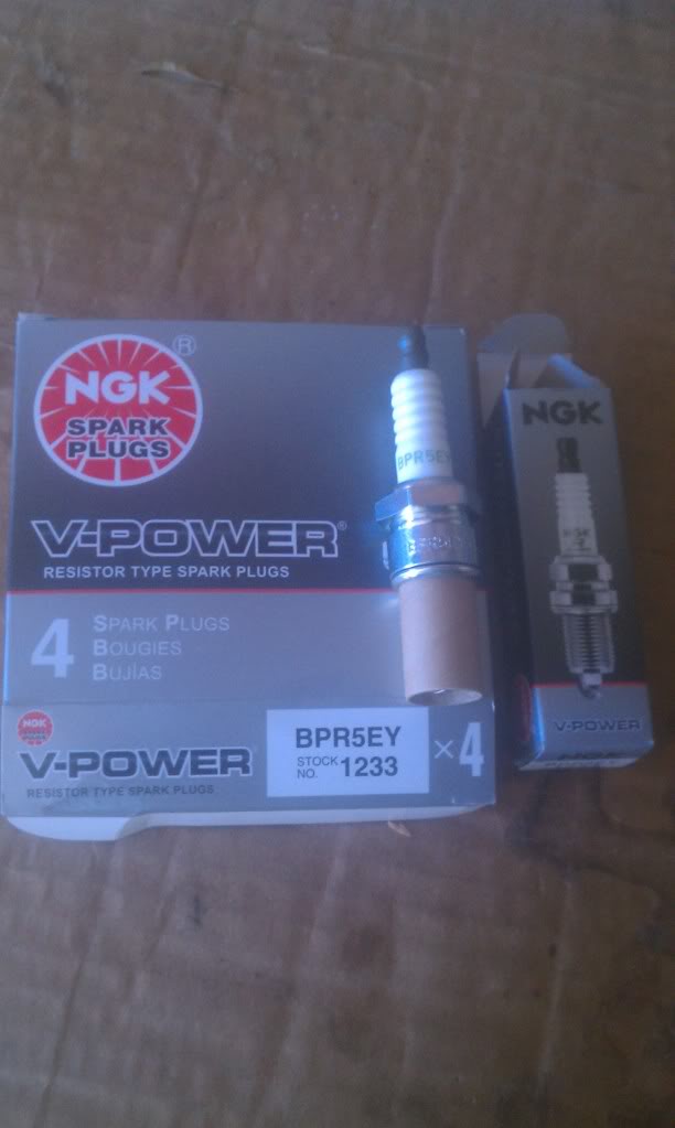

Okay so uh parts galore came the other day! Woohoo!
I'm gonna try to keep everything the same on this ole girl, because she runs so good now besides the timing chain chatter. So same spark plugs except there new

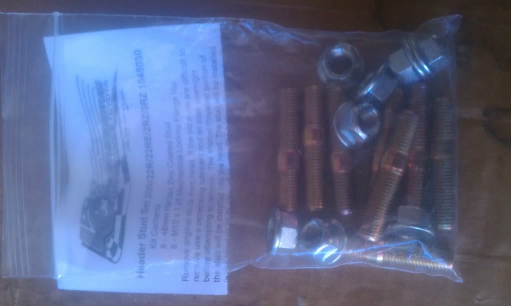

LCE header stud kit. I got this because I eventually plan to run headers and a 2 1/4 inch exhaust back and I feel this will help the next time I remove the header a little easier

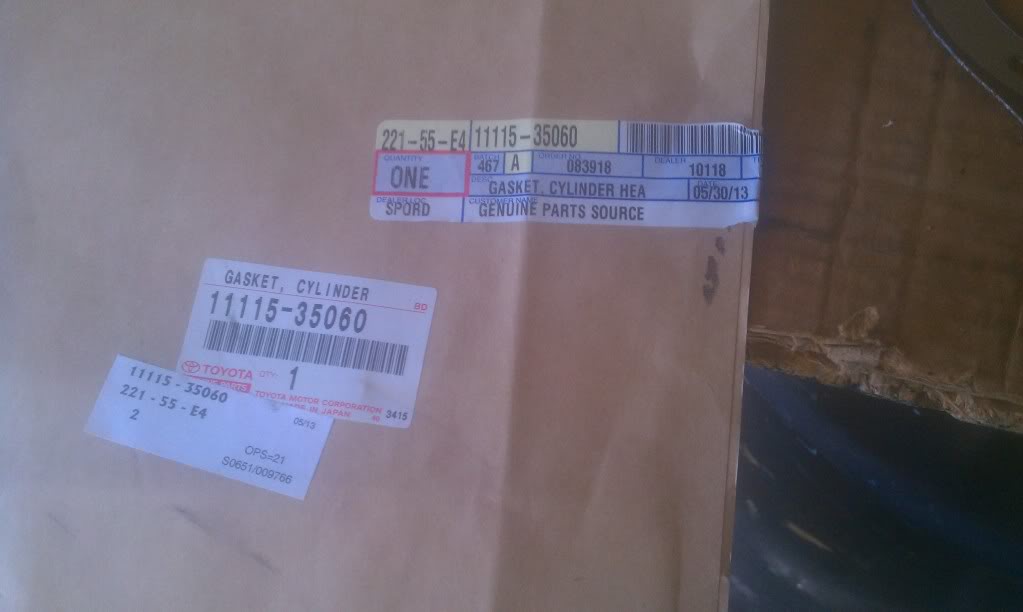

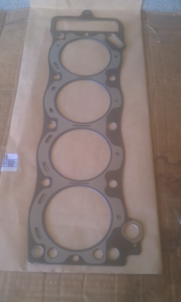

Oh that's a nice OEM Toyota Head gasket ya got there!

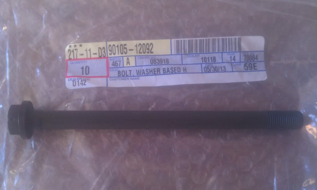

I got ten of these beautys...(head bolts) Some say to re-use, I felt better getting new ones!

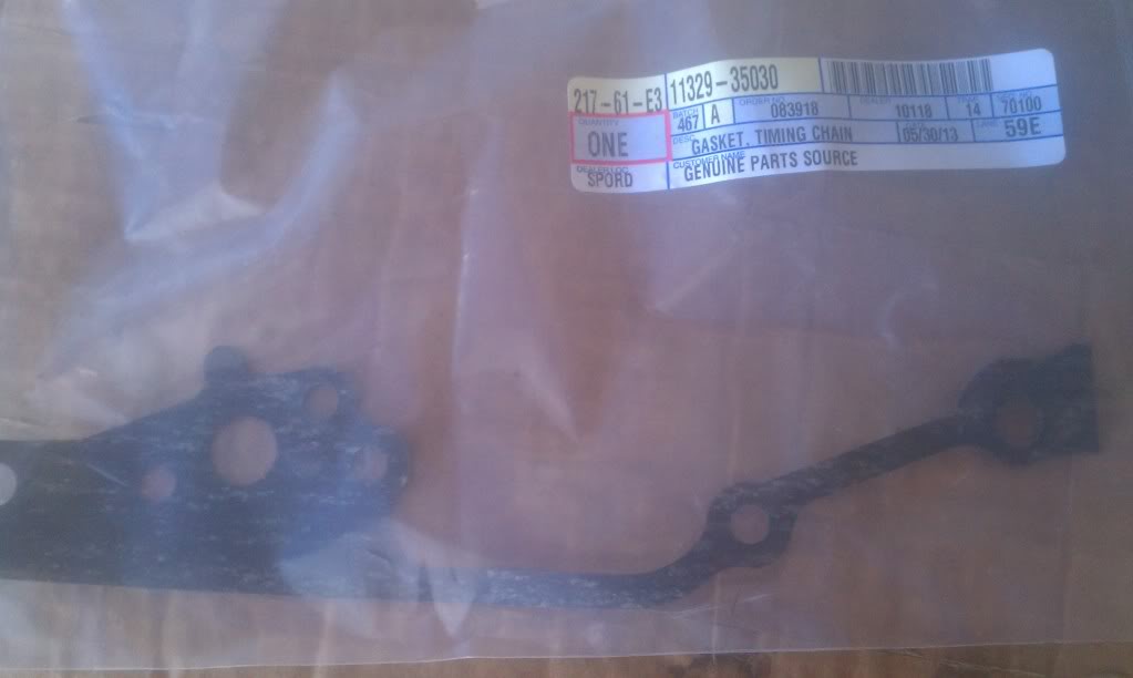

One of the timing cover gaskets

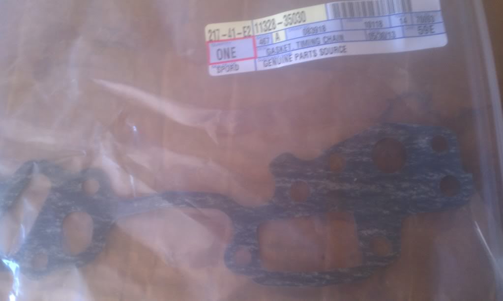

The other one

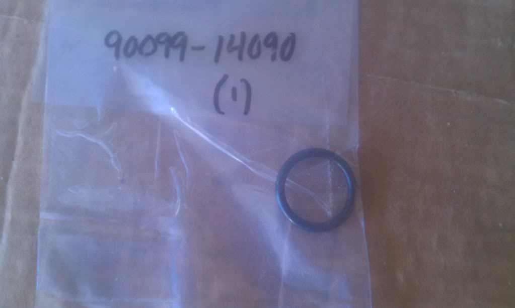

Distributor O ring

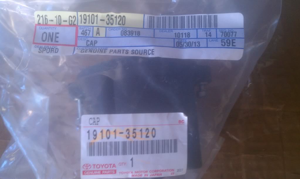

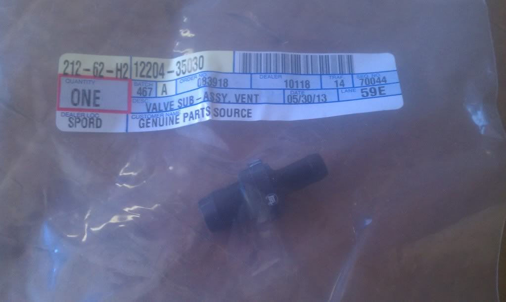

PCV Valve, because I broke mine:/

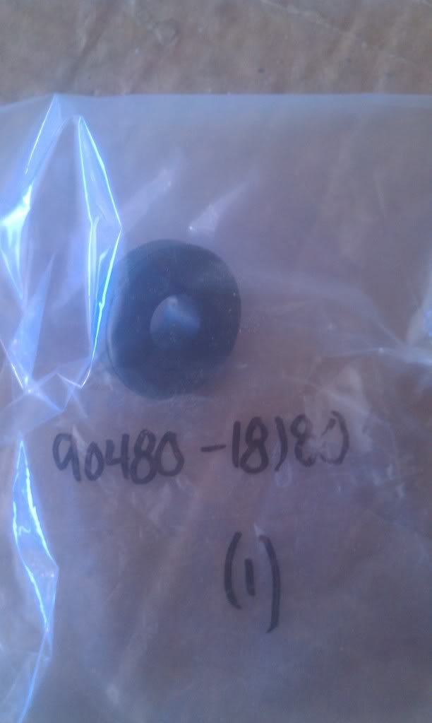

PCV grommet, because I most likely will break the old one getting it off...It's really on there!

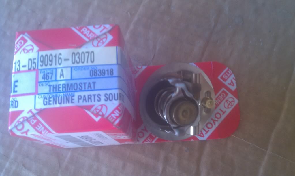

Dual stage t-stat everyone likes

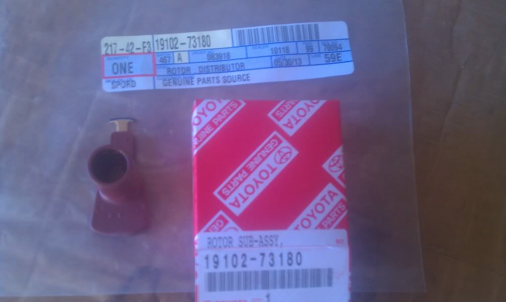

The dizzy rotor...cheap part, good to replace

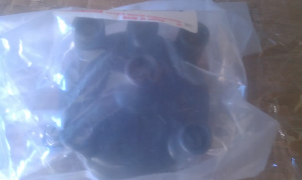

The dizzy cap, good to replace and cheap

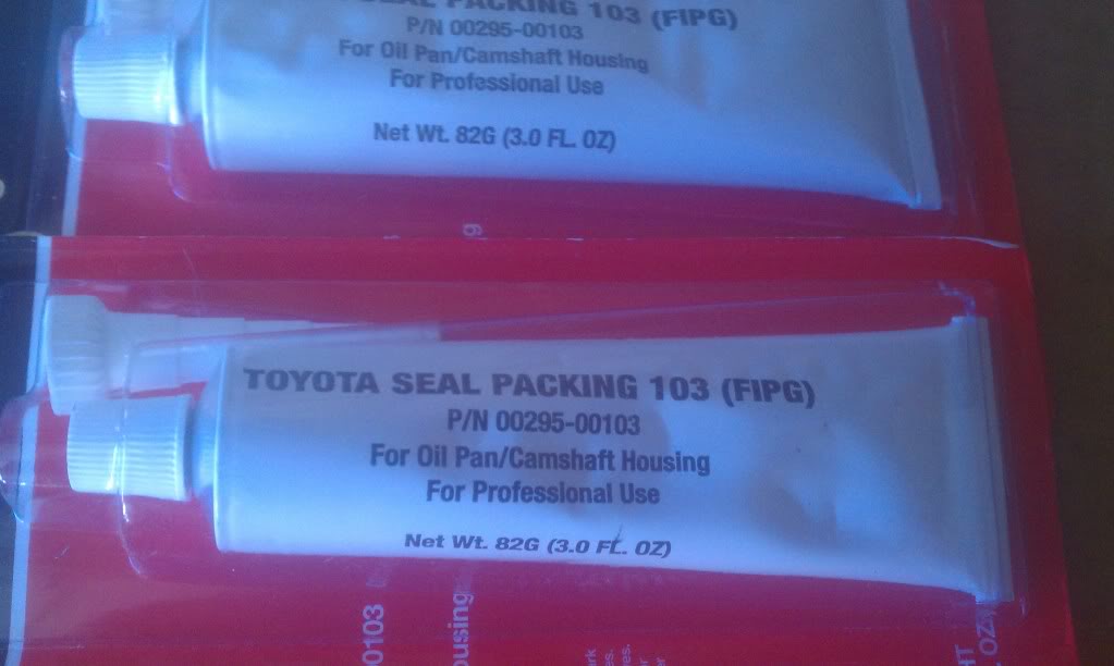

FIPG for the wonderful oil pan of course!

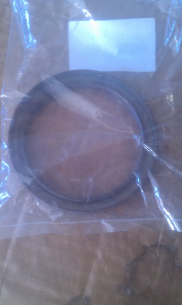

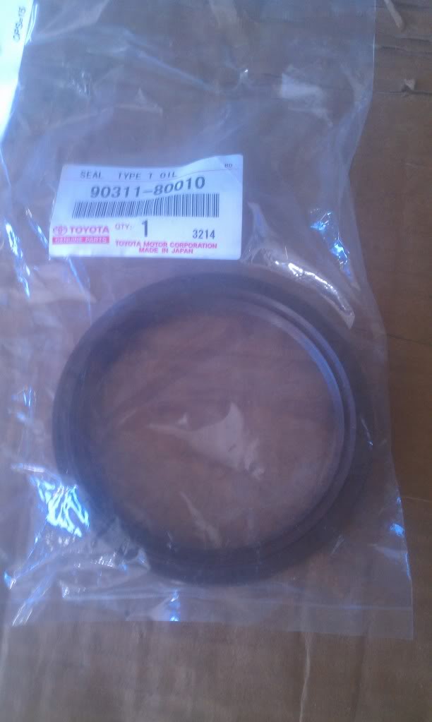

Rear main seal, I'm thinking it's a good idea to replace it while the motor is out.

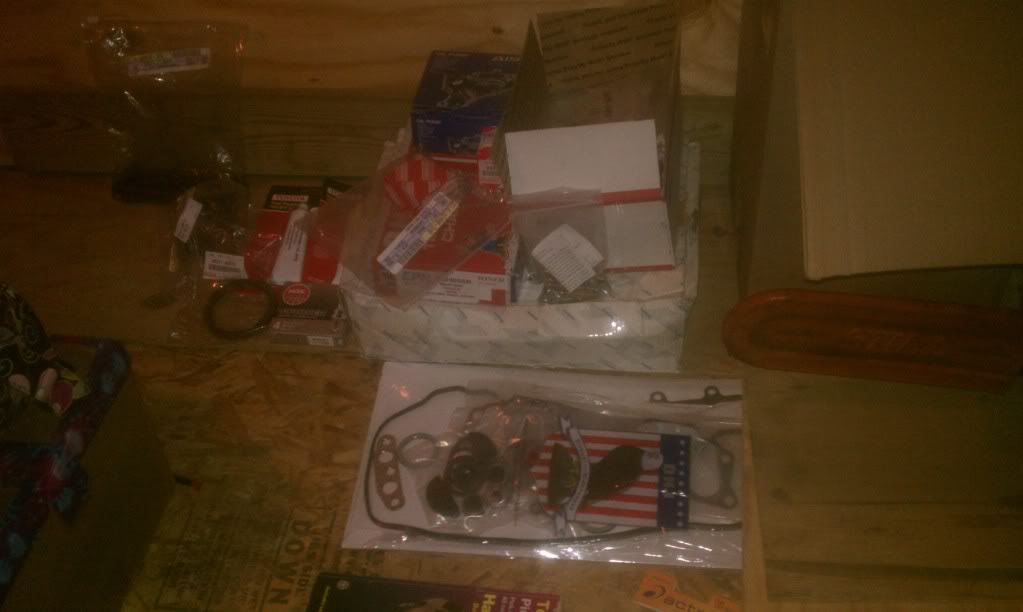

My parts pile! WOOOOO!

Ahhhhhh, told ya I was mind melted lately.... forgot u were carbed.... at least I mentioned it as a variable, right? Hahaa.... The hose and apparatus in the white is the hose and 2way valve/w/filter that attaches to the dashpot.

So the red is the dashpot?
Sorry I keep asking about this, just my noggin isn't comprehending.
