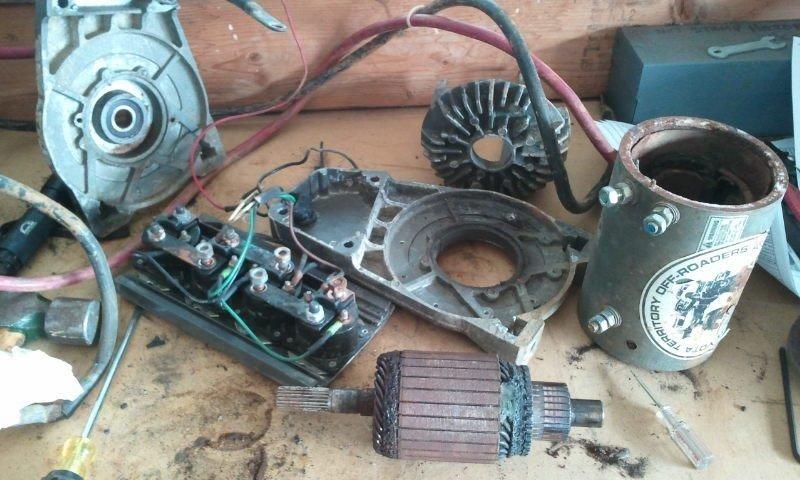

Actually did something over the last week, over 3 years ago, I took my winch apart to rebuild it after burning up the relays. I've had all the new parts to fix it, so finally this week I decided to get on it.
Here it was 3+ years ago:
And after cleaning it up, painting it, and replacing all the relays, the bearing, the bushings, etc:
And decided to give my bumper a quick coat of paint before mounting the winch:
Still have to re-splice my synthetic line to replace the thimble in the end of it, but I tested the winch with no rope and thankfully it does work.
