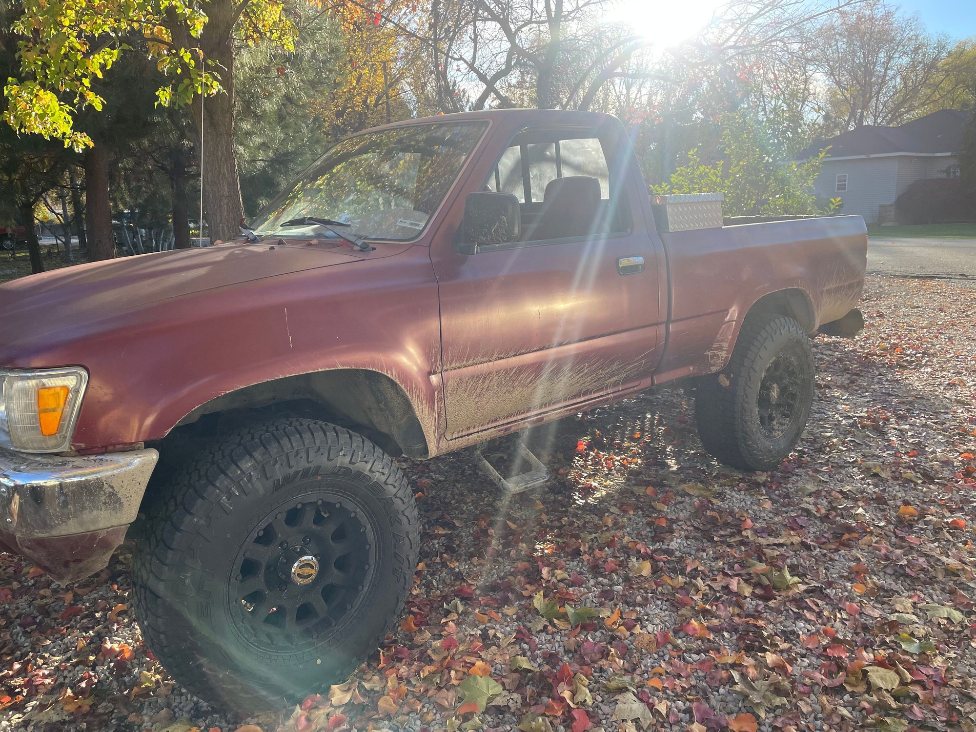

In early June several life changes lead to me selling my gas guzzling 1997 GMC k1500. The only trucks I was looking at was 90s toyotas, I after weeks of searching I finally found it. A 1990 toyota pickup with a 5 speed manual, single cab, and 192k on the 22re. I hit the guy up and asked him to hold the truck for me until I could look at it, he agreed and 3 days later I payed the pull 5k he was asking for the truck. Sadly 2 days after getting him home the rear main seal started to leak bad. I went ahead and asked the seller and about it and he was very sorry but had no idea about the leak because he had not driven the truck much in the last 3 years. So started one of the bigger projects Ive taken on in my short 18 years of life. After hours of reasearch I decided to replace the rear main seal, tranny seal, clutch, flywheel, ujoints, half moon seals, and as many gaskets as I could reach while everything was apart. I also ordered a set of wheels and tires to replace the huge 33x12.5x15s that came when I bought it. Here is my parts list and work done as of now. Asian Clutch kit, OEM flywheel, OEM seals, valve cover upgrade bolts, valve cover gasket all from 22re performance, highly recomend them for the service and quality. Next up were moog ujoints and all the fuilds went was royal purple for all tranny and diff fluid. Finaly I finished it off with Pro comp 32 series bandido 16x9 wheels wrapped in falken wildpeak at3w 265/75/16s. While I was getting the tires mounted I had them check my alignment and it was woahfully out, I had some time to kill so I told them to just go ahead and fix it. Shortly after they come in and told me my camber adjust bolts were frozen and needed replacment. As of now I have bought new control arms, camber adjust bolts, and rancho 9000 shocks to get it taken care of while I have the front end pulled apart. For now im sticking with stick hight but will be getting a budbuilt tranny support skid plate to help with the clearence there. Plans for the future are full skid plate set, tube bumpers front and rear, and new paint next summer. Please share and sudgestions and recomendations and this is my first build. I do know I want to 3.4 swap at some point. Thanks for taking the time to read and Ill continue to post as I work on the truck. Thanks Again!

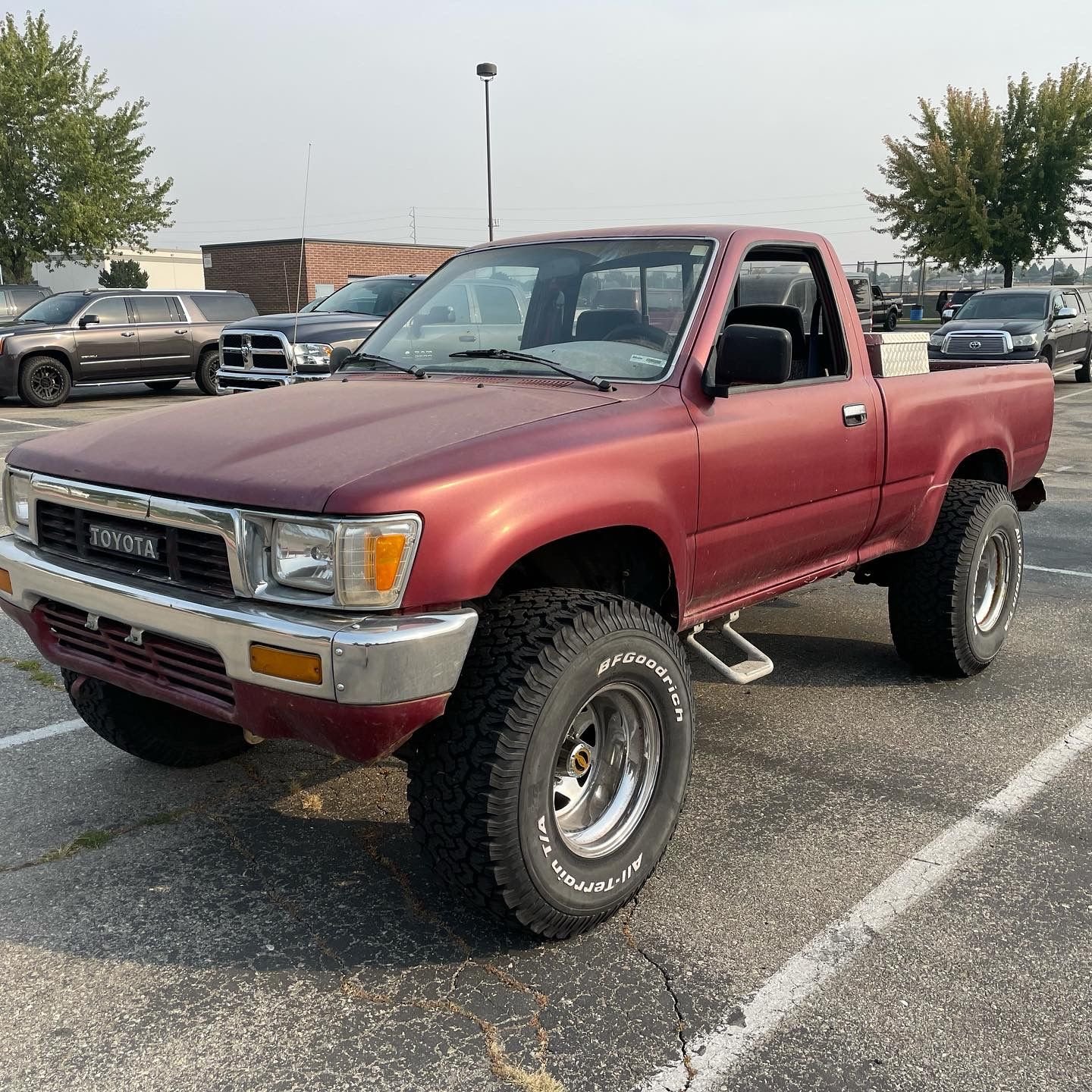

Day that I got clifford!
Oh yeah, Snapped lugs lead to snapped drum... got it fixed in the end though!

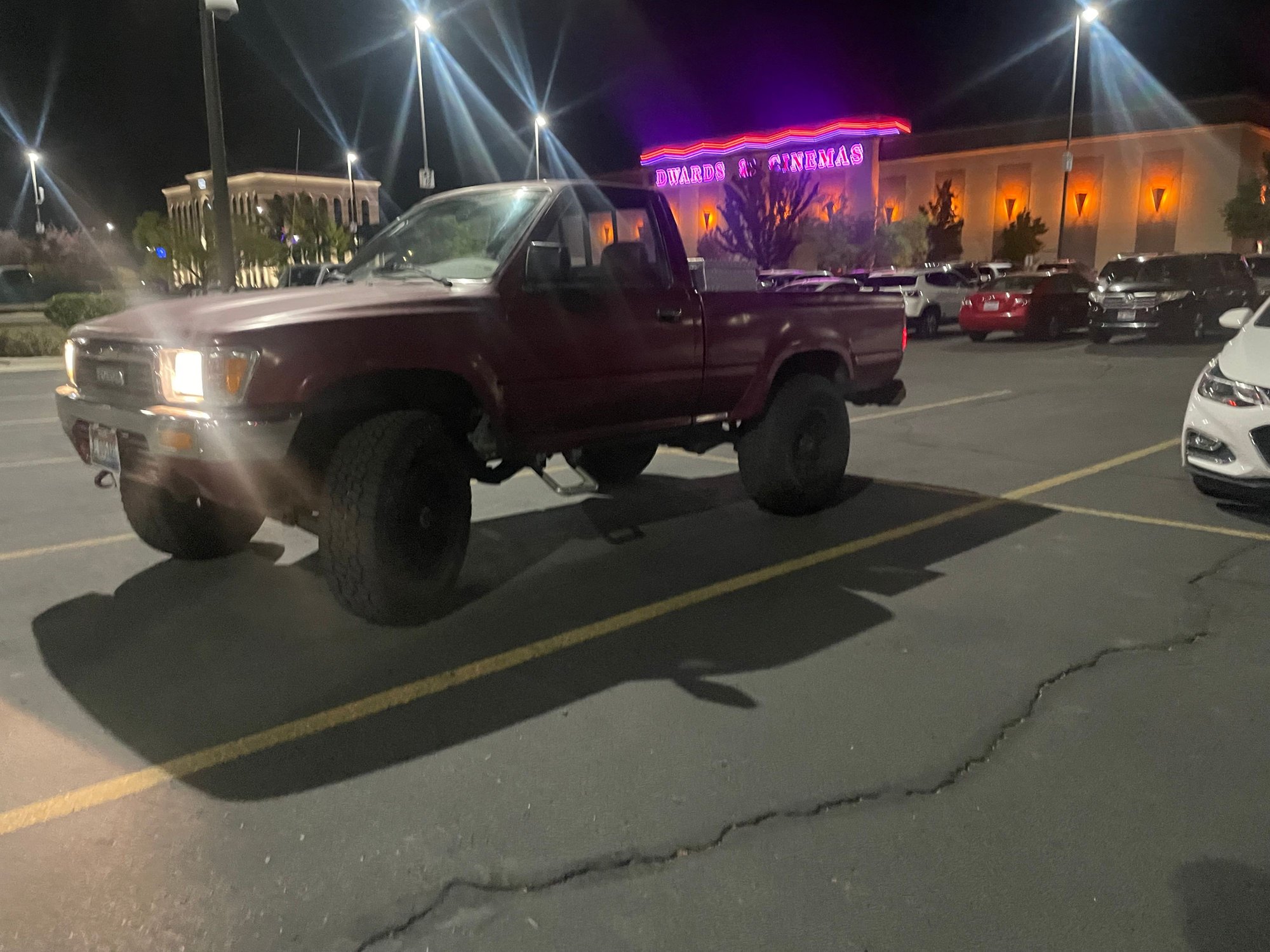

First time wheeling, Cant wait to go again with the rancho shocks on theold ones are very tired.

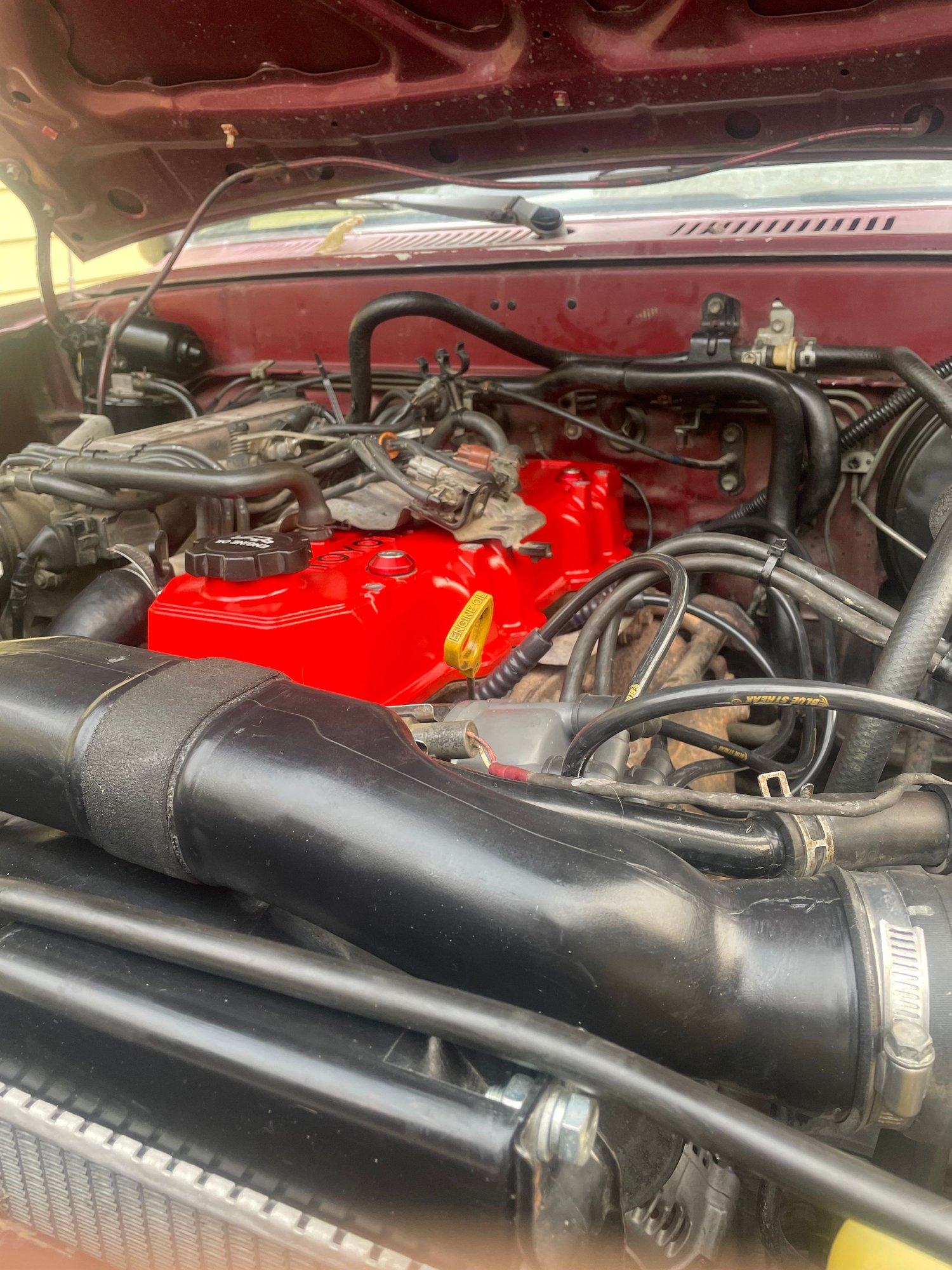

Right before the first start since all the work, engine was looking fresh!
Looking good after new shoes! had to go watch a movie to finish the day off haha.
