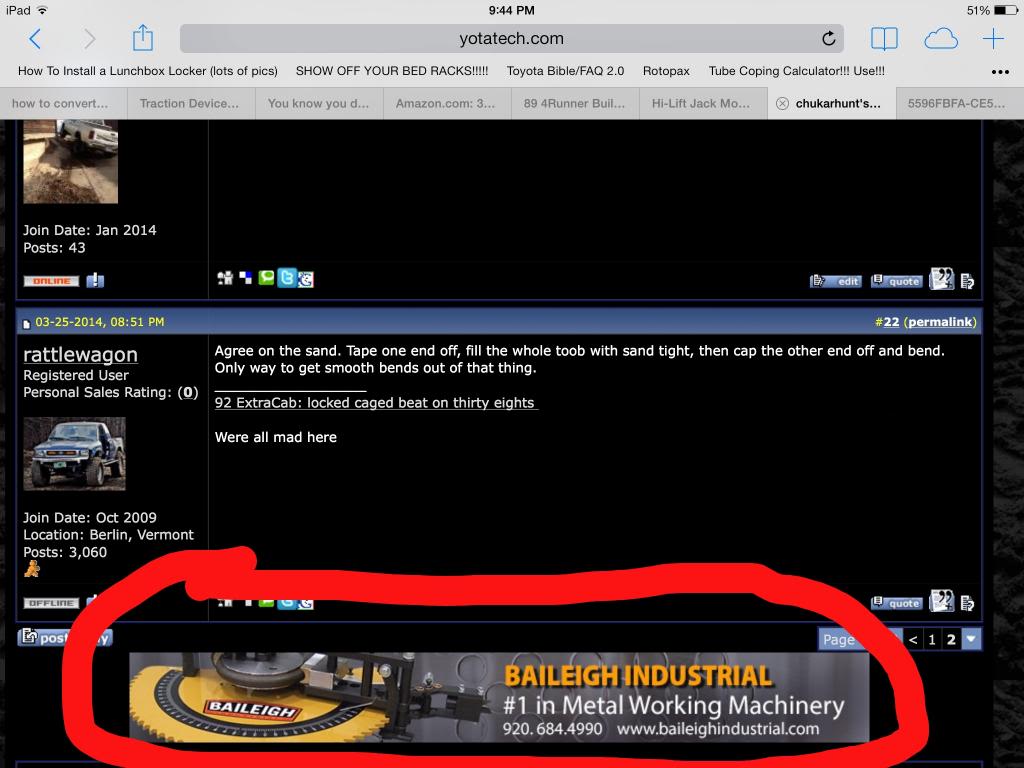

And Jake, YA! talk about irony in advertising. It is like the computer knows...

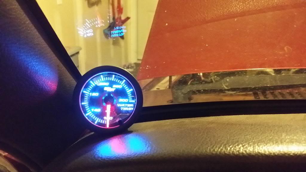

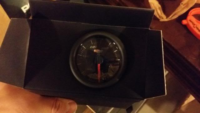

Well, one of my new toys showed up in the mail:
I will hopefully get it installed tonight! I will be able to accurately monitor engine temp this way. Current gauge is WAY off, and glowshift just looks cool.

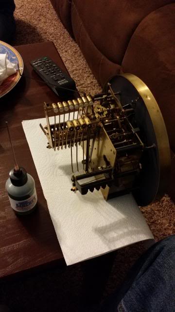

While I waited for parts, I had to keep myself busy:
Made in Western Germany, the real wall hanging grandfather clock deal, picked it up for free.
Works great for being over 30 years old. Being an engineer I love these old mechanisms. sometimes I miss the art and intuition that was put into technology.

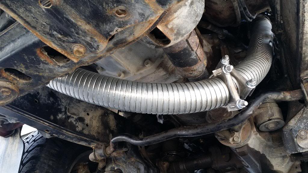

crossover elimination mod

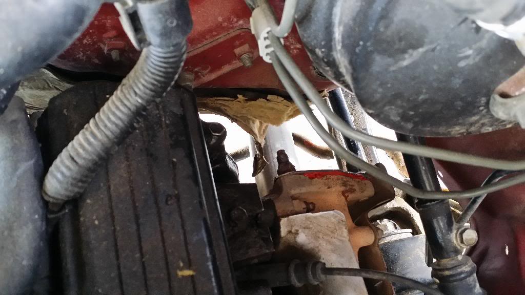

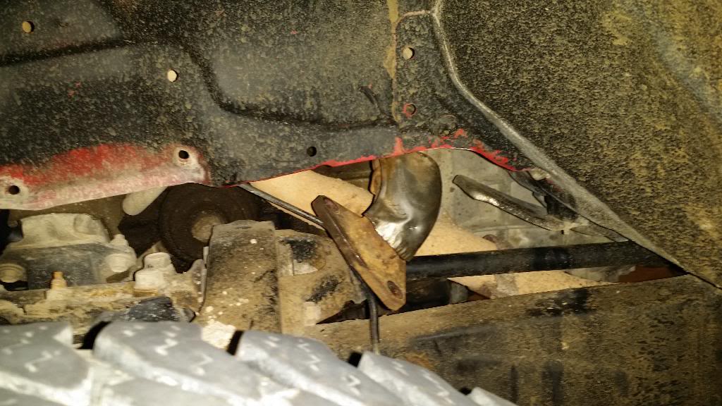

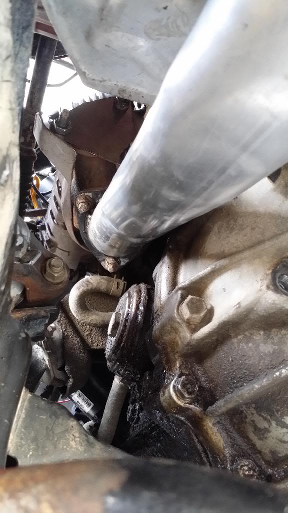

well, here it is. After almost 50 hours of stress, knuckle busting and neck straining work, I got the bloody crossover done. Am I happy with the results? no... Does it look ugly? yes... Am I a great fabricator? work in progress... Did it lower under hood temps? you bet it did. lol...
Had to lift the cab off the frame a couple inches for it to slide out. Funny, the exhaust nuts came off with relative ease. The pipe that goes to the muffler is a different story...

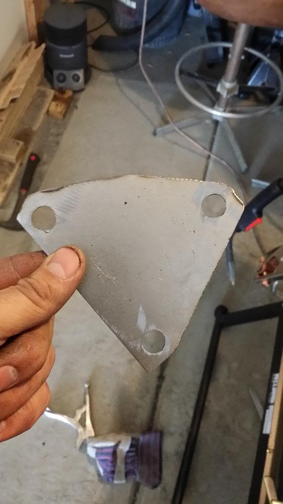

There it is, ready to be hacked up and re-used. I used the passenger flange to make my drop down pipe.

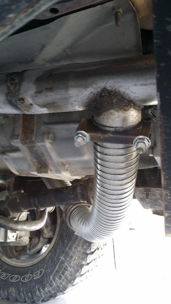

YES! I know... flex pipe... not the best but certaintly cheap. Did I say this was only temporary?

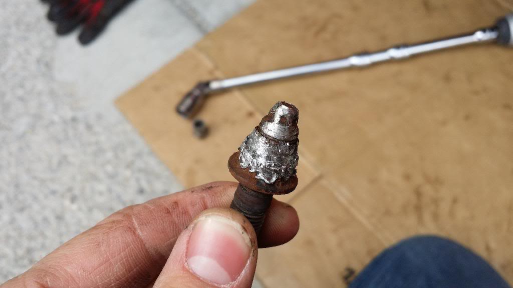

THIS THING!!! Had to be the last bolt... But I always win a fight. an impact, special stripped nut sockets and a lot of swearing later, it lost... I even re-used it.
Sadly this was the easiest thing to make.
Woohoo! no more crossover! I still sense an exhaust leak somewhere...
new driver side...
I HATE flux core. I mean it has its place, but it is not on thin exhaust pipe. Feel free to criticize.
new pipe right up to the flange.

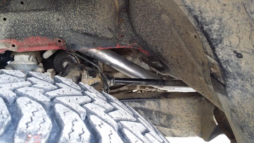

passenger side drop. beauty of flex pipe is you can bend it to your will. barely clears the lines.

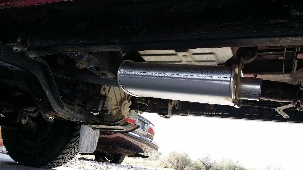

Thrush turbo muffler no cat. We don't need no stinkin' emissions! (really, elko county doesn't have smog requirements)
and here is one of the reasons, I should take my time when doing this kind of stuff... what is up with the low hanging muffler?!?!? well, when you are in a hurry, have been dealing with this for a long time, and can't get your welder close enough to the truck... you end up with this... soon to be fixed.
I am not entirely happy with the outcome. Actually kinda embarrased by the hack job, but I figured I would post so you all would see what NOT to do. I went straight from the manifold to 2.25 inch pipe, and then to a 2.5 inch muffler. In all honesty, I feel I have lost power, probably due to a missing vacuum line. I started the egr delete but decided against it for now, so I might have a misplaced vacuum line, the ecu keeps trying to raise the idle even after it is warmed up, not sure what I missed.
On a happy note...
The new gauge is awesome. Can't wait to buy more! AFR gauge is in order.
Well, feel free to criticize. I probably missed something but I will probably post it later. Enjoy.
new driver side...
On a happy note...

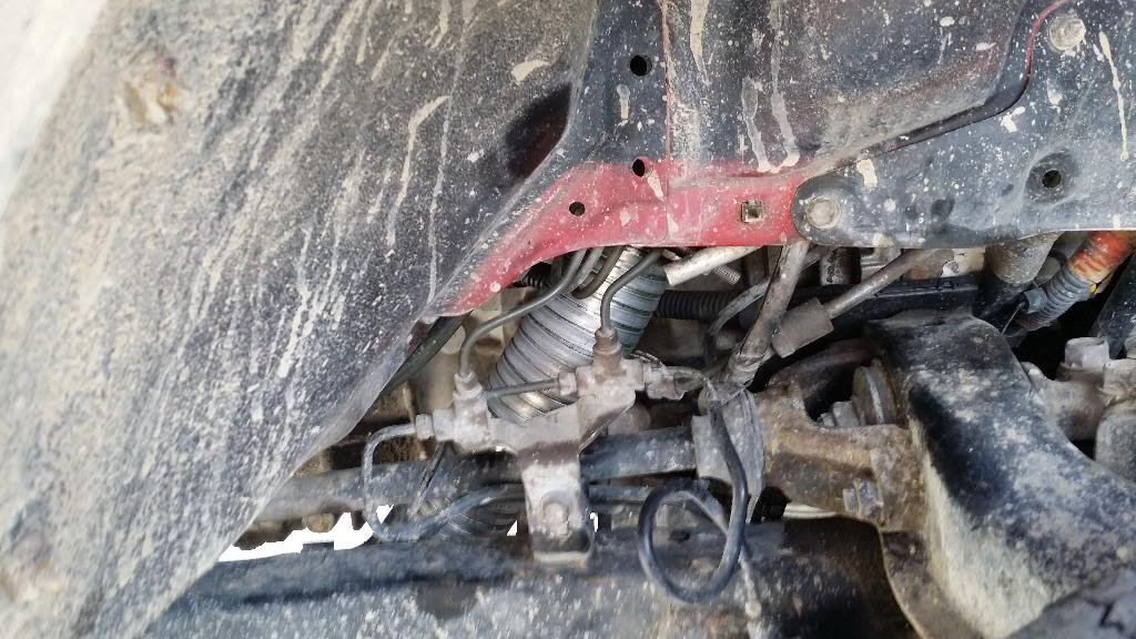

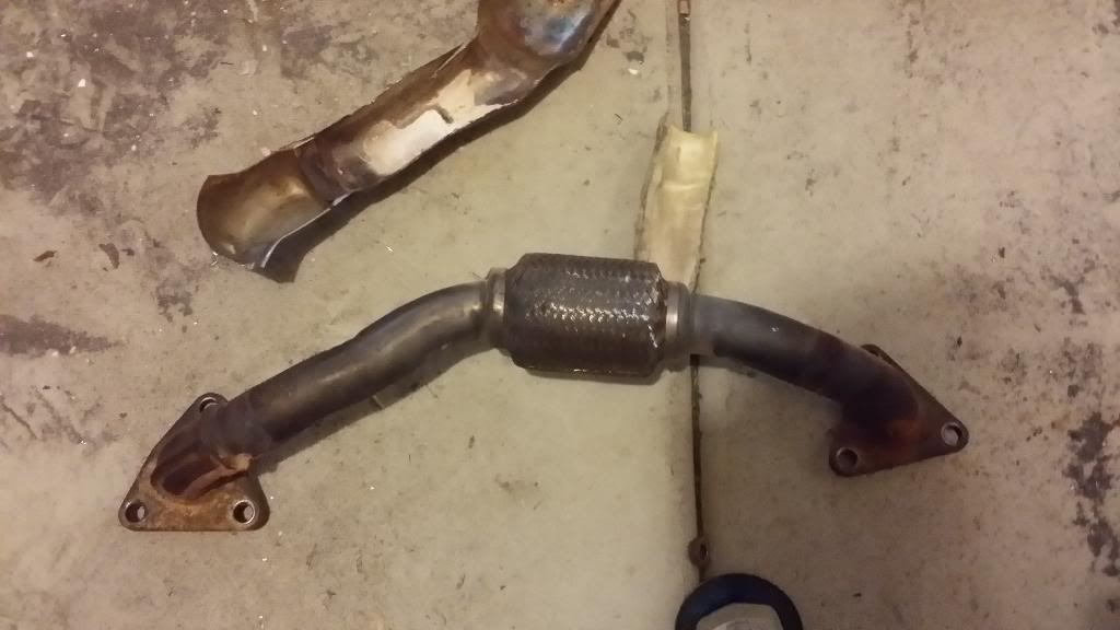

Ya I have the 3.0, the crossover is the pipe that takes exhaust gases from the passenger side manifold and dumps it into the driver side manifold, right where number 6 cylinder. All the exhaust gases then exit out the driver manifold on the bottom side. It is a huge bottleneck with colliding gases, very inefficient. And supposedly the extra heat by cylinder 6 causes the infamous head gasket issue.
If you look at the pic of the crossover, that pipe is extremely small, ridiculous. I opened up the pipe to 2.25" at the manifolds, this helps reduce exhaust reversion, encouraging the exhaust to scavenge out of the cylinder better.
There are tons of guys who have done it, I would search through the forums and look at everyones and get an idea of what you would want to do. I went under the driveline because it keeps the pipe away from brake and fuel lines on the frame rail, and I will eventually build a skid plate to protect it since it is at the same level as the trans crossmember.
If you have a drivetrain lift or diff drop, you could probably squeeze the pipe between the trans and driveshaft. Others have routed the pipe around the backside of the transfer case.
My old muffler rotted out too, so I just cut the thing off and left the CAT. It was fairly loud but I didn't like the sound. The Thrush Turbo muffler actually quited it up, with a little more lug. If you need any more pointers I left out of the previous post hit me up if you go for the mod. Again, lifting the body off the frame makes sliding the crossover out a breeze.
