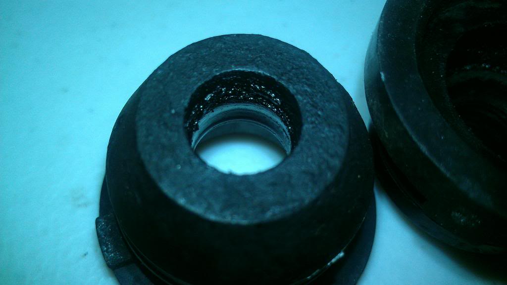

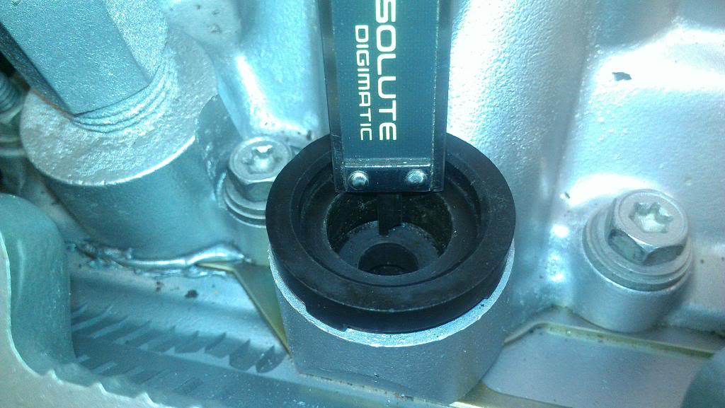

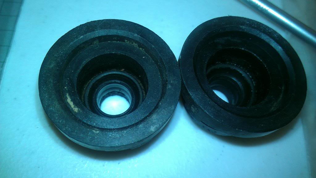

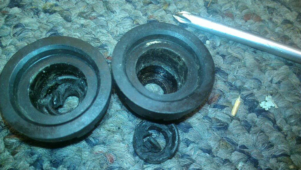

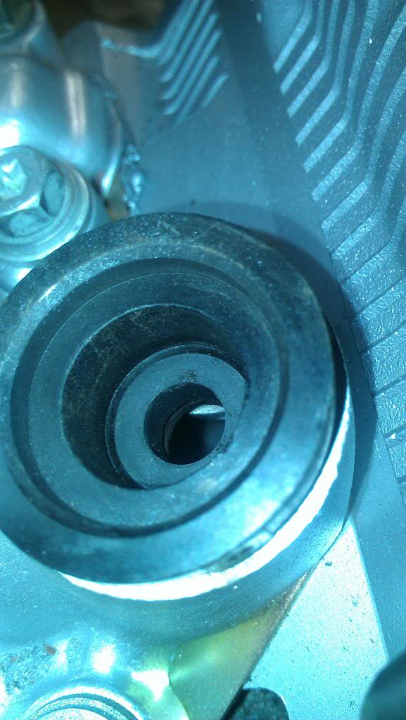

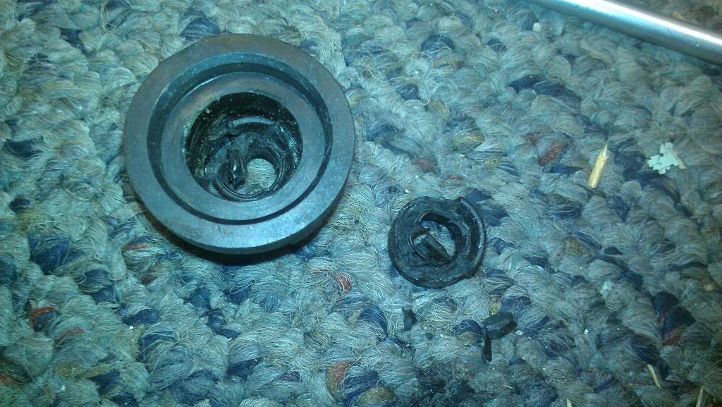

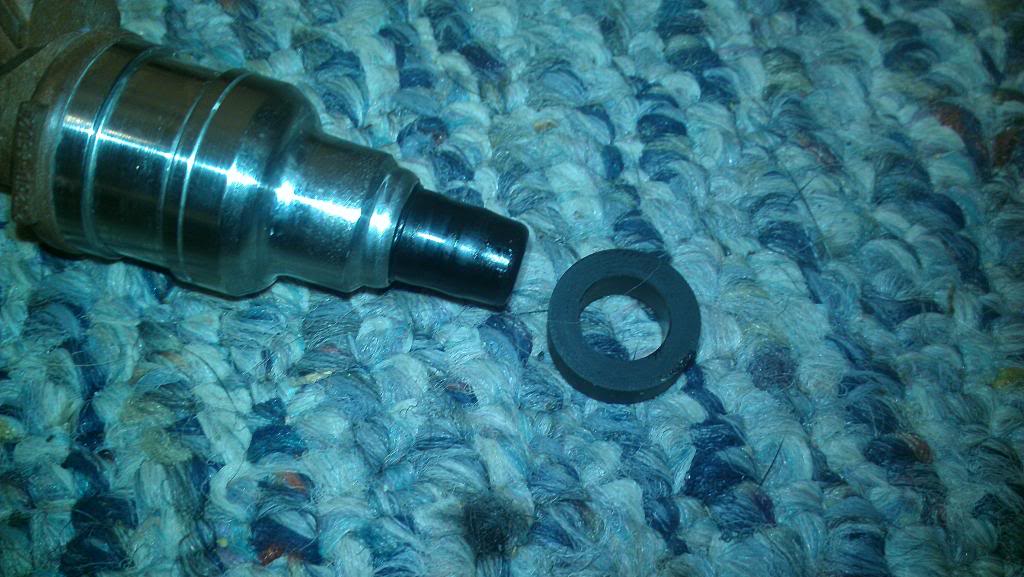

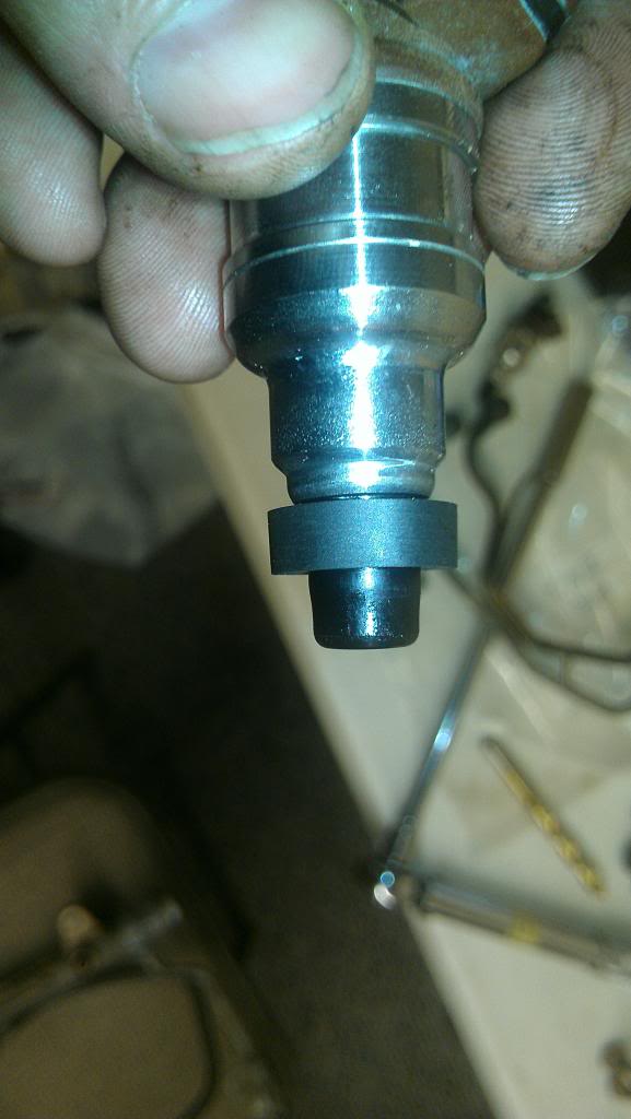

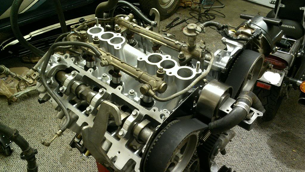

So I actually didn't go to bed after last night's message. Instead I was productive! I installed the fuel rails and fuel injectors, though not without difficulty. In fact, I'm still not 100% sure they are in right but they are in enough, I hope. My problem stemmed from the injector cups having an old gasket or washer left in three of them. I am a bit disappointed in Fuel Injector Connection for not having this piece removed from three of the cups, as I sent them to be cleaned with the injectors. The injectors looked good, for the record, but I'm going to be giving them a call to find out why they didn't fully clean the cups as I asked. Makes me a bit worried for the actual injectors.

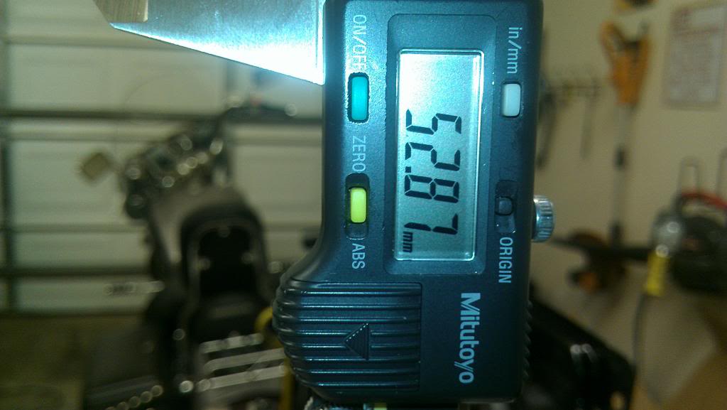

Anyway, pictures are here. I also got out the calipers to show what I feel to be the correct install height of the injectors if everything is right. I could be wrong about this so I'm not liable if you shoot for these numbers and they aren't right.

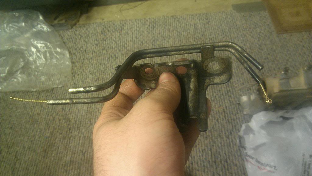

Also, I had a couple of vacuum lines with bad stuff in them. I found that the low E string from my guitar worked great at snaking through and cleaning them up. Feel free to use this information as you see fit.

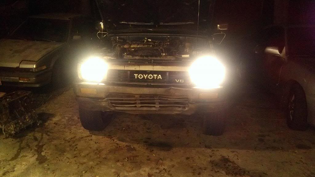

The big day.
BIG NEWS!!!!!
IT IS ALIVE!!!!
Here is a little video of it starting for the first time (well, second time, but who's counting?!)
http://s1364.photobucket.com/user/Ch...4d142.mp4.html
I apologize in advance for the crappy videography.
I have plenty more pictures to post but I'm just super stoked that the truck runs. Heck it doesn't just run, the A/C works, the power steering works, and I was able to back it up my driveway and take it around the block!

I think the shop assumed you would replace the cups. I love the attention to detail you put into your rebuild. I've never measured how far injectors were seated. On customers cars and my I vehicles I replace all "rubbers" . Install new, Coat with a lil bit o Vaseline then push and twist. Some European manufacturers say don't twist. Whatever I've been doing like that for 10 years.
