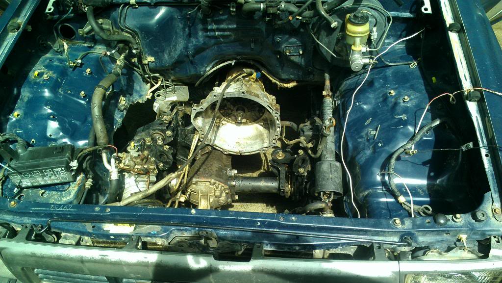

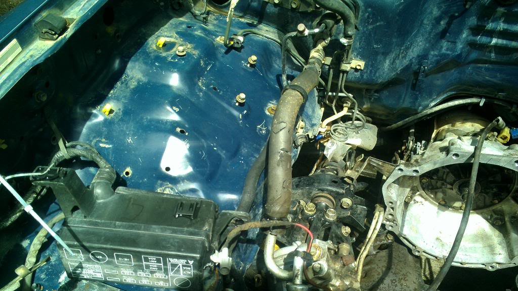

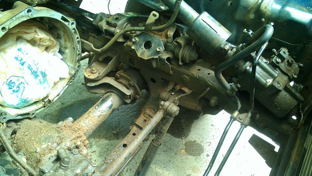

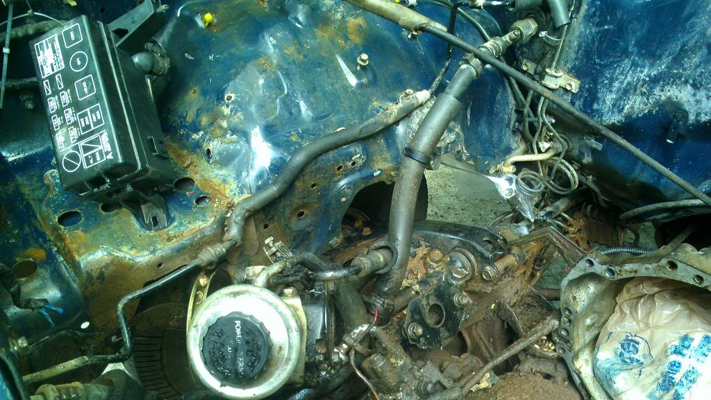

Well, now that I'm waiting for an engine to arrive I figured I would try and knock a little more dirt off of the truck. Here is the before and after:

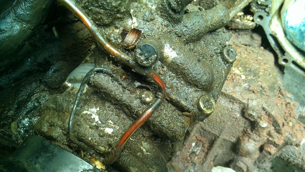

Before (rat poop, Georgia clay, acorns, and engine sludge):
After:
I'm sure there are still a couple of cracks I didn't get to, but she looks a hell of a lot better now!
-Chris
After:
-Chris

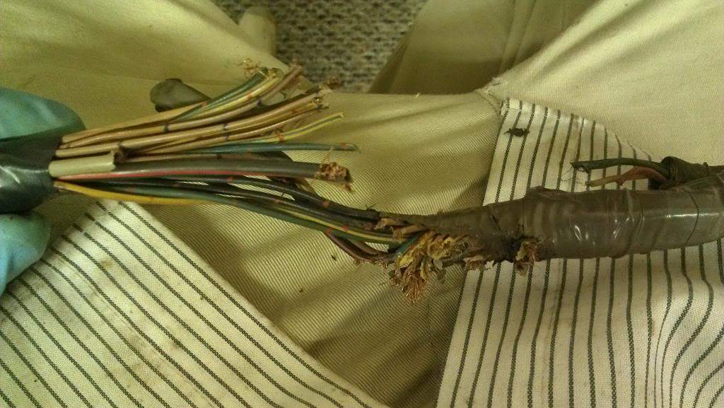

This re-wiring job is a PITA!!!
First off, the Haynes manual's wiring diagram is pretty much useless for a 3vze. I don't even know why I bought the damn thing. Second, why in the world did Toyota decide to use the same two colored wires for every fuel injector? Do they all fire at the same time? This is driving me nuts. If I ever find the literal rat that did this I am going to shred it with a crowbar.
I will figure this out. Rant over.

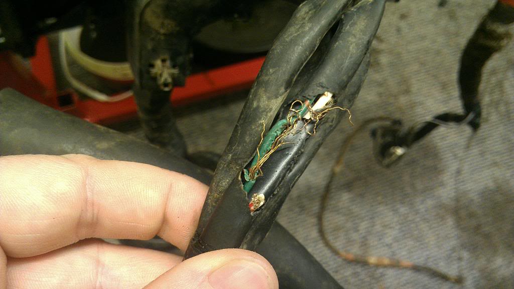

I may be screwed at the knock sensor - It is a braided co-ax cable. I'm not sure if you can do this but I un-braided it at both sides, twisted the braid into a wire I could then tie to my jump wire and soldered both ends so the flow will go through that wire. Then I jumped & soldered the middle wire as normal. In my head this should work but I'm a mechanical guy not an electrical guy. I'm wondering if this will cause some kind of un-wanted interference. I guess I will find out.
Edit 3:
I found out! Apparently this motor uses "simultaneous fuel injection". I forgot for a moment that I have stepped back in time to the 1980s. What this means is that since the computers back then were very slow, they had to fire all injectors at the same time. It isn't even batch-fired as the wiring diagram might initially lead you to believe. Despite the fact that one bank of cylinders uses a white wire and the other uses a white-red wire and the fact that they join the ECU in two different ports (#10 & #20), both wires are spliced together at splice E18 and the ECU fires both simultaneously anyways. (why they bother to have two ECU outputs I don't understand. Maybe it is to supply a little extra current or as a fail-safe.) Either way, the answer to my initial question in this post has been solved. It doesn't matter that they're all the using the same frickin' two colors - they are supposed to all fire at the same time!http://snjschmidt.com/wiring/Engine_Control_3vze_2.jpg

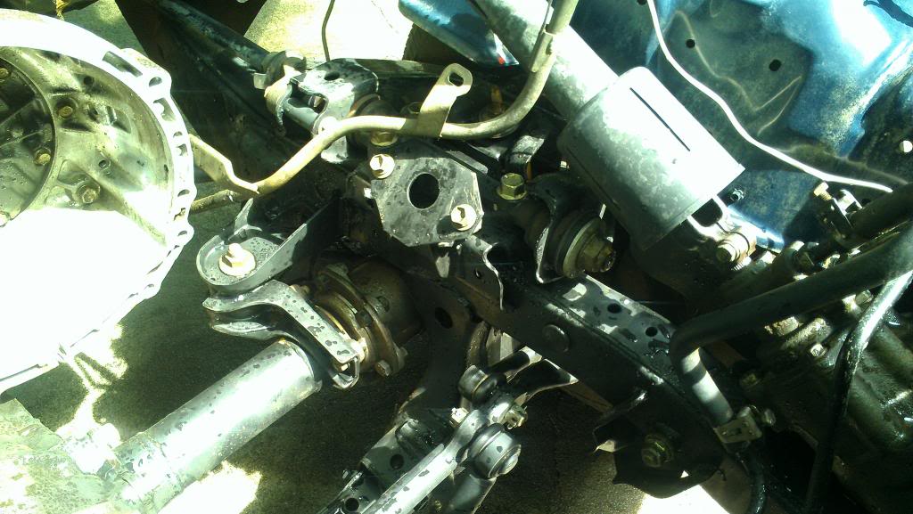

Anyways, a visit from my parents didn't slow me down today! Managed to get the exhaust headers and engine mounts off. And the oil cooler. Now I'm gonna go splice some more harness wires together. I'm targeting a 6/15 date to have this truck leave the driveway under its own power.
-Chris

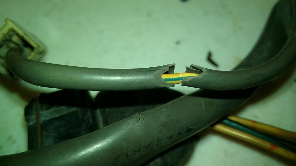

Does anyone know why there isn't an EWD available for the 1989 3vze pickup anywhere on the internetz yet? The 1993 EWD will not completely match up and I'm getting frustrated. I've got three or four yellow-green or yellow-blue wires, and 3+ brown-black wires that are in between the #2 & #6 fuel injectors on the wiring harness and have all been sliced open by the rat. I'm trying to make sure that I splice the correct wires back together. It appears that a yellow-blue and a yellow-green wire connect to the volume air flow meter. Any help would be appreciated. Here are pics of all the relevant connectors downstream from where I'm talking about:

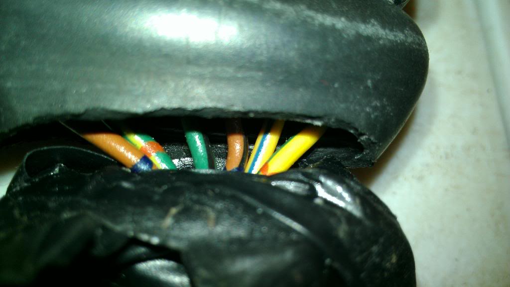

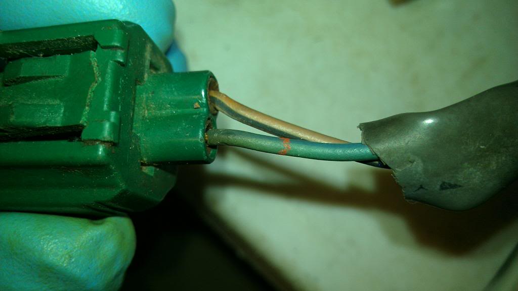

Volume air flow (From left to right - Brown, Green-Yellow, Green-Black, Brown-Black, Yellow-Blue?, Yellow-Green?):
Single wire connector (Yellow-green?) very hard to tell. (Water temp sender?):
Throttle Position Sensor, 4-wire connector (yellow, yellow-blue?, green-black, brown-black)
2-wire connector (Green?, Brown-Black) (Engine Coolant Temp Sensor, EFI?):
This is a bit of a challenge without the proper electrical wiring diagram. I've bought one off of ebay but it may not get here until the 15th and I was hoping to have this bad boy running by then! Any help would be much appreciated.
-Chris

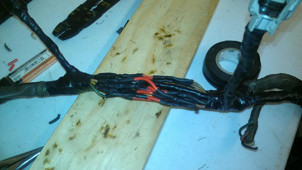

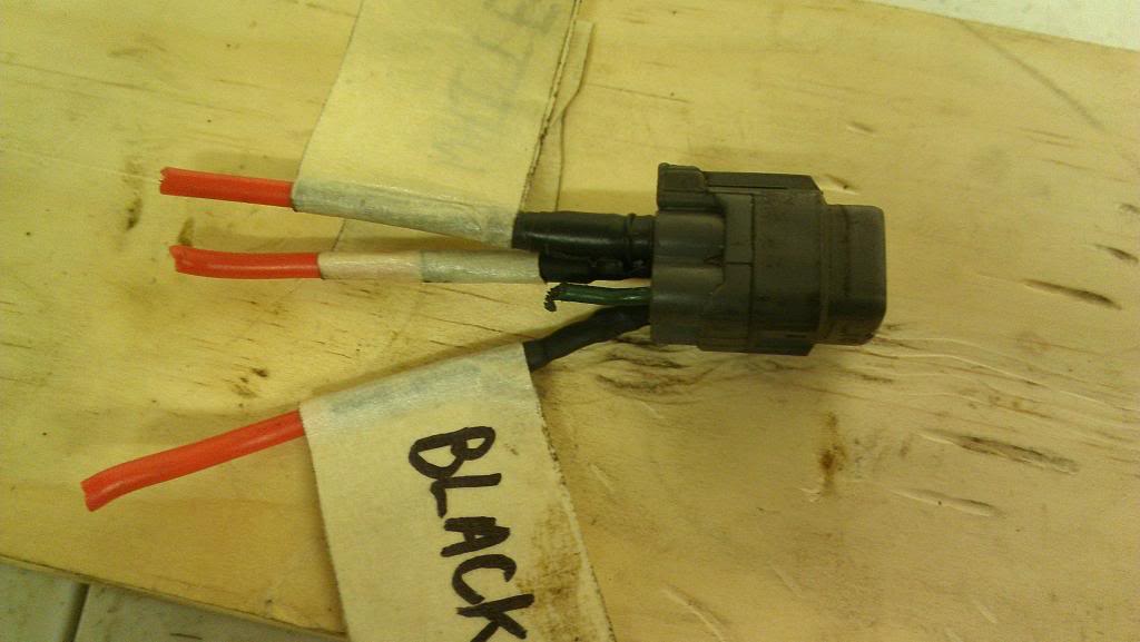

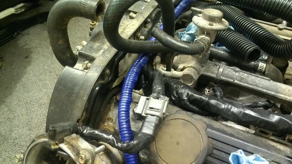

Progress is ongoing...
The wiring harness is two wires from being complete. This thing is going to be pretty much water & dirt tight when I'm done. I'm wrapping everything in electrical tape, then wrapping it in those flex wire covers, then taping those! Overkill? Maybe, but I have no intentions of letting water get anywhere near my hard work and since I do want to keep my engine clean with chemicals and possibly high-pressure water washing, this is the only way for me.
The engine is confirmed for a Thrusday/Friday delivery so I already know what I'm doing this weekend!
Here's a couple more pics - Giant splice job:
Same as above, but wrapped and test-fitted:
A little blue for fun:
Last two to fix:
-Chris

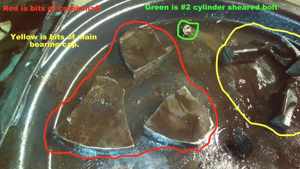

Also, after taking off the oil pan I was able to find out just how much damage the old motor sustained. It was massive. The crankshaft is broken between the #1 & #2 cylinder, it shattered the main bearing cap in the same area, and the #1 connecting rod is now split into two halves. Also, one of the bolts on the #2 cylinder connecting rod sheared off, the oil pan baffle plate is mangled, and the oil pickup tube is dented pretty good. I will put pictures up later.

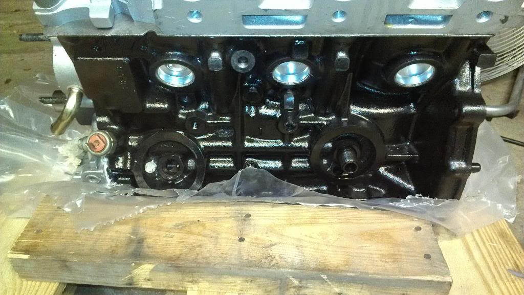

#37

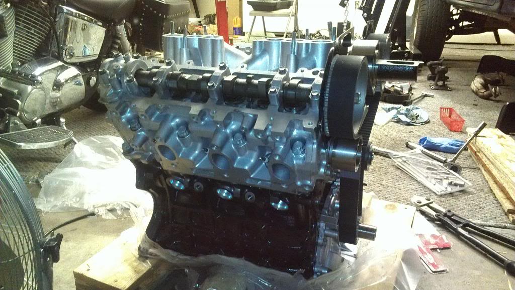

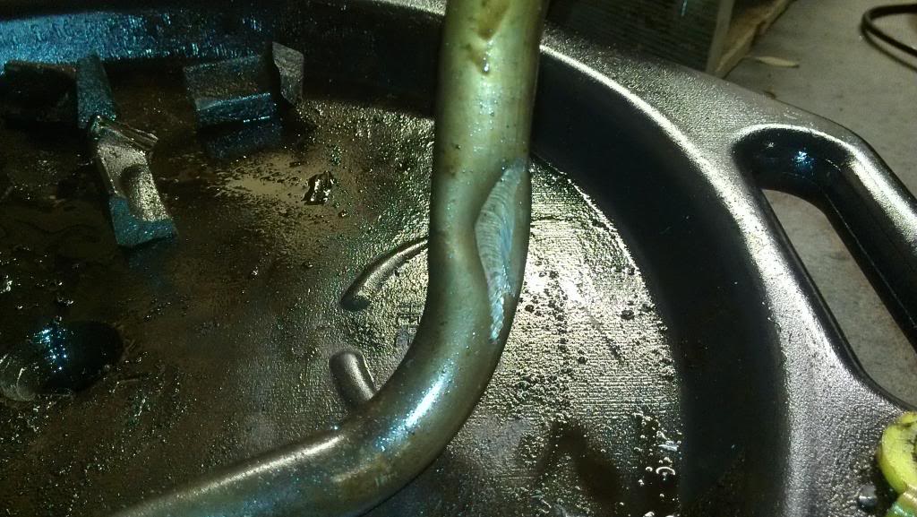

Okay, I think I may have been worried over nothing. As far as I can tell, all 3vze are the same as far as the block and heads are concerned. Which is good, since that's all I bought to replace my old one. It seems as though all I had to do to switch from one to the other was move the oil filter union from the rearward port to the forward port. See the diagram here:
http://personal.utulsa.edu/~nathan-b...ne/69cylin.pdf
If I am wrong about this, someone let me know please.

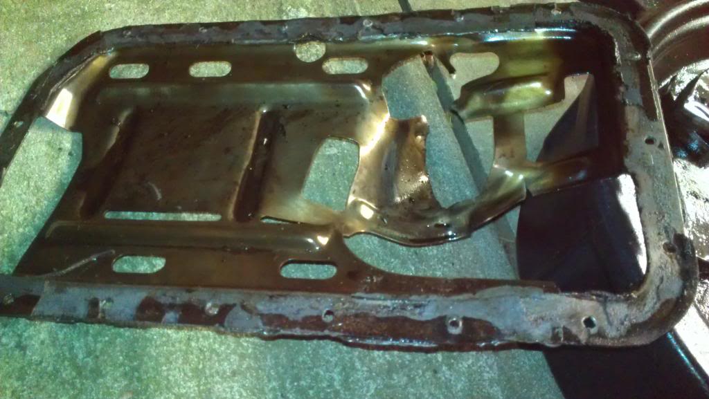

Anyway, some pictures as promised. I will try to get a shot of the bottom side of the old block when I can get it back outside again. I'm not flipping that thing upside down in my garage!
Broken parts:
Bent baffle:
Dented oil pickup tube:
Friday arrival at work:
Hello there, shiny:
Oh crap, looks different:
Oh wait, this just comes out and gets swapped over. Scared me for a min.:
More to come, stay tuned!
-Chris

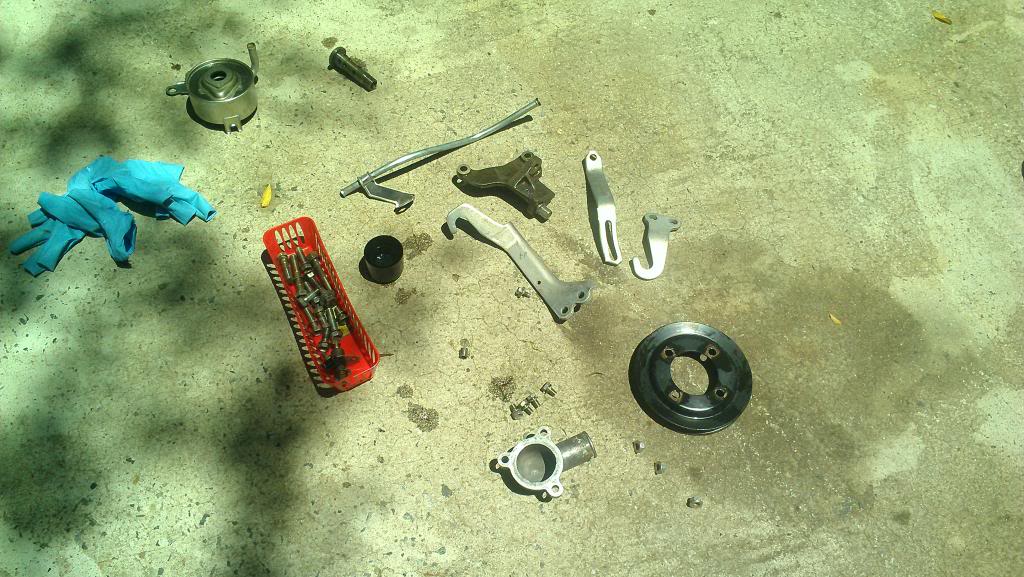

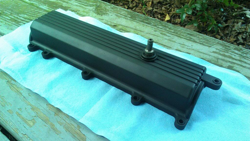

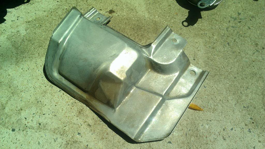

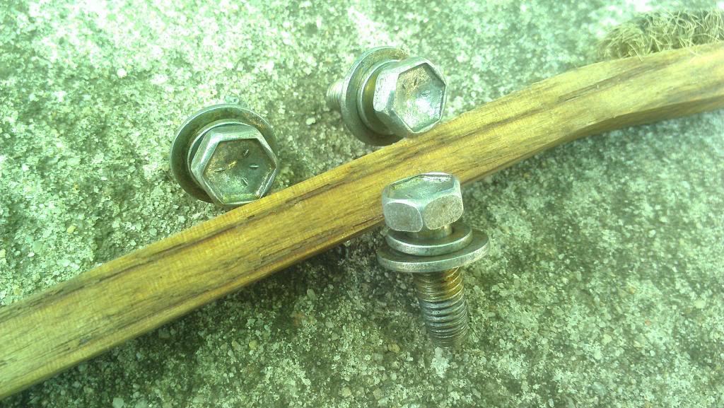

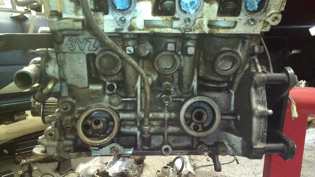

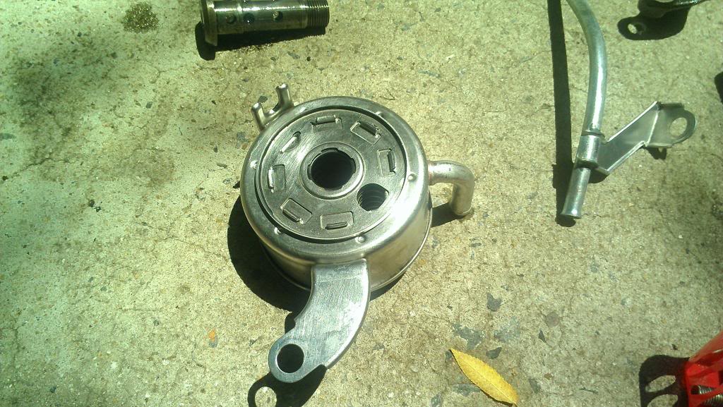

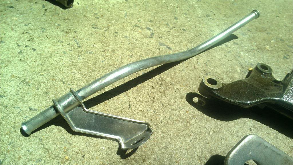

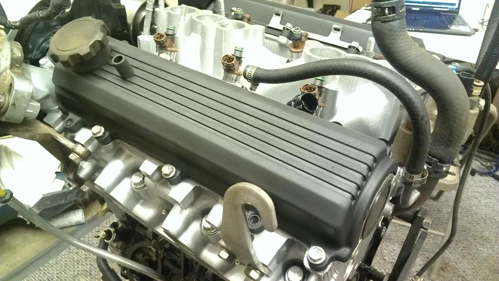

Anyway, here are some Yota pictures of parts during/after the cleaning process:
You can see what the dipstick looked like before cleaning in the previous post.

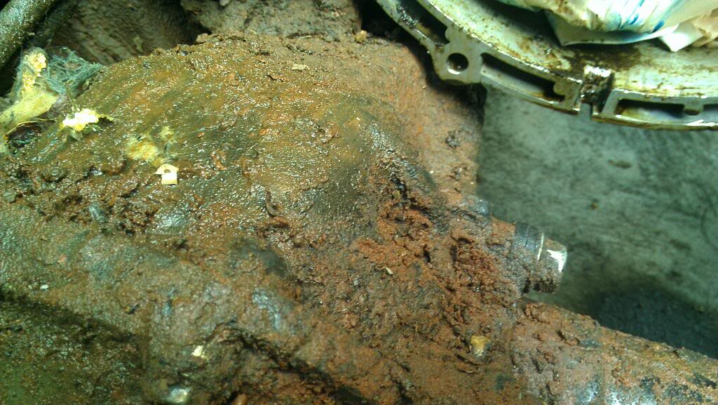

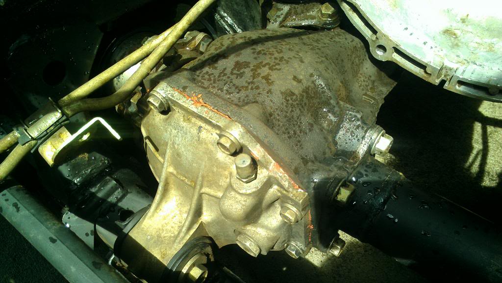

Before cleaning (btw, these are representative of pretty much everything that was attached to the old engine, so you get an idea what I've been doing):
After cleaning:

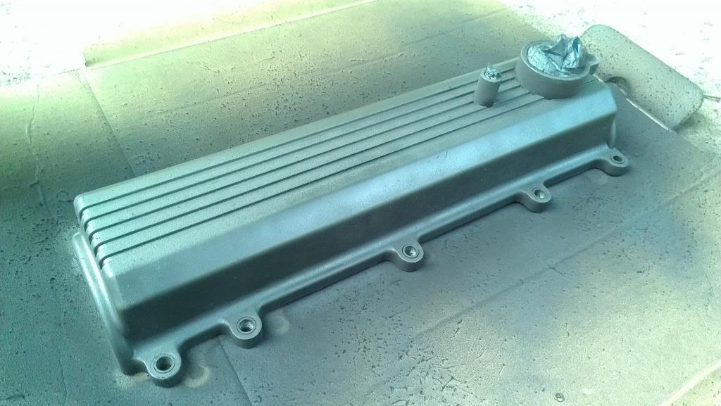

Well...
Sweet. Well, some of them are trickling in.

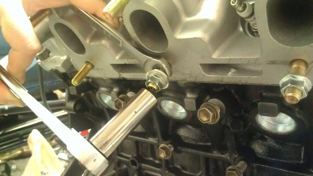

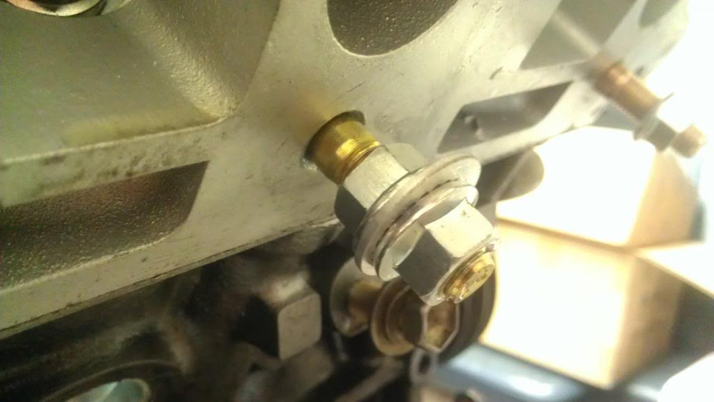

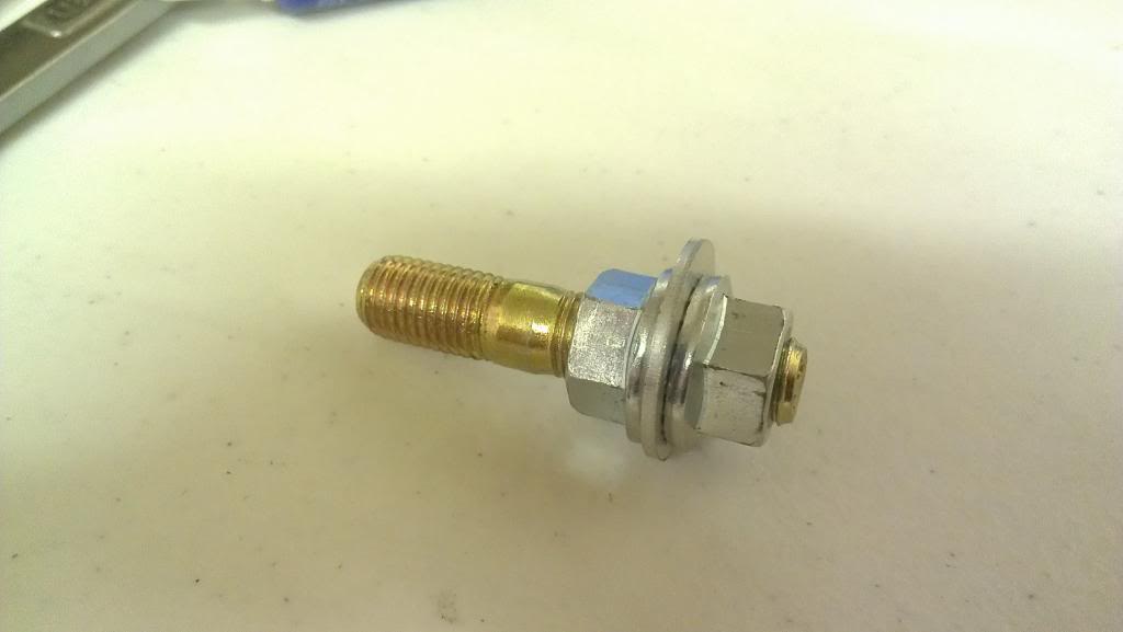

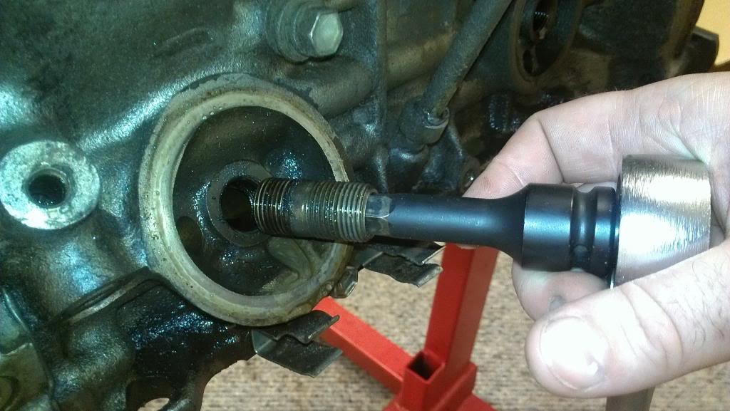

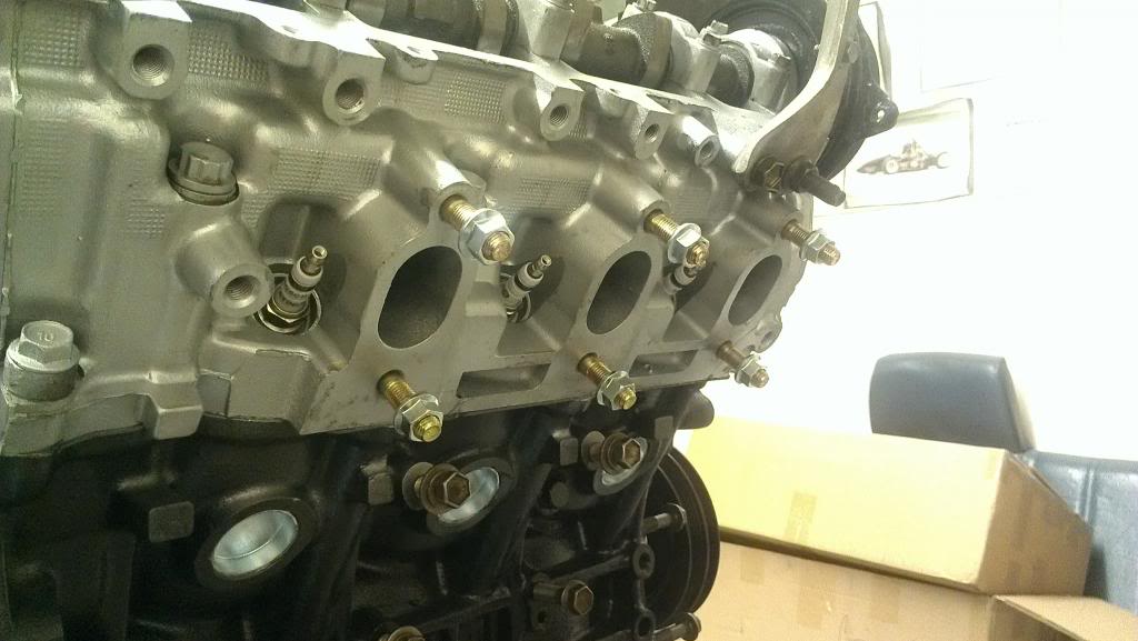

Of course, pics (Exhaust manifold studs, blue silicone vacuum hose):
And this is a great way I have learned (learnt in GA) how to install studs:

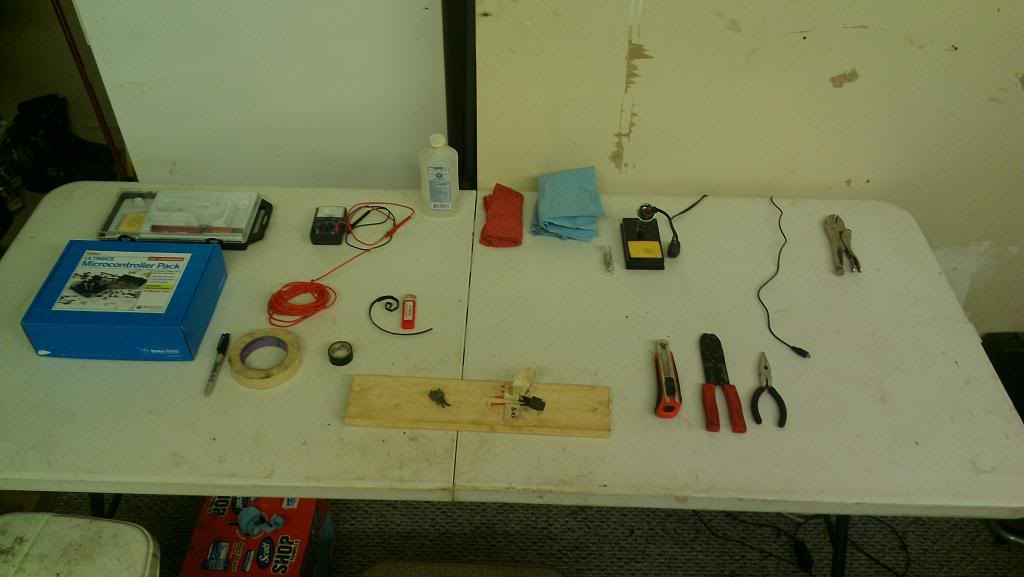

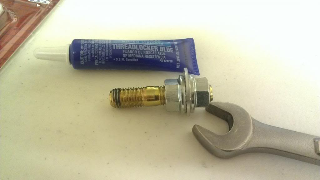

And here is a selection of the products I'm going to use to make sure various stuff stays in place and/or doesn't leak:
Ultra Copper between the exhaust gaskets and the manifold/headers; Ultra Grey just about every where else (oil pan, valve covers in the corners,); Water pump and thermostat housing RTV on any coolant gasket areas; Thread locker blue/red where applicable (blue on exhaust studs, red on oil sender, etc.)

Progress today: Exhaust studs installed, Water by-pass outlet installed, oil cooler install finished after hose install, oil sender installed, LH engine mount, generator bracket, and oil dipstick all installed.
Time for bed.
-Chris
Sweet. Well, some of them are trickling in.Of course, pics (Exhaust manifold studs, blue silicone vacuum hose):
