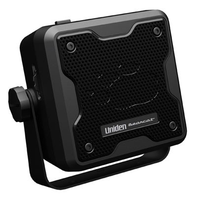

heres some ideas for amplified cb speakers compact is of course better easier to find places to mount it
http://www.aliexpress.com/wholesale/...b-speaker.html
http://www.alibaba.com/product-gs/49...mplifier8.html
pirate 4x4 link
http://www.pirate4x4.com/forum/gener...b-speaker.html
http://www.ebay.com/itm/HAM-CB-RADIO-MINI-SWIVEL-EXTENSION-SPEAKER-3-WATT-/220785059335?pt=US_Radio_Comm_Speakers&hash=item3367d0a607
this is the one i had
http://www.sears.com/astatic-classic...29114?prdNo=21

Thanks, Dragon! U2 Jason, really appreciate your input/professional perspective!
Reading up and watching a couple videos of CB fanatics/and the Pirate thread, they seem to feel that a GOOD noise cancelling amplified speaker/or pair/ is a real improvement over the stock internal speaker in the Mounted CB units, already.
The reason I chose the Cobra handheld unit above is because it saves so much space/easily removeable/seemed to be well liked and shown to live up to its claim of "90% noise reduction"/ and good range..... I guess we'll see? Bahhhahaha.....
Speaker...... Now I am very aware that this is not some huge decision, like everything else I just want to get one speaker one time and that's it for good... It seems logical that they have your one with the bigger man and just good quality in general is the way to go... I thought this was pretty interesting...

ok that is just too funny MP3's through a CB ok its neat a new electronics connection but still funny
the speaker looks good but a good noise canceler with some amplification will do ya better than LED's for sound strength the radios do that on their fronts or the display on the hand held if i ever put mine back in likely to change the white bulb in the swing gauge to a colored LED as its can get a bit much when driving
but ive never heard these external speakers first time ive seen anything like them i look forward to seeing what it sounds like mark an looks like as well! :-)
as for ya ear warm compress on it as ya relax might help it open up an drain like i told ya mine warmth helped but it finally took being lanced an hosing the nurse an dr's pants with stinky eew from it to fix it the drum healed up just fine ohhh did it feel SOOOO much better

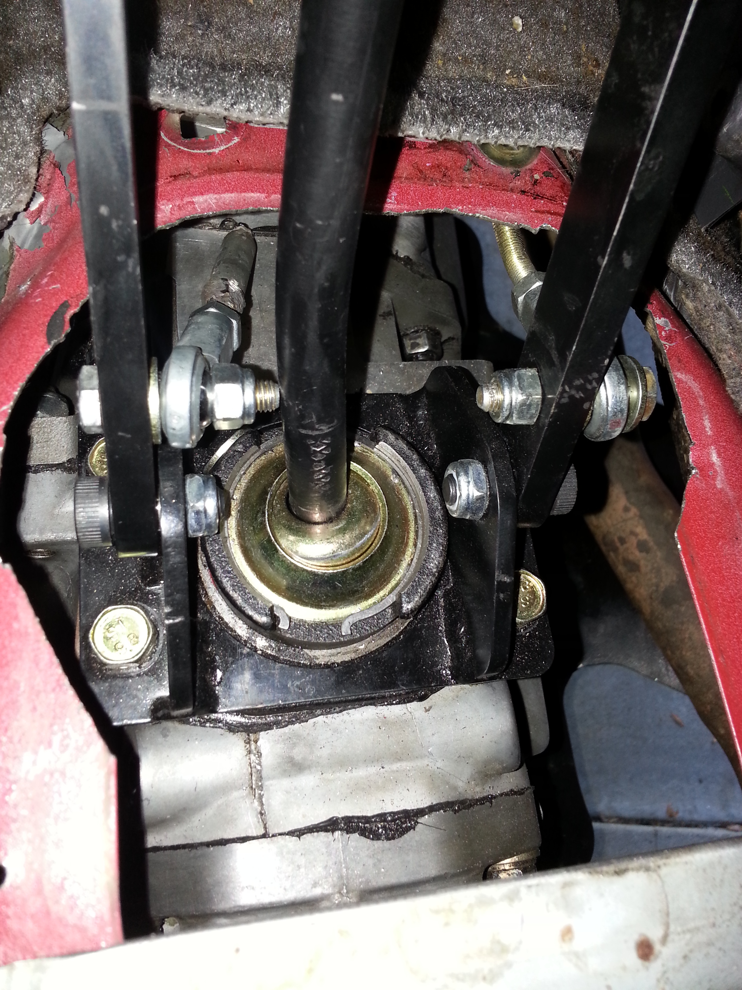

Sidetracked today due to triple stick problems..... I'm not doubting and believe Rory at RADesigns when he says they don't bend/break ..... and there were some mistakes on install... But long and short the rod on pass side for 2wd is broken.... I'm also very pleased with Yotamasters work overall....
Eric pounded for clearance amd then felt he had to bend the rods to make it work. ... It was also set up on the opposite side to clear the tunnel. I'm not wanting to give the impression that they're anything but GREAT at what they do. I KNOW Eric will say "SURE, bring it back, I'll make it right".... but I'm gonna give this a shot as I want to keep as much of my console and such as possible.....and its a hot long drive to have to make twice again! Hahaha.
I have to either drop the cars more.... or start pounding. ..... AND I DO NOT want to lose more clearance.
Rory is sending me two new rods, and I'll do whatever it takes to keep them straight this time.
I will be building up a risen shelf that will allow me to seal up everything again and use some of my bezel even (including the forward pocket which will be my CB speaker mount location, ....possibly)
Rory did tell me that he was surprised how certain rigs set up with dual cases can fit his kits without hardly any modification....but that others, including using different tcase crossmembers, require quite a bit of modding. I have a plan..... and I'll share it with video hopefully soon after getting the parts!
Told ya if "IT" is going to happen. ... it will happen to me! Haha
#7199
iTrader: (5)
Posts: 19,281
Likes: 20
From: Lake Havasu, AZ
No rear heater, THANK GOODNESS! Never have need for it anyhow...... So the pounding of the tunnel and some fine tuning will commence! Lol..... it wont take much.......
I basically plan to punch it with a long 3/8" extension...... BFH and a narrow but metalurgically HARD and NOT TOO POINTY tool.....that sound like a plan?

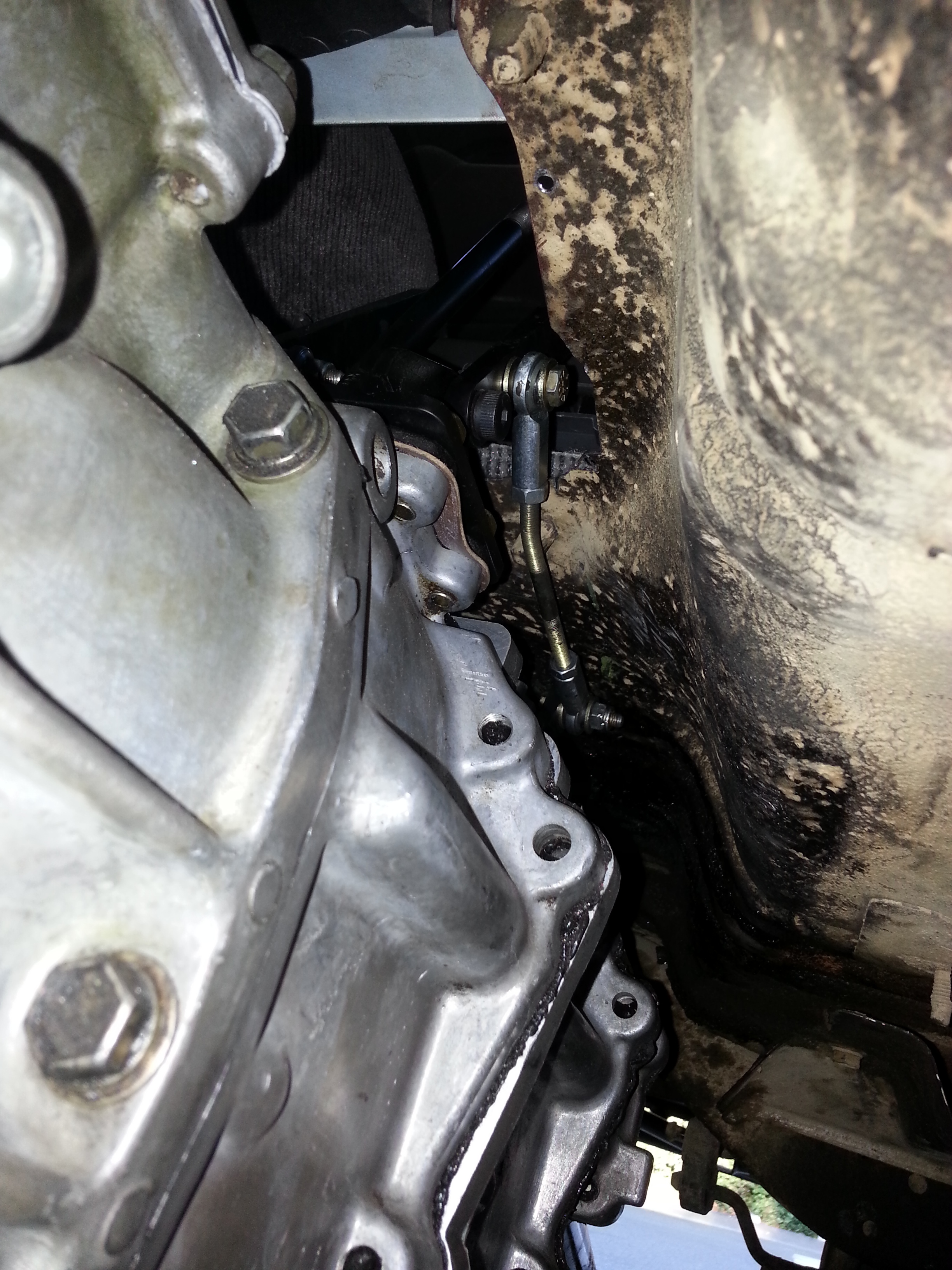

Proof of premature. Carnage! Lol....
More shots of how our works....
If you notice in the first picture , the passenger side shifter linkage has the hiem on the inside which automatically increases its difficulty of angle... I'm guessing Eric didn't want to cut anymore and I could see how it wouldn't fit as it stood if it was turned around how it was supposed to be as Rory intended it. As you can also see, it is right up against the tunnel and it's literally needing to be punched up along those lines to clear more (so I can keep the tunnels from being cut further back).........Kayyyyh? Suuuuperrrrr! Allllrighty then! Lol
