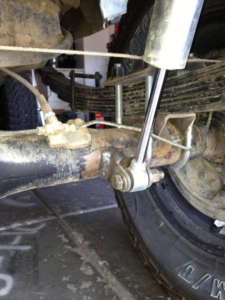

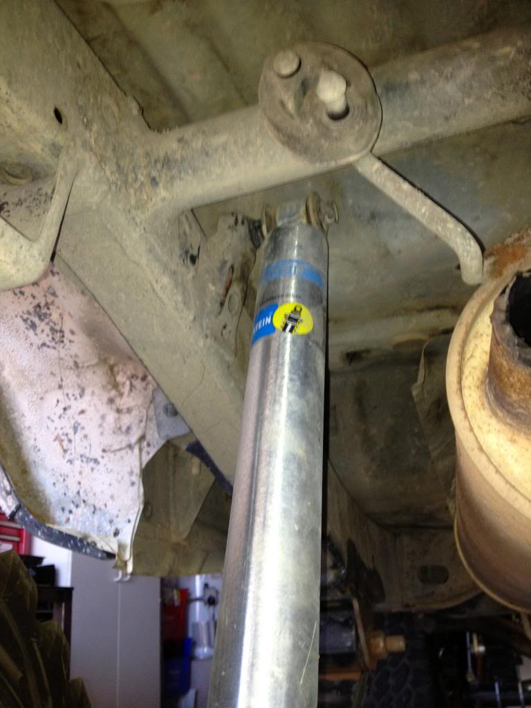

Hey man Loving the SAS. How much Lift do you have under that bad boy?
BTW is it possible for you to post up some pix of your rear spring hangers and where you mounted the shocks at. I just ran into a problem with my newly SAS'd 89 4Runner. and it'd really help me out if i could see how you welded/mounted your parts. figured your runner might hold the answer that im looking for.
Old Apr 17, 2013 | 04:44 PM
  #34
CHEEZE's Avatar
Joined: Mar 2011
Posts: 135
From: Nevada
I used the stock locations for the upper rear mounts. On the bottom rear I just rotated one forward and one backwards. I dont know if this is the right way to do it but it seems to be fine. I took it out to Johnson Valley right after I finished it and purposely beat the f out of this truck. It was off the ground a couple of times and put through its paces. I drove it back home to Vegas (250 miles) with the cruise set at 75 and it was fine. Its a 4 inch in the front and 5 inch in the rear. I was thinking about taking the bottom leaf out because it does feel a little top heavy off road.
Old Apr 17, 2013 | 05:05 PM
  #35
Redeth005's Avatar
Joined: Apr 2012
Posts: 2,817
From: Los Angeles CA
Cheeze thanks a lot. We Just found my problem. THE DAMN SHOCKS ARE TOO FREEKIN' BIG!

They are 12 inch shocks. I got the tg 4" in the front and 5" in the rear.
