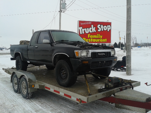

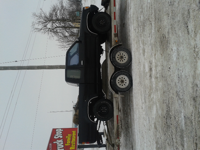

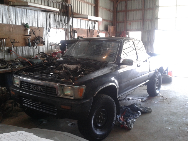

Well I picked up the truck today. Everything went to plan and hopefully I can get to work on it tomorrow. Here are some pics.

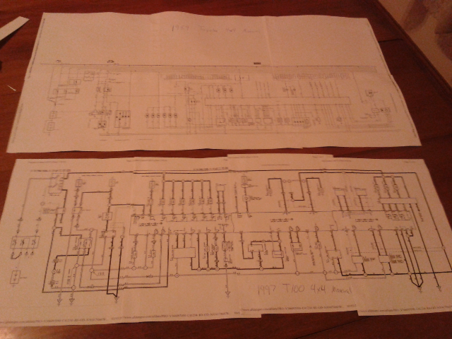

I got a spot cleaned out in my buddy's shop yesterday and started looking closer at the swap. I'm going to have to redo a lot of the stuff the previous owner did. Most of his work is pretty crude and really doesn't hold up to my standards. Oh well, that's the way these things go. I was able to identify the engine and ecu. It's from a 1997 T100. I went and printed off my wiring diagrams at work today and sat down for arts and crafts time tonight glueing the pages together lol. These 2 diagrams will be my bible from now on.

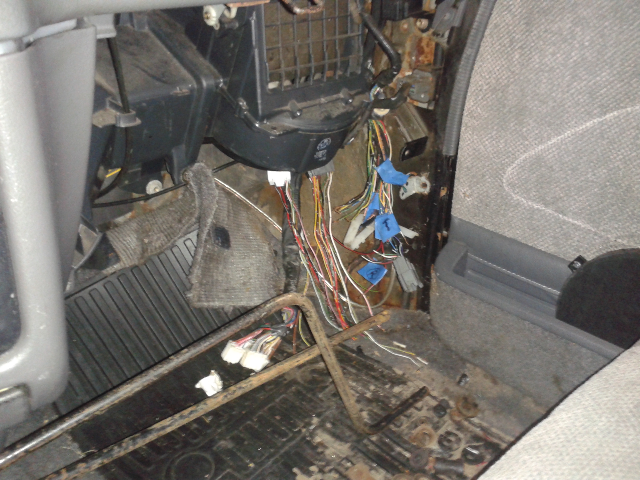

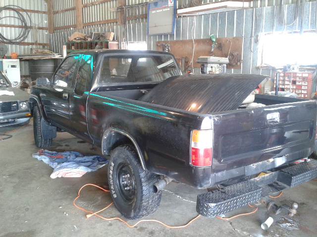

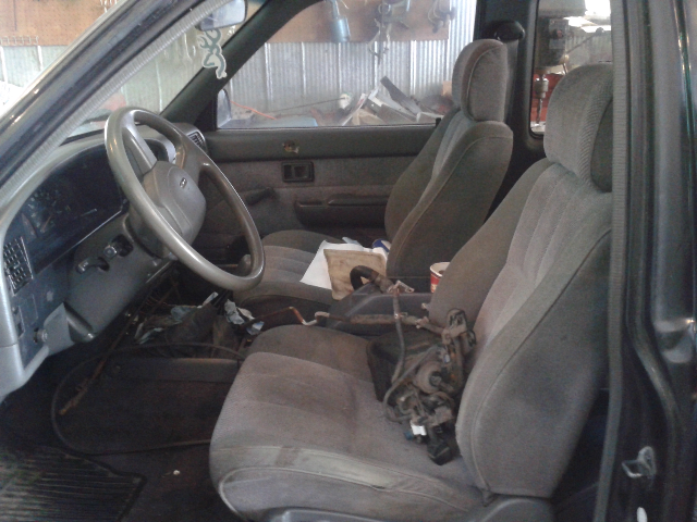

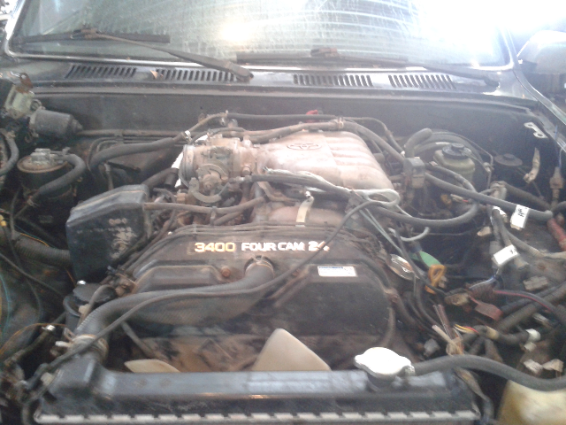

It was fairly mild today so I worked on the truck for a bit tonight. I really didn't get much done. I spent most of my time trying to sort out the mess. I realized I am missing the one connector for the ecu that I need to wire in so I have to make a trip to the scrap yard. I did get my alternator wiring done and got some other wiring sorted in thw engine bay. Here are some more pics of the truck.
Buggy's '89 pickup build!-forumrunner_20140311_204329.pngClick image for larger version
ID:	97029Buggy's '89 pickup build!-forumrunner_20140311_204419.pngBuggy's '89 pickup build!-forumrunner_20140311_204455.pngBuggy's '89 pickup build!-forumrunner_20140311_204559.pngBuggy's '89 pickup build!-forumrunner_20140311_204642.png

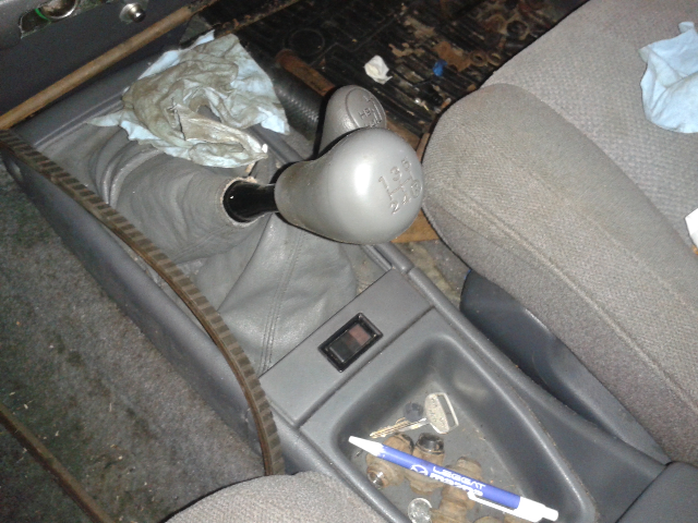

Buggy's '89 pickup build!-forumrunner_20140311_204918.pngBuggy's '89 pickup build!-forumrunner_20140311_204954.pngBuggy's '89 pickup build!-forumrunner_20140311_205037.pngBuggy's '89 pickup build!-forumrunner_20140311_205111.pngBuggy's '89 pickup build!-forumrunner_20140311_205145.png
Side note. Does anyone know what the switch below the shifters is for? Its factory three position switch that looks like its for a heater of some sort. Any ideas people?

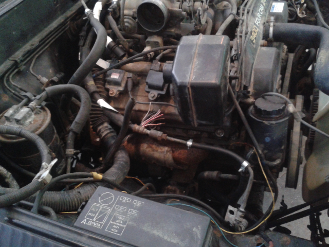

Yesterday was another decent day so I got a chance to work on the truck for a little bit. I checked the timing belt and properly hooked up the throttle cable. I also sat down and started to label wires on the engine side. My Rx-4 made a good work bench lol.
I am having trouble finding the diagrams I need to sort out the truck side of the wiring. Alldata's wiring harness and connector views are terrible and almost non existant. The previous owner already cut off the factory connectors too which really doesn't help. Does anyone have connector views or even a picture of the ecu and body harness connectors?

So this stupid snow here won't quit! I wanted to go the the junk yard to look for stuff I need yesterday, but we got 5" of snow overnight. Can anyone take a picture of their wiring at the computer and the harnesses behind the passenger kick panel for me?

After I had the truck running I noticed a smell of fuel. Sure enough I had a fuel leak back by the tank. I decided that being I'm doing a body lift anyway I just took the bed right off the truck. Good thing I did that. The sending unit was rotten, the wiring for the tail lights has been hacked up, and the box is pretty rotten too. Worse than I had thought. I have a lead on a good rust free southern box I may end up buying. As for the sending unit, the truck came with the tank and sending unit from the donor truck so I'm just swapping that assembly in.
