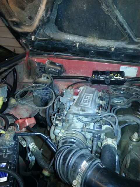

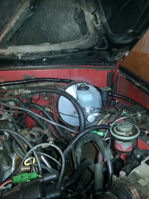

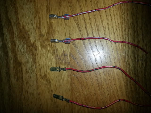

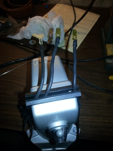

thanks, and you nailed it exactly, i hate having anything anyone else has. unique is the only way to build. heres some updates i decided to run all new headlight wiring from the fuse box out because the factory stuff is so thin and i want to run hids. also i wanted to move the factory wiring away from the radiator support to keep it out of water and keep it clean. so i took two factory fuse boxes with wiring and created one long harness that goes along the firewall with all new headlight wires to. heres some pics, its almost finished just need to tie in the passenger side headlight and attach terminal box
these are the original leads that plug into the fuse box
these are the ones i made
new harness along firewall, box will be mounted right around there tomorrow

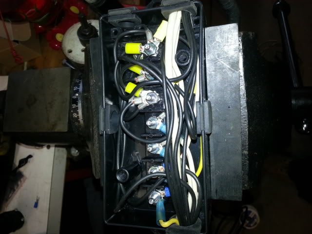

terminal box, four wires on the left are for the plug on drivers side fender well three on right are headlight high low and ground larger wire is the power feed off alt.

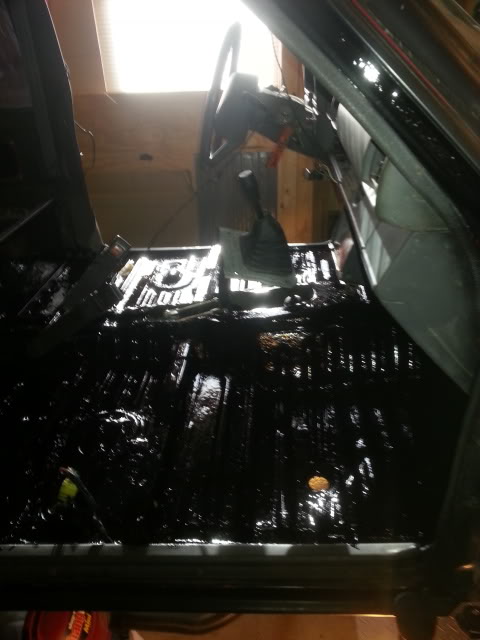

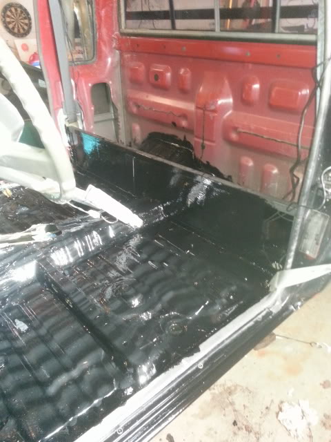

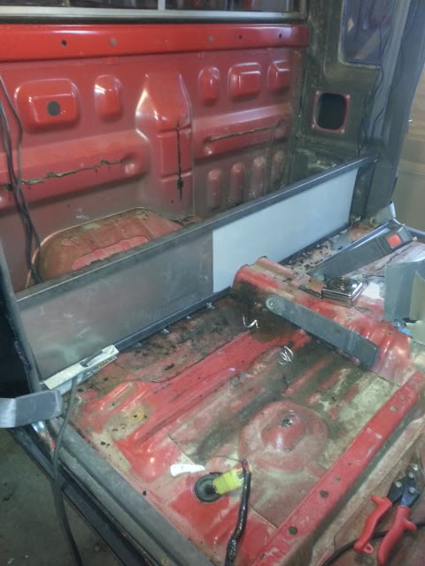

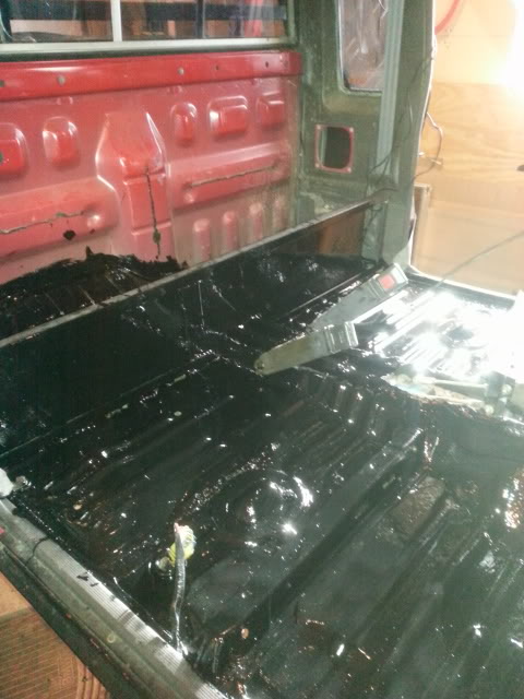

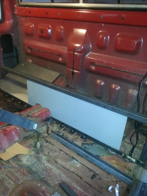

decided to start the storage box today and monsta line the floor.
here the start of the box all just basic angle iron, the fronts are furnace sides i grabbed from work. worked perfect for this, small opening on the driverside is going to be expanded steal for venting because the compressor will be in there.
then i sanded a ton, stripped off any lose peaces of the factory "heat shield" (most of the passenger side) and monstalined

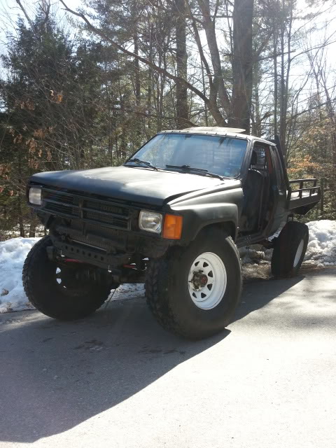

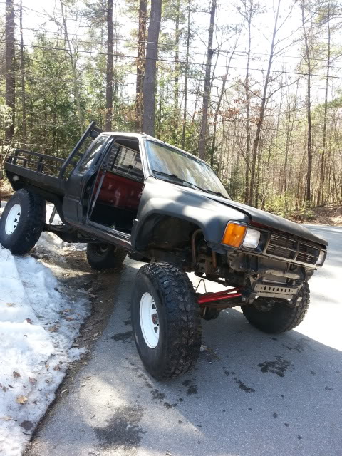

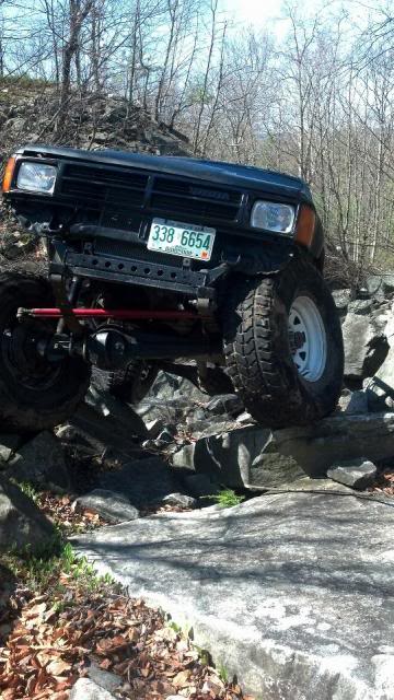

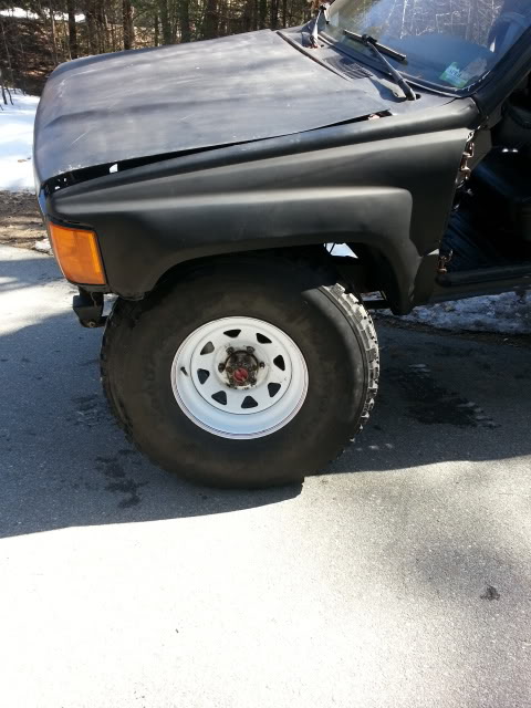

finally everything mechanical is done, registering the truck tuesday. next thing to do will be straighten bed and redo latter rack to add RTT

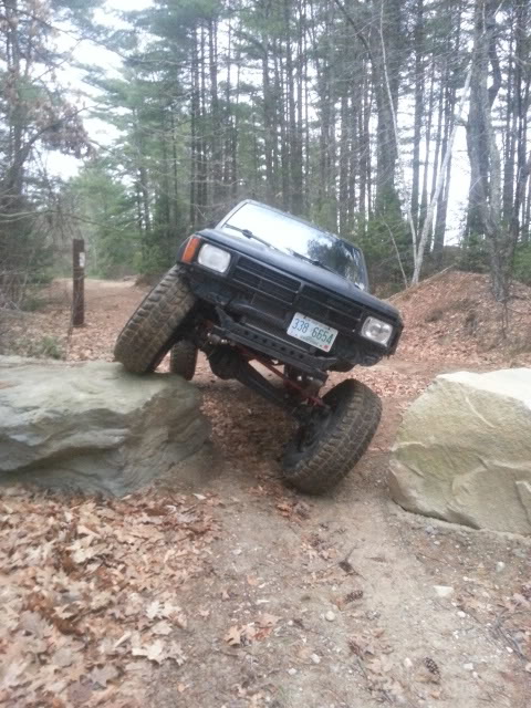

heres a couple little flex shots, front shocks and seats have been installed since pics

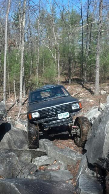

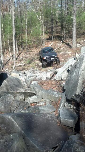

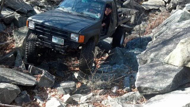

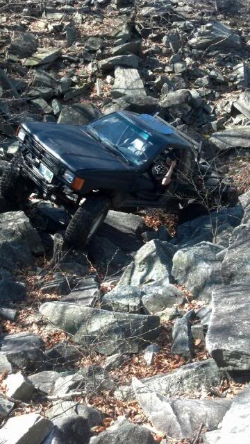

thanks everyone, here was today. pics dont do it much justice but you get the idea, lots of sharp pointy rocks

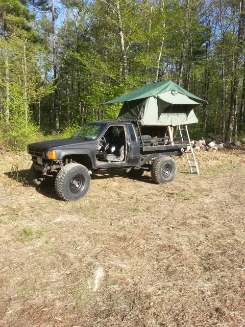

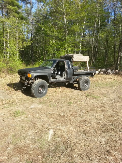

Here's the most recent. Also coming up on a week of sleeping in it
