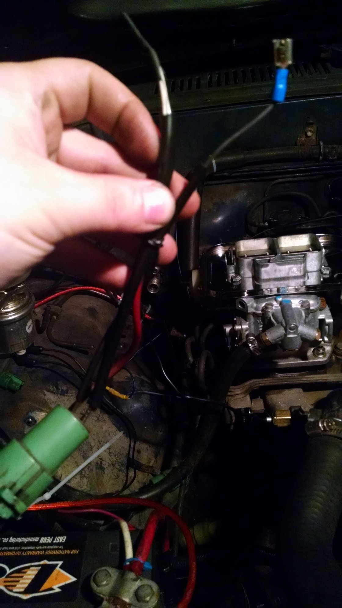

electric choke weber 32/36 22r
ok utah, so here is the electric choke hookup and here is a vid
my multimeter is on volts (dc) mine has a function button to change from ac to dc. For anyone that doesn't know a lot about electrical, like me lol, the car electrical is dc, not ac. I have the red probe in the (V) port and the black probe in the ground (com) port.
here is the plug i used, its not being used by anything currently, the previous owner had used this plug for the stock carb electric choke, but he used the wrong um... port? There are 4 wires that go to this plug, each wire is one of the 4 ports u see there. He had used the red wire, which is one of the bottom two which have 0 current when the key is on. I used my multimeter to check each one while the key was off to see if any of them had constant power, then checked with the key on
for my truck, both of the 2 vertical ports on the plug had 12v (DC) power when the key was in the on position and 0 when the key was in the off position, so i used one of those. I found the wire on the male part of the plug for that port and put a new connector on it
there is the male part of the plug, the wire i used that i made sure had 12v (DC) when the key is on and the new connector i put on it. So i plugged the male into the female (green plug) and hooked my new wire to the spade connector prong on the choke. Then instead of using the ground post on my battery, i used the carb as the ground when testing it with the multimeter. as you probably noticed, there is nowhere for a ground wire to be hooked up, only the hot. The carburetor is the ground.
and there it is plugged in, just use the hot (red) probe on that connection and put the black (ground, com) probe on the carburetor and turn the key on, the multimeter should read 12v(dc) I spent about an hour trying to figure out why i wasn't getting any current, i didn't switch my multimeter from (ac) to (dc)

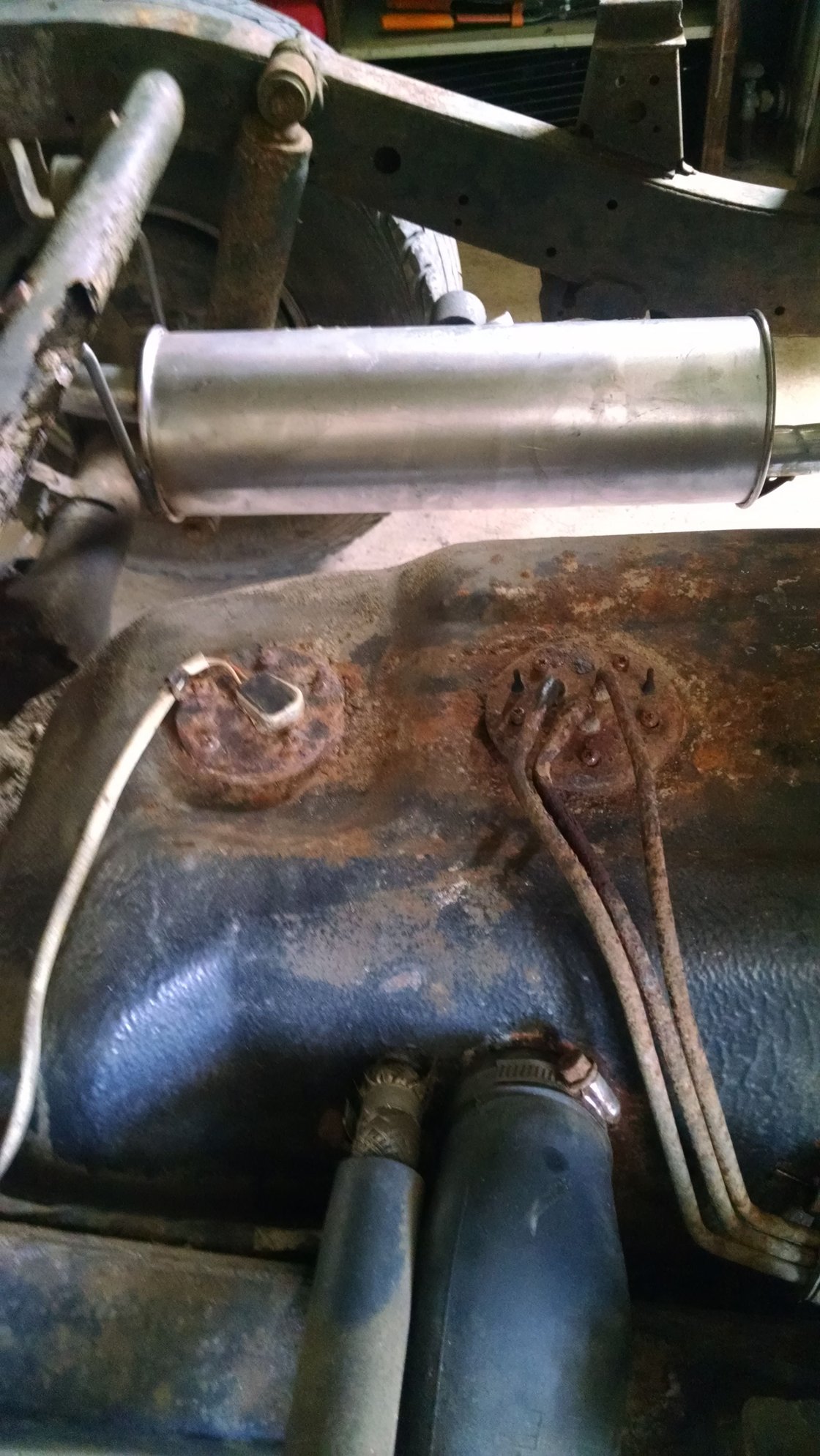

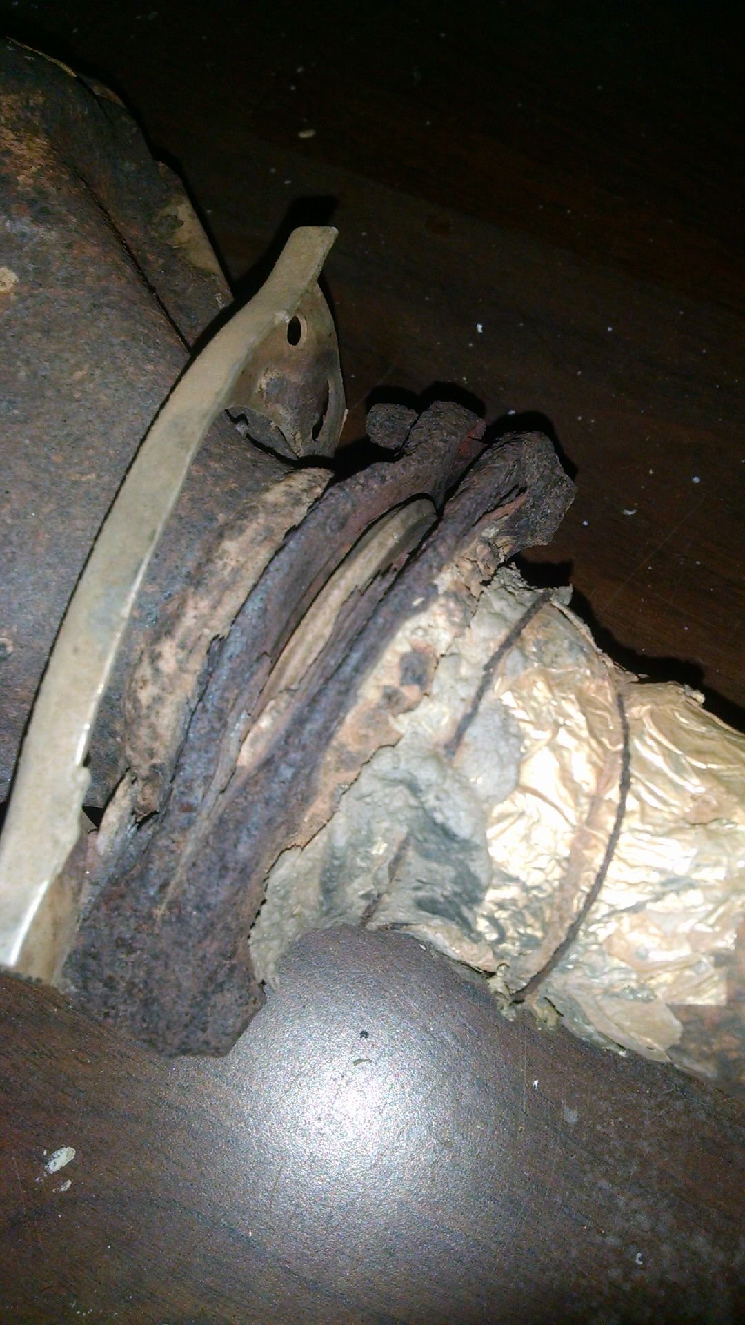

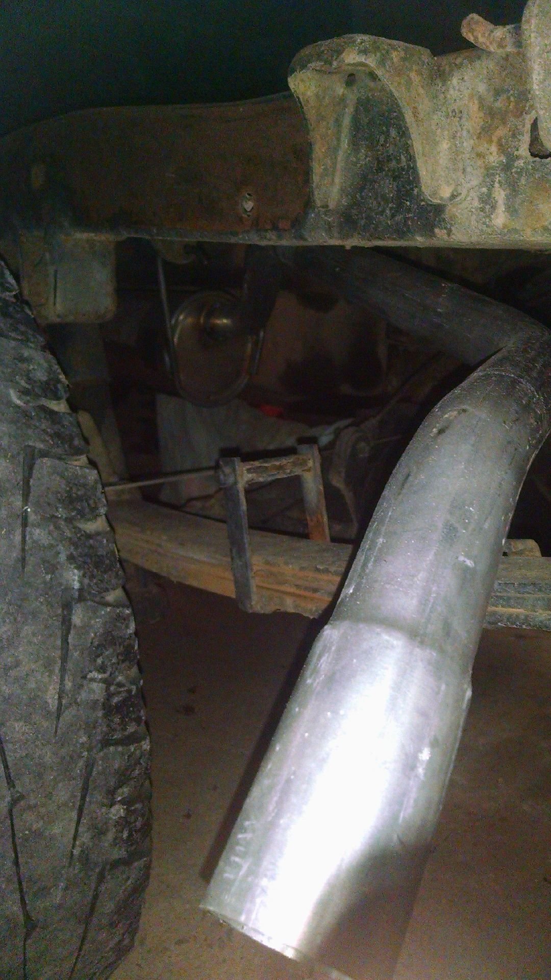

exhaust
Well i just got my new bosal exhaust pipe, muffler and catalytic converter from rock auto. It was about 200.00 with shipping. It took about 30 min to install, i had to grind the bolts off of the flange because it was just one solid piece of rust lol. I got the truck with the pipes that connect to the exhaust manifold and the cat converter and thats it, no muffler, tail pipe, etc... Here is the old cat and some pics of the new hardware.
the old catalytic converter rust bucket
pretty rough shape
shiny new catalytic converter from rock auto
muffler
is it ok to have the tailpipe between the leaf spring and frame? i have a few inches of clearance, i can get another photo if u need to see how much

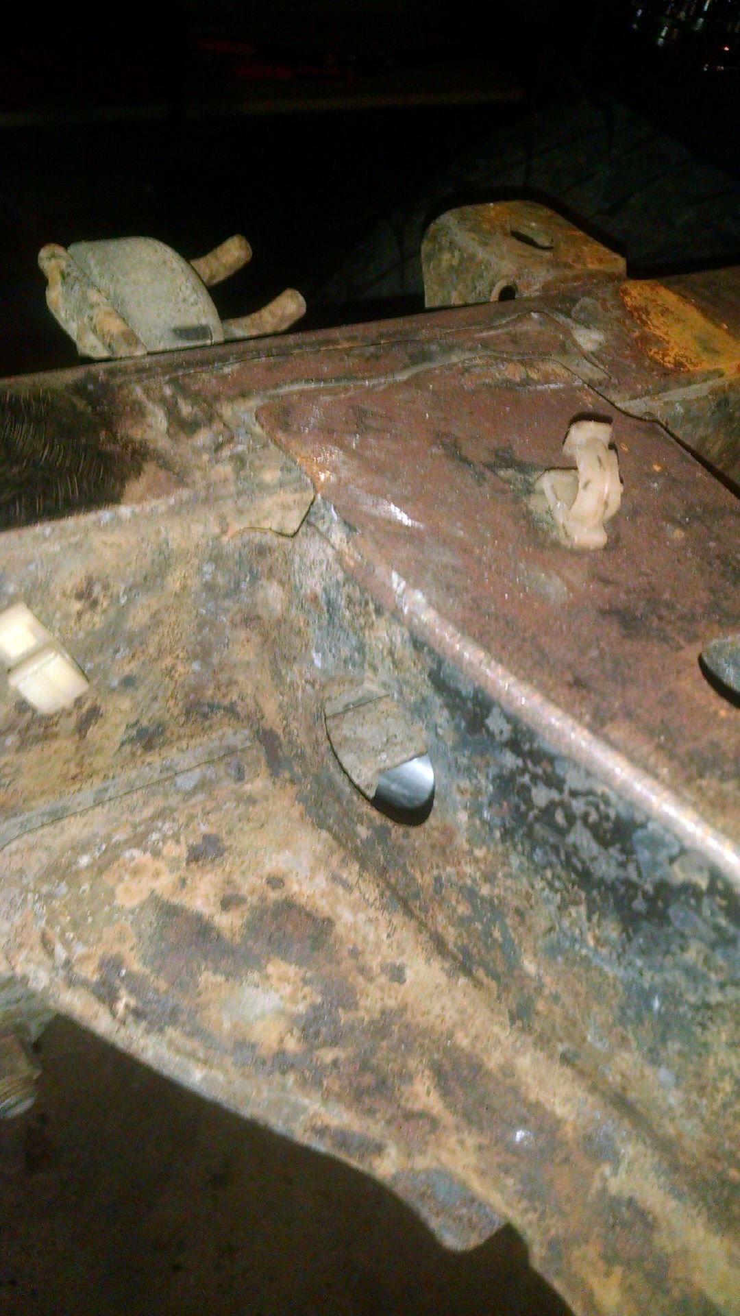

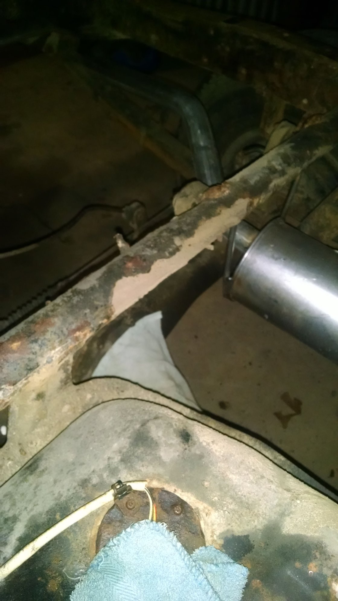

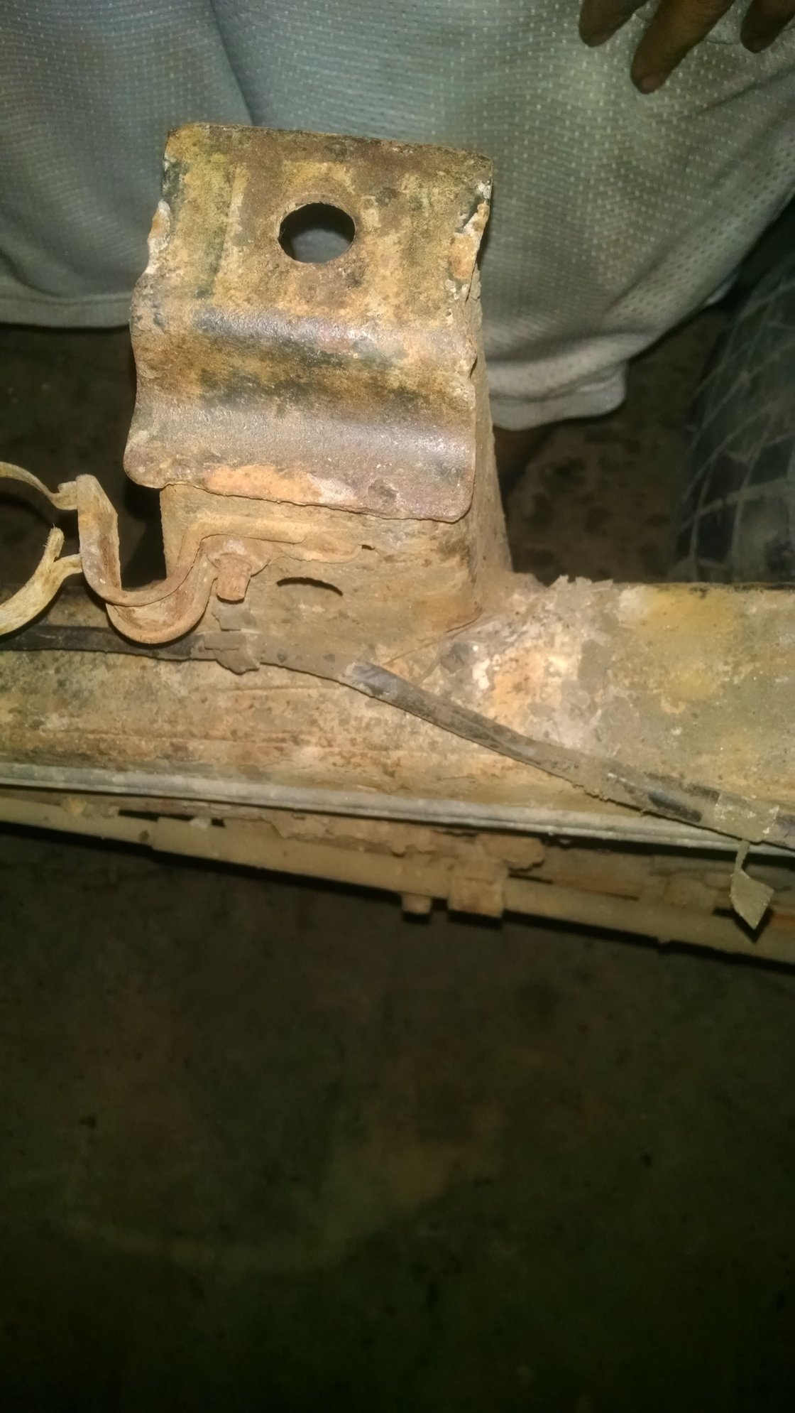

22r frame with rusted cross member

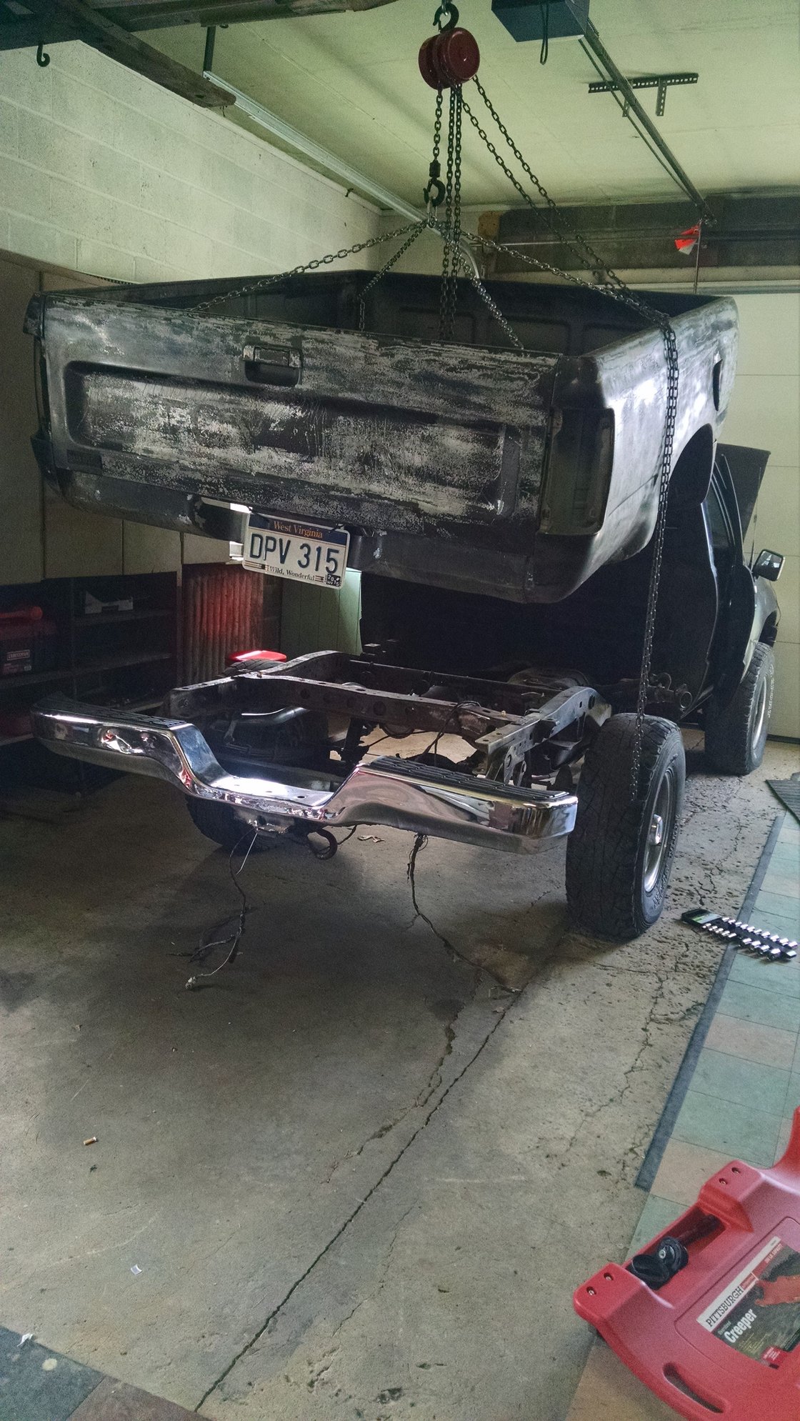

Well i got my new 1 ton chain hoist so i can finally get the bed off without having to call somebody. Its a big red hoist by torin. The frame looks really good for being an 87, but there is one giant rust hole on the pipe "crossmember"? Whatever the pipe is that holds the exhaust hanger and goes across between the frame. I have my new lincoln mig welder shipping tonight and i was gonna ask, should i cut the whole pipe out with a sawsall, or... clean the rust and get about 2 feet of pipe that has the inside diameter the same as the outside diameter of the rusted pipe and slice it right down the middle, wrap it around the hold of the rusted pipe and weld the seams. I'll take input from anyone who knows more about this stuff than me, which is probably everyone lol. Thanks guys.
here is the hole, its bigger on the other side.
here is the other side
thats pretty much what the rest of the frame looks like, just very minor surface rust. I got 4 bottles of 3m undercoating
love my new hoist <3

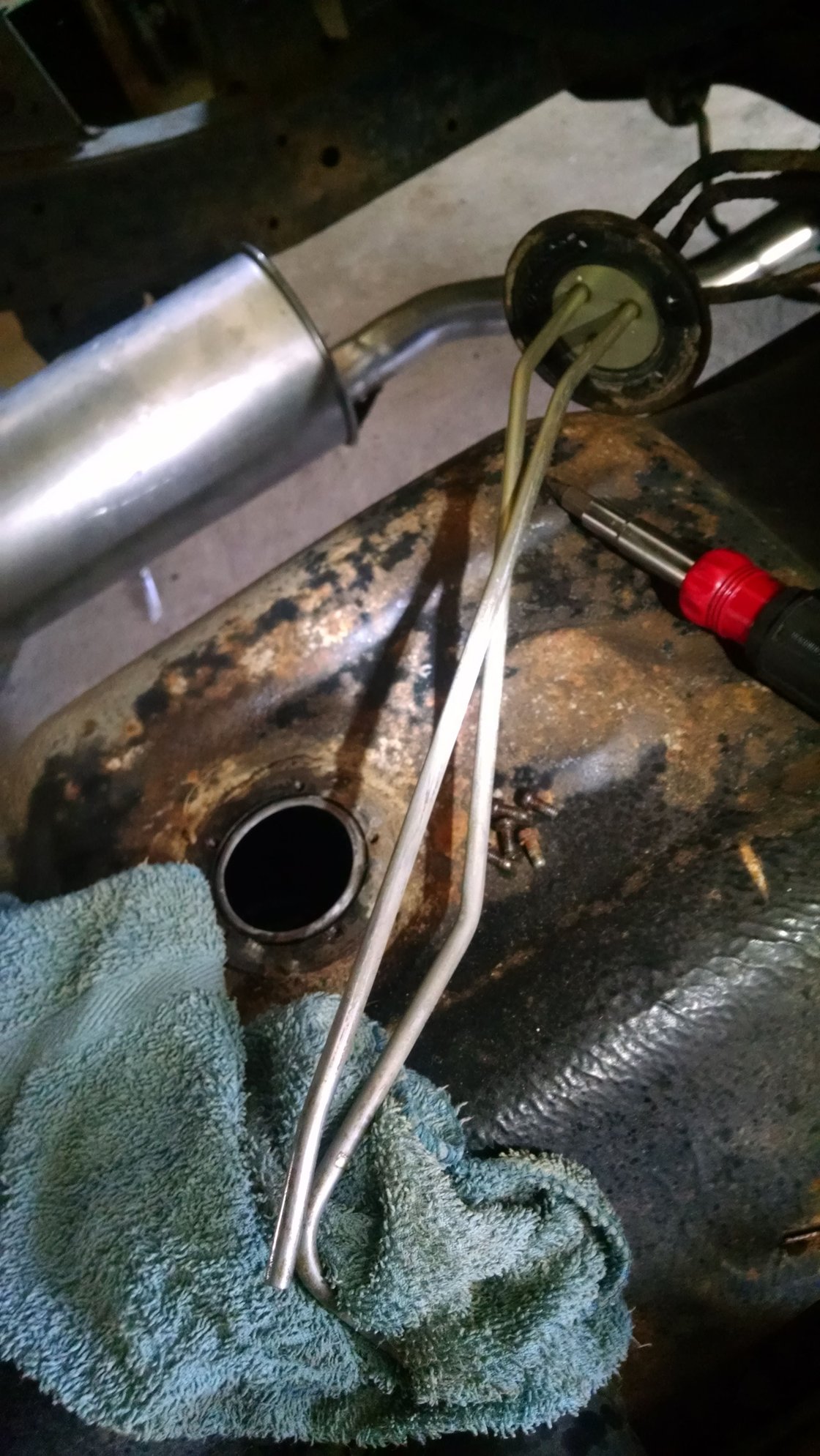

really hoping i can find another gas tank lid or whatever with nice, new steel tubing, the inside looks great but this... f that, look how nice it loos like under the lid

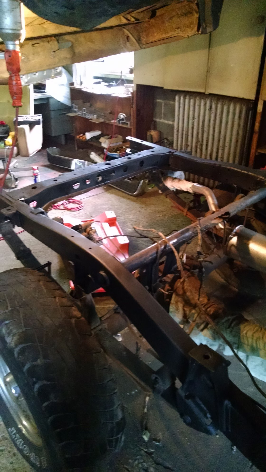

My frame now...

Your frame cleaned really well. I have seen people replace the pipe that runs across it. Frame looks 100 times better. Also looks like you are taking care of the spare tire carrier while you have easy access to it and working on the fuel tank all at once is a good idea as well. If I get a carbed truck, I think I would relocate the fuel filter to a better area like under the hood if it was me. Great job!!!
