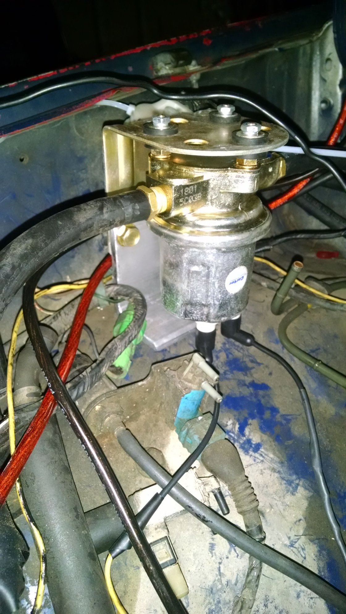

I got rid of the old fuel pump. I read that the weber 32/36 needs around 50-65 gph and my fuel pump, when i took the hose off the carb to fill up a gas can, there was little more than a trickle. Definitely not the gph my carb needed. This was probably part of my issues driving the truck. Anytime i gave the throttle little more than a slight push, the truck would try to die so i started out on the highway doing 50 mph and after about 30 min, i was down to 10 mph. I had to drive from west virginia to pa like that, a 2 hour drive took about 9 hours. I think i was getting vapor lock also because the old owner had the fuel line sitting on top of the upper radiator hose.
my new carter fuel pump

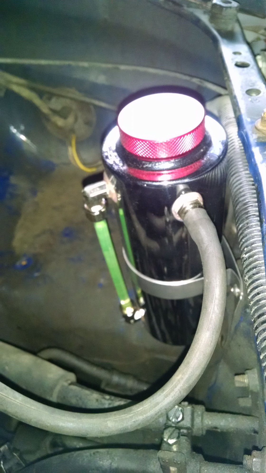

When i picked up the truck, there was no overflow tank/resevior, and the small hose coming off of the radiator was plugged with a pencil. Thats probably why my heater hose blew up and threw coolant all over my engine bay, thank god i was next to a truck stop. I called my old man, he's like "a pencil !!!!!!!" so he told me to take it out and get water and take it easy. I did, and then i ordered my new tank

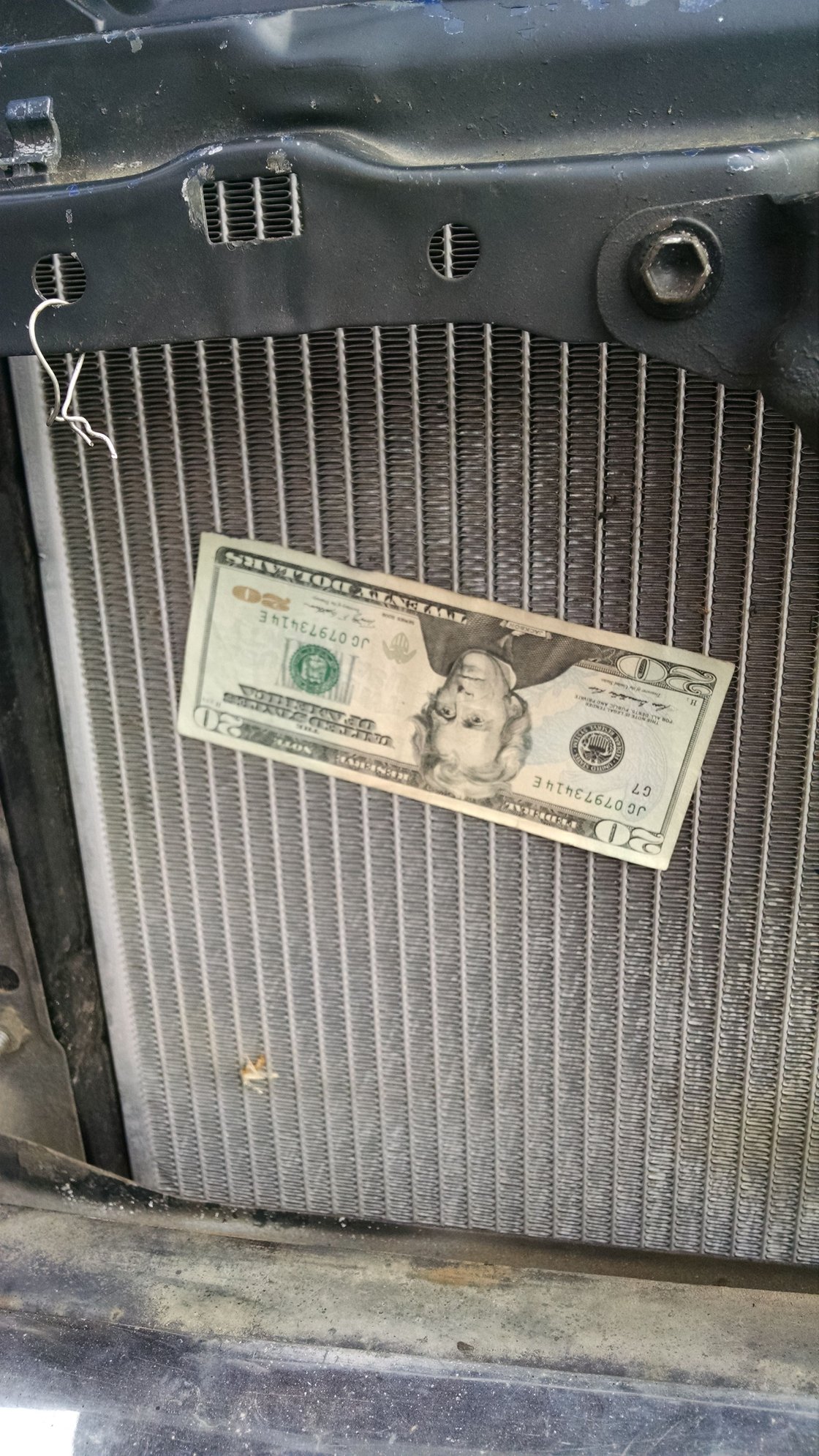

my buddy told me i needed a new fan clutch and a fan shroud. He tried his "dollar bill" test by holding a bill against the grill to see if there was enough air moving to keep the bill sucked to the grill. There wasn't, but we got both of those things installed and now the dollar bill test is successful.

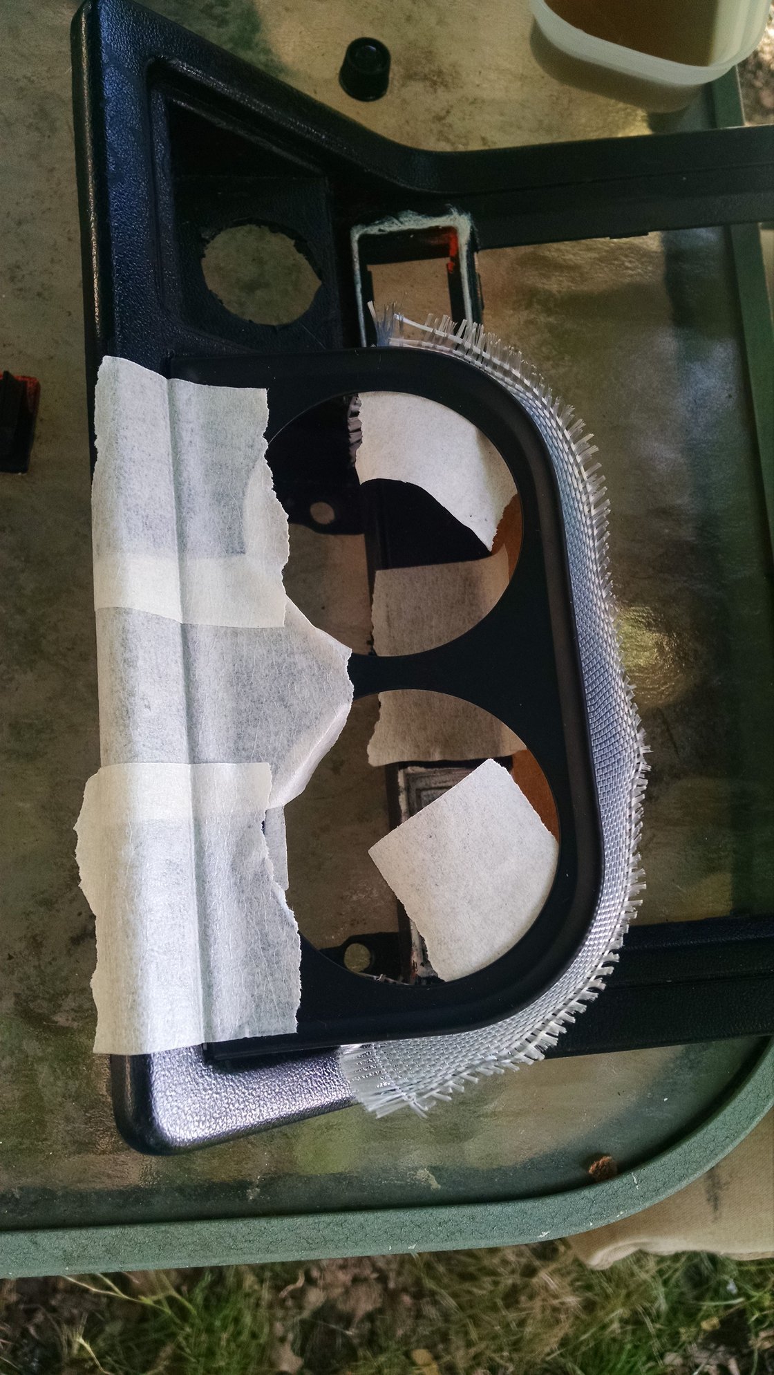

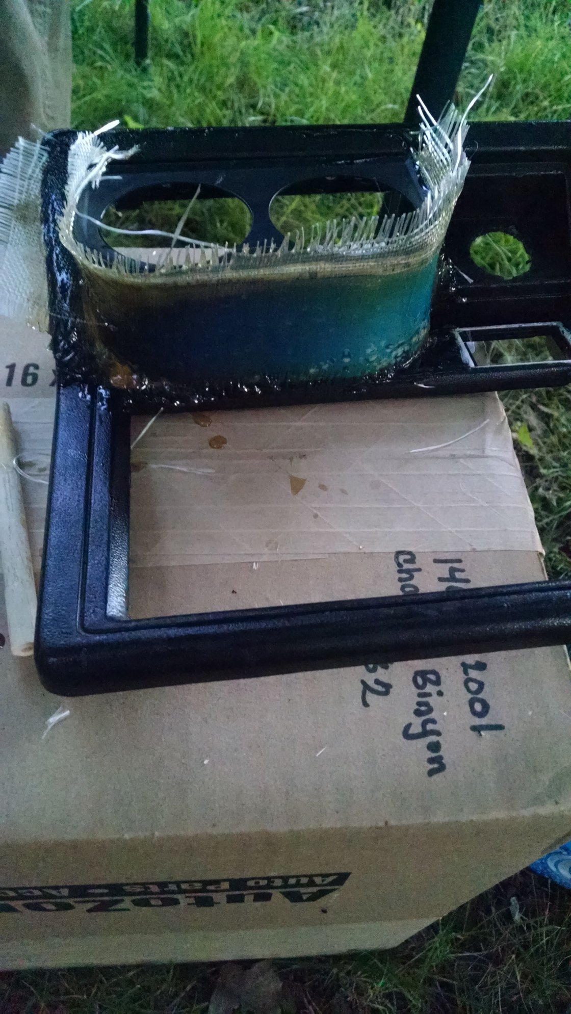

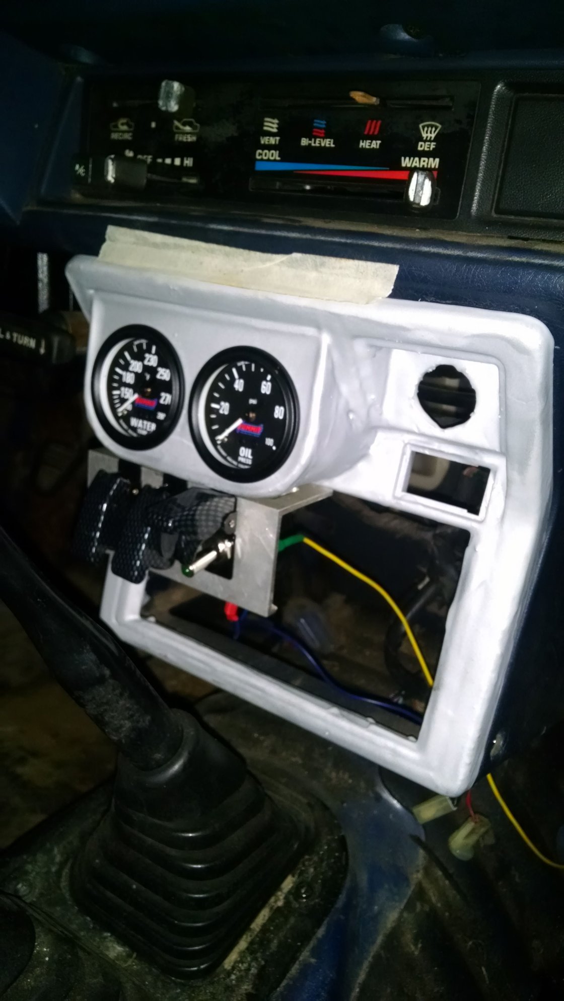

So, i'm still weary of overheating, although he said its not and running fine, no vapor lock, plenty of fuel, new carb and a broken temp gauge and gas gauge. The gas gauge i'm gonna check when i take the bed off. Oh ya, the fuel issue was partly due to a cheap pump and metal fuel line was blocked up. So i bypassed that line and bought 25 feet of fuel hose and now it works great. Also ADDED a fuel filter, i found my filter sitting on top of the frame by the gas tank, disconnected and not even attached to the truck. Anyway, i bought an after marked water temp/oil gauge from summit but didn't know where to mount it, so i did some fiberglass work and added the new bracket to my stereo face plate thing. heres some progress photos.
i used a bud light box for the support behind the cloth
with the lights on, i got 3 toggle switches from amazon that light up

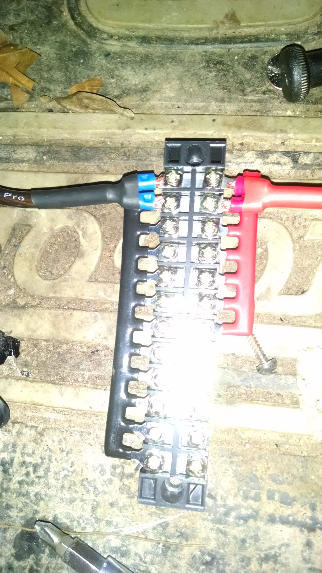

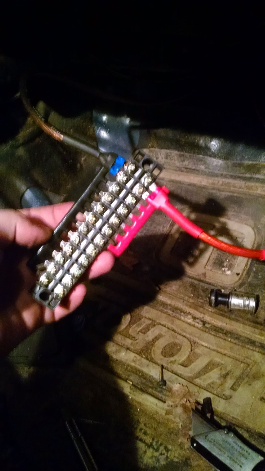

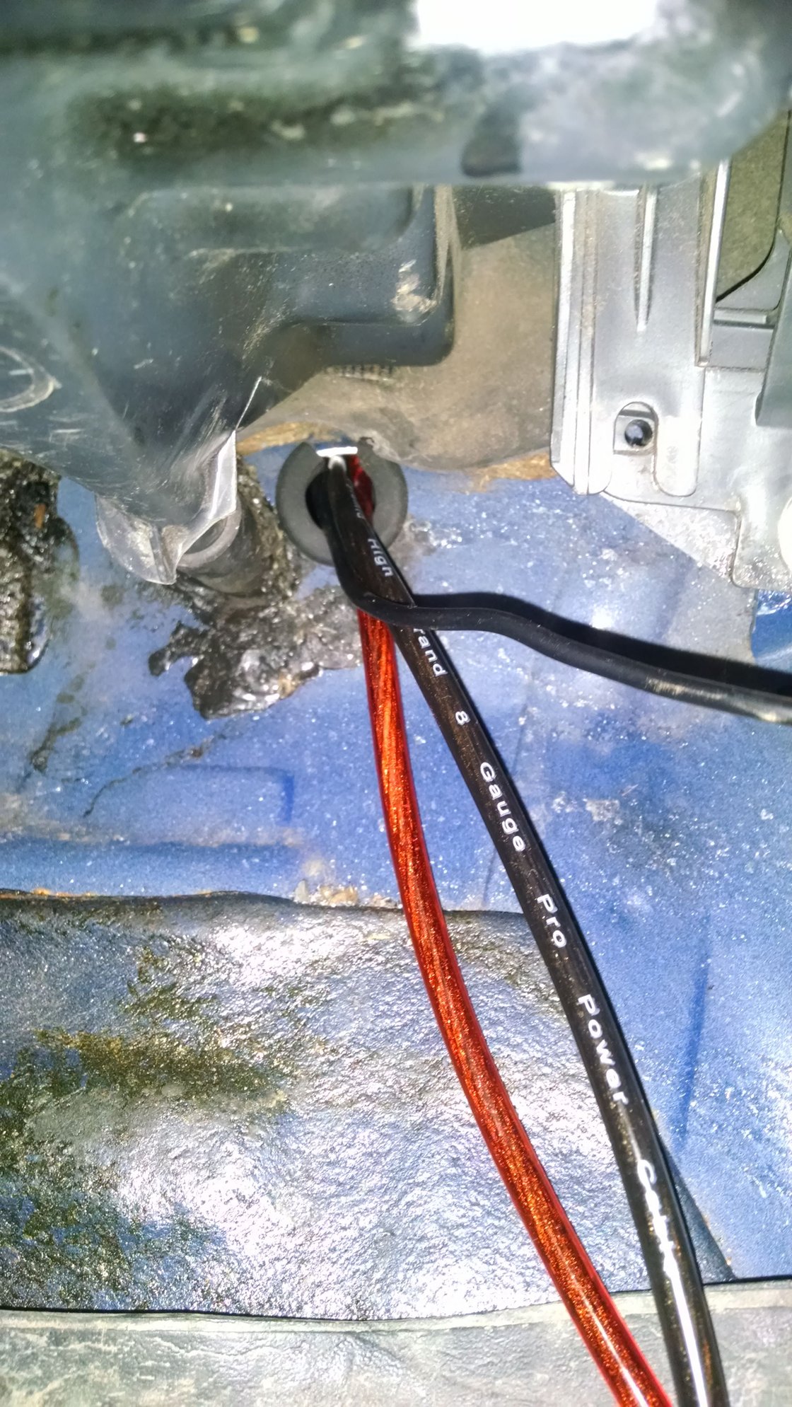

My dad gave me a good idea and said all the wiring and stuff would be cleaner and nicer if i got a power distribution block and ran a power and ground straight off the battery with some nice gauge wire. I haven't finished it yet and i still need to hook up the separate fuse block i got with it. OMG i messed up big time too. This is how i set it up first
i also bought those customizable little tab things to distribute the power across as many of the terminals as u want.
this is on the passenger side, next to the ac pipes i think

I'm sure anyone that knows about electrical can see my problem, i was so sad. I hooked up the battery and smoke started coming out of my cab. I quickly disconnected the battery and investigated. I burned the wire pretty good and the terminals got pretty hot. As u can see in the pic, the terminals on the hot block across from each other are hooked up together, i saw the plastic divider going down the middle and didn't even think about it.

i could have hooked it up differently, maybe used the first 5 for ground, and the other 5 for hot, but they would still be too close for comfort so i used a separate block for hot and ground
BAD!!!!
better
