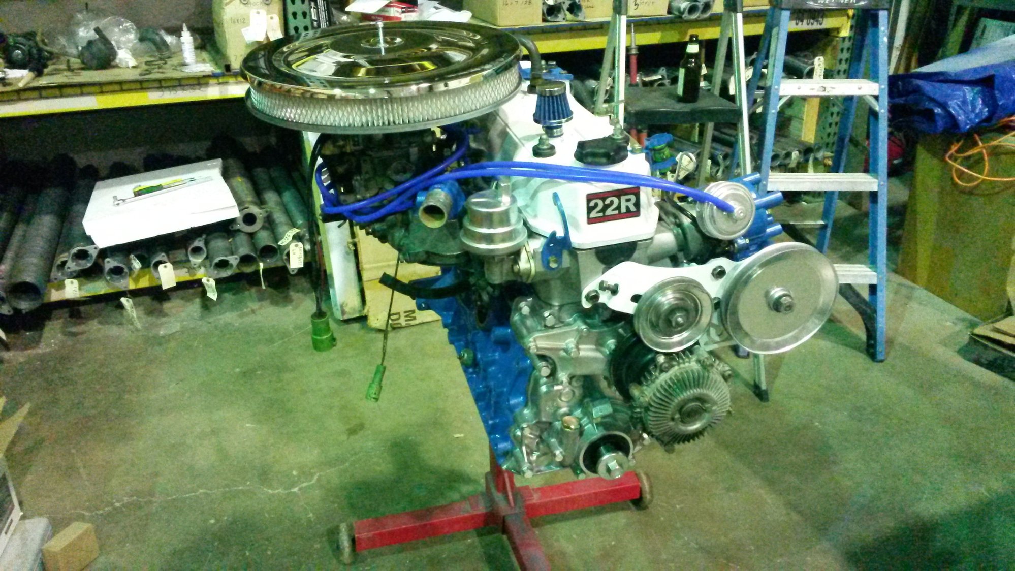

And that's how she sits now. Picked up the blue silicon vacuum lines from Summit. With eliminating that steel vacuum line setup that sits along side the intake it was a little challenging making sure that whatever system I'd be keeping is hooked up correctly still. Couple of t-fittings solved that though.
Saturday I should be pulling the old motor out, which has been stripped down to just the block and head now. I need just a few things off of it to put onto to this one and then get her dropped in. More pics to come as that takes place.
