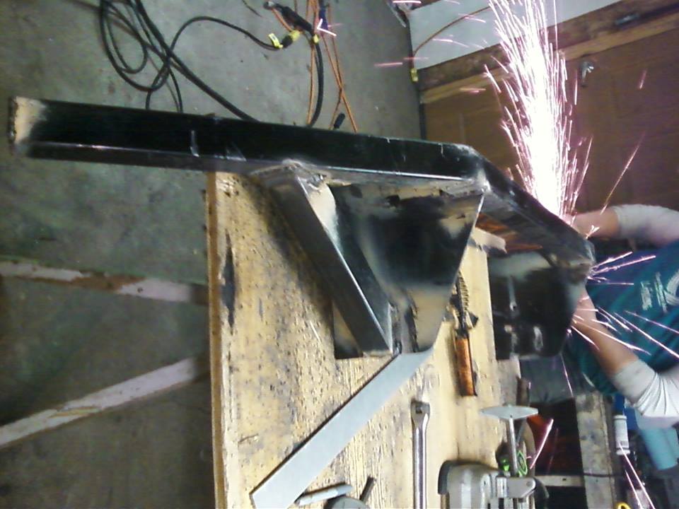

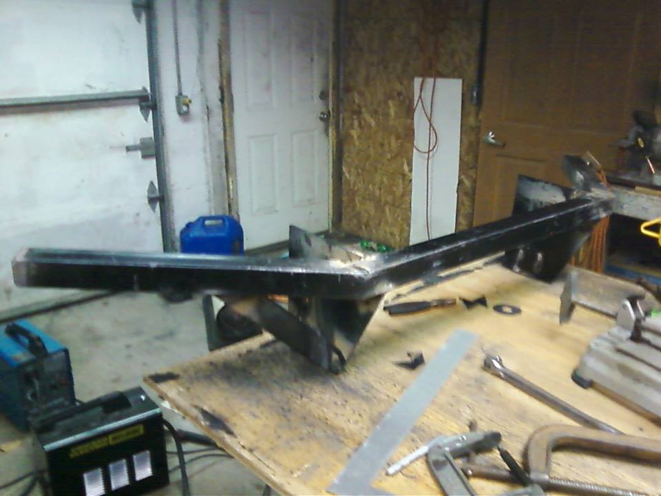

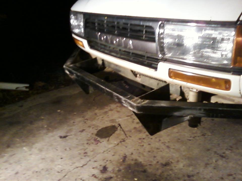

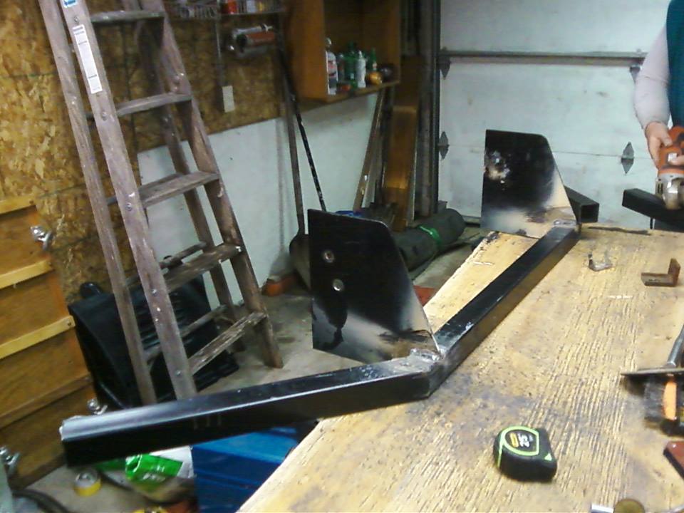

A friend of mine has been bugging me for 2 weeks now to build a bumper for his FZJ80 cruiser. He said he would give his stock bumper to replace my broken bumper on my cruiser. I said DEAL!!! Well last night he came over with steel, a welder and an idea of what he wanted. So we cued the music and got to work....

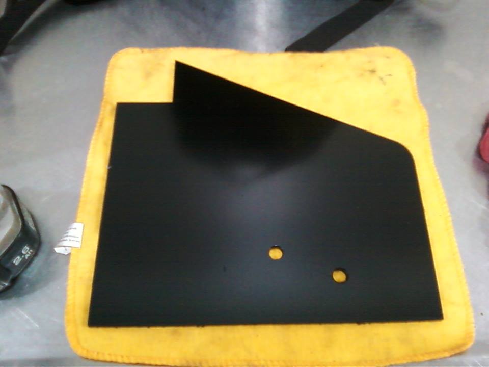

His dad made these mounting brackets at work:
angle set, and brackets welded:

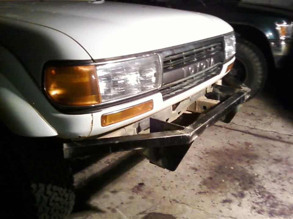

first test fit:
Adding the wing support:
Final bolt up:

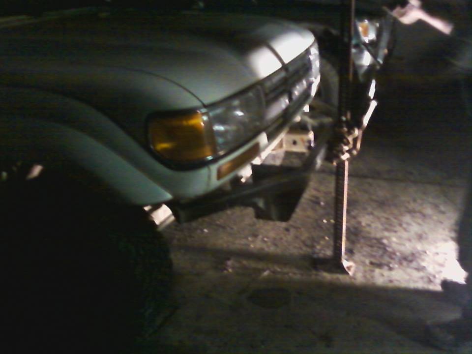

testing its strength:
We are going to put some diamond plate on the top and a winch plate on the bottom. The cruiser had 6 (yes 6) mounting points on EACH frame stub end. 2 on top, 2 on the side, 2 on the bottom. the plan is to get a plate and bolt it to the bottom on the frame and bolt a winch to that plate. Then weld the bottom winch plate to side bumper mounting brackets for a beefy bumper. When we jacked the cruiser up by the middle bar with the high lift, the bar never flinched. The cruiser ways 5800 pounds, fyi. the mounting plate is 1/4 inch steel and the tube is 2x2x1/8.

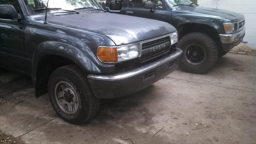

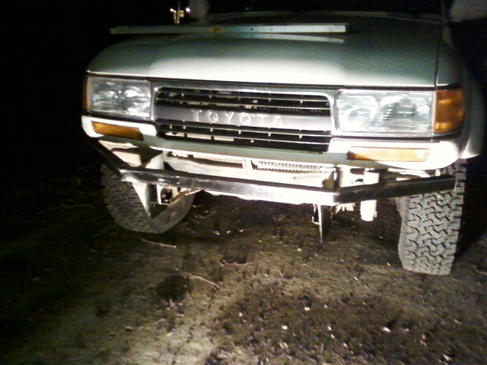

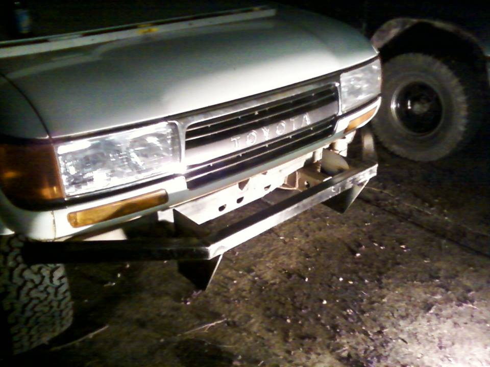

Today I believe I have finally conquered the battery drain that was plaguing the Cruiser. It was the voltage regulator in the alternator. I had replaced the alternator on July 4th weekend from AutoZone. It is possible that when I replaced the battery cables and fusible links that I shorted out the regulator. So I am cautiously optimistic that I have fixed that very troubling problem. While I was at it, I replaced the bumper. It looks much better now.

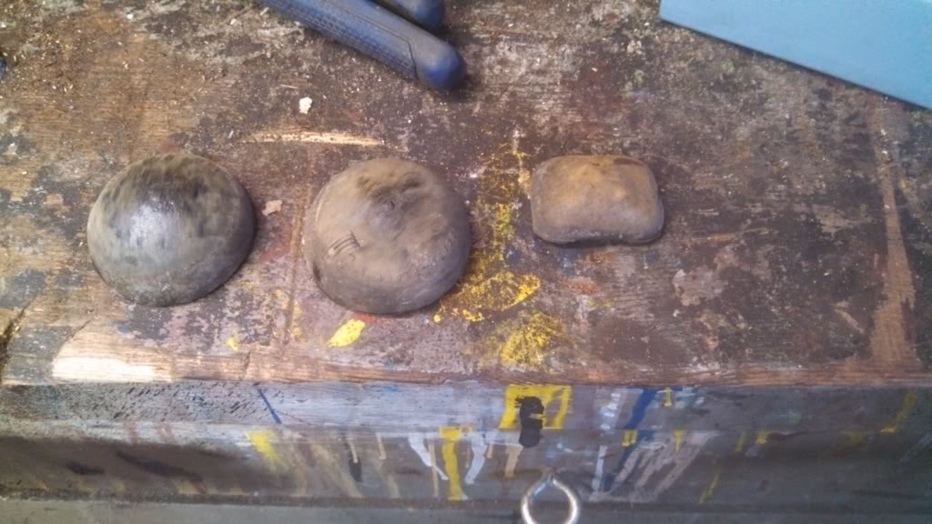

I also worked on my truck a bit today as well. I put some rubber matting in the fender wells and gave the body seams another good whack with a 8 pound sledge hammer. I also cut my bump stops in half to allow some more travel. Here is how much I cut off.

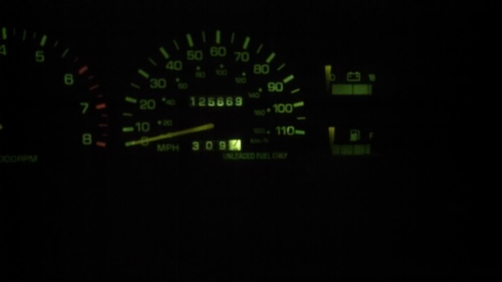

So today I took my truck and my boys on an adventure today. I drove 3 hours south to go to the Indianapolis Colts vs St. Louis Rams in the new (to me) Lucas Oil Stadium. This was my first ever NFL game. So I took off at 8:45 am with my boys in the truck and starting driving. I filled up the truck with 93 octane in South Bend which is about 20 minutes from my home. I drove down to the Stadium, went to the game, and drove all the way to my house on 1 tank of gas. It was 309.7 miles. I was pretty impressed, especially with the new 33s.
I set the cruise for 67 mph for most of the drive. The truck was purring a 2750 rpm and did a great job. Never skipped a beat. I was very pleased. This is the longest I have driven the truck in one day.
