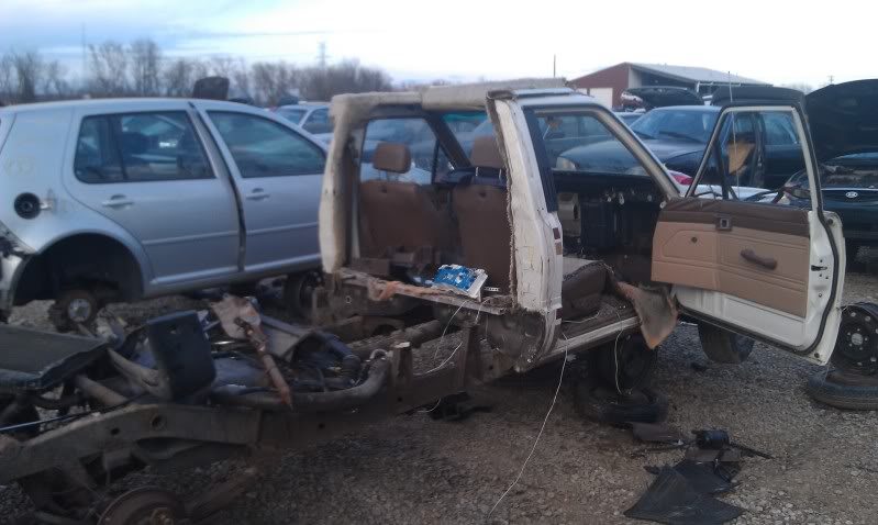

So looking through the junk yard I found a couple 22re motors. The best one I found came out of an 85 toyota camper. Only had 92k on the clock.

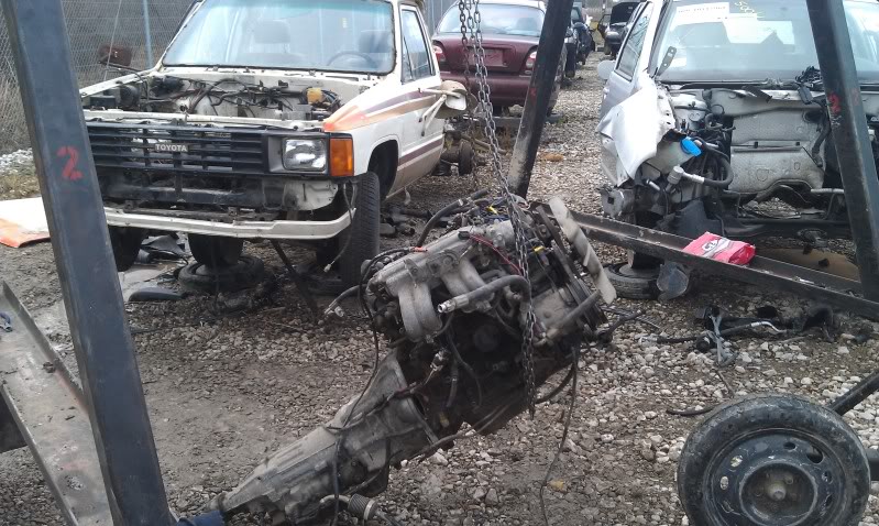

Took two days of work between my buddy and I to finally get it out. The first day was nice, about 50 degrees and sunny. The next day not so much. It rained during the night making it really muddy and cold. It started snowing about the last hour we were there.
Pulling the actual engine out didn't go a smoothly as I had hoped but we did get it done. The rear engine lift point snapped off so we had to wrap the chain around the exhaust manifold. And no matter who hard we tried the tranny would just not let go. ended up pulling the tranny out with it even though all the bolts were out.
after picking up the end of the tranny when the engine was up in the air like that and smacking it against the ground a few times it finally let go.
After a few cold and muddy hours and 150 bucks I had my engine

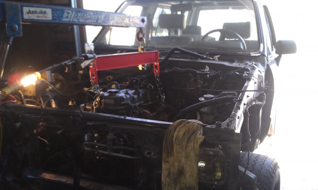

Engine removal:
Clear on both sides and labeled all the vacuum lines and everything to be able to put everything back right.

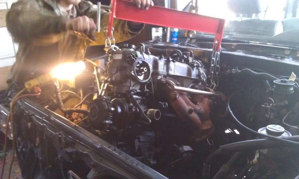

Rented the engine hoist and bought a load leveler from harbor freight.

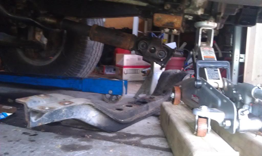

put a jack under the tranny and remove crossmember

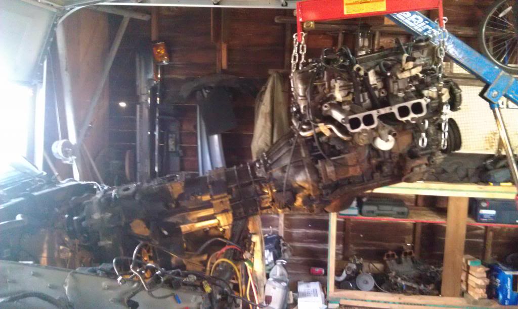

Unbolt engine mounts and up she comes with the slow process of giving the engine hoist a few pumps then cranking the load reveler and repeat. I would surprised that pretty much all they weight of the engine and tranny is supported by the rear engine lift point.

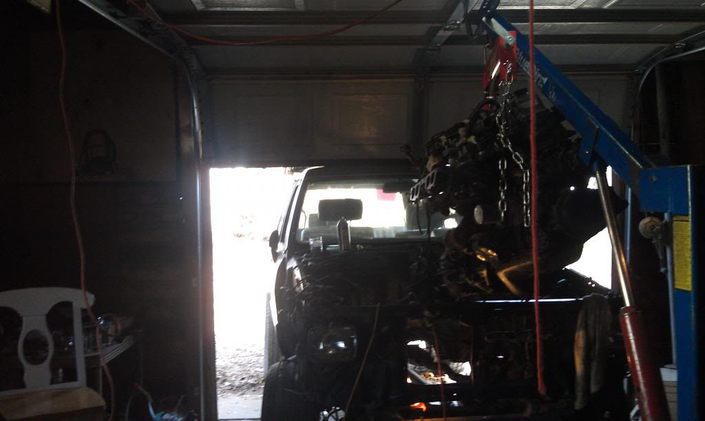

To clear the grill I had to put down the garage door as far as i could and had just enough room to raise the hoist.
