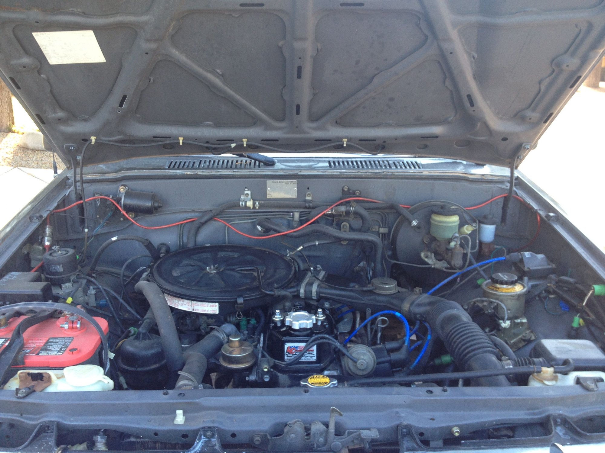

What I am starting with.
So, this is my current rig, it is an 87 Toyota Pickup 4x4 22r with california emissions setup(bleh). It has had a bit of a life before my dad got it, and then my dad did some stuff, and then I got to work on it after I got it from him. I bought it from my dad sight unseen, he had it for about a year or two before I bought it, so he had already done some work that it needed. Anyways, he left the interior alone, so that was pretty nice condition when he got it. He painted it, had no body damage or rust, which was awesome for a truck he bought in Colorado. It had 117k actual miles when I bought it from my dad, but the previous owner clearly did not understand how to do fluid changes, since the motor needed to be replaced, and the tranny was crapped out, and the carb was junk. My dad tossed in a used motor, replaced the transmission with a used one from a 90 pickup, and he stole the carb of of his 83, and tossed it on the rebuilt motor. It came on 31" tires, from a hilly area, and the gears were never changed, so probably not the best for the truck. Anyways, I had some stuff I needed to do to get it "done."

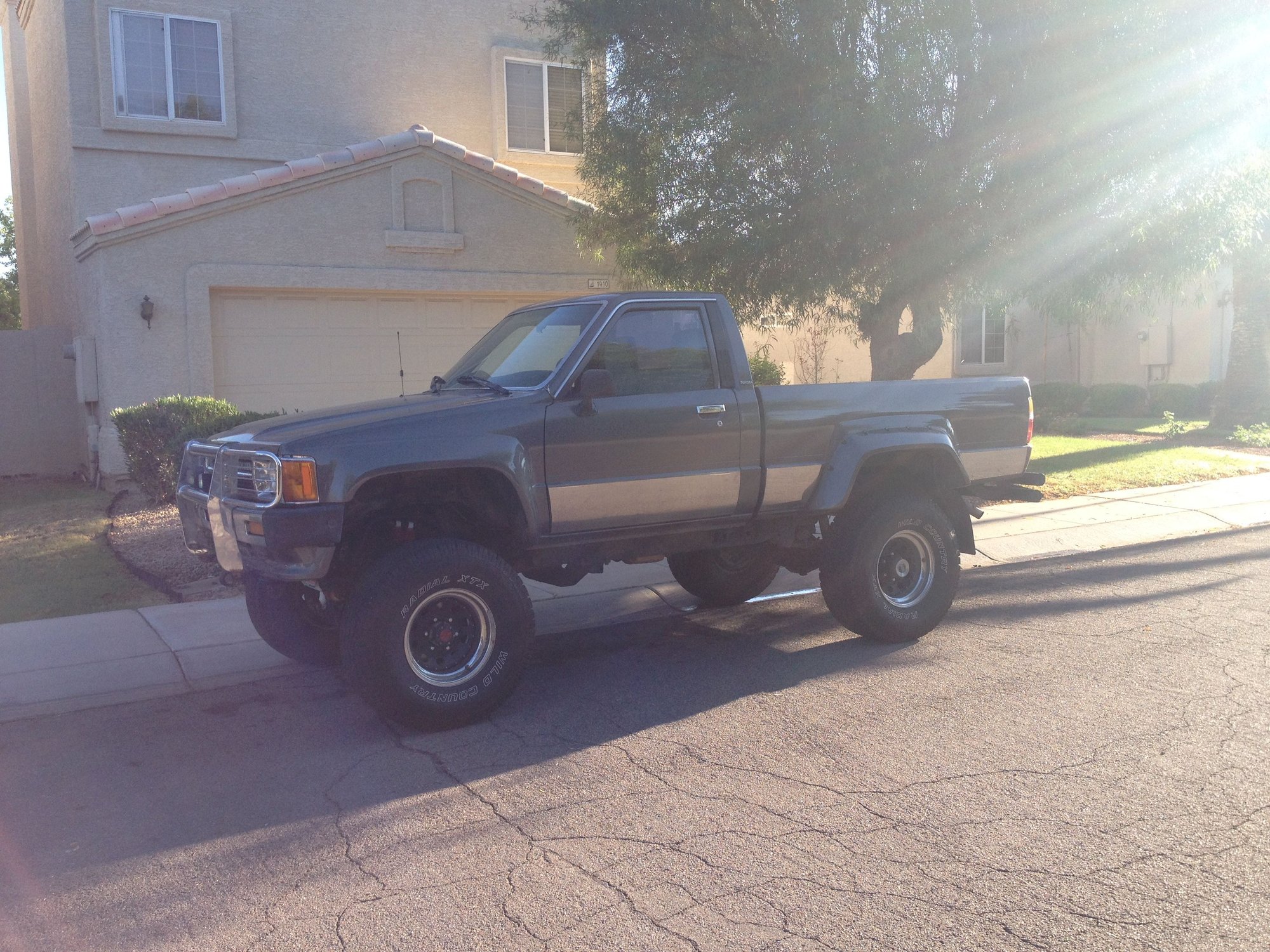

I had gotten to work really quick in making some small cosmetic upgrades, since she seemed to be in good working order, you know, if it ain't broke, don't fix it.

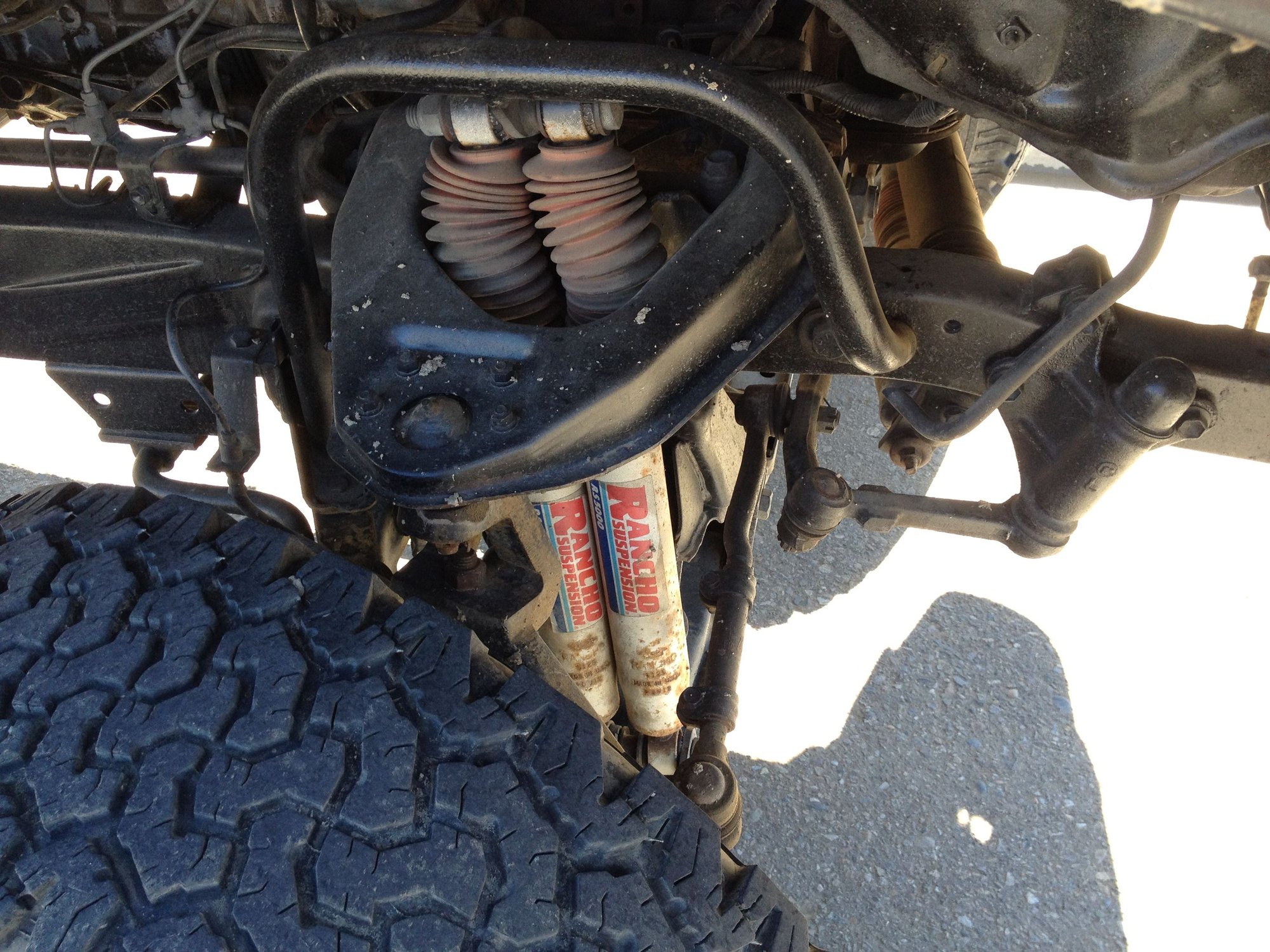

So the truck was mostly stock, except the suspension, but oh well, I dont really have a desire to change that anytime soon. The kc lights looked dumb so don't worry, they are removed.

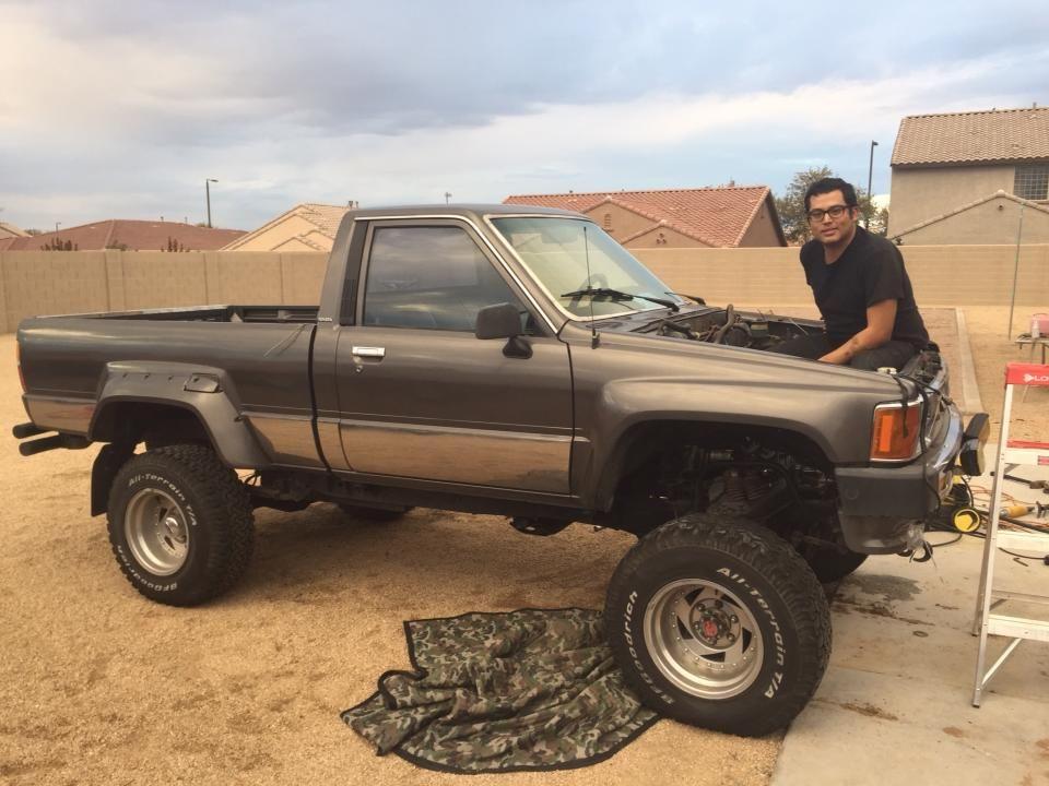

I had driven it around a few thousand miles, and the tired engine, kept getting worse and worse with the oil leak from the crank shaft seal, eventually it was dumping a quart a day, and that was even after changing the seal. Then one day it a piston ring took a crap, and it was time for a rebuild. On a budget, due to being in college, about to be a recent grad, which means the student loan repayments begin, I was strapped for cash. I pulled the motor, and took the long block to a company called AutoSpec in phoenix az. For the 85+ 22r motor, it is $600 for a rebuild. I was a bit sceptical, but they did all the machining, and included a master rebuild kit, They gave me back a completed longblock, and it all looked like it was going to work. I put the accessories back on, and dropped it back into the truck, I put in a new clutch and flywheel as well, so that was supposed to be the end of that. Autospec did the valves, timing chaing, decked the head, and the cylinders were 30 over, and they gave me a replacement crank for $70 because mine was trashed, allegedly. Out the door I paid $670 for a fresh rebuild, not bad, and it only took them 2 days to do the motor.

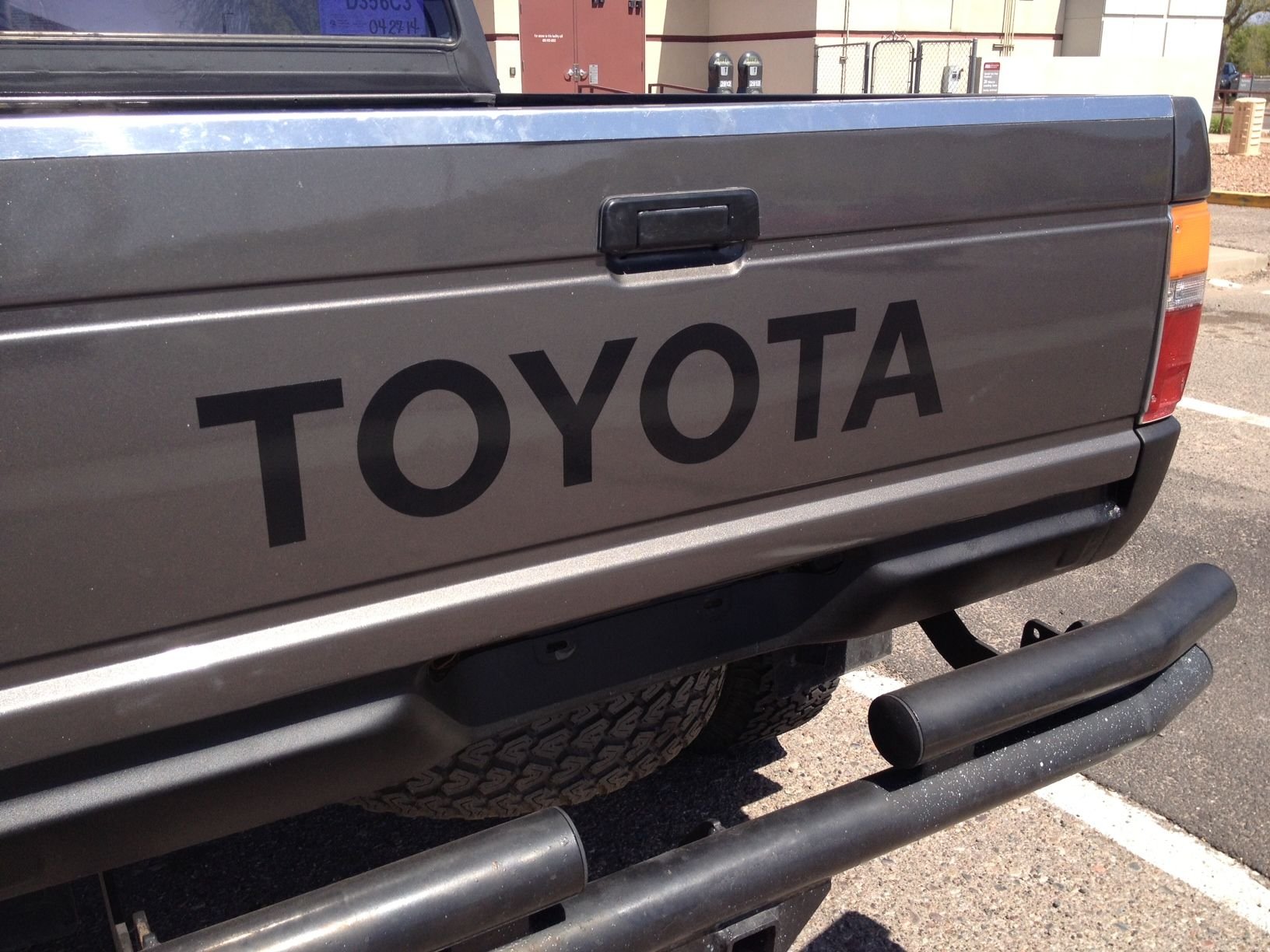

Told you those dumb KC lights were coming off, she shines really nice after a clay bar and wax.

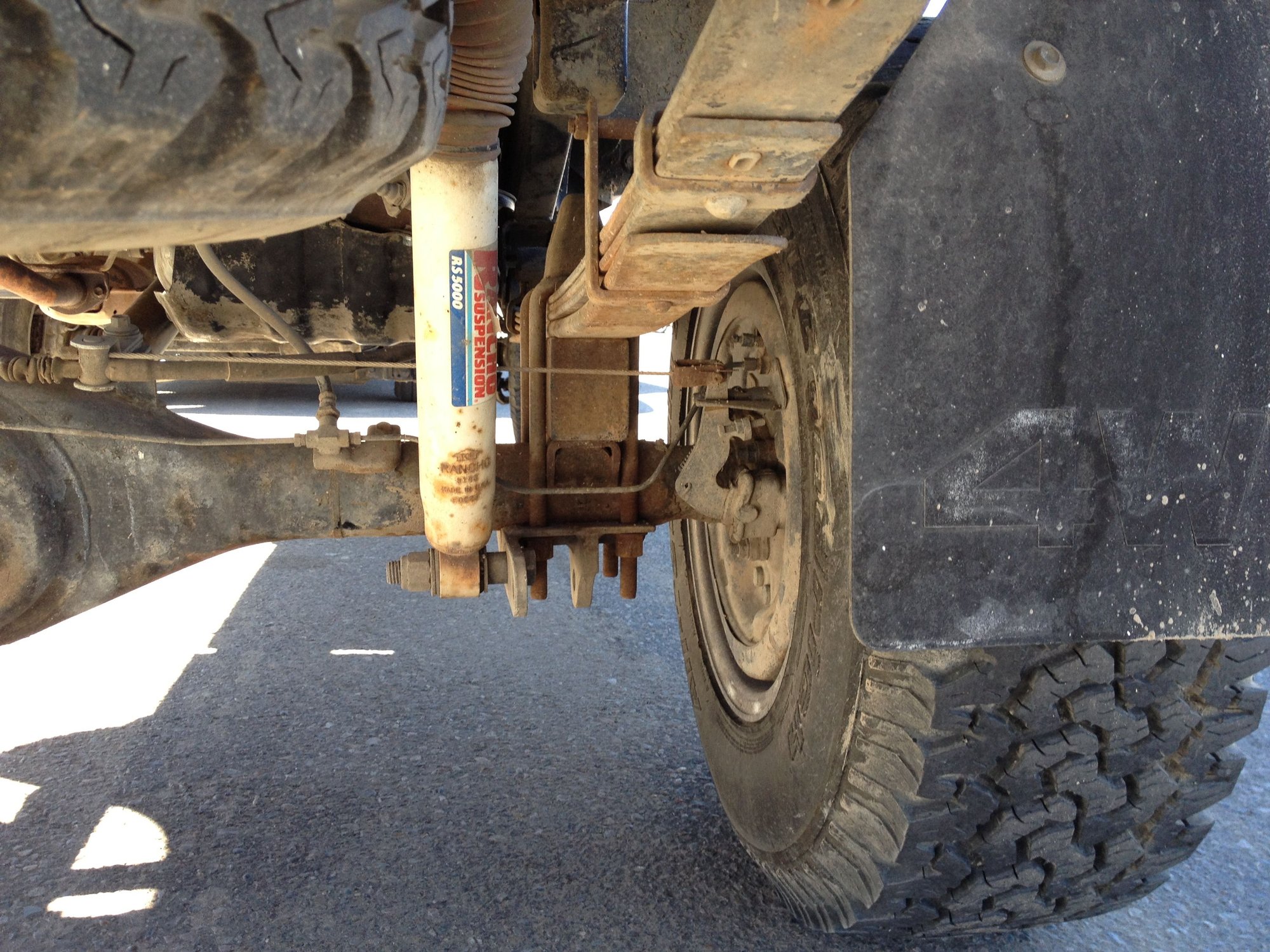

I took one more trip to NM, got a new passanger mirror, and a bumper guard, not sure how I feel about it, I think I will be building a custom bumper, but we will see how that works out, since home made bumpers always look like crap. I also changed the front shocks, so it is definitely a better drive, needs new stabilizers and rear suspension done, but that can wait.

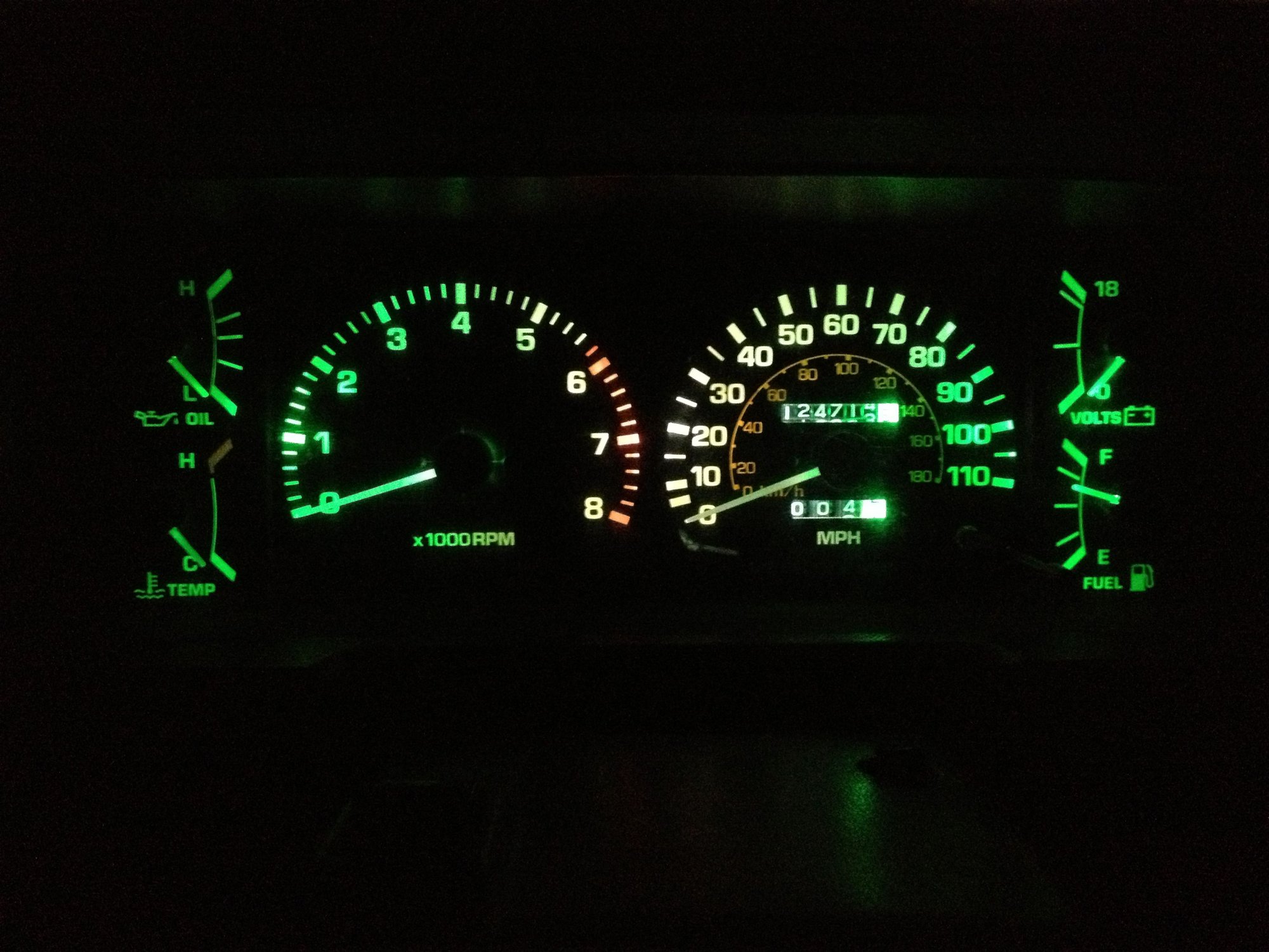

SR5 cluster, I changed the bulbs to LED, went green, white, green, I like the look, wiring in the tach was easy, but the oil guage crapped out, but I have another cluster, but that cluster has a smashed lens, so I can move all my good parts to one cluster, and call it good.

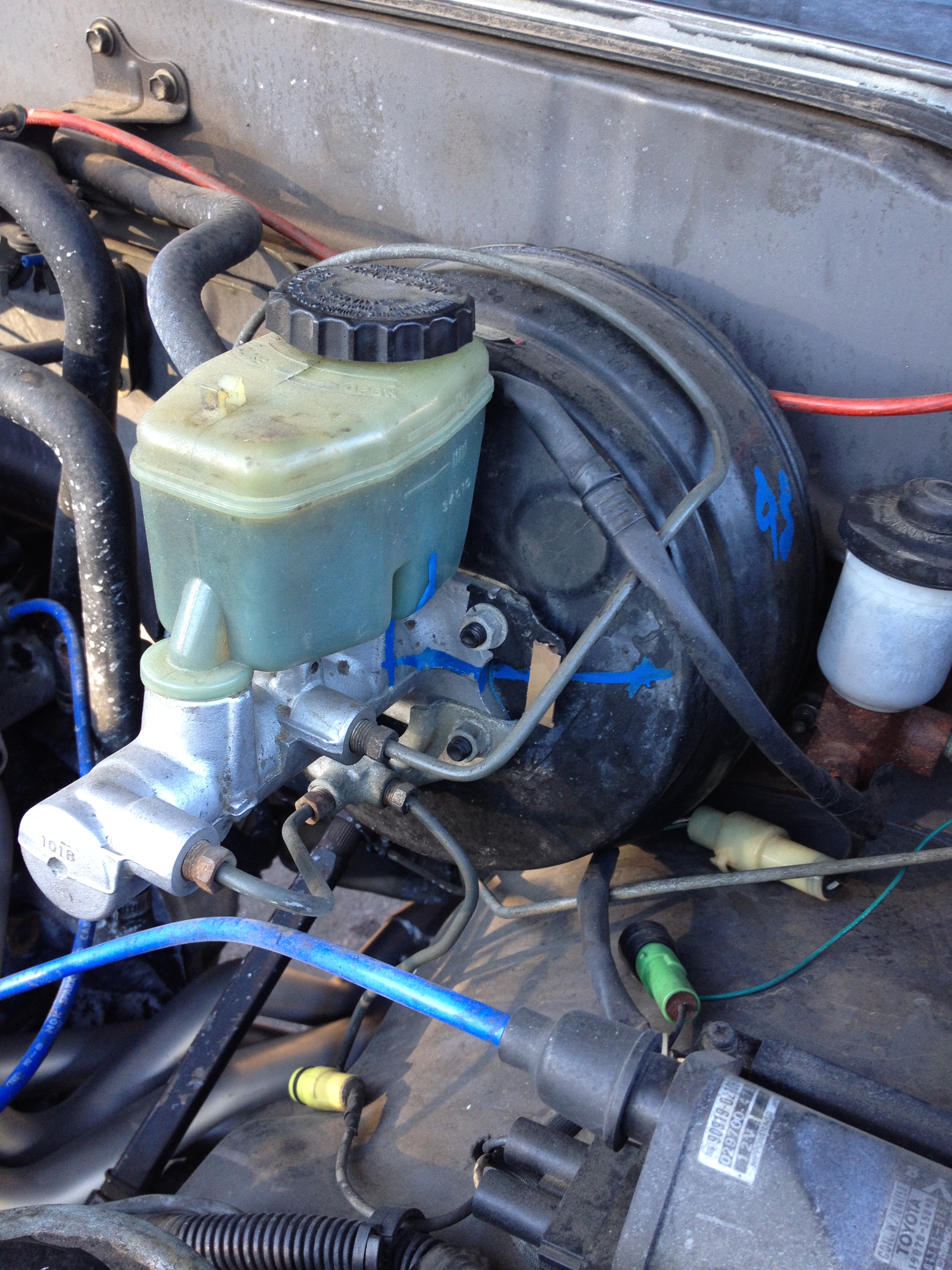

Okay, so I have made a few upgrades to the truck, fairly simple. My brake master cylinder died, so I decided I should do all the brakes while I was at it. New shoes were a pain to adjust, as it was my first time doing the brakes, but I got it all sorted out. I bled all the brakes, used the brake bleeder kit from vatozone, it worked all right, kind of handy when working on the brakes by yourself, which I was. Pads were easy to swap out, all in all, it was fairly straightforward. The master cylinder and brake booster were replaced with the master cylinder and booster from a 92 4runner v6 4x4. It all bolted right up, pretty much plug and play, definitely could feel a difference in the brakes. Does it work any better at stopping, could not tell you for sure, but it feels like it does. Not saying it is an upgrade really, I am actually just stating that it fits, I make no claims on effectiveness or safety of changing your brake components. When I bled the brakes, I followed the order that is listed in the Toyota bible, which is full of information.

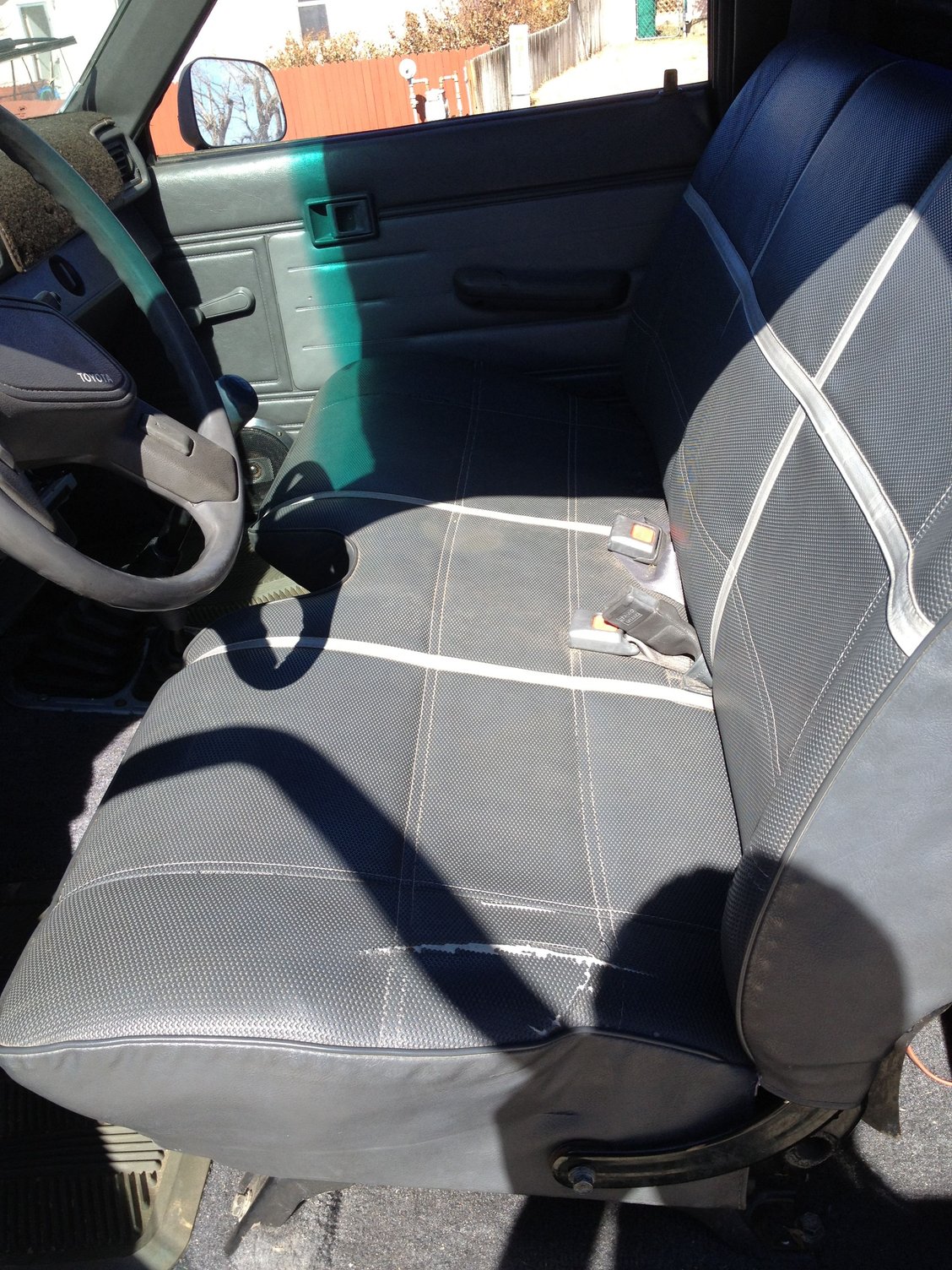

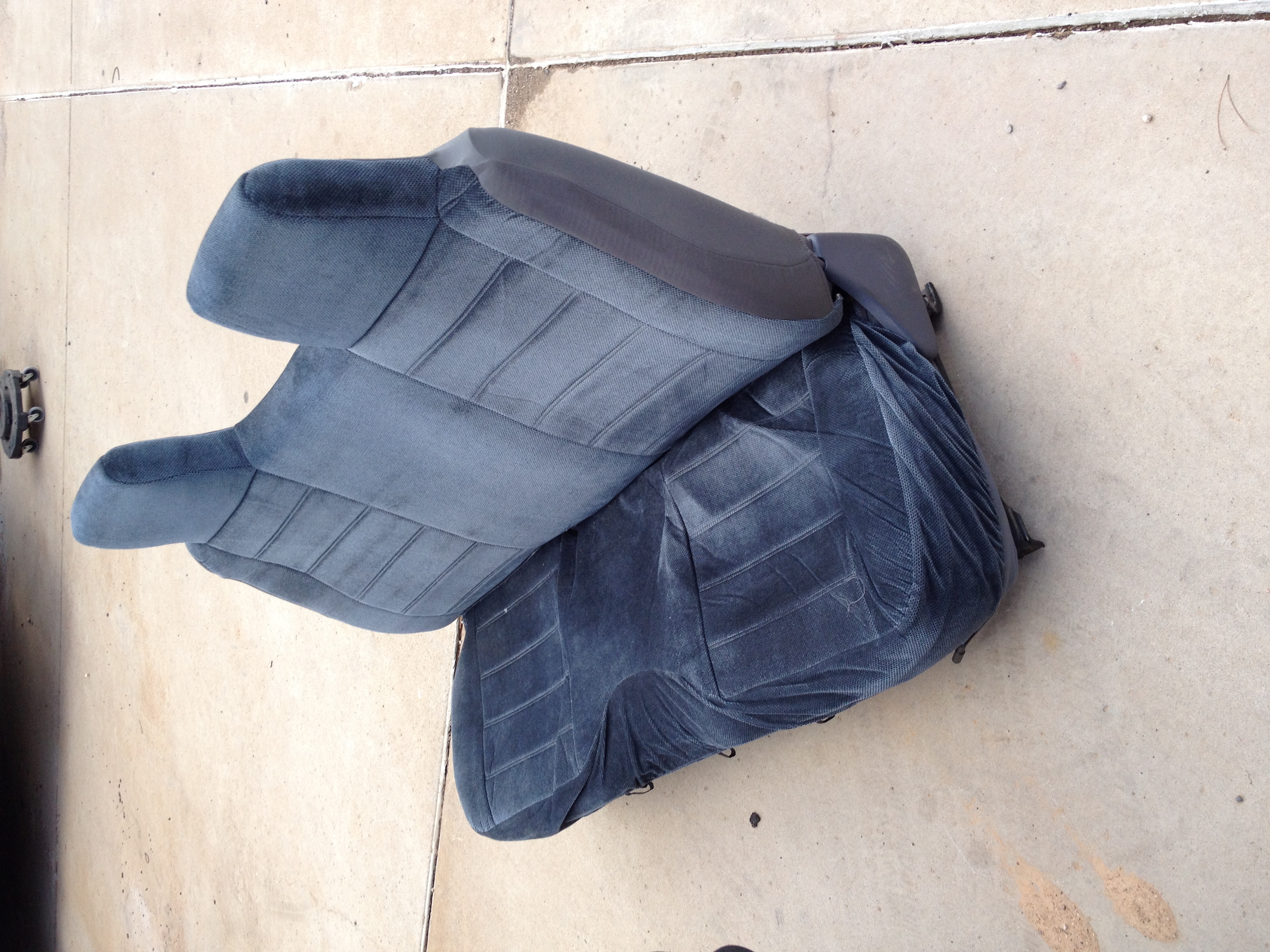

I also bought seat covers on amazon, they are called A25 bench seat covers, they claim to fit the 84-95 bench seats, I bought it for both of my toyota's, my 87 and my 92, the fit is good, the color is good, I am pleased with them. they fit snug, in the photo I had unhooked the bottom, so it looks loose, but they tighten up really nice. I bought the charcoal covers, and it looks like it has a blue hue in the color, which actually turned out really nice in the trucks, the 87 is grey interior, and the 92 is blue interior. The seat in the 87 did require fabrication for the newer model seat to fit. The front brackets mounted right in, but the rear brackets needed to be cut, turned around, and welded back on so that the holes line up, I can post photos later. I just bought tacoma seats from a 2001 extended cab tacoma, the holes only match up with the front outside brackets. I will document the changes that are needed to install them.

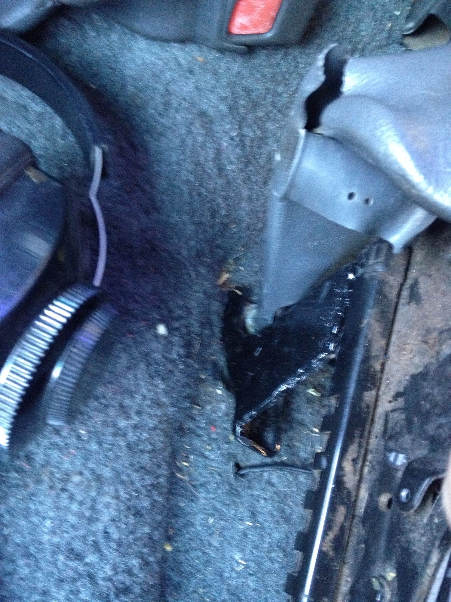

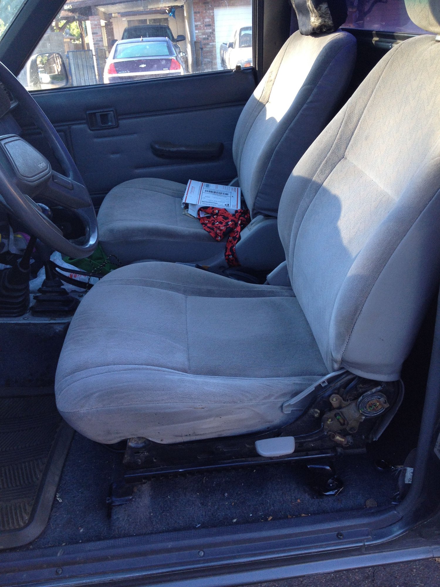

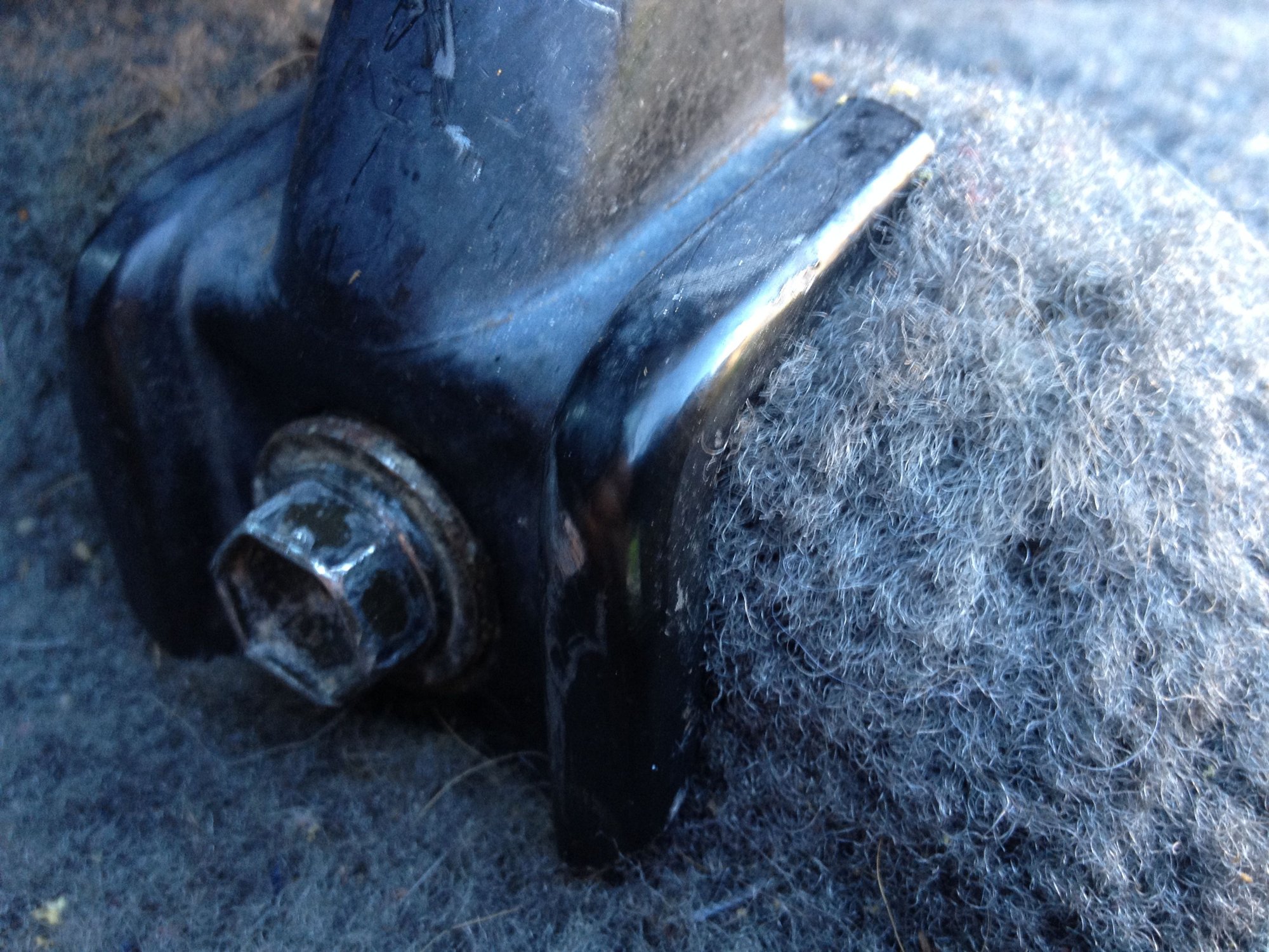

So I got the tacoma seats in. They are NOT bolt in, the front outside tab lines up, that is about it. The rear outside tab needs to be cut, and moved forward, the front inside tab needs to be bent down, and a hole drilled to mount it(still need to do it). The back inside needs to be cut and moved, I lined it up with the seat belt hole, not sure how safe that really is, but I did that. My thought process for the lining everything up was to place the seat, and line up with one hole, bolt it in. Mark where I want to cut the other tabs, remove seat, cut tabs, and put seat back in, and bolt in. Then I get the cut tabs, bolt them in, and that would give me the seat lined up with the tabs, I can add metal and weld, and I would know that my holes all line up. I think it is a pain, takes some decent welding skills, moderate cutting skills, and patience. I lack patience. When welding, place wet rags around all cloth areas to avoid burning down your truck, the seats or the carpets. When done welding, hit it with some paint, and call it a day. Needs seat covers, there is a local place that makes seat covers, so I am going to check with them on cost, or might order a set off of amazon. My seat position places me higher, which I like, I can now easily rest my arm on the door. The angle of my sitting is very comfortable, nice geometry to reach the pedals, and I clear the roof. I am 5'10", so it might not be that great for a taller person. I like the room under the seats that I now have, I can fit both amps under one seat, which is a huge change from before.
The seats after installing.
Inside front tab, already folded down, still needs a hole drilled.
Rear outside tab, needed to add some material to get the angle where I wanted it.
Front outside tab, I made zero modifications.
Rear inside tab, added material, cut and relocated, the biggest pain of all.
