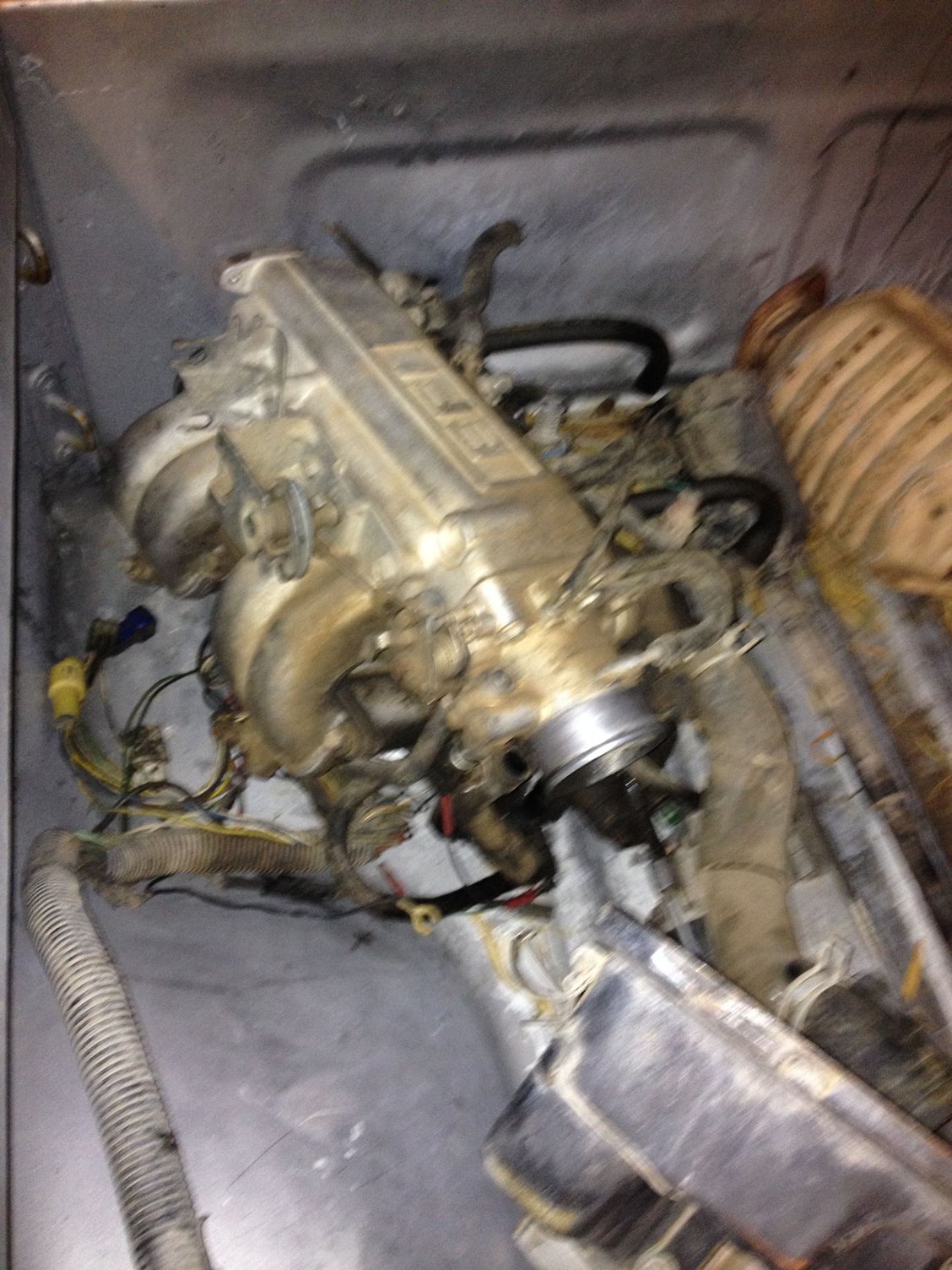

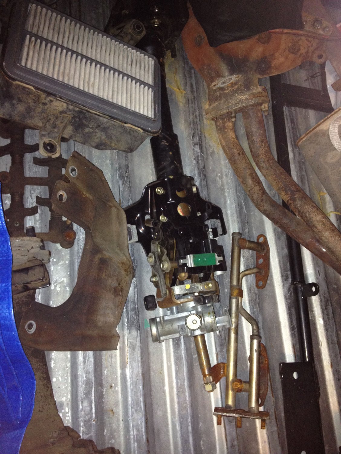

So I recently bought a bunch of stuff that needs to get put on the truck. I acquired a tilt-able steering column, some 5.29 gears for the front, I am buying a complete rear diff with locker, so that will probably be a while before I get the diff's installed. I ordered the power steering pump re-sealing kit off of amazon, and I ordered the power steering pump idler bearing from 22reperformance, which I must say was quick to get the parts I ordered out to me. I also picked up a complete EFI intake manifold, with the sensors, fuel rail, injectors, air box, ECU, and uncut wiring harness. The EFI stuff was only 100 bucks already pulled, so, I will be doing an EFI swap sometime after the winter, maybe by summer? I just need to get a distributor, EFI tank and pump, and the tubing from the air box to the throttle body. I am for sure buying a new head and cam, getting the injectors rebuilt, and assembling it all, that way my downtime will be kept to a minimum.
new steering column, my old exhaust parts. I think I keep everything I take off, never know when if I will want to put everything back one day.
EFI setup, sorry for blurry photo, crappy light in the garage. I just realized I also will be needing a throttle cable.

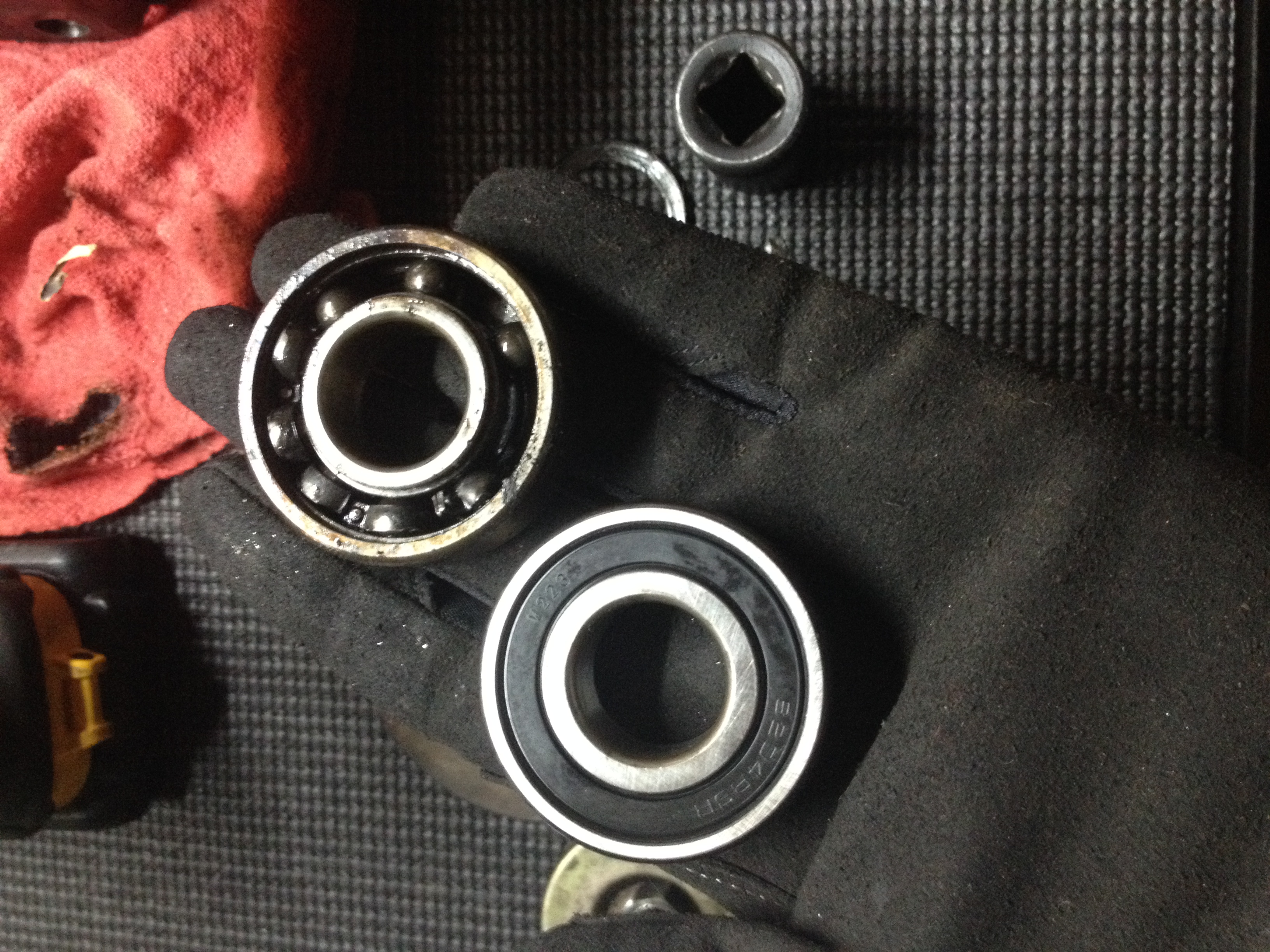

I also replaced the idler bearing for the power steering, that was a fairly easy job, I got the bearing from 22reperformance, very helpful, and quick to ship out. The bearing was completely shot, surprised the belt had not broken. I also replaced the seals in the power steering pump, since it was leaking. I used a kit from amazon, Edelmann part number 8760, it was under 10 bucks when I ordered it. I want to get another power steering pump to completely rebuild, with new bearings, and check tolerances so I can have a completely ready spare on hand. I did a quick search on on 22re power steering pump rebuild, and found a great step by step. For the idler bearing, I did not use a walk through, quick heads up, a press would be nice. I used my bottle jack and some spuds to press things in, so a press is now on my list of things to buy. I do not recommend using the bottle jack and the truck, but you gotta do what you gotta do.

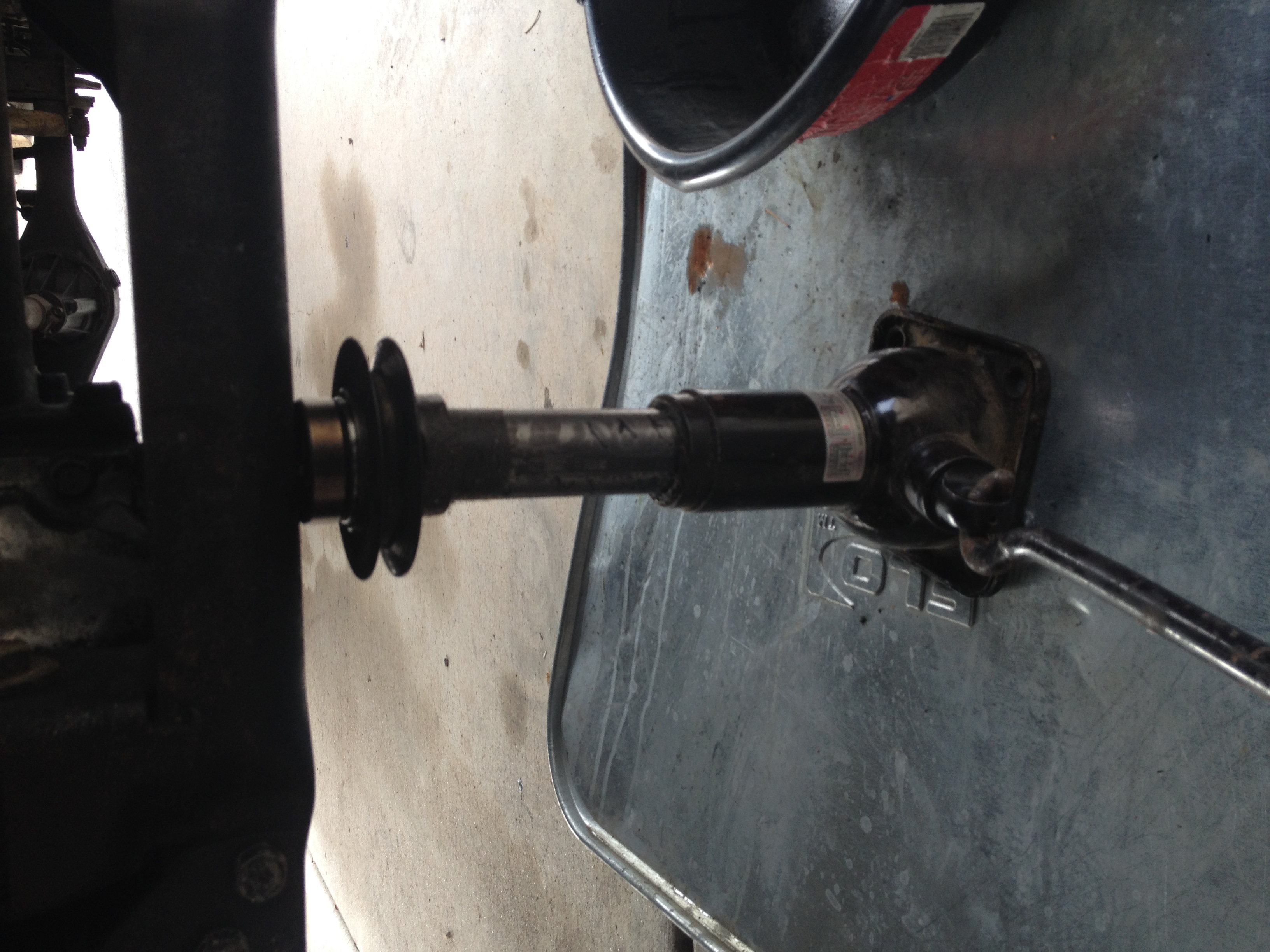

The power steering pump reseal was a bear to do, some of the bolts were rusted in from the back side. The final bolt to split it open was very rusted, at least 3 threads worth. I used mouse milk to penetrate, that worked great on all the bolts but the last one. The torch did not help either. I might recommend loosening the bolts while still in the truck, because my impact gun was doing nothing when the pump was on the workbench. Vise and 2 foot breaker bar did the trick.
