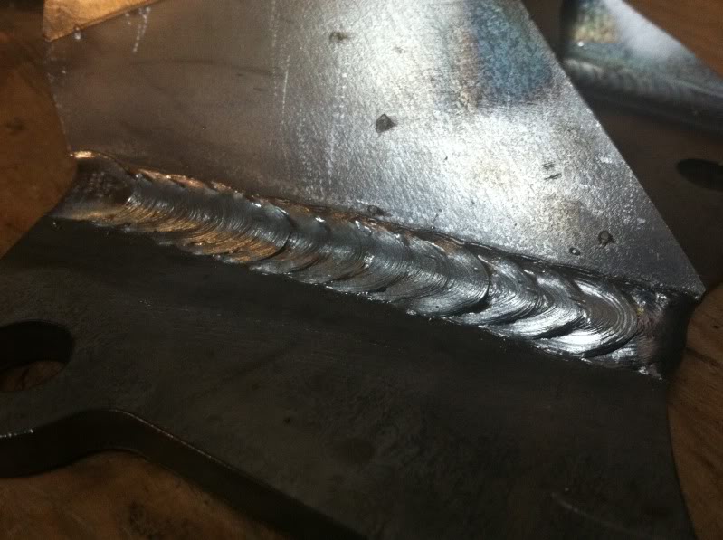

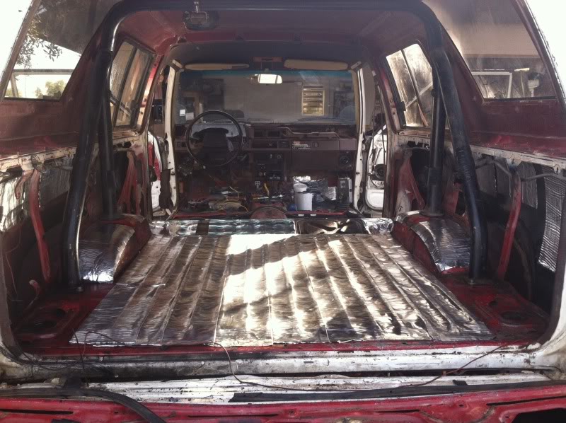

Thanks to Chilkat, my motor mounts showed up Saturday. Beautiful welds. So I said forget waiting til Monday. I'm off Monday-Thursdays, I work Friday, Saturday and Sundays. I took a partial day yesterday, came home and wrenched from 330-11ish. I'm now working on the wiring.

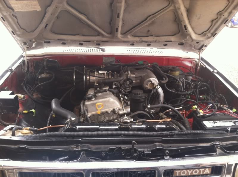

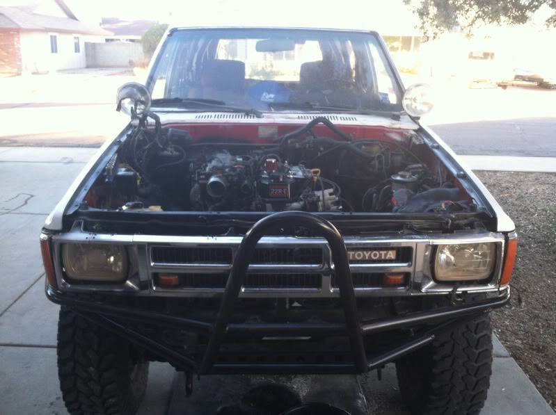

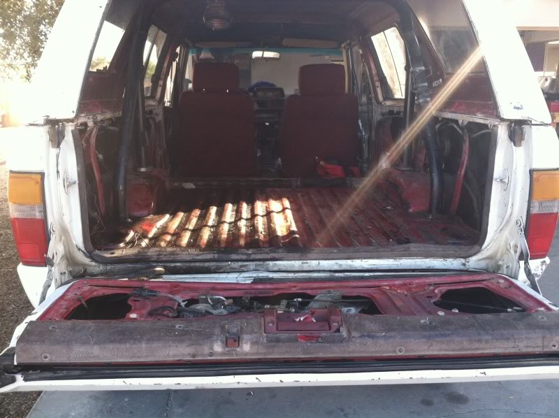

Okay folks, here it is! From Saturday at 3pm (pulling 22re)-Tuesday 730pm(minor items left)
http://i104.photobucket.com/albums/m...psf8f76469.mp4
Old Nov 14, 2013 | 08:14 AM
  #70
AZkid's Avatar
Joined: Sep 2007
Posts: 1,182
From: Arizona

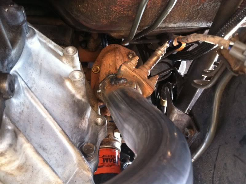

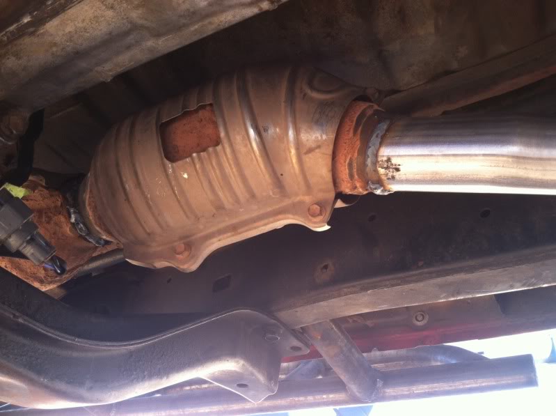

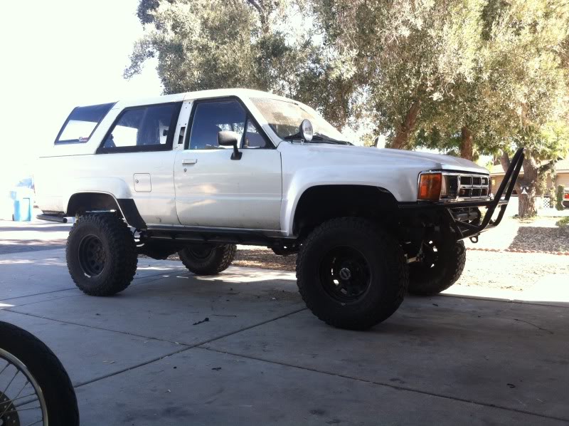

Well here's my exhaust work, the guy only charged $80 to do it all. Then a picture of the whole truck how she sits. No front diffrential or CVs. The rear sump pan didn't clear the diff. I'm motivated to SAS.
Later today I will take pictures of where the ORS harness connects. It'll answer most people's questions and a good reference for me.

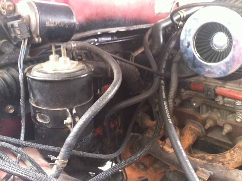

Here's the before, during and after. Some things I'm still working on. Such as; front door panels, headliner and associated pieces, drivers side fender wiring mess.
I ran emissions test the first time and failed it for no evap system. Here's the readings from today's run, which was a pass, clearly.
.030of3.00 HC
6.96of25.00 CO
1.21of4.50 NOX
For a note to other, the 2003 and 2004 3rz uses a funky evap system which I do not have. So I utilized the stock evap canister and ran the 'to purge' line the same as the 22re, straight to the front of the fuel rail.

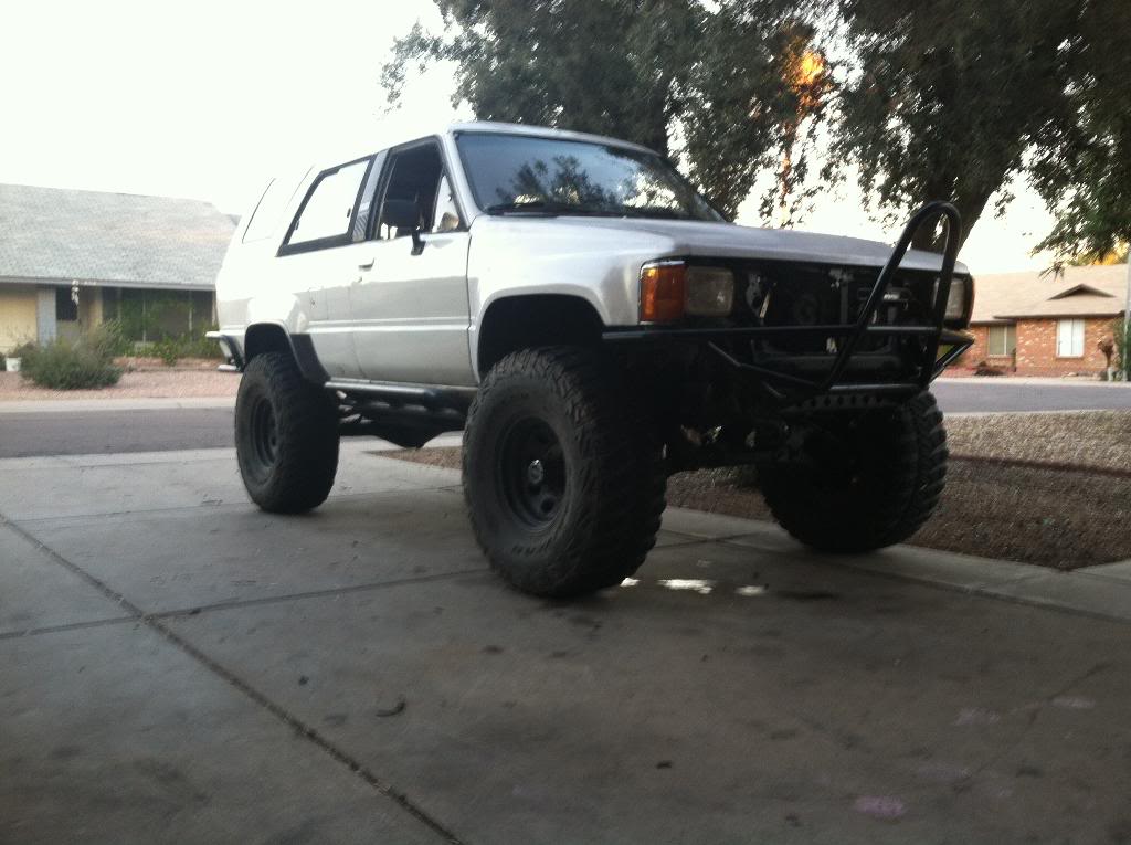

Well I'm still fiddling with the EFI fuse problem. It seems to be fairly intermittent, but in the end I know it's right under my nose. I had part of the stock 3rz evap system hooked up, but it's just clicking. I worked the next three days and the holiday, so it sat for 5 days with the battery out. I come back to it, removed the evap system, capping the plenum. The two electrical leads are now unplugged, it fired right up. Numerous times, ran it down the street, around the block and so forth. I'm hoping this solved my problem. But, in the end, I know I need to do my homework. Track down a wiring diagram and test each port/lead in the system.
But, here's a picture to break up the boring words.
I posted my 31's on the local boards and I have interest. So it's time to swap them out! Done!
(The grille is not on because my hood latch cable broke)
