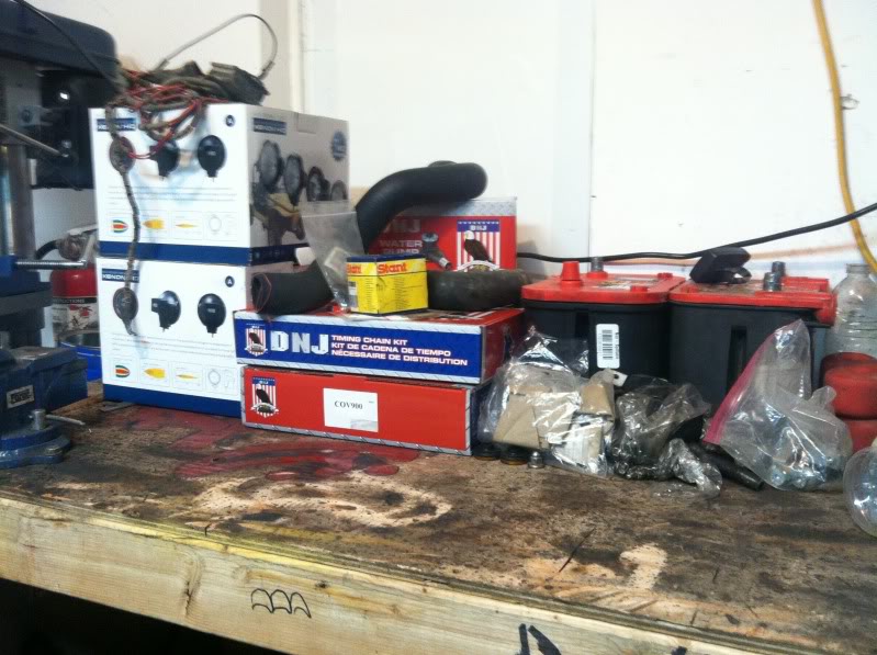

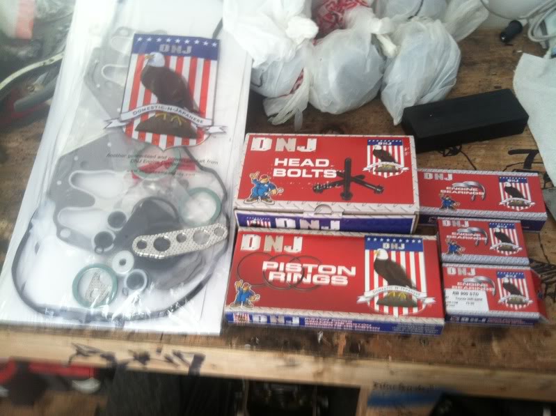

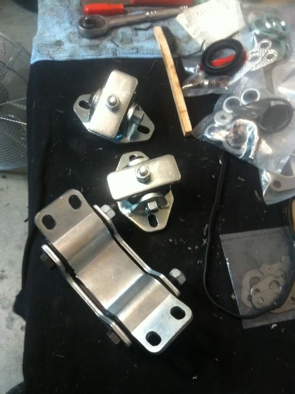

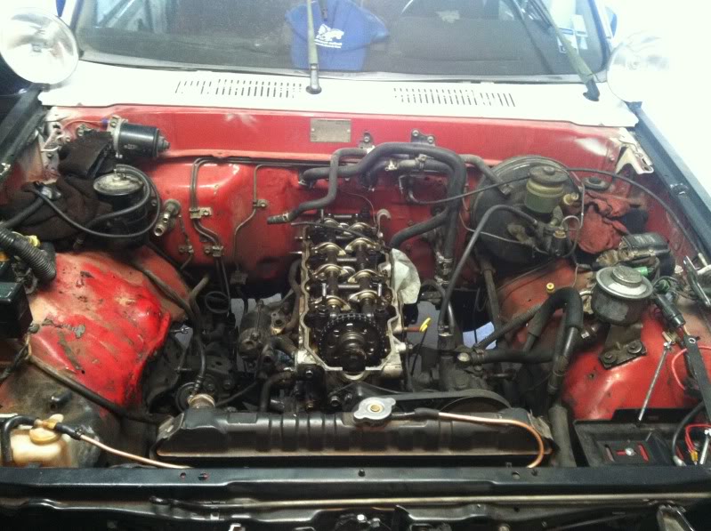

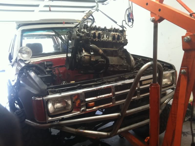

Okay, so we left of with the truck sounding like a freight train. Made time for it this week and got the old engine pulled. I decided instead of figuring put what is wrong with this one, ill swap in my spare. I already have my ENGNBLDR timing chain, cover, water pump and oil pump. I've also collected a couple other goodies, HIDs, thermostat, radiator hoses, new belts. I ordered new engine mounts, trans mount, full gasket kit, ect.
Sorry for no pics, photobucket is being a whiny baby.

From: Arizona
Thanks guys! My trail gear and autohaus orders both shipped Monday morning and should be here tomorrow. Havent heard from marlin yet... So I'll have everything to get this other spare engine installed. Woo!
The engine that came out in the pics will be built on the side as a fun project and eventually make its way in.

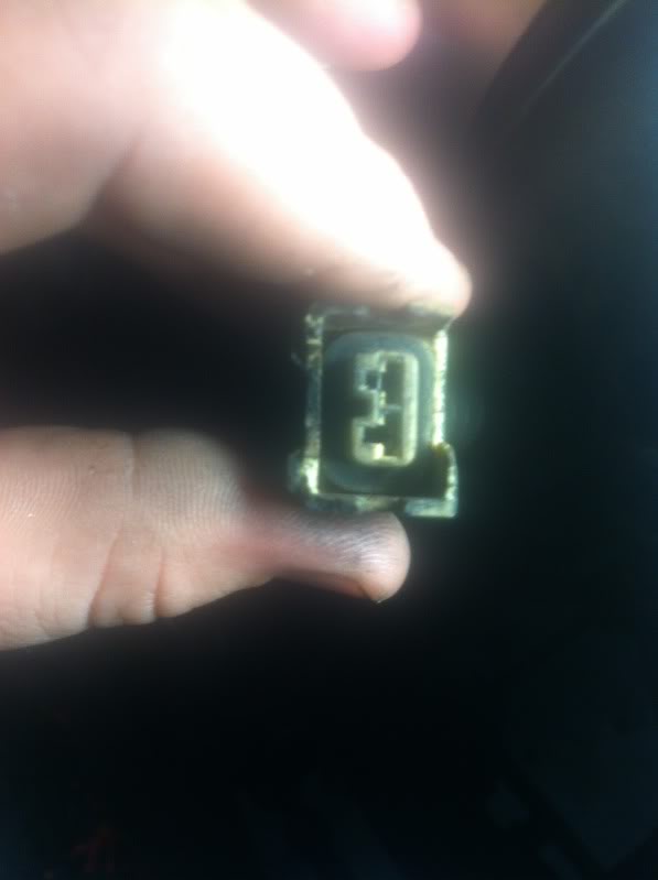

Well long story short, 1st motor had bad compression. So I got my spare motor, swapped everything onto it. I was having problems with my #1 injector. While pulling my harness back out, I checked my connector, the lead for one clip was pushed back inside the housing. Got that connector repaired, hooked it all back up, viola, run like a champ!

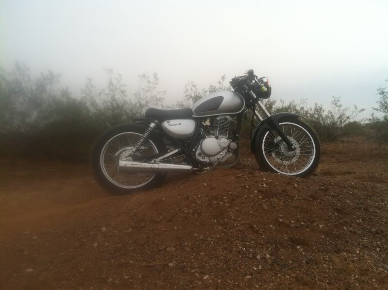

I feel a need for a picture. So here's my daily.
2013 suzuki tu250x

I then started having problems with my fueling. Started looking into and found that my #1 injector lead wasn't making contact. So I took the connector apart and fixed what's left. I'm due for new connectors.

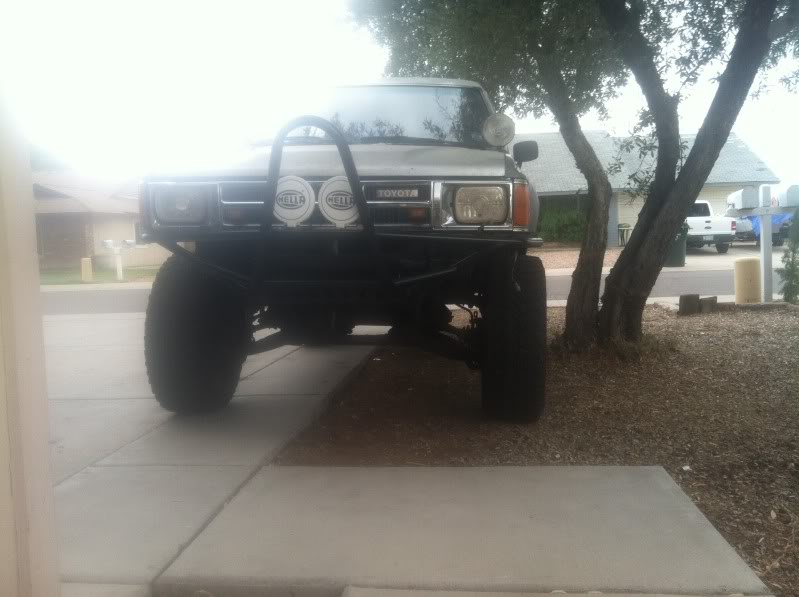

As you can see, the corner of my Hellas are covered by the front bumper hoop, I plan on ordering a set of the HIDS in a smaller size. I believe it's a 4"?
