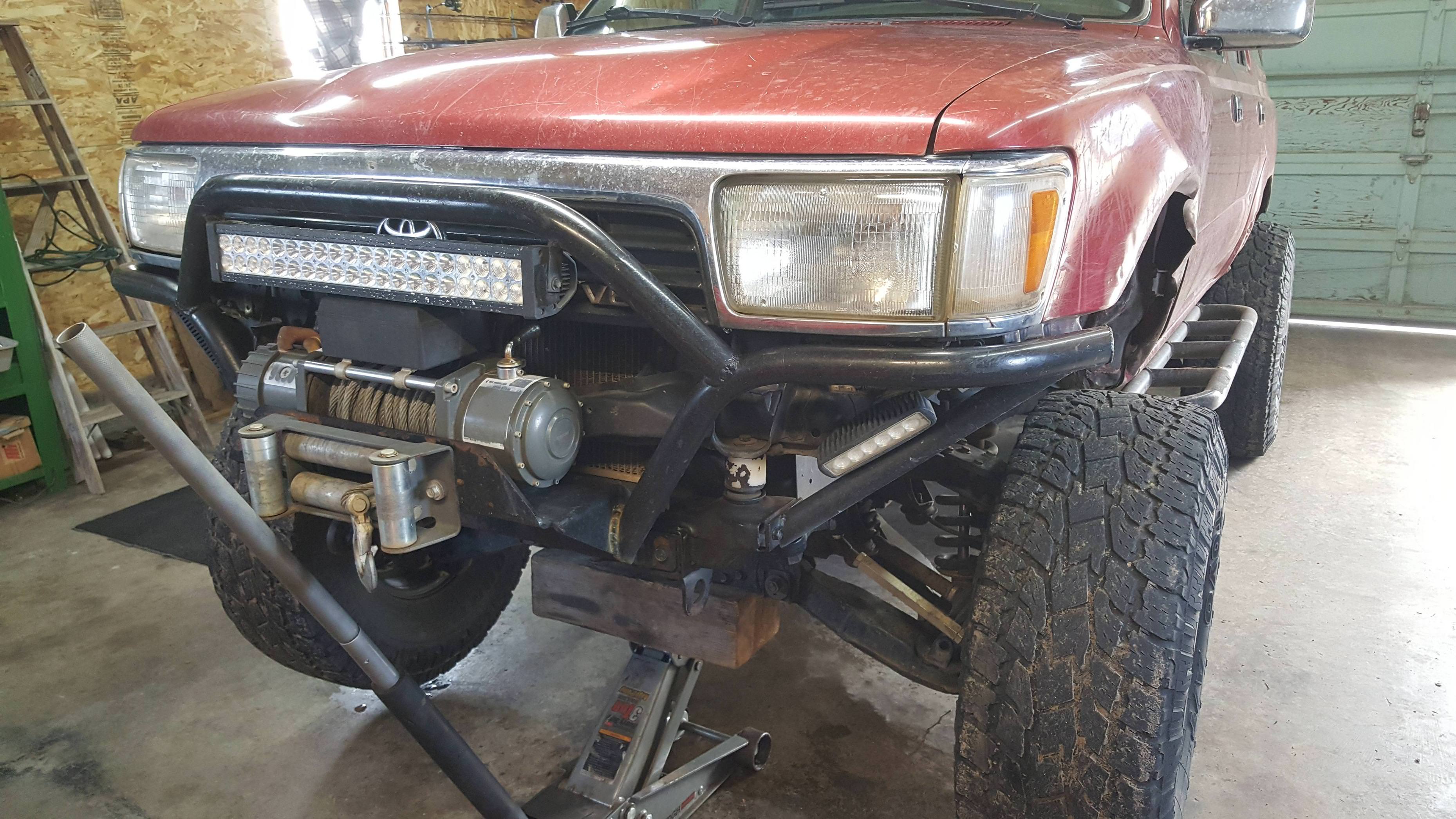

Here's the damage from my ball joint breaking going down the road....
Here's how she sits today...

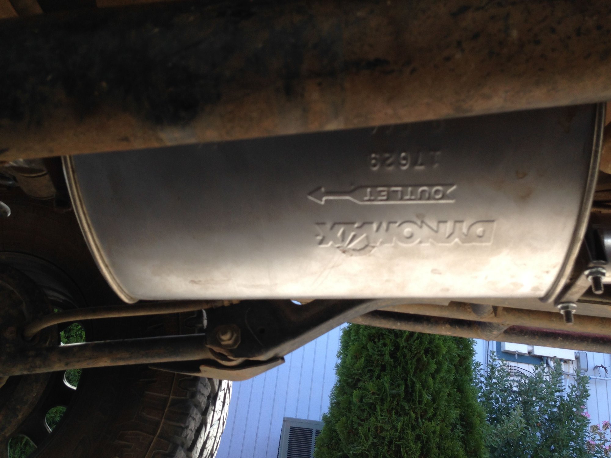

I changed up my exhaust Because I was tired of how loud it was with the Thrush muffler I had on it. So I bought a Dynomax muffler and it sounds WAAAAAAY better and quieter to boot.

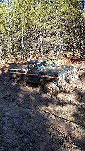

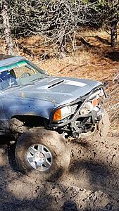

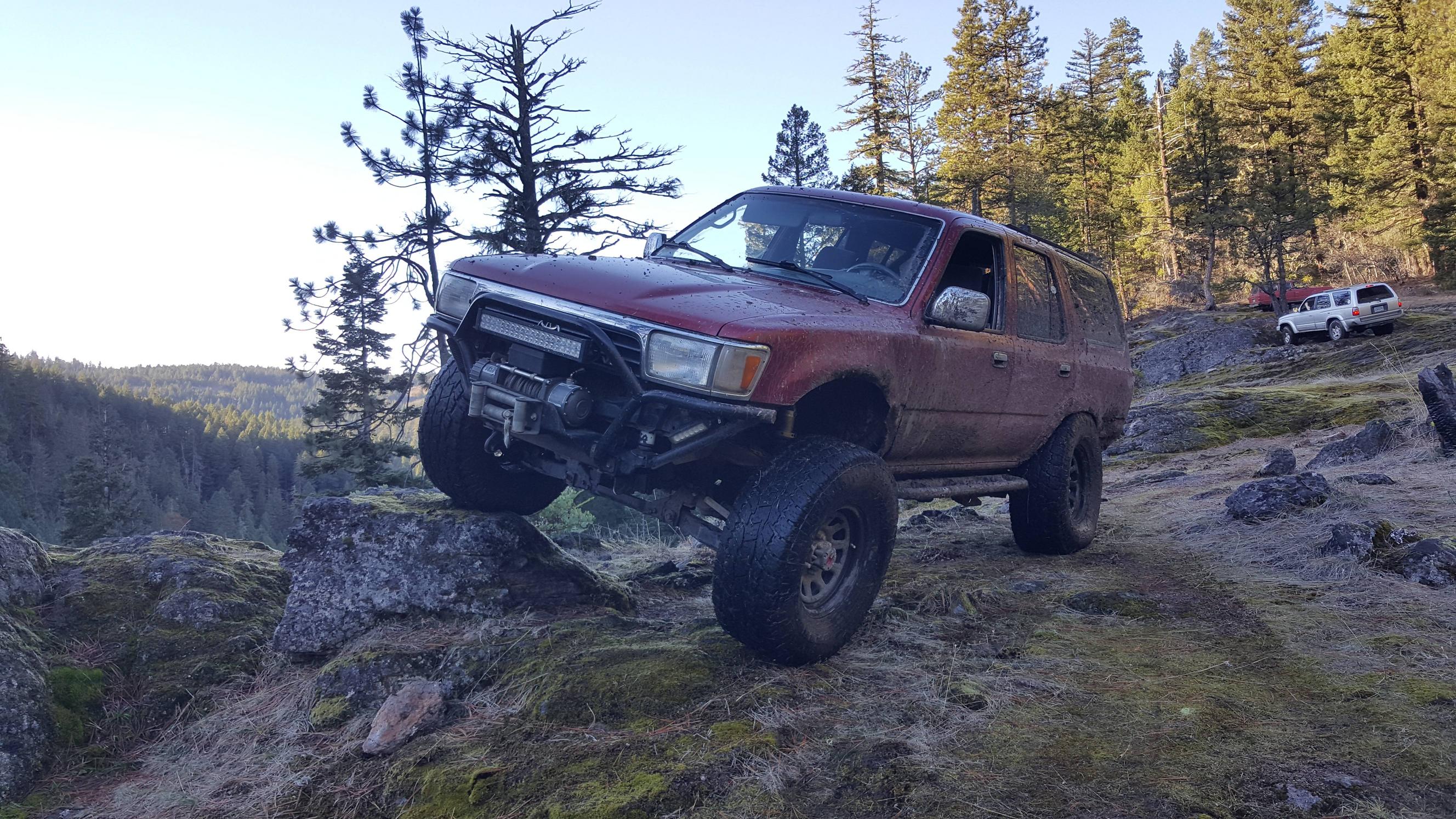

Well we ran our annual Hangover run today and it was a blast! The sun was out, the mud was slick, and the trucks were plenty! Happy New year to you all!

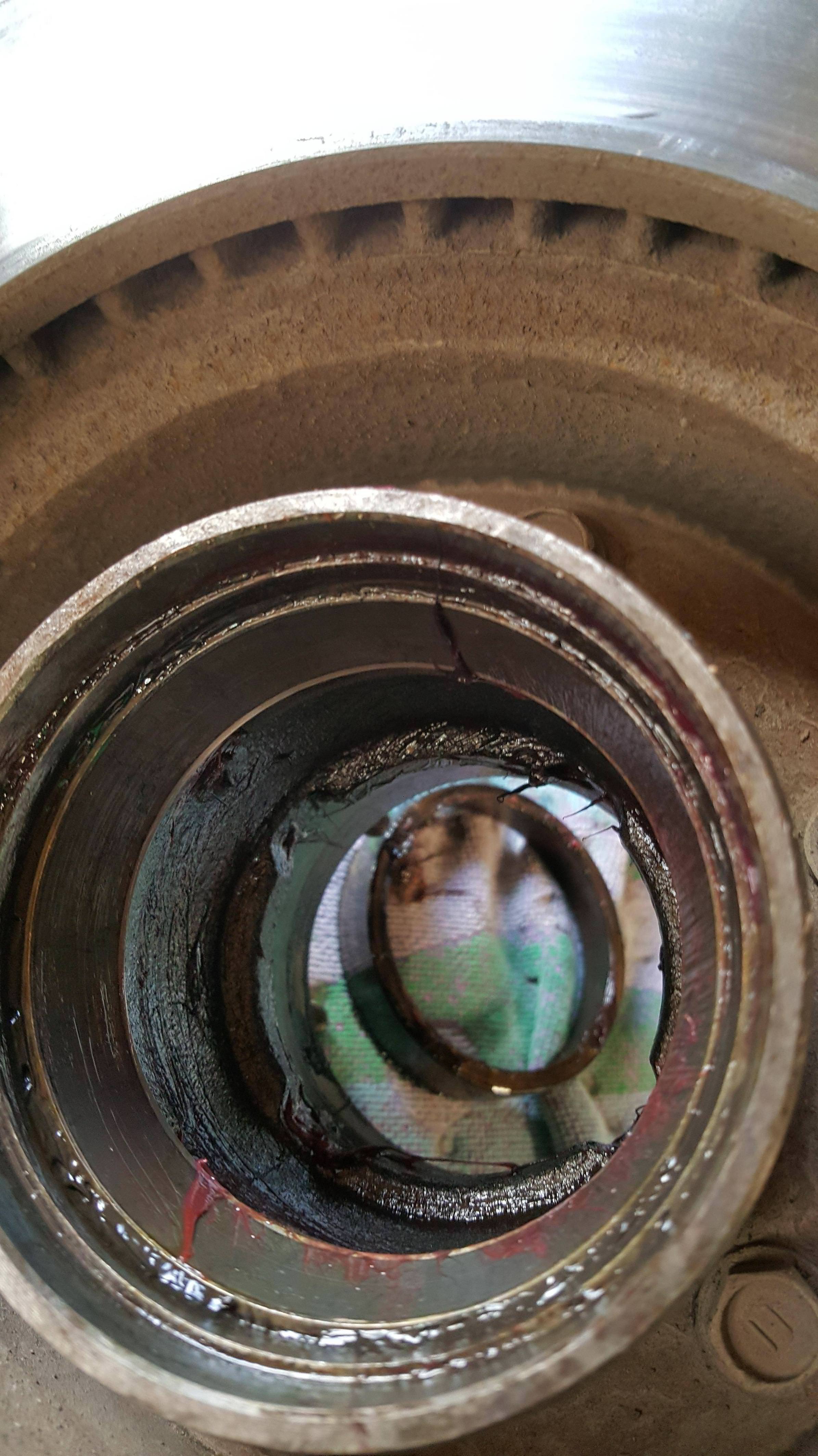

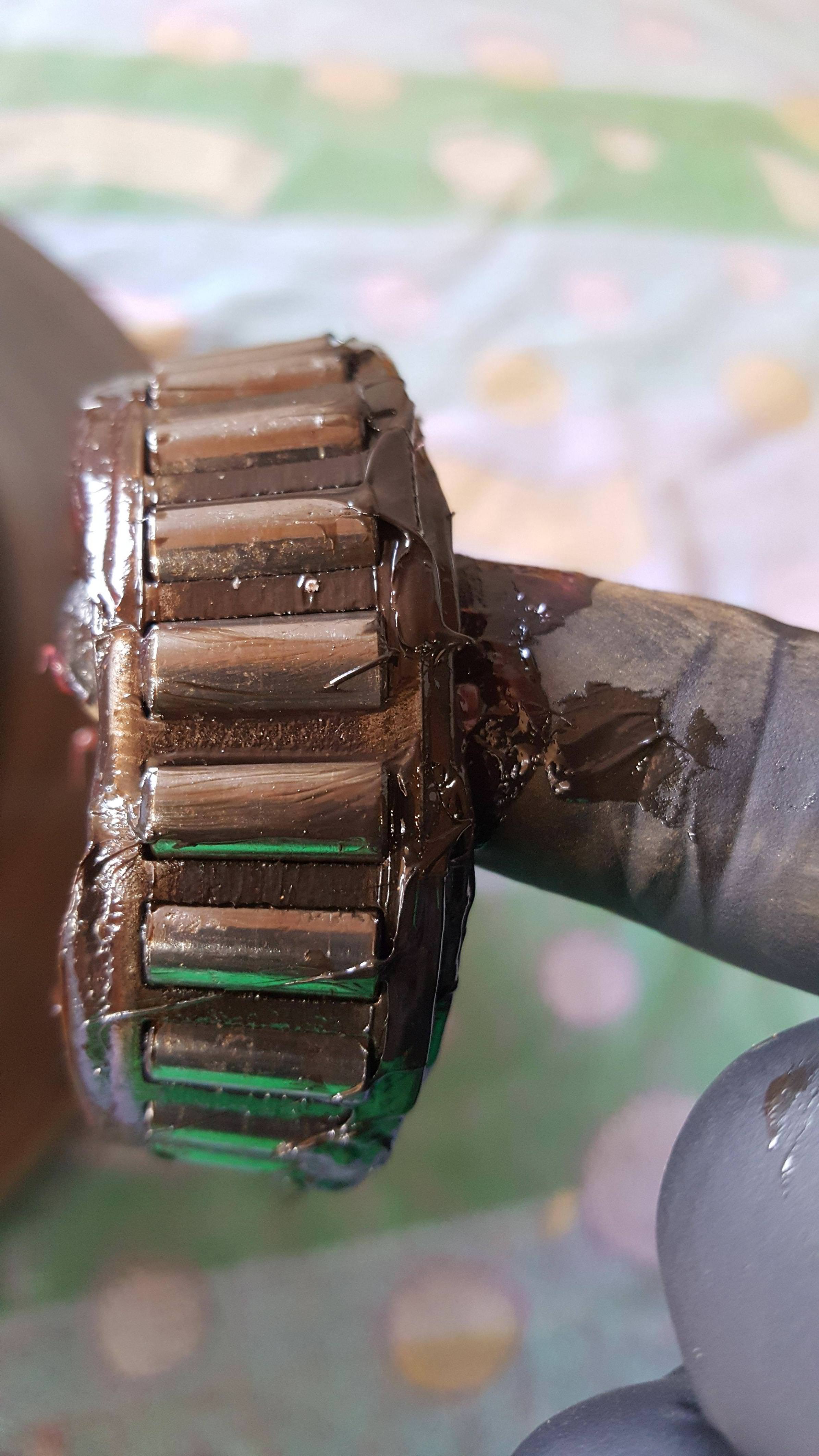

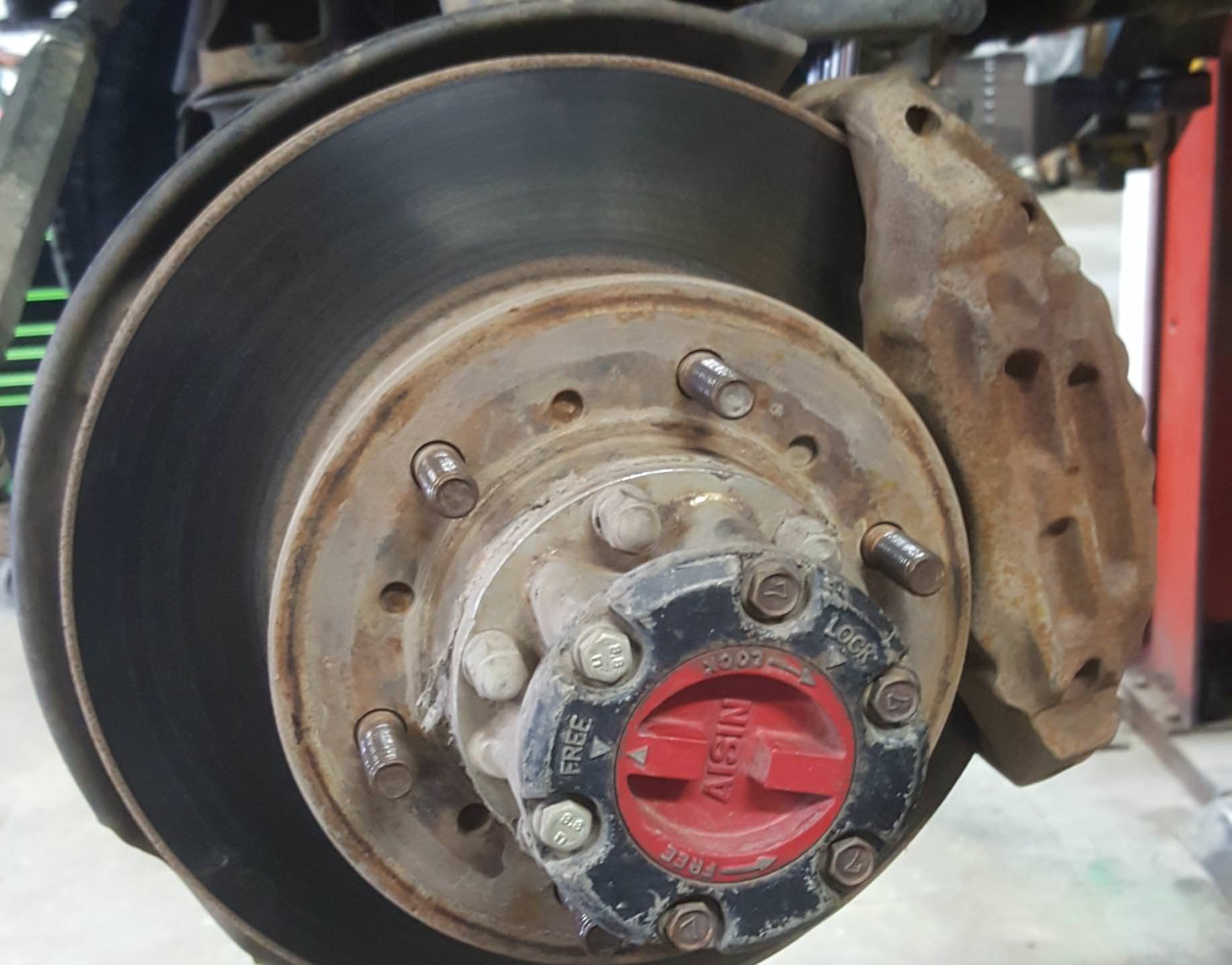

So Started some disassembly and cleaning today.
Andersej: 1993 2nd Gen 4runner-7kmdhb6.jpg
Jacked up and ready
Andersej: 1993 2nd Gen 4runner-gdtfk8b.jpg
Rotor is still looking alright brakes are at 60% or so
Andersej: 1993 2nd Gen 4runner-qxiuw0k.jpg
So you can start to see here that the red grease is not very red in fact its a brown/black mixture....

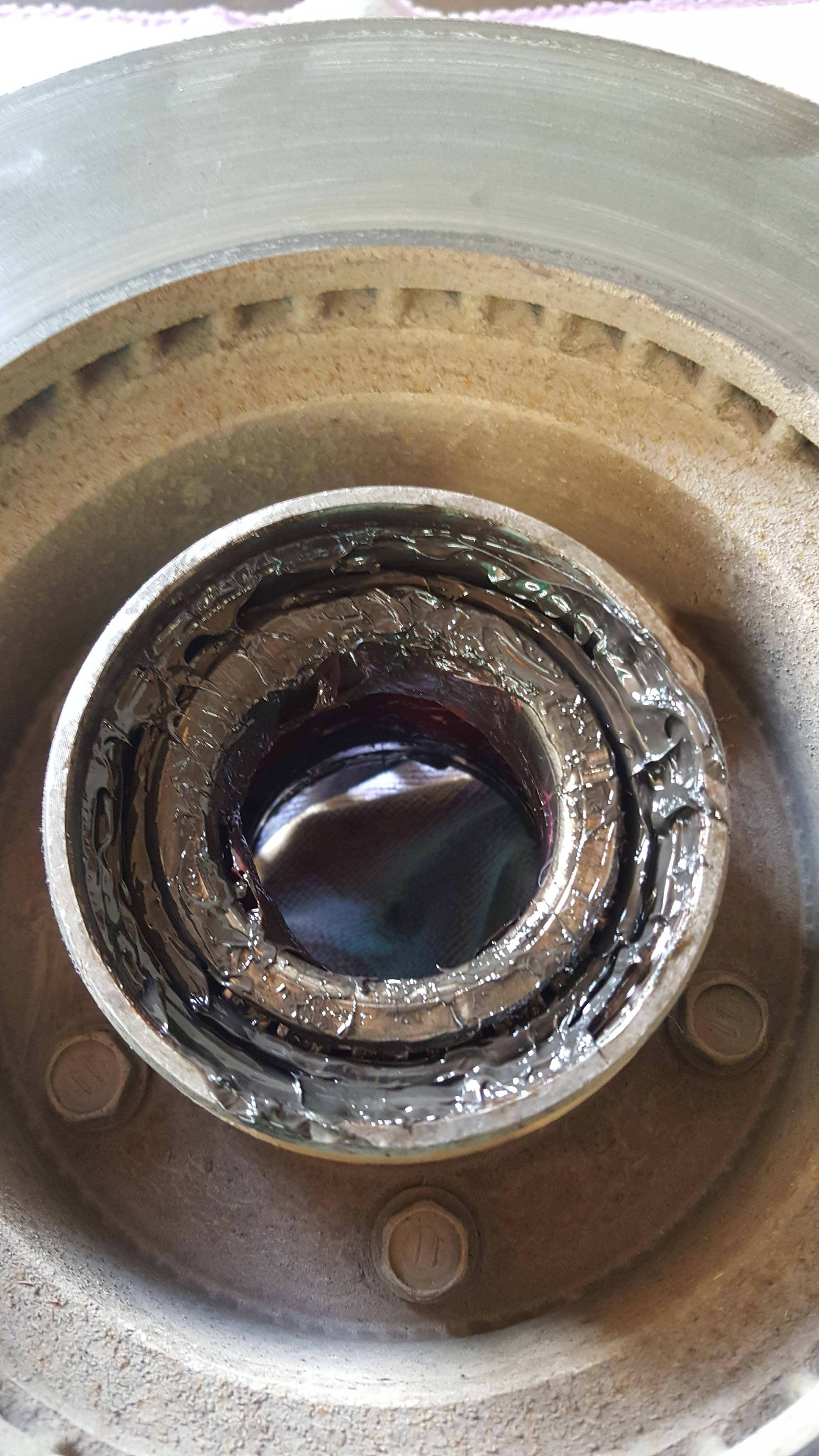

Andersej: 1993 2nd Gen 4runner-ux3glvc.jpg
Andersej: 1993 2nd Gen 4runner-bejacic.jpg
Heres the inner bearing as you can see the pitting and what you cant see is how clapped out it is. It has quite a bit of movement and the bearings themselves are worn.

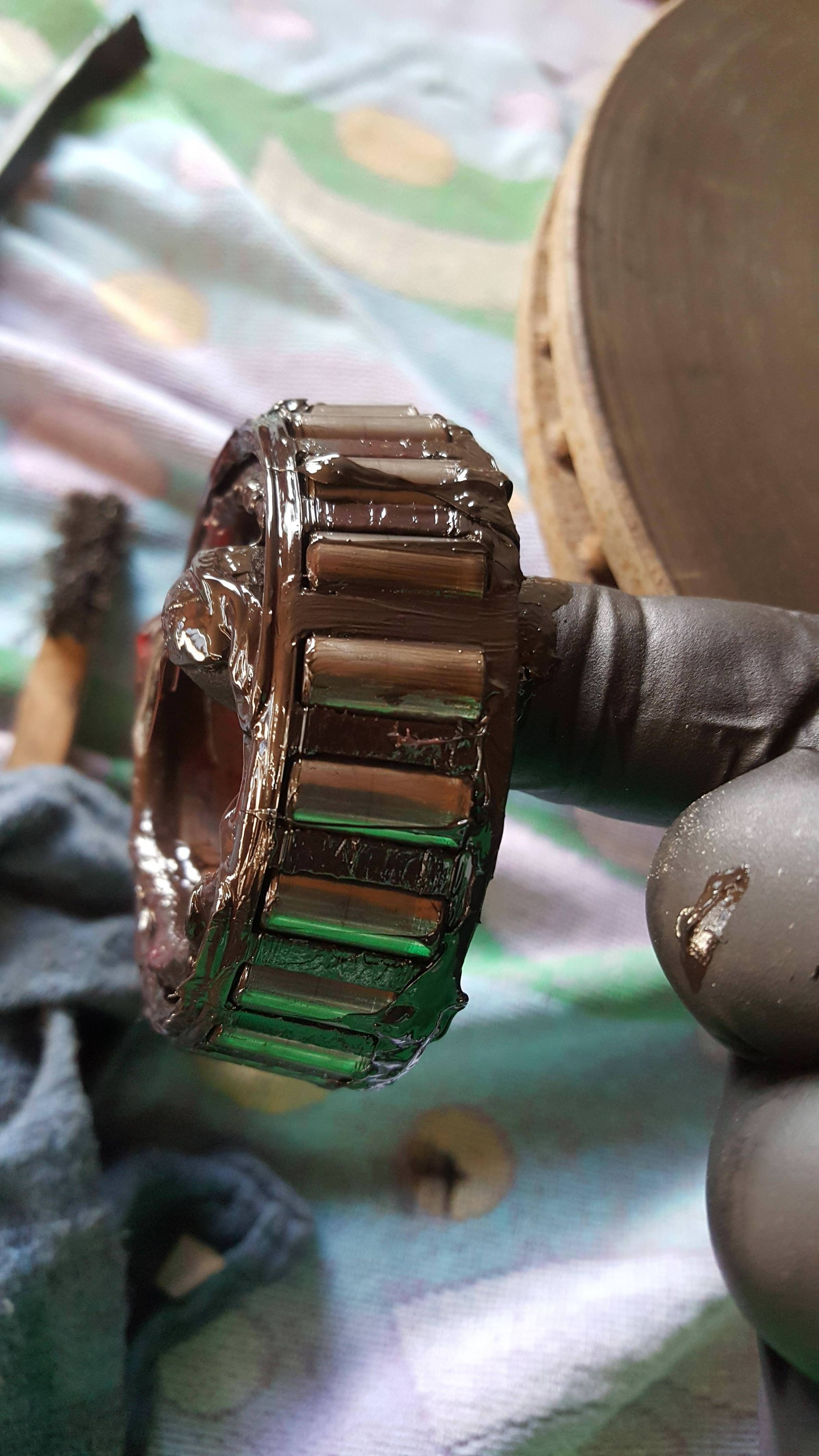

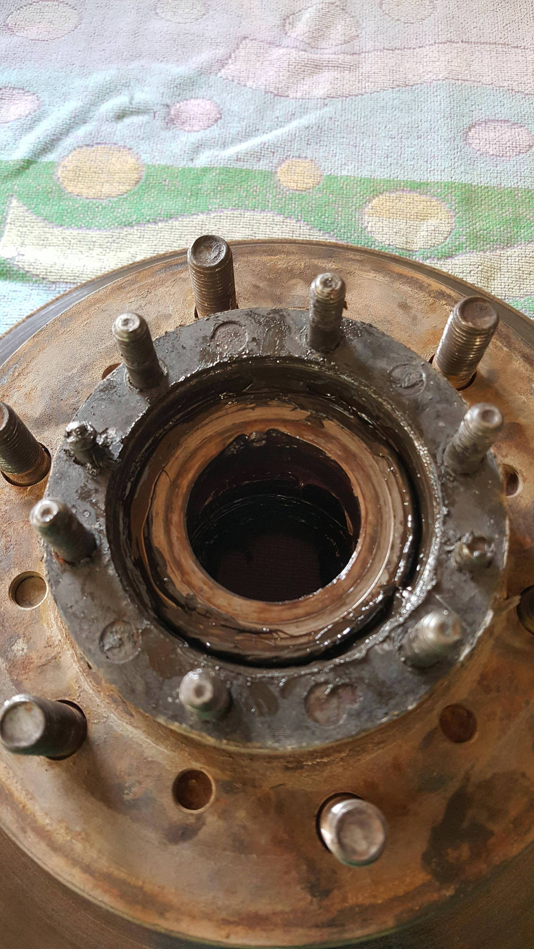

Andersej: 1993 2nd Gen 4runner-vb6ta2l.jpg
Outer Bearing
Andersej: 1993 2nd Gen 4runner-wf34no7.jpg
A few smacks with a punch and out comes the Bearing Race
Andersej: 1993 2nd Gen 4runner-fsmt3xb.jpg
Yep some wear signs on the race but nothing like a new set to cure all that.
