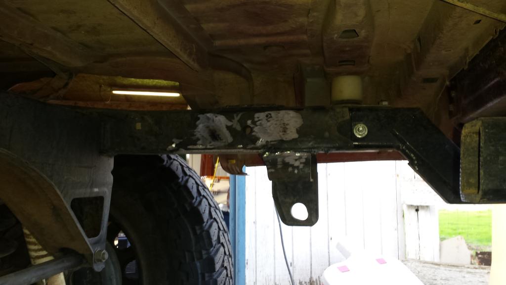

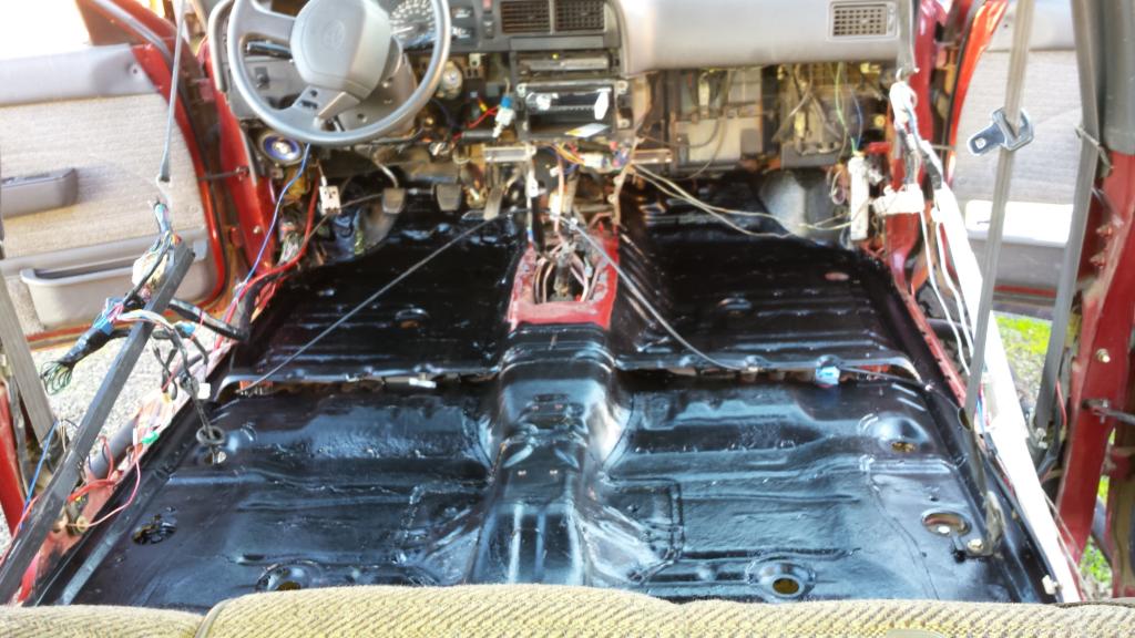

Been a bit since I have posted anything....

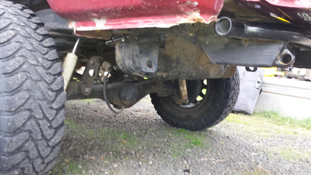

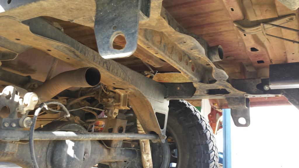

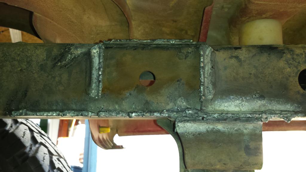

Lets see I have relocated my Gas tank...

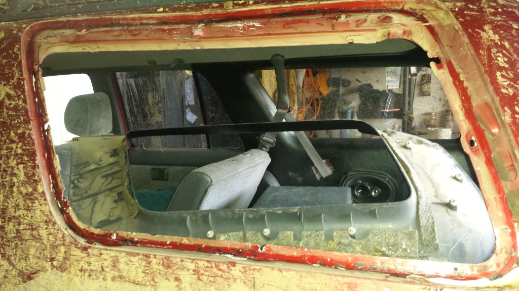

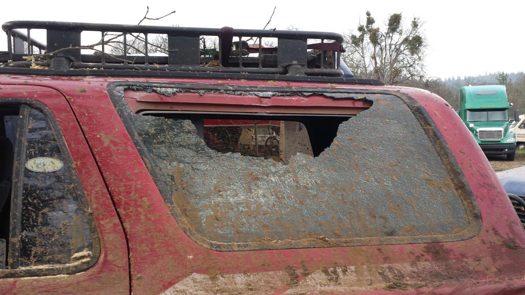

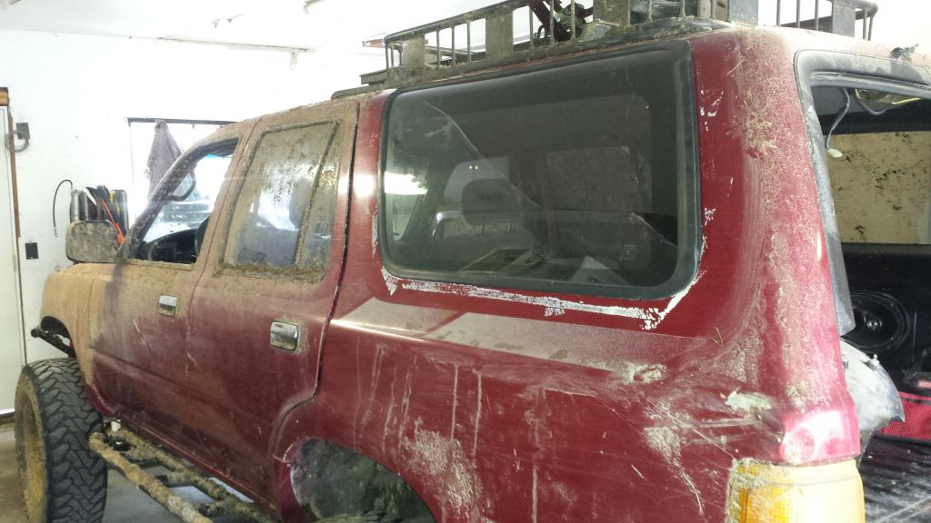

I have been wheeling a ton. Broke my driver window and rear side window out... Replaced them...

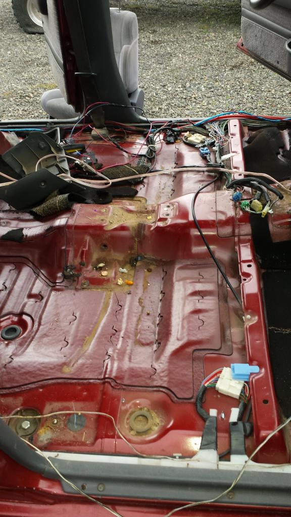

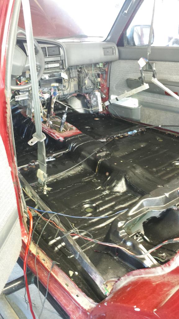

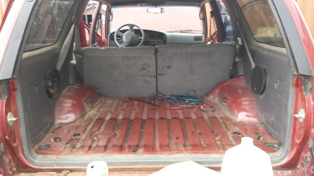

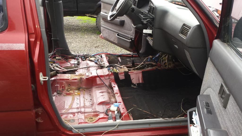

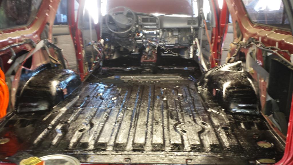

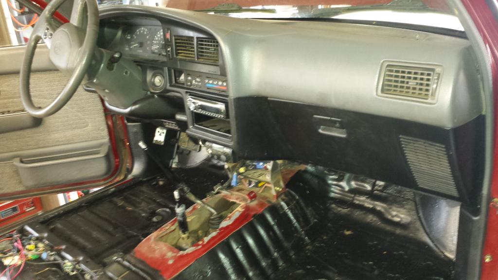

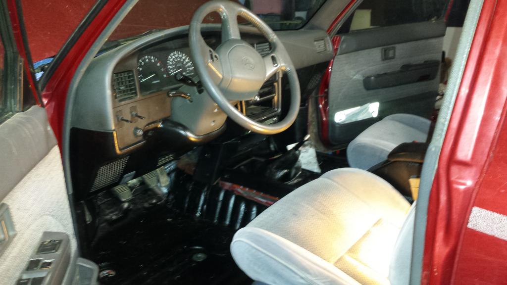

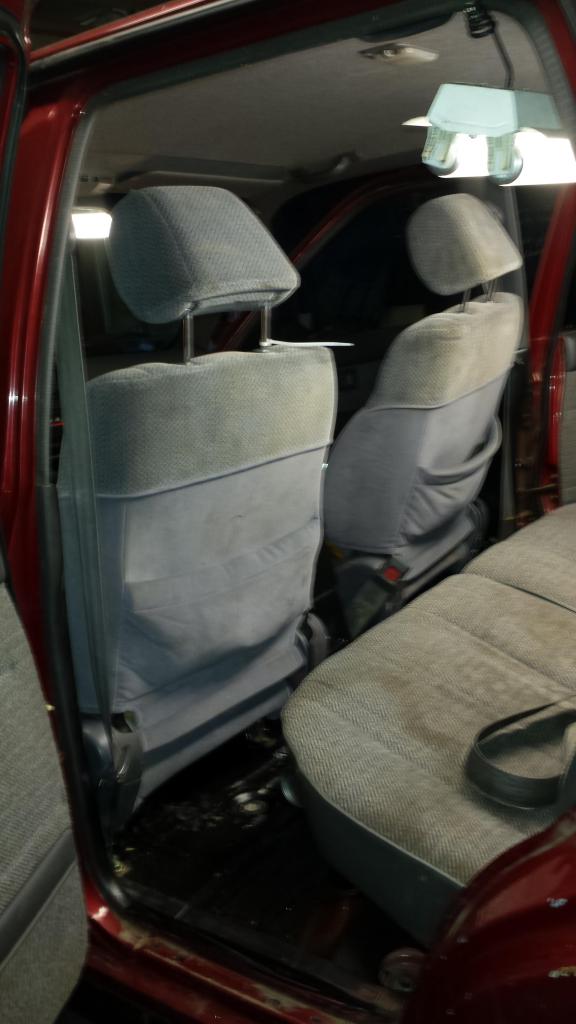

Stripped my carpet and Bed lined my floors..

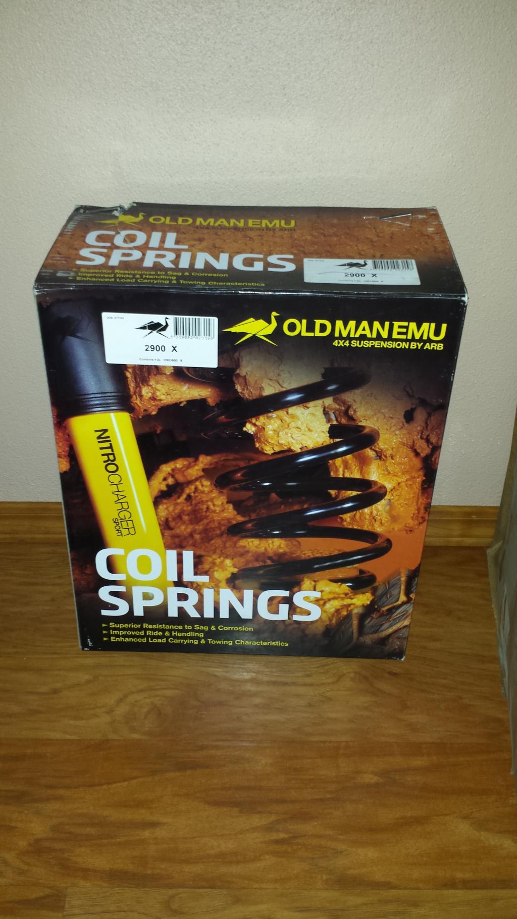

Well I won this gift certificate at the "Cruising the Woods" event up in tillamook state forest. So I decided to get some OME 2900 rear coils. Should be getting them here in a week or so. Then its on to cutting fenders and tucking my q78's.

Maybe I missed it, but what rear suspension setup are you running? Which coils and shocks? Stock links/arms? No pan hard drop bracket?
Old Feb 13, 2015 | 09:49 PM
  #93
andersej's Avatar
Joined: Dec 2011
Posts: 228
It's stock with some crappy aftermarket shocks I found in a junkyard.
New OME coils and bilstein 7100's in the near future.
Old Feb 14, 2015 | 06:31 AM
  #94
atlastrekker's Avatar
Joined: May 2009
Posts: 216
From: Sierra Foothills
I'm interested in your gas tank relocation. What all did you have to do? Was it motivated by wanting to make some longer links for the rear suspension?
Old Feb 14, 2015 | 10:33 AM
  #95
andersej's Avatar
Joined: Dec 2011
Posts: 228
Well you have to cut out the rear crossmember in the frame and grind it all down smooth. Then you have to cut approx a 1/4 inch or more off each side of the gass tank. Use some kind of angle iron and weld it to the frame. (Pretty sure I used 1inch angle) Then drill new mounting holes and bolt it up. Its all about checking all your clearances to get it right. Then you extend all your gas lines and electric wires...
Don't forget to replace the cross member with some sort of square tube or round tube to get that support strength back.
You are correct I did relocate to re do my suspension in the future... But mainly to gain that extra clearance underneath. The gas tank was the only thing that seemed to get hung up on the trails so I decided to move it.

Got my coils in!
