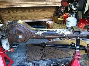

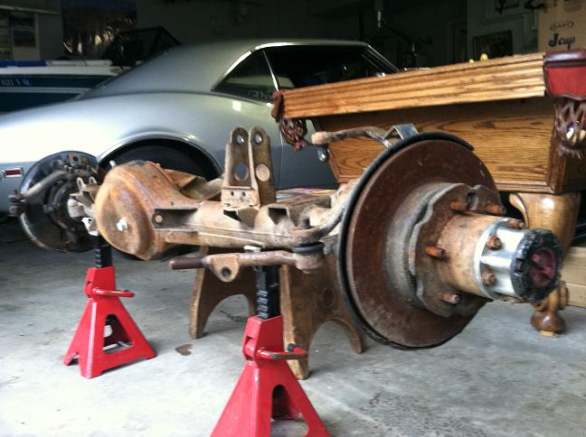

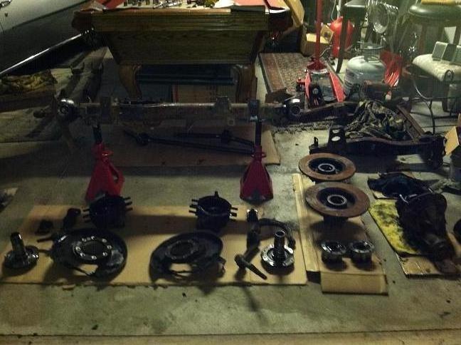

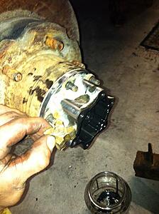

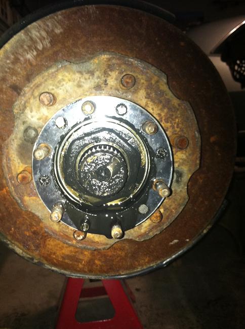

Got the axle torn down all the way, went smooth, no broken studs or anything. Found some water in the passenger knuckle but no rust or anything, can't wait to clean her out and grease it back up!
Cone washers were a snap using brass to hit them studs with, steer arm cone washers were a bit more of a pain!
Used the screwdriver/hammer method to get those 54mm spindle nuts off and worked great. Also noticed some previous screwdriver marks : p
And where I'm at now. Still have to clean all the parts out, cut everything off the housing I don't need and sand it down well. Kit will be here sometime next week for reassembly!

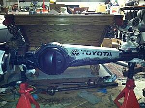

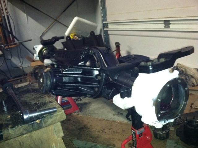

Extra brackets all cut off and smoothed out.
Primered and painted.
Burning in Sky's Toyota truss.
Grabbed a stock 8" diff with 4.88's out of a v6 4runner with only 150k on it!

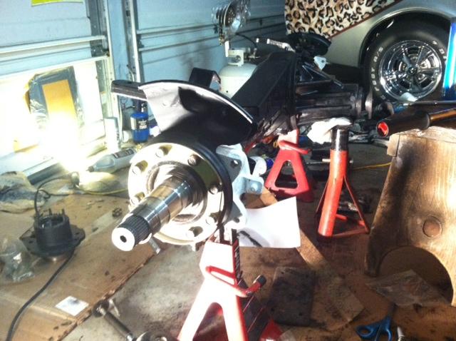

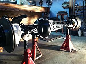

Reassembly! Full rebuild kit, bearings, seals, grease.

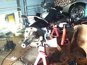

Torqued and assembled up to spindle!

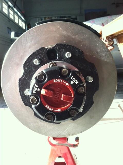

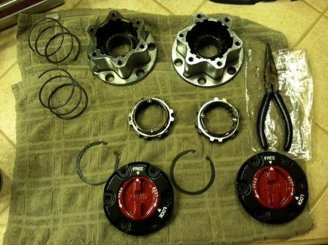

Locking hubs all tore apart, painted and cleaned up and lightly greased for reassembly.
All put together!!
Drool...

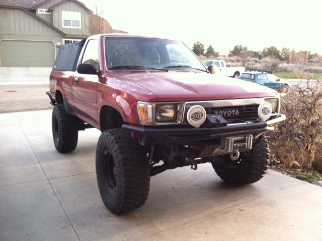

Well got all my hardware for my SAS, just building up my leaf spring setup and will get started soon!

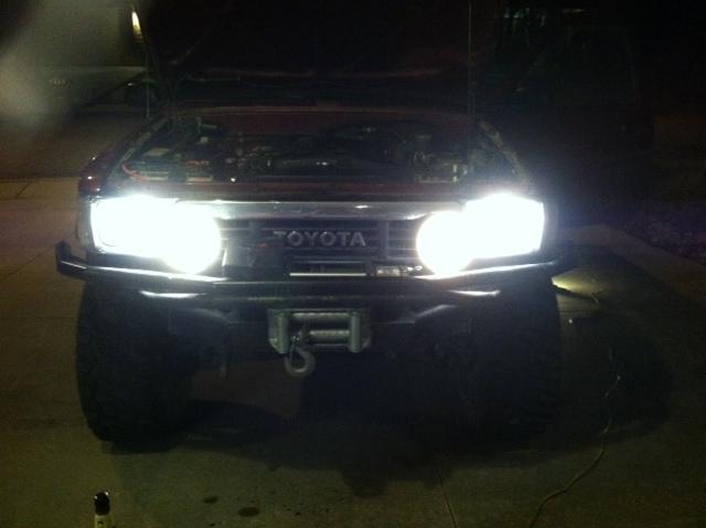

As for now put on some Hella 500FF driving lights!
Lit up!

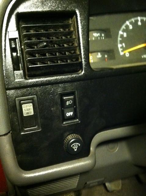

I got this stock toyota fog light switch I wired in as well!

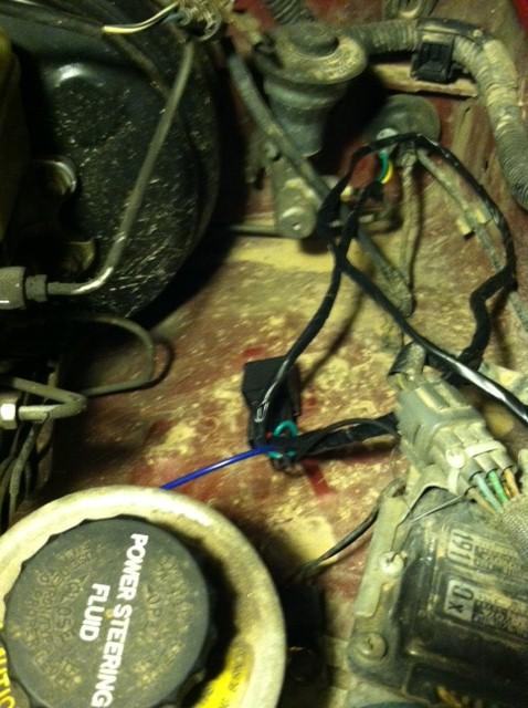

And where I mounted the relay.
Super bright and well worth it!

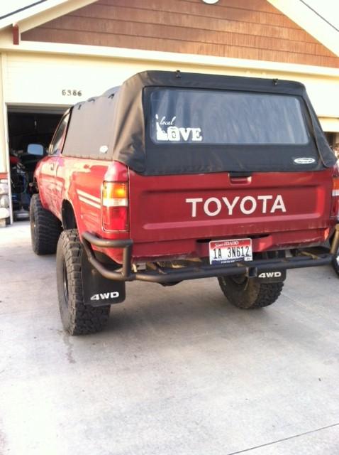

In the mean time I got my tax return and gladly spent it on a new softopper and TG rear tube bumper! Was going to fab up my own bumper but ended up going the easy way. Looks great and super stoked on the topper!!

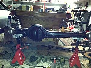

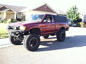

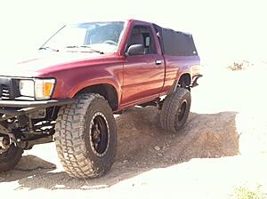

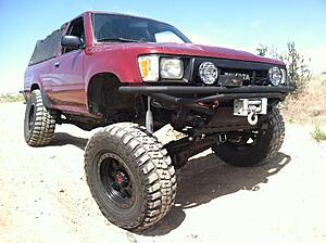

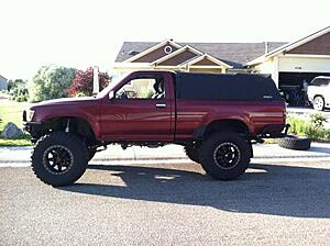

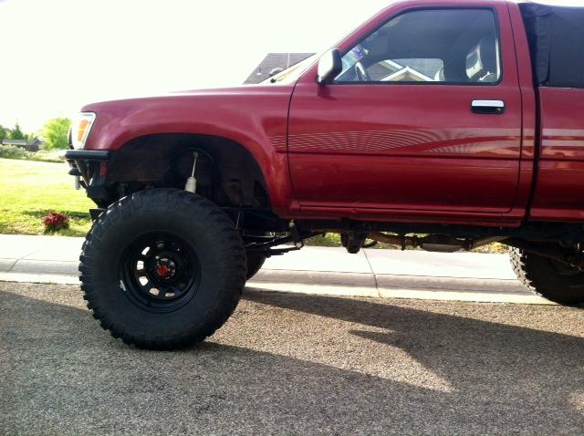

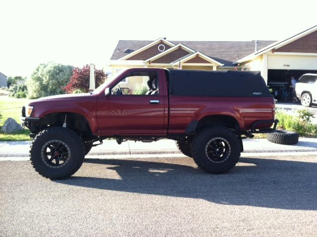

SAS Basically finished! Still need to set some bump stops and a few other misc things but super happy with the out come!
Here is my build thread if anyones interested!
https://www.yotatech.com/forums/f152...ow-sas-274848/
Few pics of how she sits now! It's about 3" lift in the rear and around 4"ish up front so planning on grabbing some chevy springs at the local yard to get the back up a bit and most likely be getting some 35's soon!
Also.. Went to the local pick n pull the other day and grabbed something pretty special for only $80!! Factory E-locker with 4.30's, factory switch, most of a harness, and 4wd ecu! Pretty stoked!

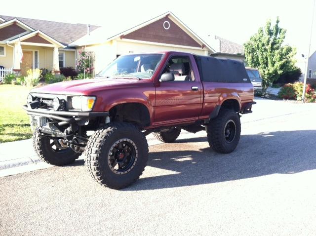

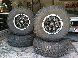

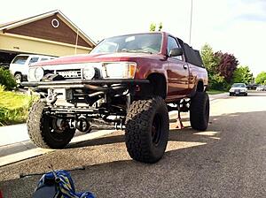

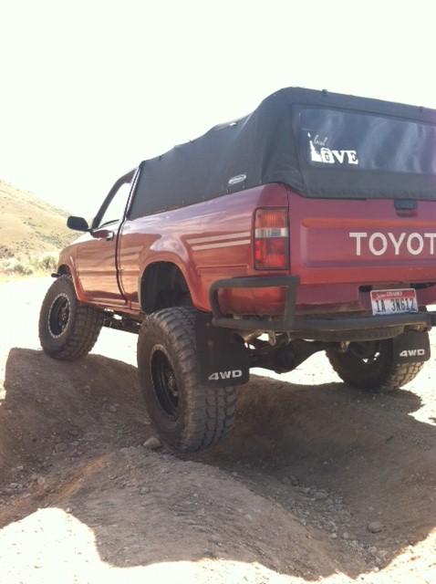

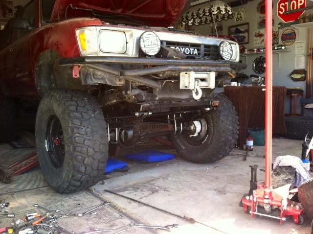

Well... Decided against buying the 33's because I found a great deal on CL.. A set of Federal Couragia M/Ts on some new Fuel Trophy wheels.. 35x12.50R17.. I was hooked on the wheels and was instantly drawn in haha..
Tread looks around 80-90% and the wheels are in great condition. Both are only about a year old as well..
I had to buy some of those skinny lug nuts with the special socket to put them on which was a little extra $$ but oh well I love the look.
Need a little extra lift in the rear because I can tell they'll rub when compressed

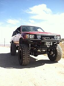

Flexing the new setup out! Rear flex is slacking, need some chebbies.. No rubbing at all! Really need to get a less drop pitman arm and get my bump stops in place though!
