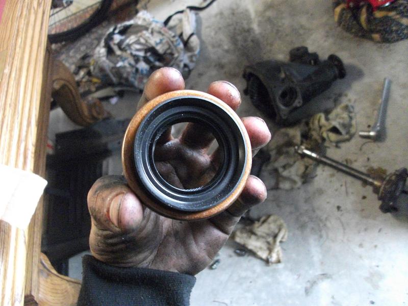

Removed the 4 bolts, 17mm I believe, off my old diff and began to pull the side axle out. Theres a small clip pin that holds it in place so a few hits with a mallet it pops out quite easy.
Do not forget to get an oil seal! The ADD diff does not have the seal directly in the housing. Instead it's in the axle shaft itself. I bought mine on amazon for $8 (Part #SKF13725).

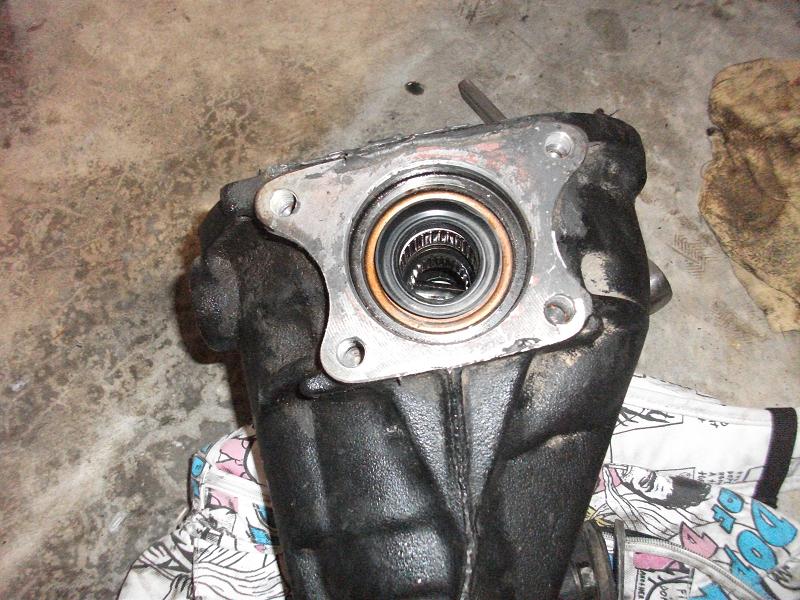

Installed.. As for putting it in; I placed it in the diff and used a pvc pipe and placed it around the rubber seal/directly on the metal edging and hammered it down in. Very easy just need to have the correct size pipe to fit!
Non ADD side axle shaft into the 4.88 pod. Again the clip will get stuck when trying to slide it in. Another few hits with a mallet will get the job done. RTV inbetween both parts as well.
Install is the same as removing. For me it took 1/5 of the time to put it back in than taking it out. I held out on putting oil in because I wanted to make sure the RTV would dry. Probably would be a good idea to let it dry overnight, put in oil before putting it all back together but like I said, needed to drive to work in the morning and couldn't.
