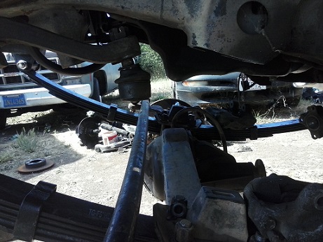

Attached Thumbnails 94 4runner-cam00008.jpg   94 4runner-cam00009.jpg   94 4runner-cam00014.jpg

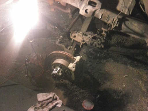

Attached Thumbnails 94 4runner-cam00015.jpg   94 4runner-cam00016.jpg   94 4runner-cam00017.jpg

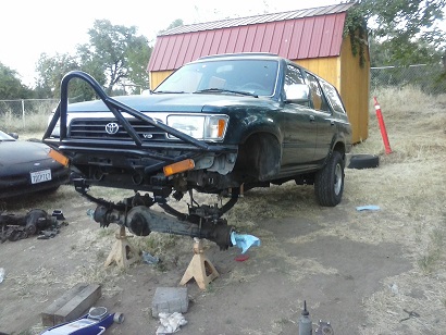

im going to try chevy 3/4 or 1ton rear 63's 2" blocks an 7" shackles see were it sits if it takes any more then that to match my 5" front springs ill just buy rear springs
lol it was all going good with the front end till I found out the Tacoma I got the calipers/rotors off of at some point was swapped to the bigger brakes so I ended up with the 16+ brakes were as the Tacoma should have had the brakes for 15's

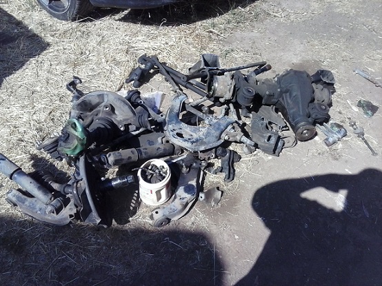

Attached Thumbnails 94 4runner-cam00020.jpg   94 4runner-cam00021.jpg   94 4runner-cam00022.jpg

had to change calipers/rotors they didn't fit 15inch wheels an I didn't notice last yr when I got the calipers/rotors some one at some point swapped bigger brakes on the truck I got them off of
so today went to the pnp found a 99 taco with the correct calipers/rotors for 15inch wheels then went to the auto parts store got brake hoses for 99 Tacoma an 2 rear brake hoses for 4runner to extend the hoses
the 4runner rear hoses are 14 5/8 inches
an the front hoses for the 99 Tacoma 22 1/2 inches

yay wheels fit with the 99 taco brakes had to grind alittle bit around the wheel mating surface but they clear a lot better then the others I had on there
ill keep the other calipers/rotors for when I need new tires ill switch to 17's an either 36's or 37's tires
