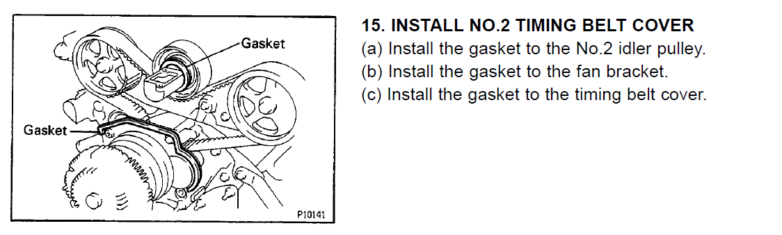

Hey all - I'm putting back together my 3vze after replacing the timing belt and water pump. In the FSM, it shows "gaskets" for the No.2 pulley, fan bracket, and timing cover. I didn't see any when I pulled it apart... Am I missing something? Are these gaskets for vibration dampening? Other? Also, where would I even get those replacements if others have before? Thanks for the help.

They are splash and dust seals.
The Ishino Stone overhaul gasket set I bought contained these seals.
I don't think all makers gasket sets contain them,
It's not the end of the world if they are omitted, but they help keep road dust out of the timing belt area.
