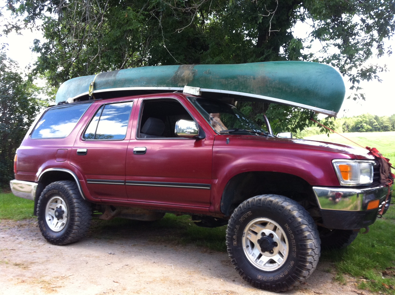

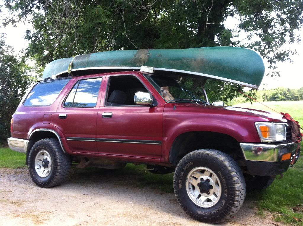

Here is a picture of my starting point. I will post some more pictures of my progression and thoughts on my approach.

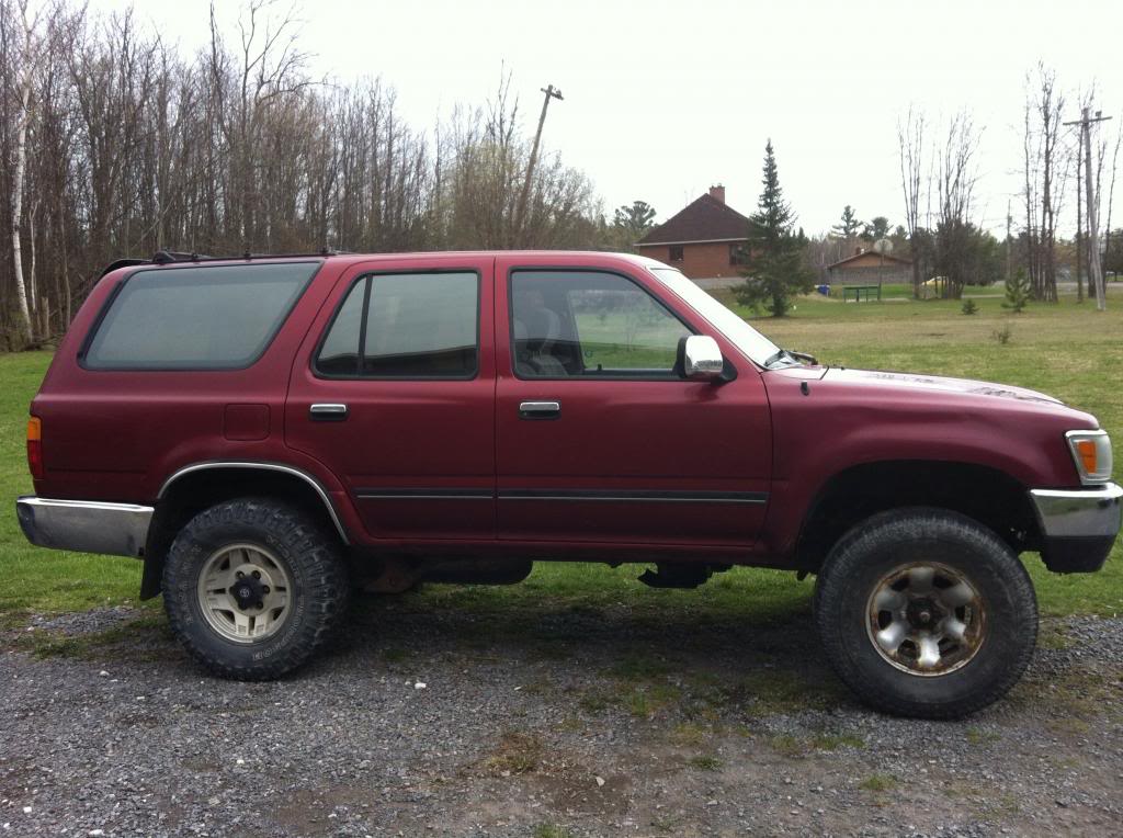

Here are some more pictures of her before her first surgery. During the first year of ownership I tried to go though most of the issues for general maintenance before doing any upgrades (i.e plugs & wires, cap & rotor, cv joints, tie-rods, clutch, etc, etc..)

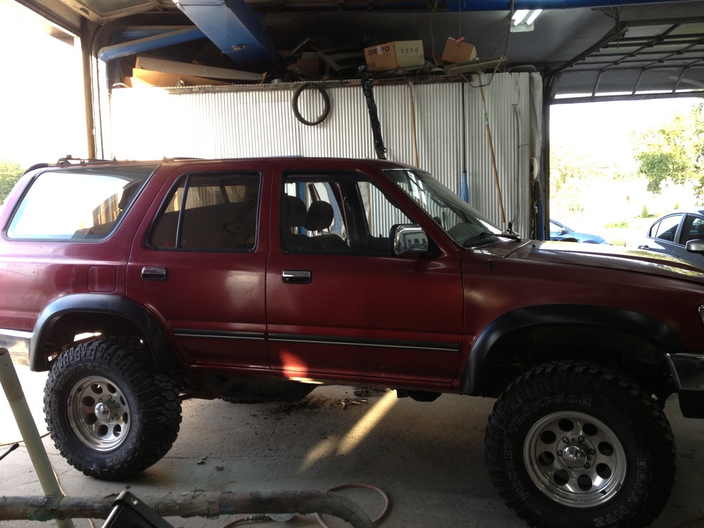

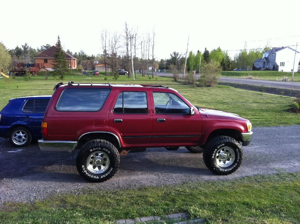

While the 4Runner is not my daily driver (and I wouldn't want it to be with the 3.0 under the hood ) I wanted to ensure that throughout my build the on-road drivability was not severely compromised. I mostly use the 4Runner as my work horse, for camping excursions, and for off-road trail running.
My first upgrade came when one of the old stock size (31") Mickey Thompsons finally blew out. I had been searching the forums trying to figure out what the largest size tire is that I could fit under the truck, knowing that I was ultimately interested in installing a suspension lift. Unfortunately I couldn't get a straight answer with some claiming a certain tire size is fine while others claiming that it rubs. A new set of rubber is not an insignificant investment and I didn't want to buy a slightly larger size tire to fit the stock setup only to want to upgrade as soon as I installed a lift. Sooooo... I just bit the bullet and ordered the OME 2" lift along with 16" MT wheels and 33" MT Baja MTZ's.
I ordered everything through one of the local 4x4 shops (National 4WD) after some price haggling. Thanks to the internet I was able to locate significantly lower quotes which National 4WD ultimately was willing to match if I would give them the labour for the install. Initially I had wanted to do the install myself (I have changed out the suspension on other vehicle before) but I was not familiar with the tortion bar setup and decided to take them up on the deal. In the end I was happy that I did because the panhard bar bushings in the rear were worn out and the end was actually broken. They were able to fab me up a stronger end piece with urethane bushings for about a 1/4 the price quote for a replacement. I have never used a welder so there was no way I could have done this myself.Name:  8B31D835-77E1-40B2-A635-95DA37B11DB1_zpskjeju9jw.jpg

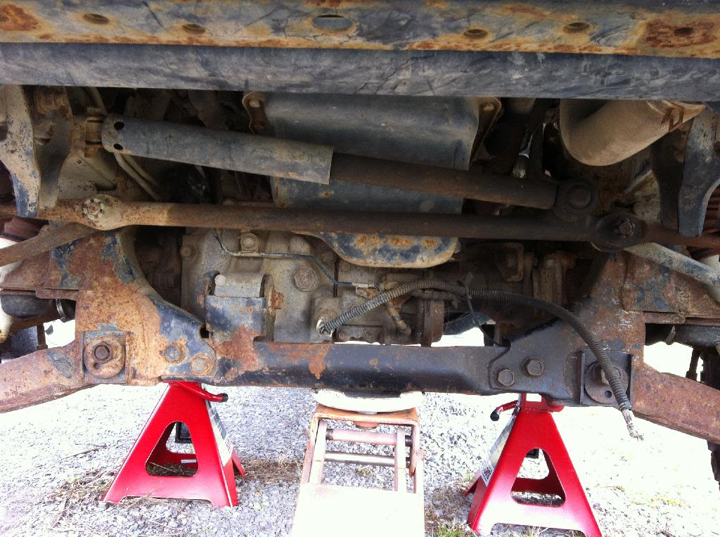

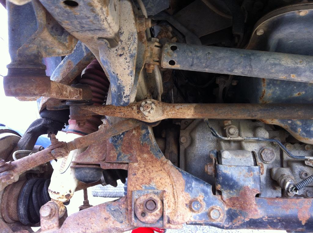

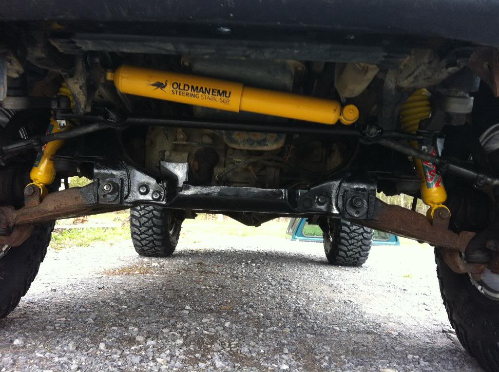

Before sending her to the shop for the lift kit I installed new tie rod ends, pitman arm, idler arm, and painted up some of the linkage parts.

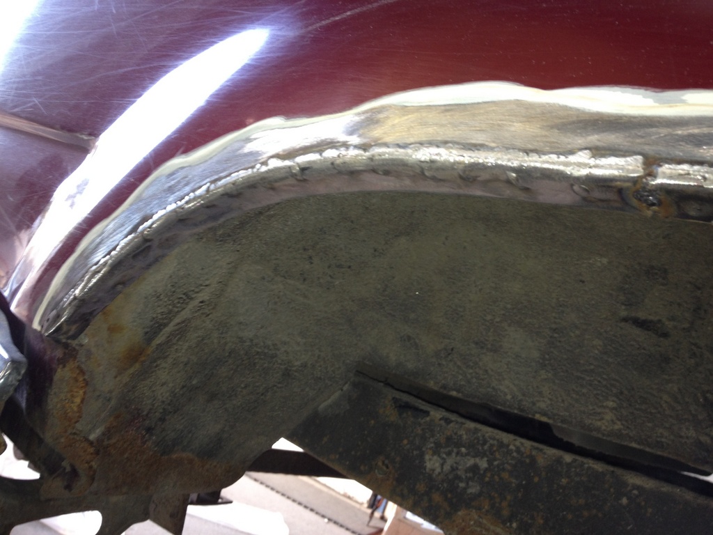

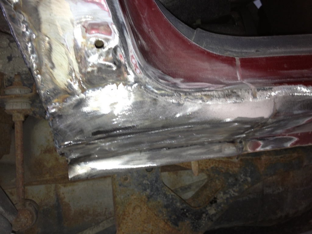

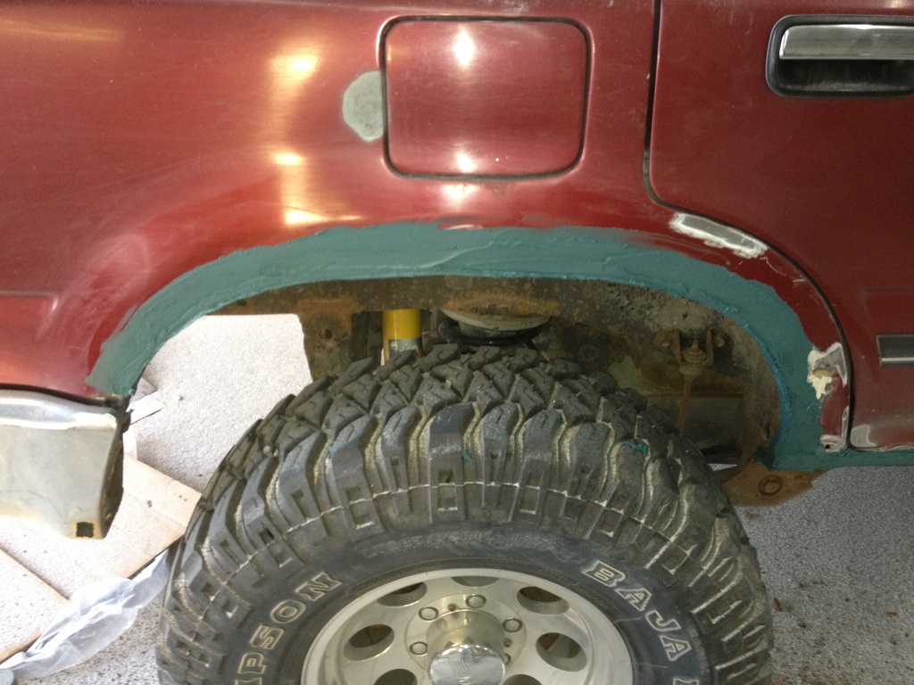

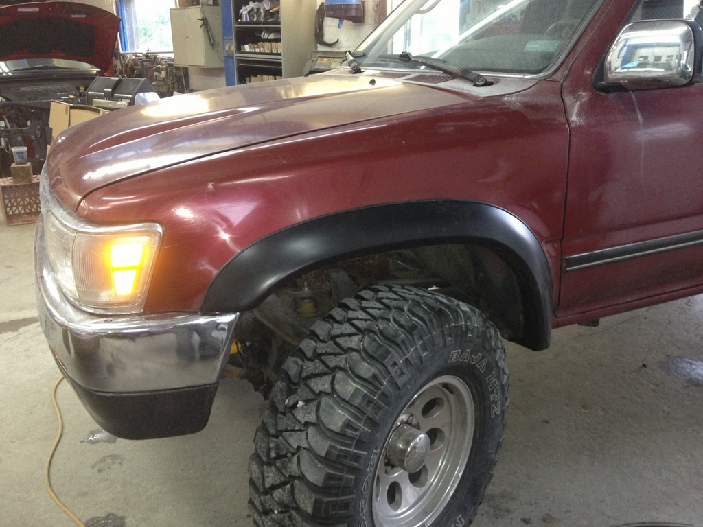

My next upgrade was to install Bushwaker fender flares to better cover the tires and provide some protection to the fenders against debris kicked up by the tires. Before covering the fenders I addressed some of the rust issues on the rockers and replaced the fender lip. Otherwise there wouldn't have been much to screw the flares to. Luckily I have a friend that is very capable and gave me a hand.

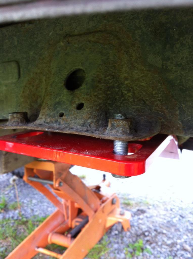

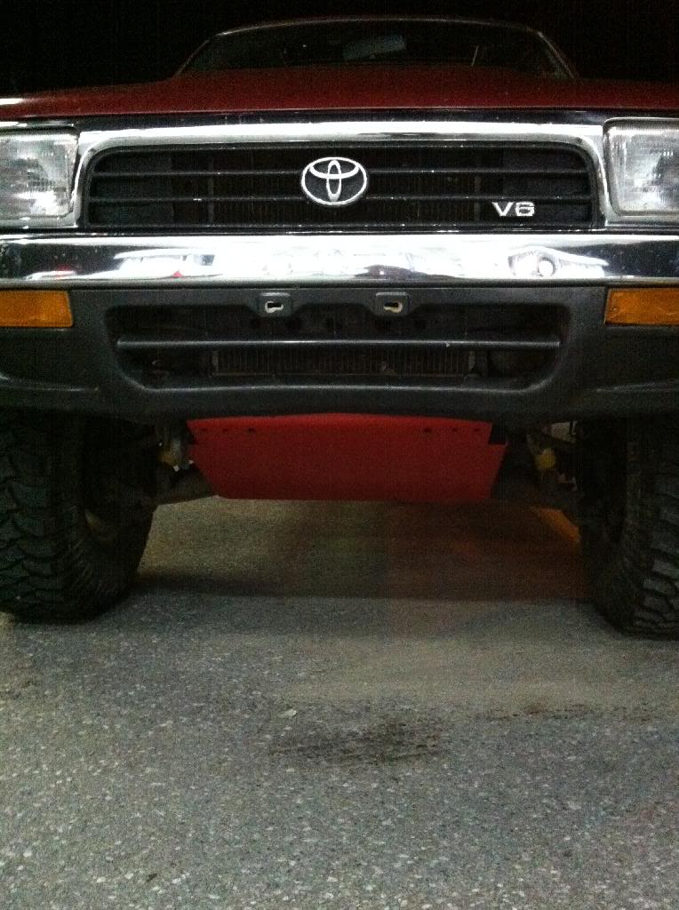

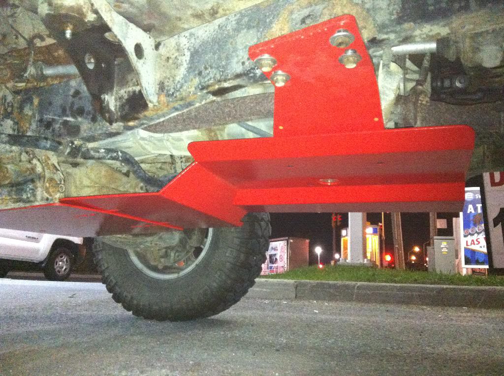

Next up I installed the Budbuilt 3 piece combo ( Front skid, cross member, and belly pan). I ran into a bit of a problem when installing the skids. It turned out that I was sent a cross member with a 1" driveline lift. I discovered this when trying to bolt up the cross member- the transmission was bottoming out on the floor before I would get it flush with the frame.

I spoke with Bud himself and he is a great guy!! He took the time to point me in the right direction and even gave me his cell number so I could give him a call anytime I had a question. He advised that I could either manipulate the floor where it was contacting to make some more space or install a body lift to make it fit. I had thought of installing a small spacer to make the difference but of course it's a better idea to create clearance. So opted to install a body lift.
So came my next decision- what size of body lift? I really don't like tall body lift and I wanted to keep the center of gravity as low as possible while avoiding things like steering shaft extensions, etc... I read through the forums to see what other guys were installing and in the end decided just to go with a 1" body lift from 4Crawler Offroad. So far I'm really happy with that decision. The resulting gaps are not very noticeable but it does get the body up off the frame allowing for a little more room underneath for working on things and will make it easier to clean mud off the top of the frame rail. It also created some space for my next upgrade, which is to install some rock sliders. Best of all the BudBuilts bolted right up after the lift!
