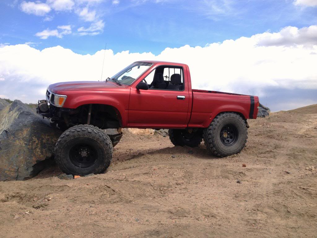

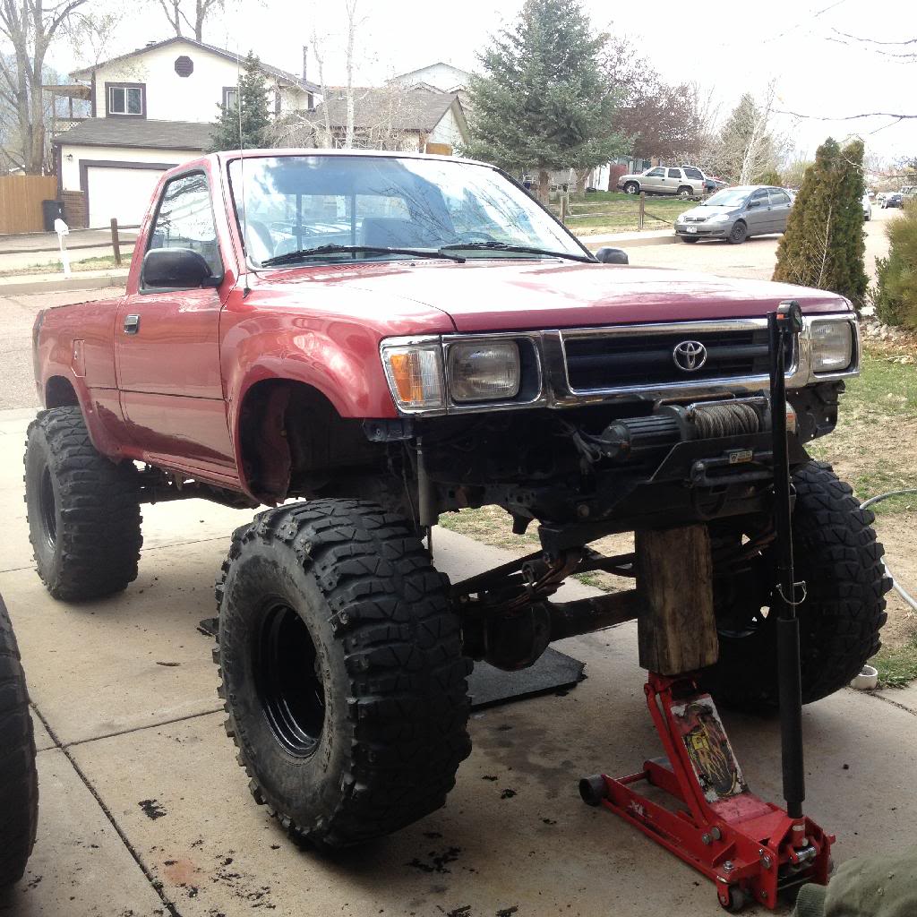

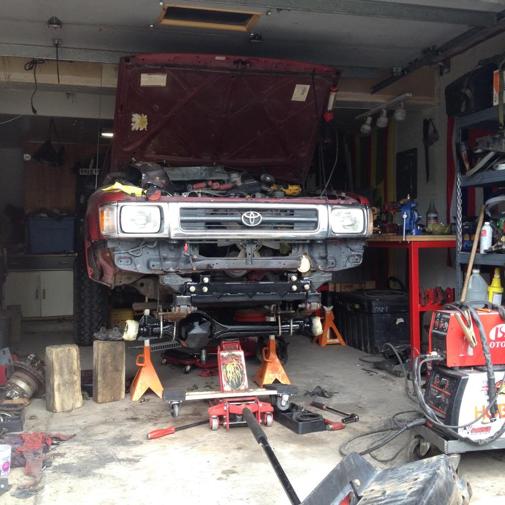

1992 Pickup, used parts that I stripped from my extra cab and other parts bought from TG.
SAS with 4" All Pro springs from old extra cab. Axles were from old truck also.

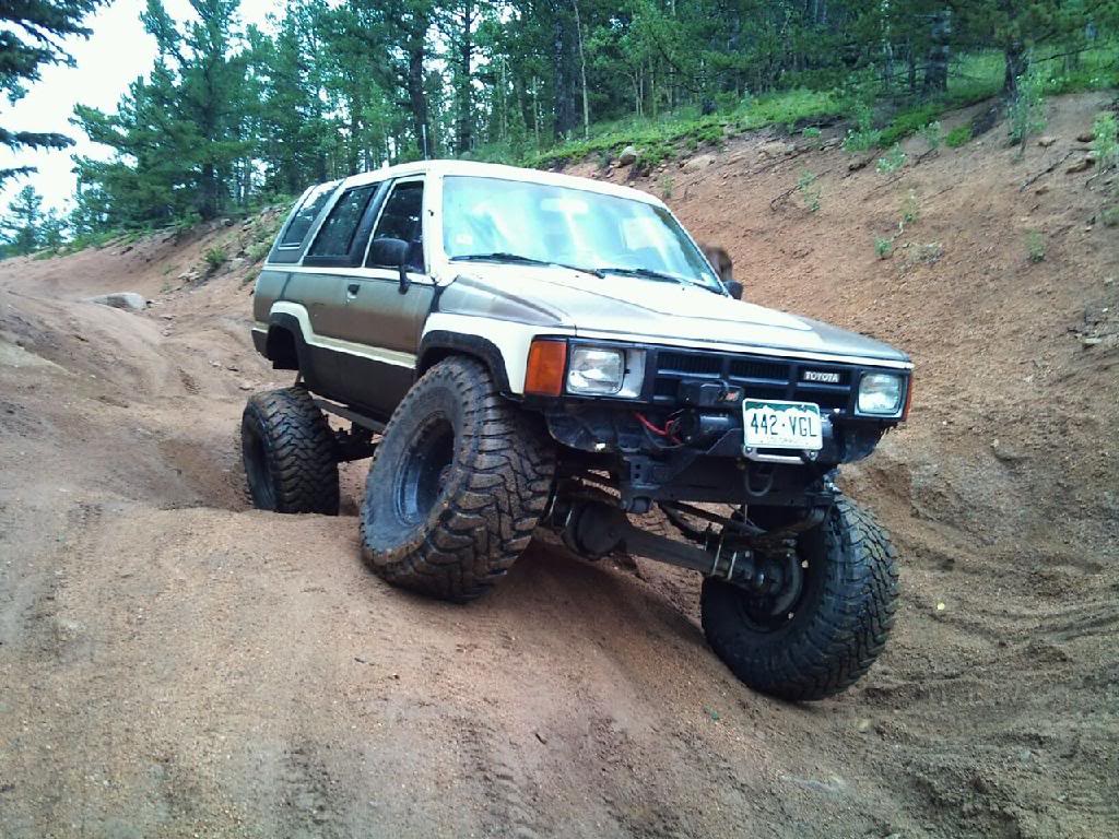

Decided to swap springs from my 4runner onto the pickup and vise versa.
4runner had RUF and the pickup rears in the back.

RUF and stock rears with one leaf added sitting on 37s

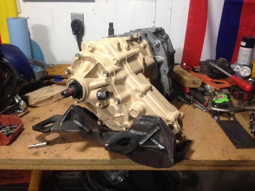

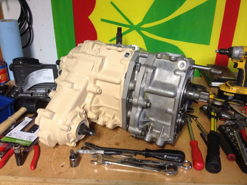

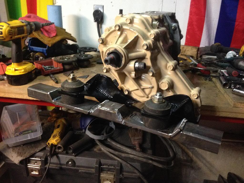

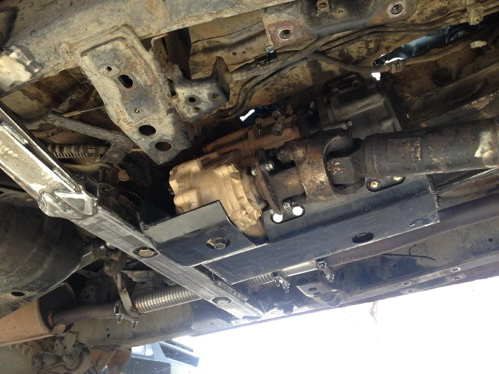

Dual cases 23 spline 4.7 in the rear. All TG

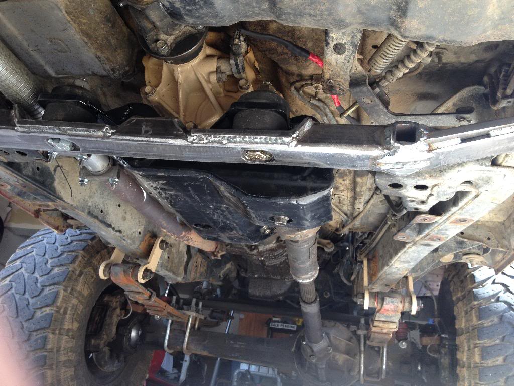

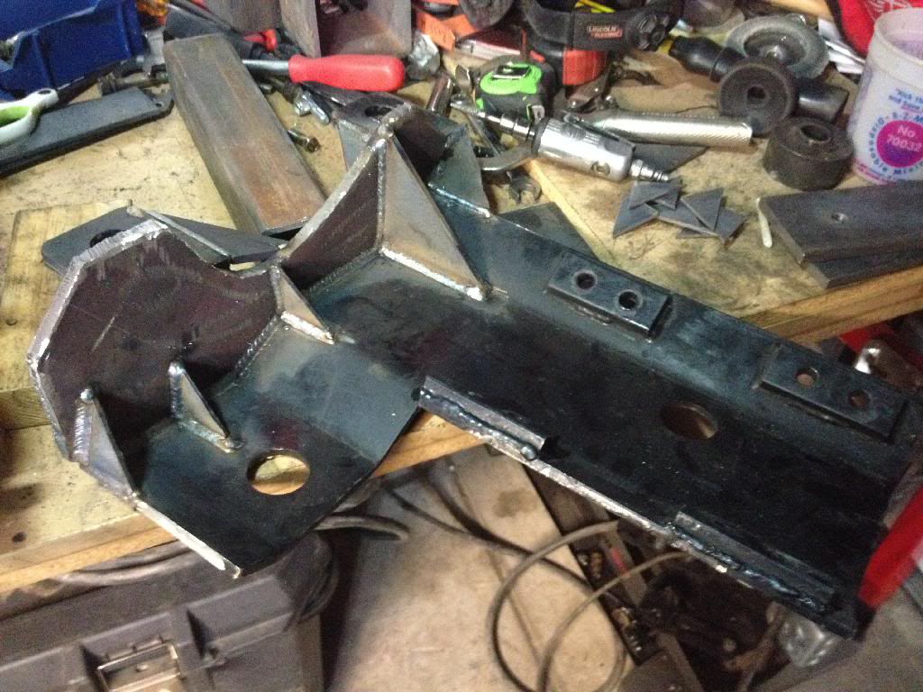

Custom crossmember using my old FROR skid

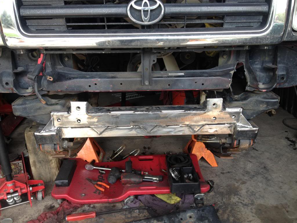

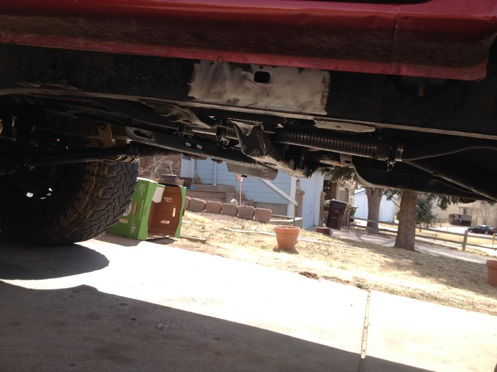

I made a thread in the fab section on this also

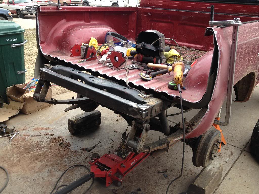

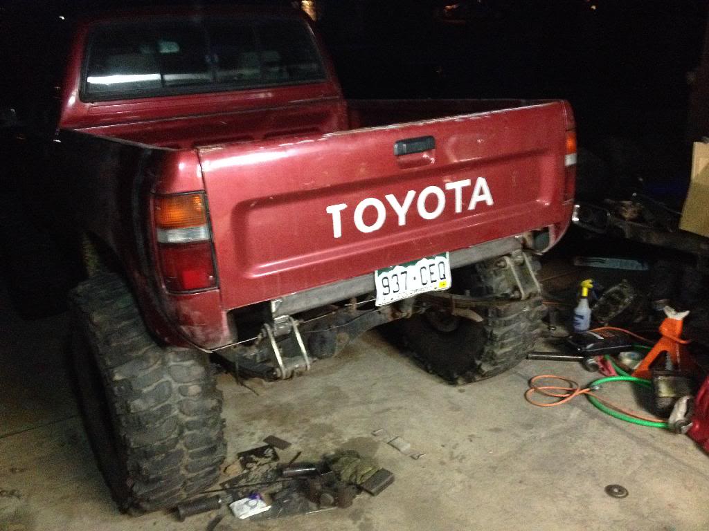

Also boxed the rear and made new shackle hangers

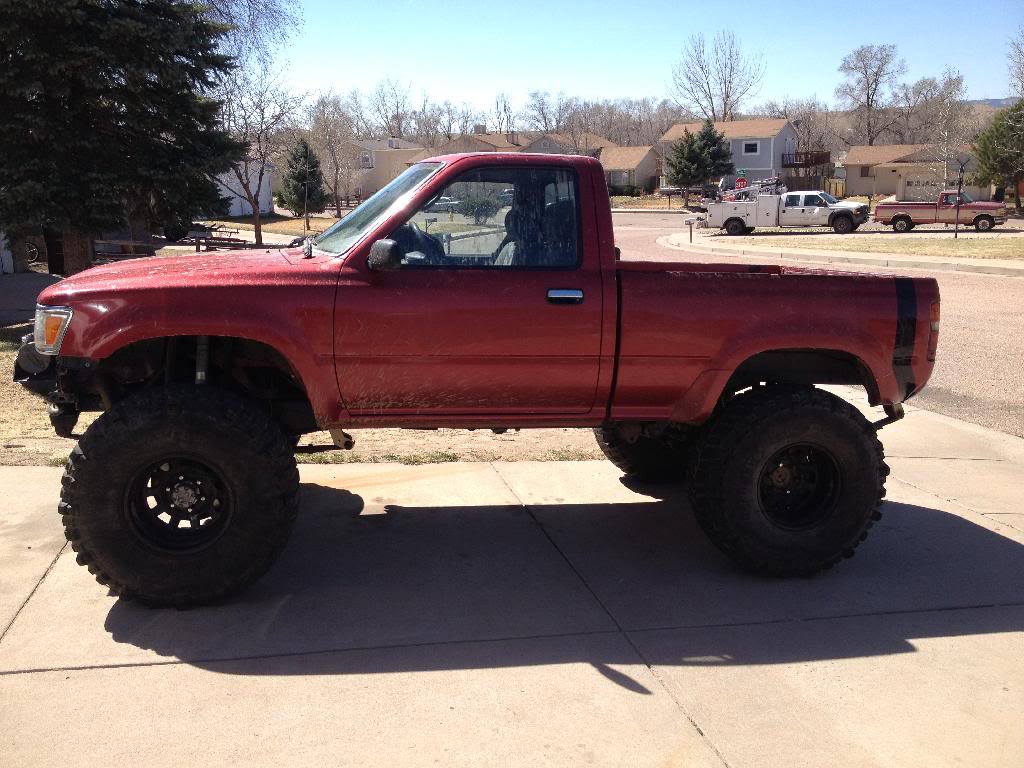

So far the duals have been the most expensive thing on this truck. I plan on doing the IFS hub swap and maybe some f150 rear springs. Sliders and bumper are also on the to do list.
Old Apr 24, 2014 | 04:56 PM
konayota86's Avatar
Joined: Apr 2010
Posts: 63

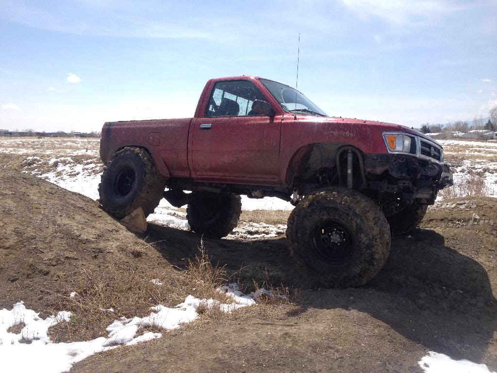

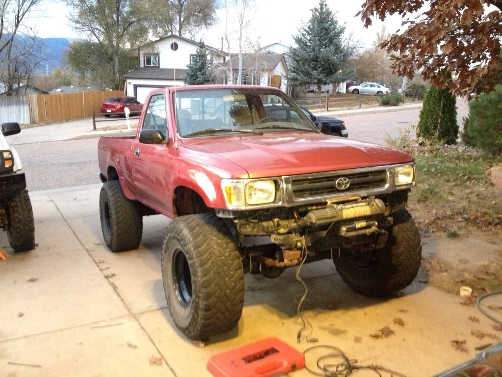

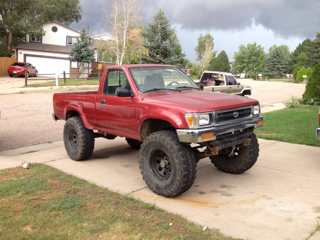

So as it sits, I have done the SAS using TG hangers, 5" boomerang shackles, 48" RUF with one leaf added, 85 front axle with 5.29s and Detroit locker, TG high steer, dual cases using TG adapter, 23 spline 4.7s, stock rear springs with one leaf added, 5" shackles, V6 rear 3rd with 5.29s and full spool, bobbed 15", ramsey 8.5e winch, 37" boggers.

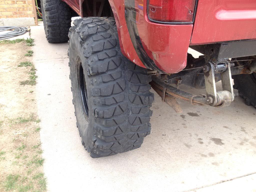

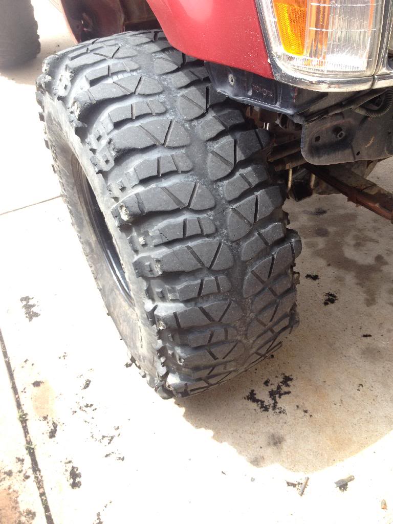

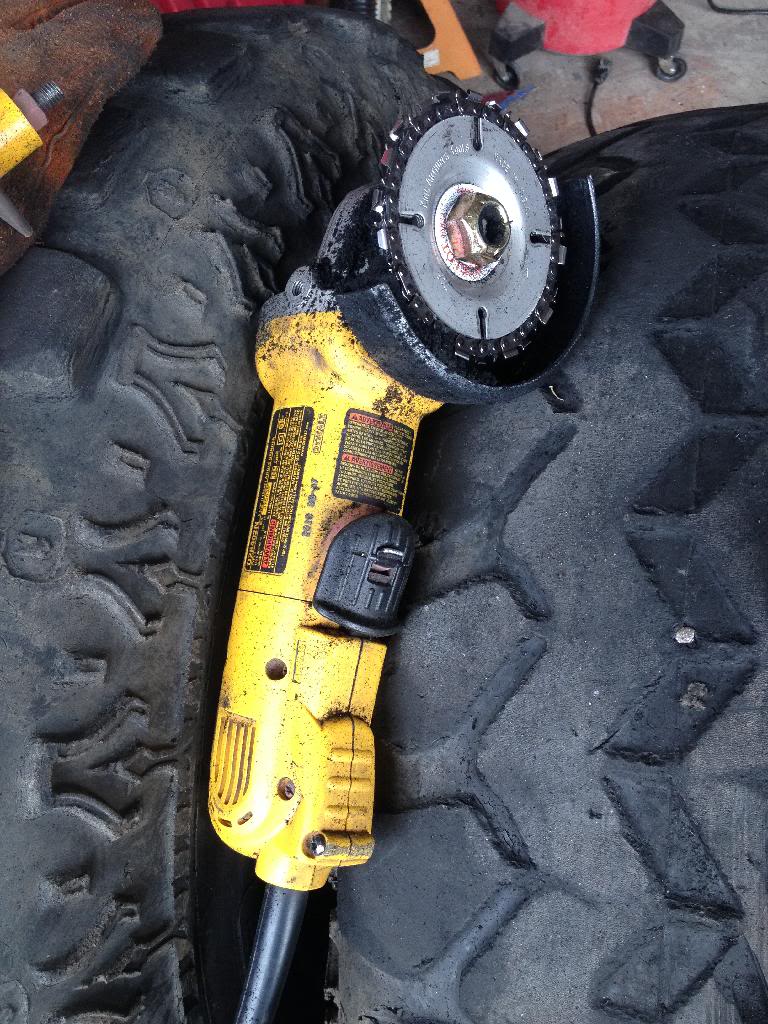

Just recently grooved the boggers. Fast and cheap

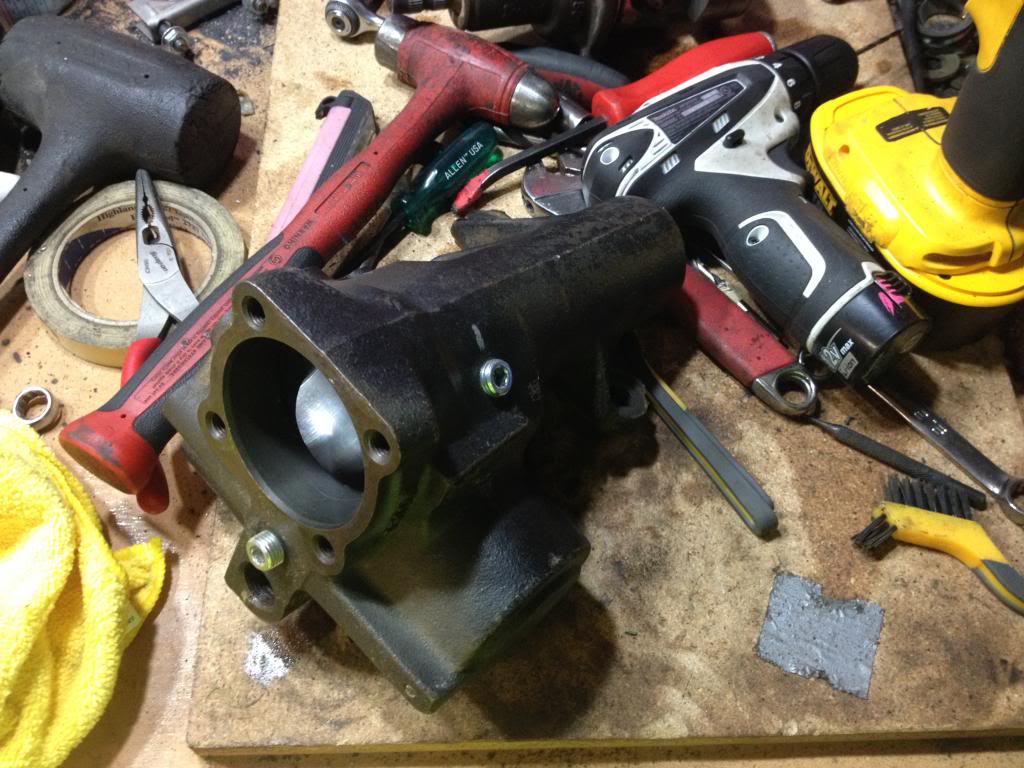

Still need to drill/tap gear box, move it forward and put on flat pitman arm.

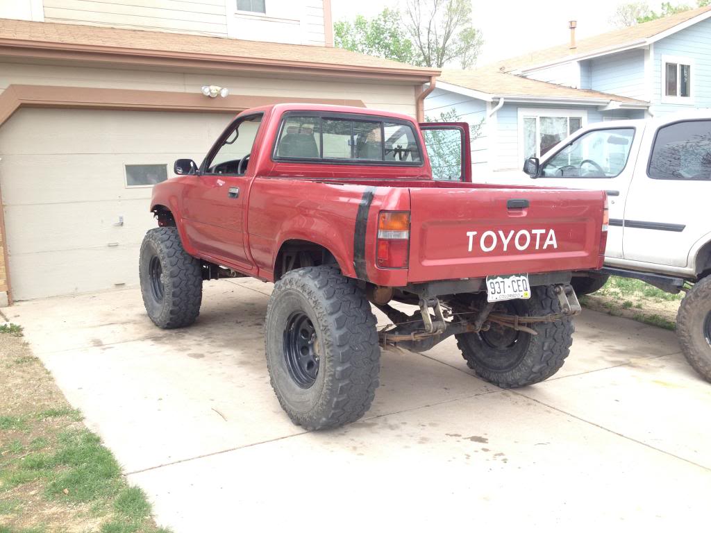

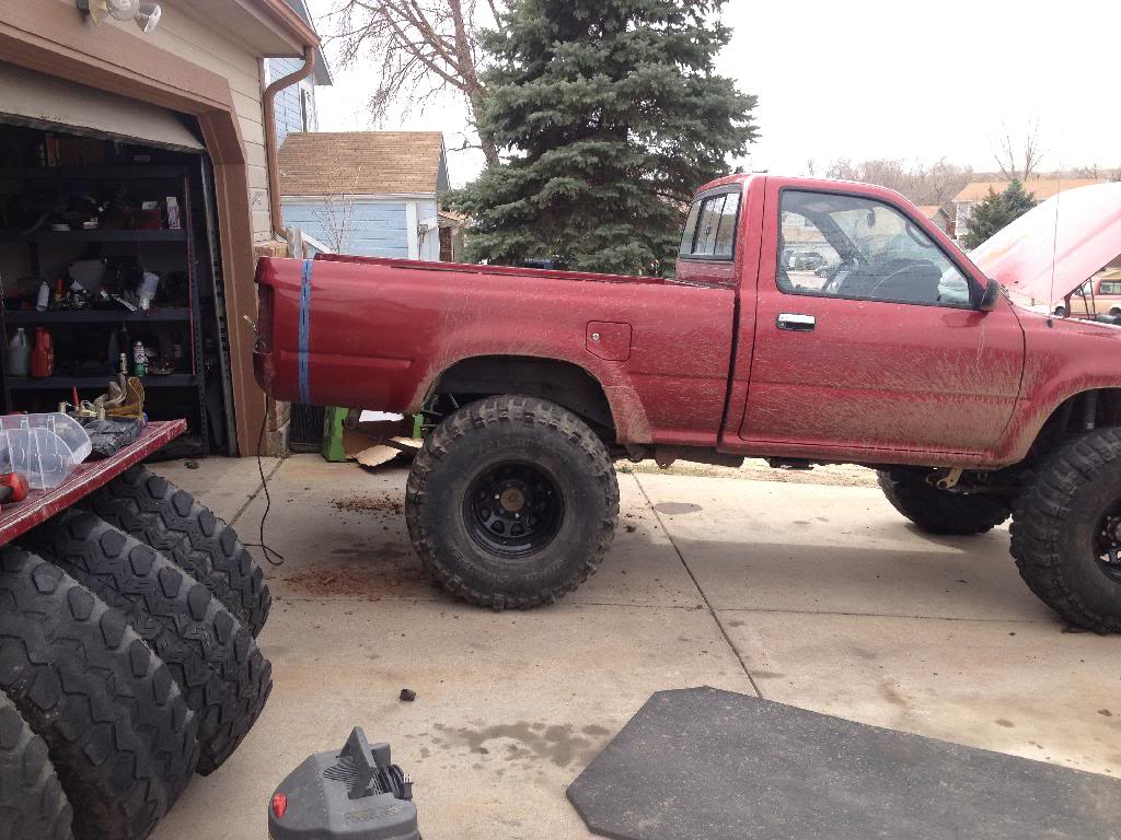

Haven't had time to do anything. I did order a set of TG longs though.
Also threw on better tires and trimmed the fenders. Got some 2x3 rec tube to build a rear bumper and sliders.

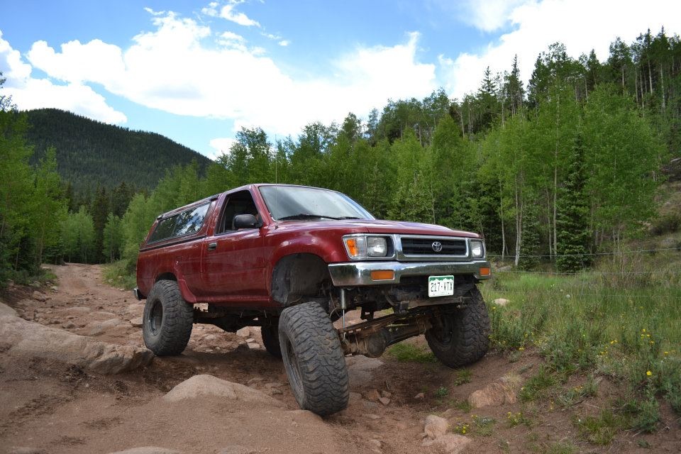

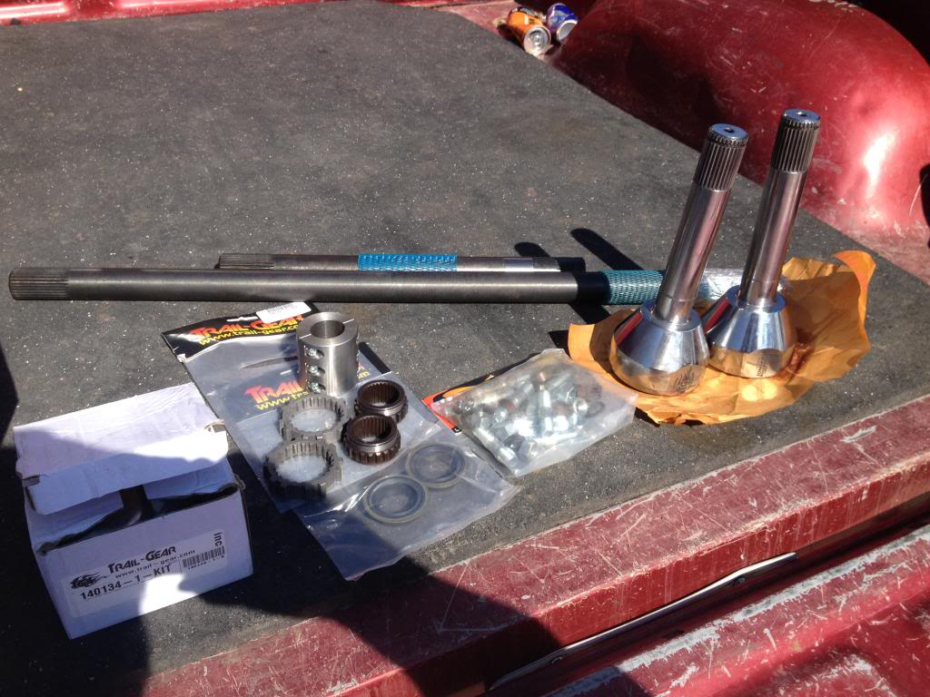

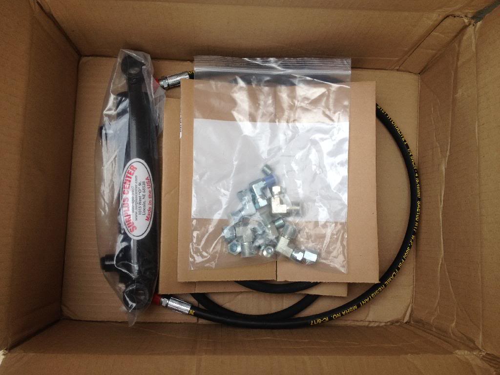

Always a good feeling when parts show up.

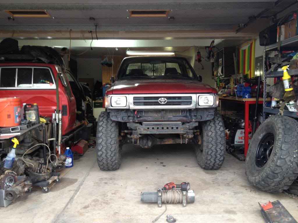

Old May 15, 2014 | 07:32 PM
konayota86's Avatar
Joined: Apr 2010
Posts: 63

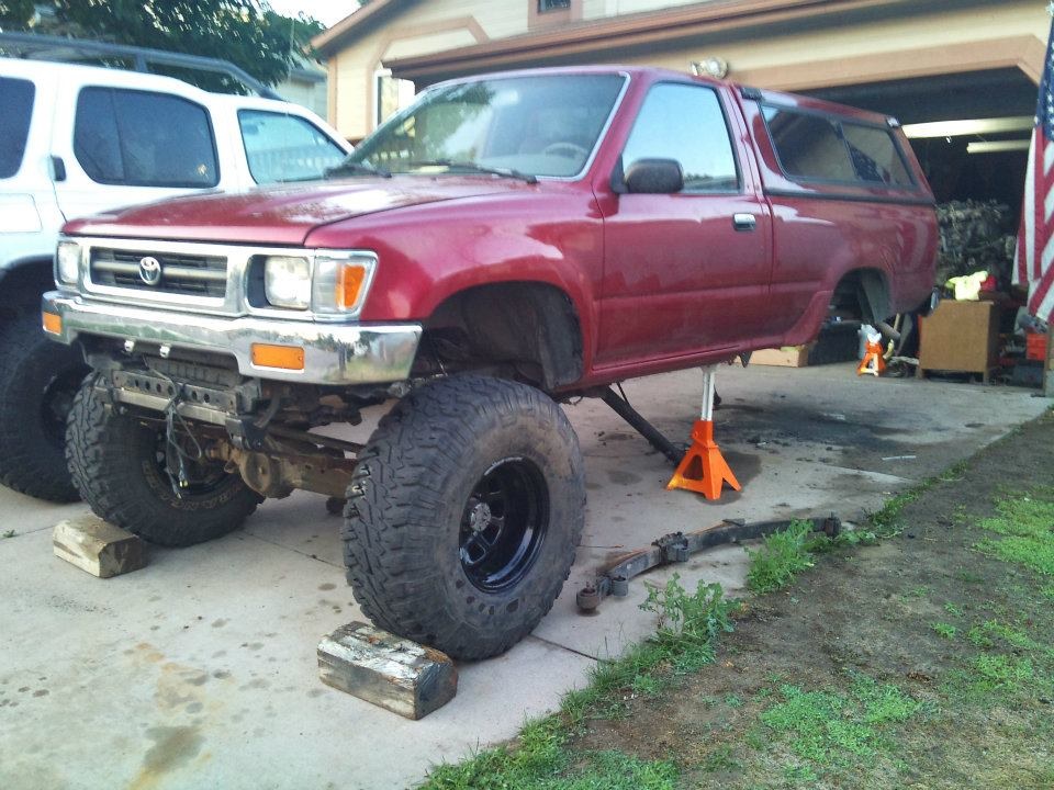

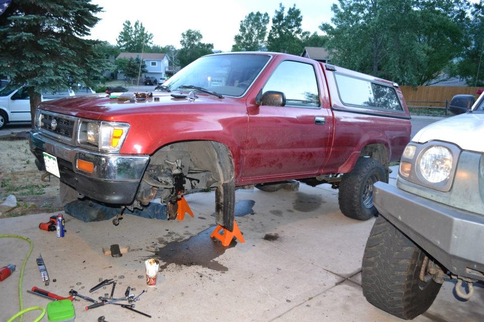

Parked and ready for teardown.

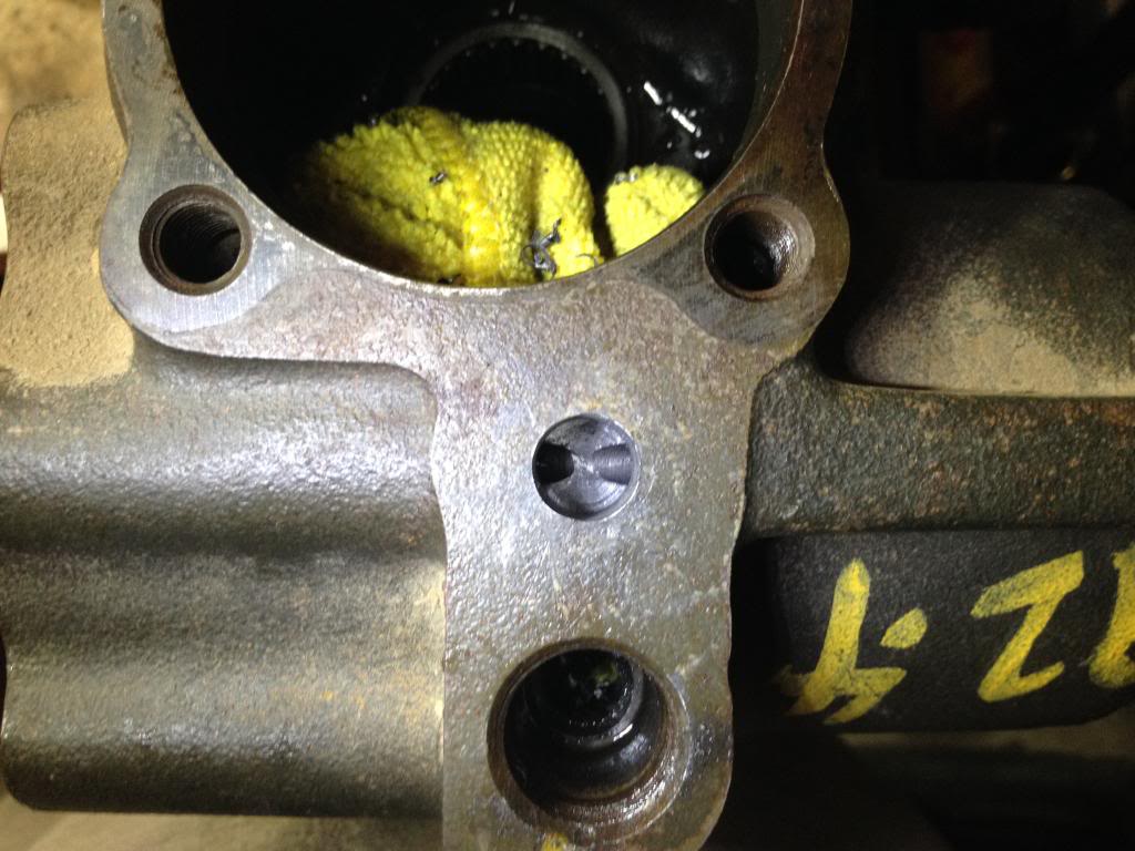

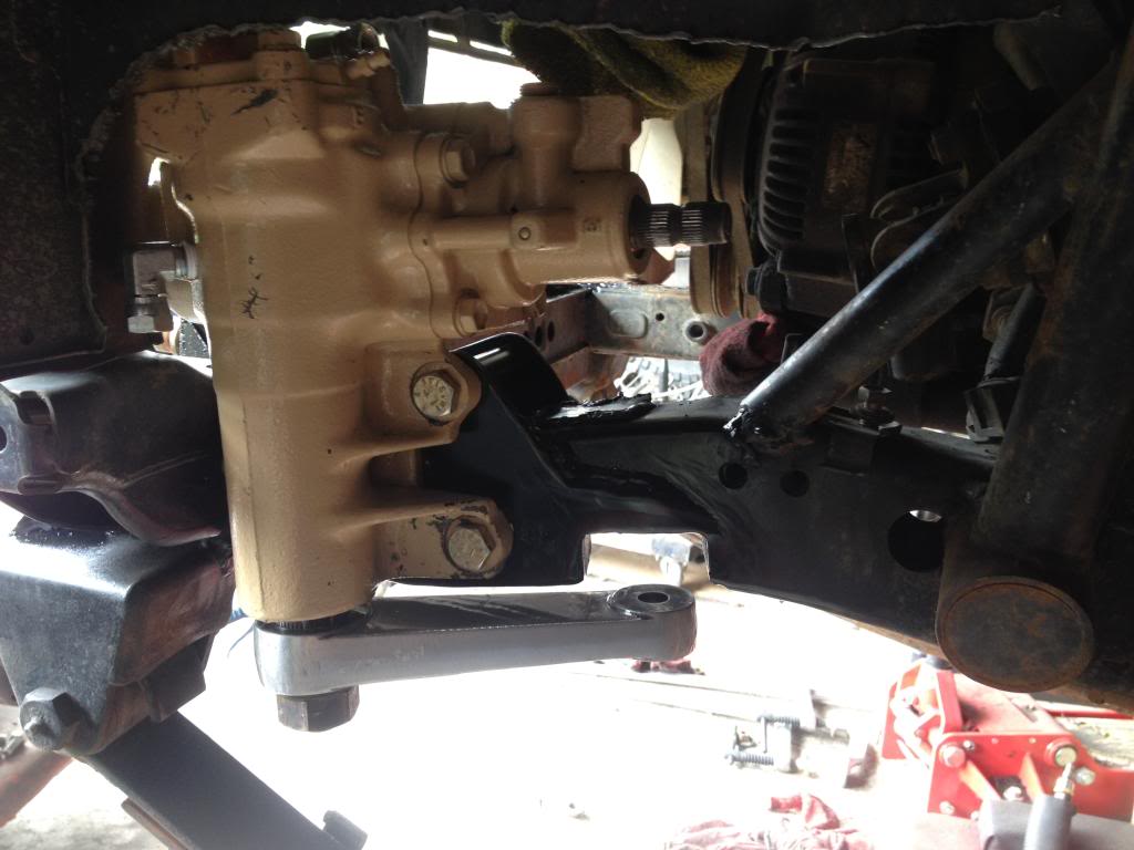

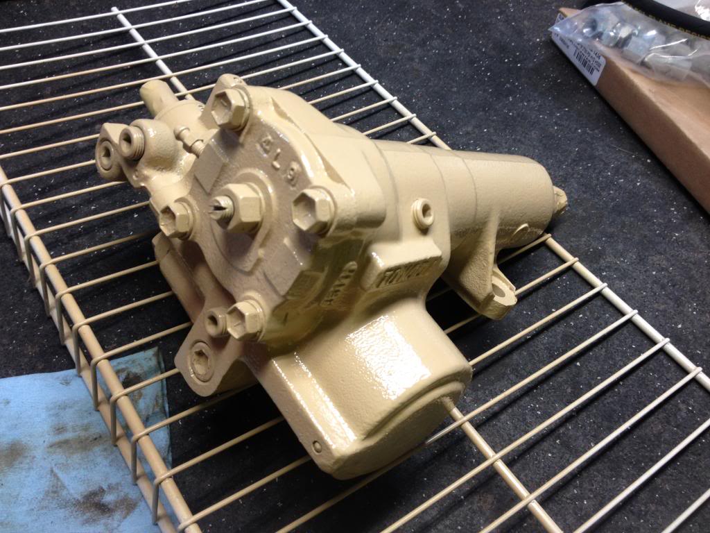

Gear box drilled/ tapped for hydro assist
Assembled and painted
