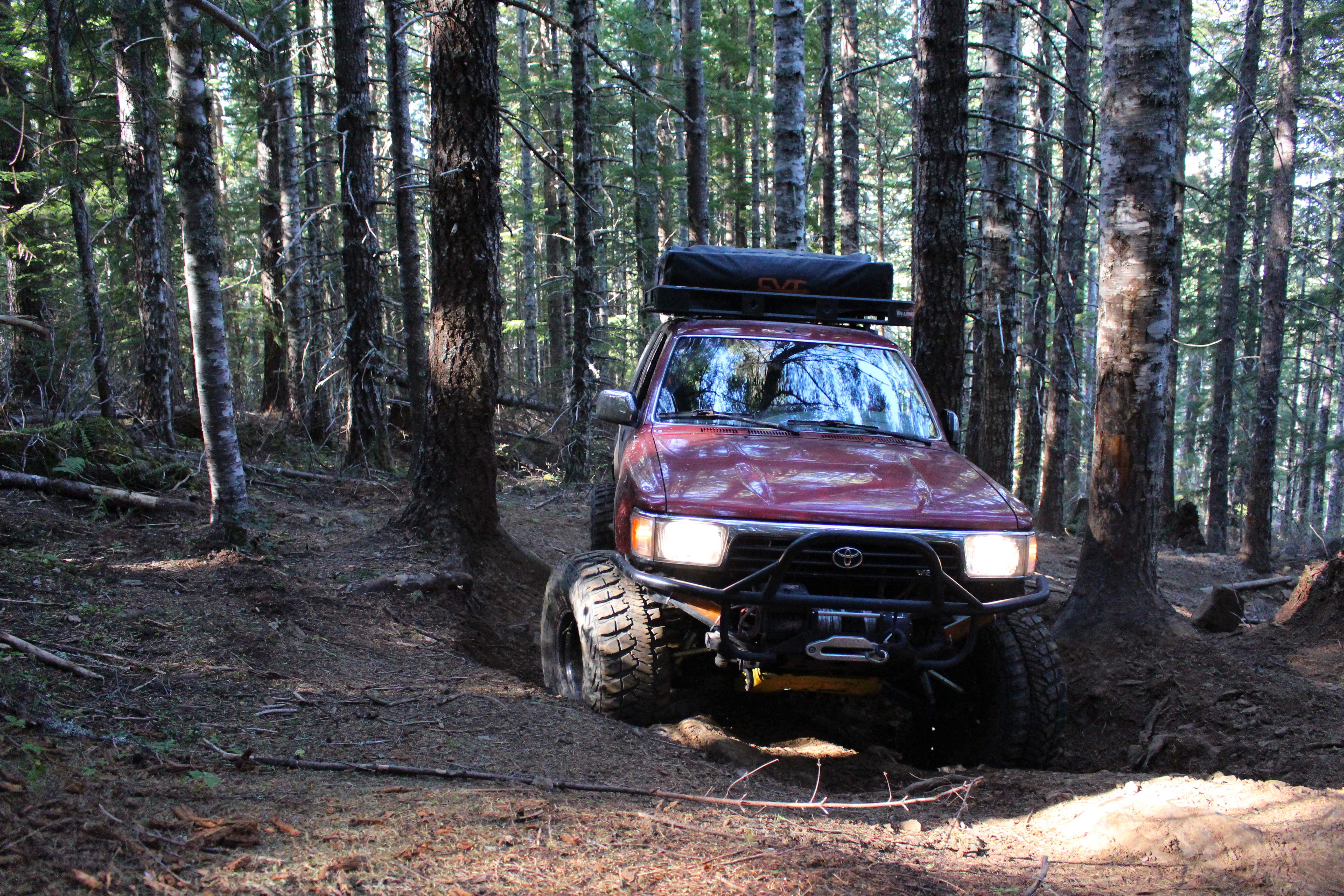

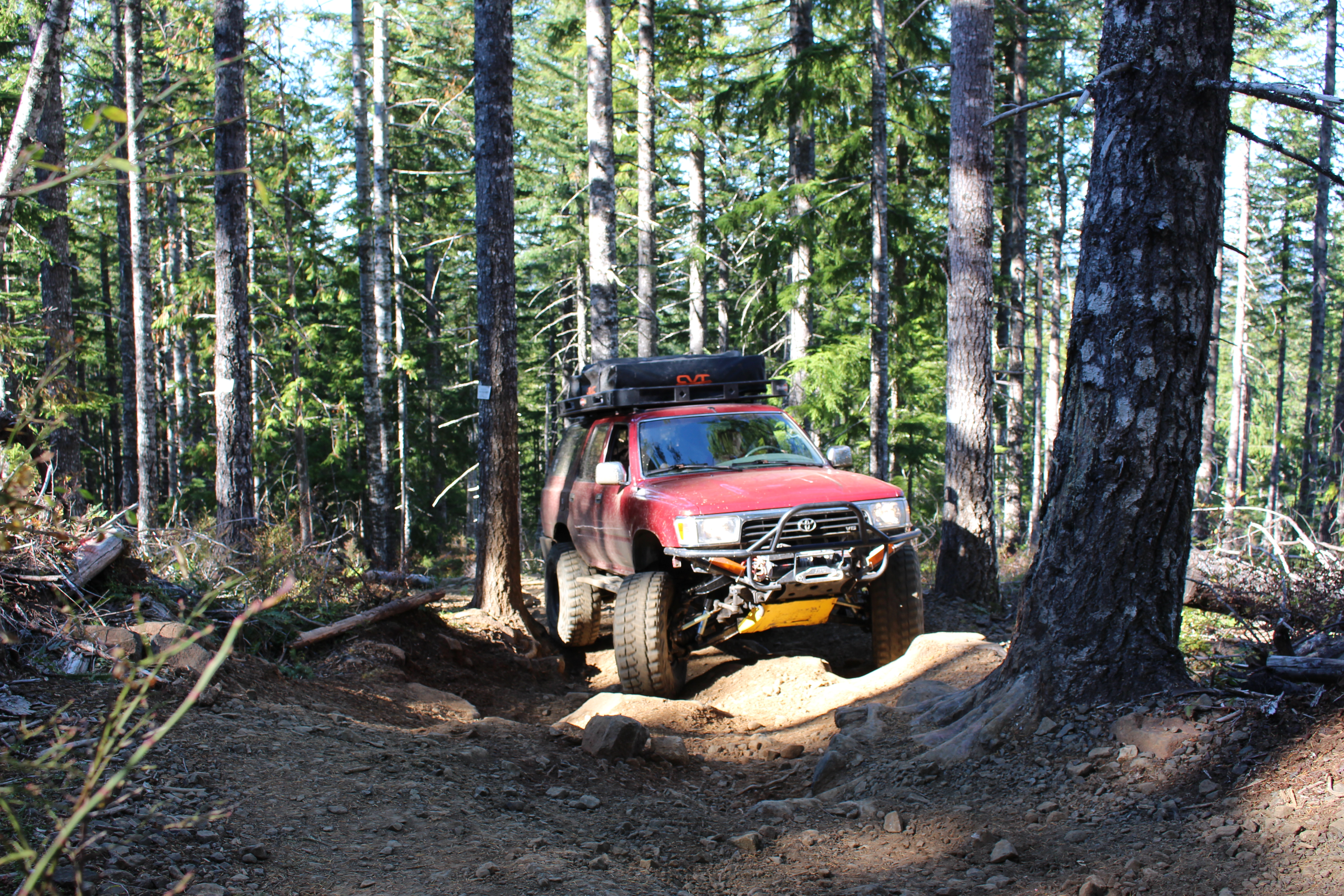

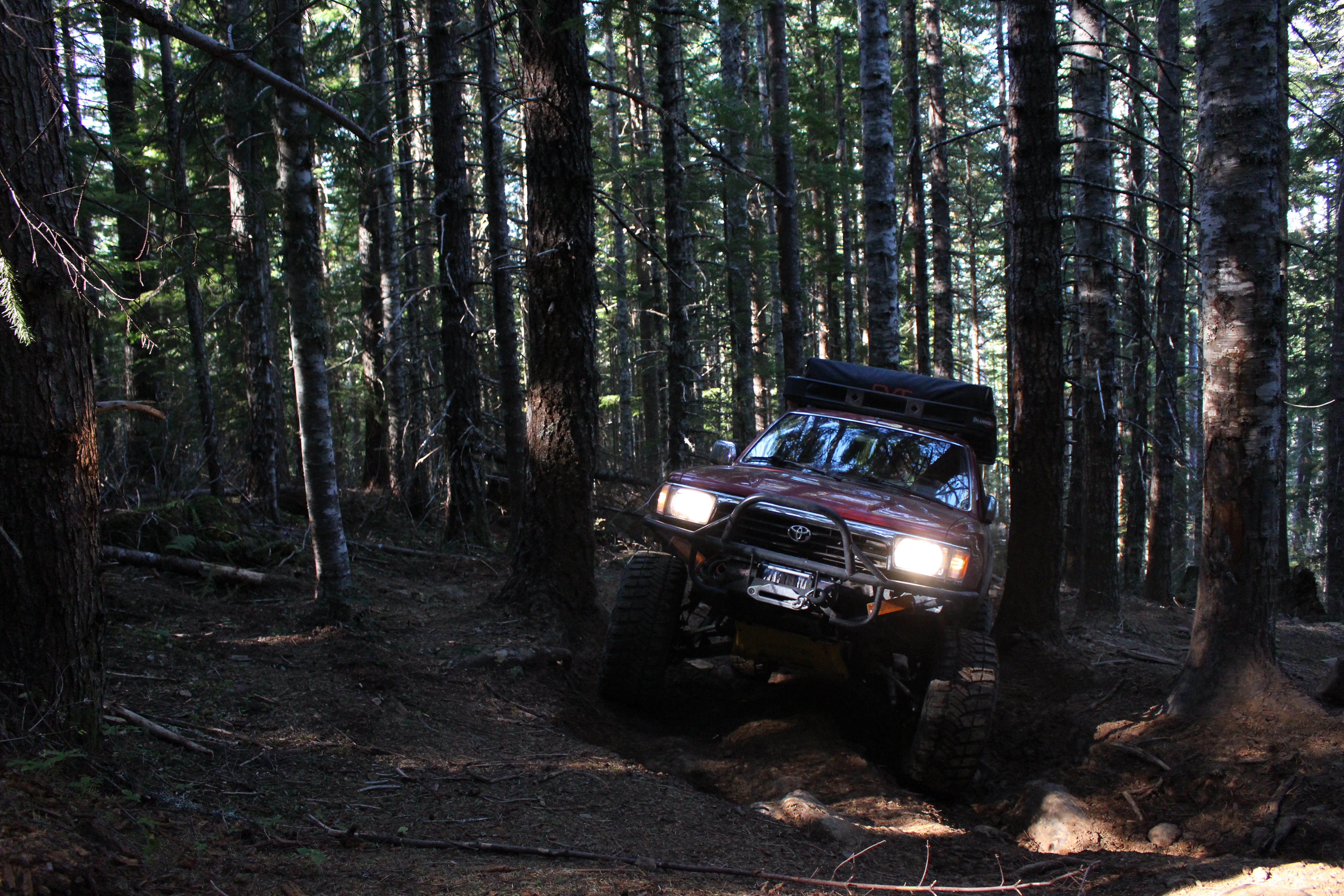

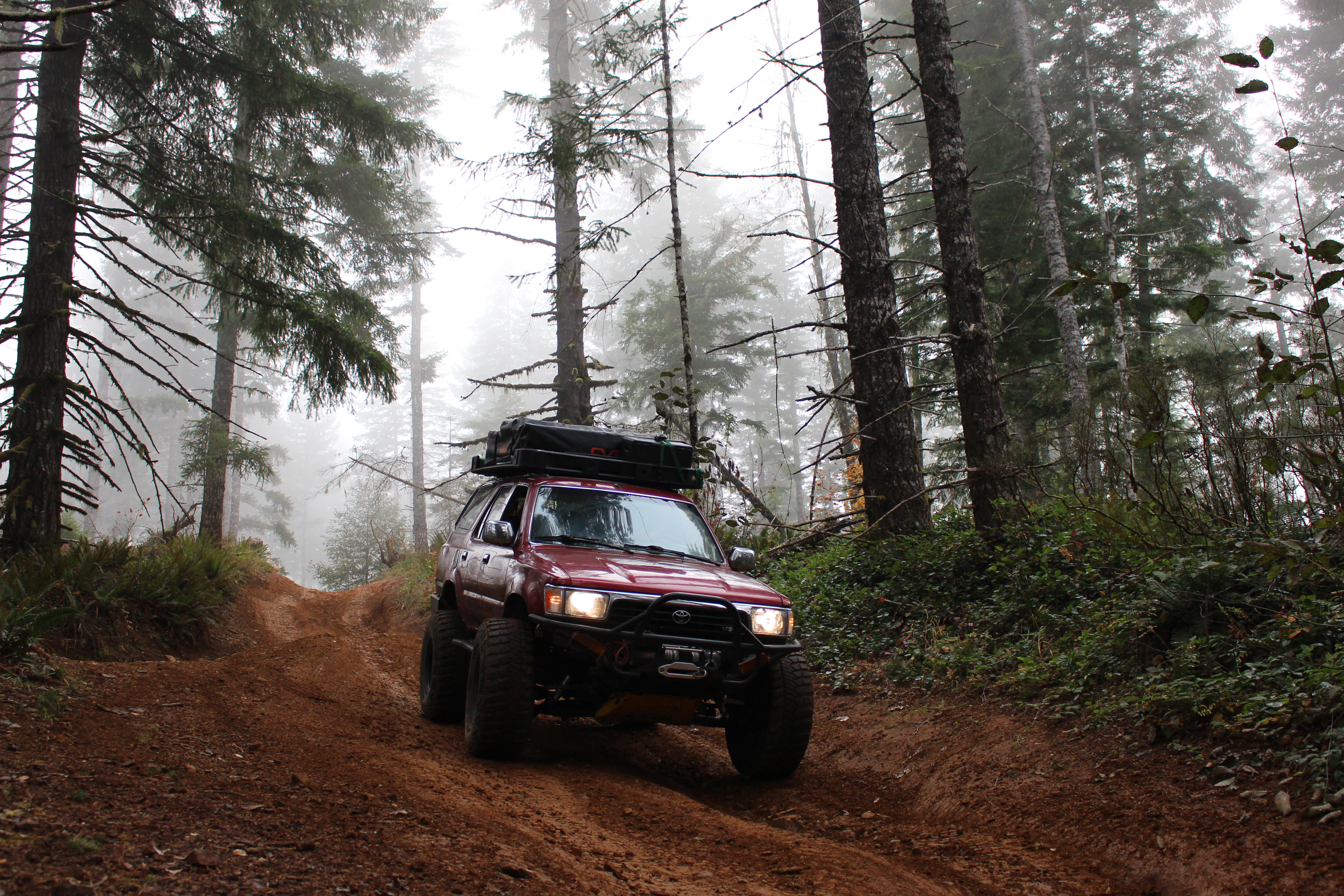

More Browns Camp, Oregon.
As promised here are some more photos.

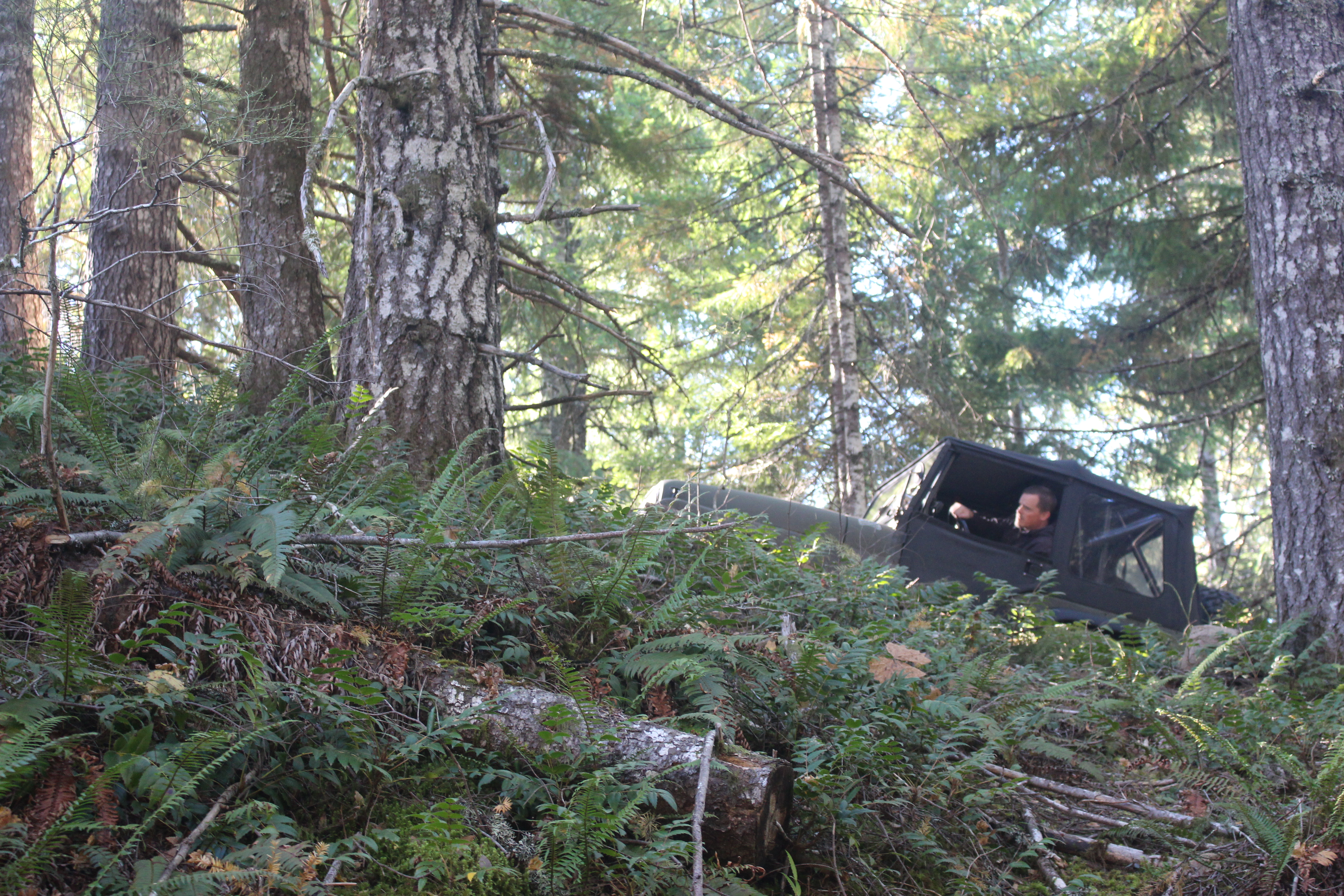

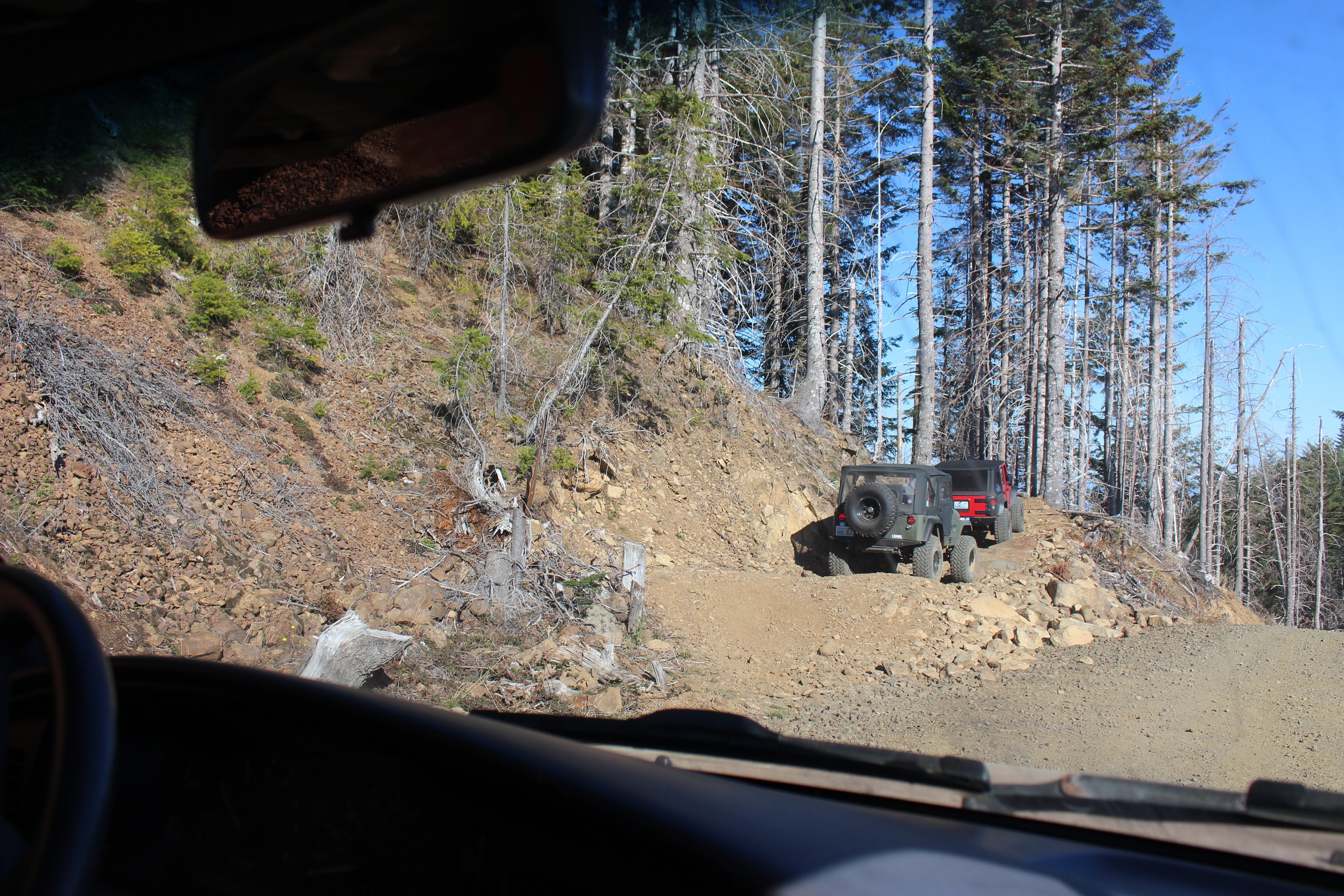

I tagged along with some Jeep guys. They where really nice guys and even helped me remove my sway bar links.

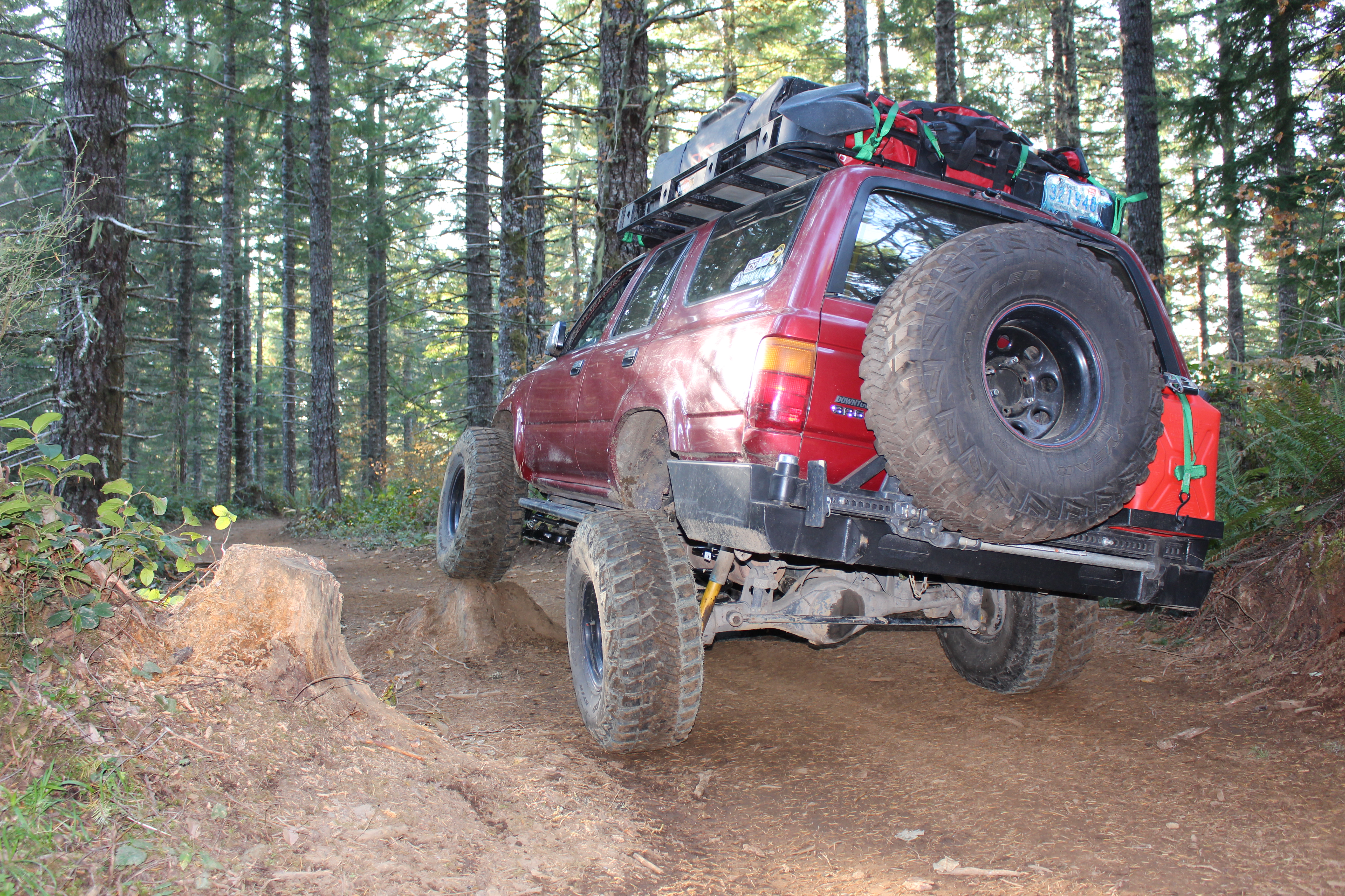

I could not get the removable sway bar links out but wheeled anyway. The ball on the pin was seized locking them in. We had to undo the nuts and take it right out. I've been running with no sway bar ever since.
Due to having much more flex up front the rear got flexed more. The bracket attached to the frame crumpled kinking the sway bar link at a bad angle. I'll have to come up with something better.

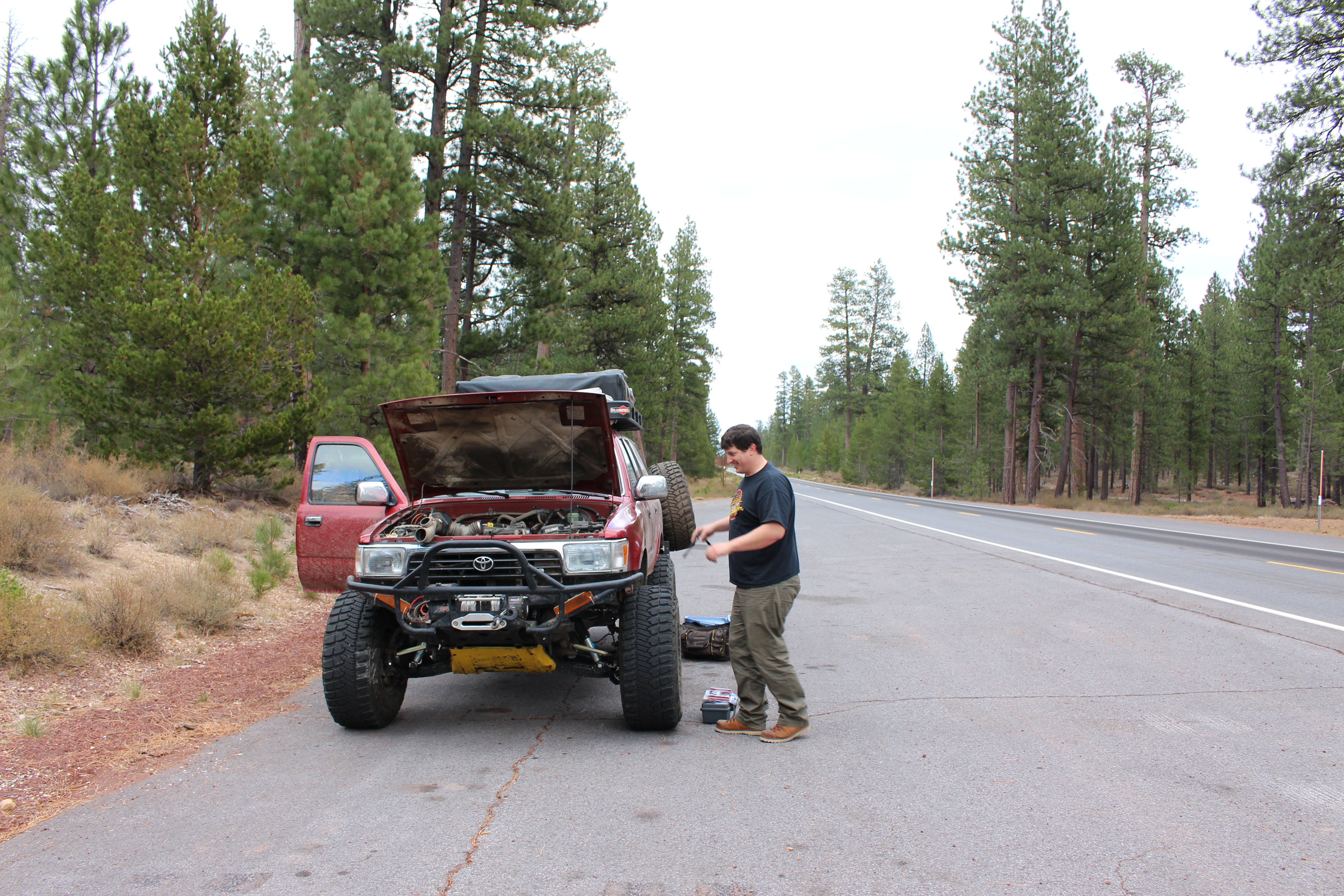

I started having steering issues quite soon after the LT kit and beating on it. First my steering column got a bit loose so I tightened everything on the side of the road.
Sarah made coffee and then we where good to go. No play in the wheel for awhile.

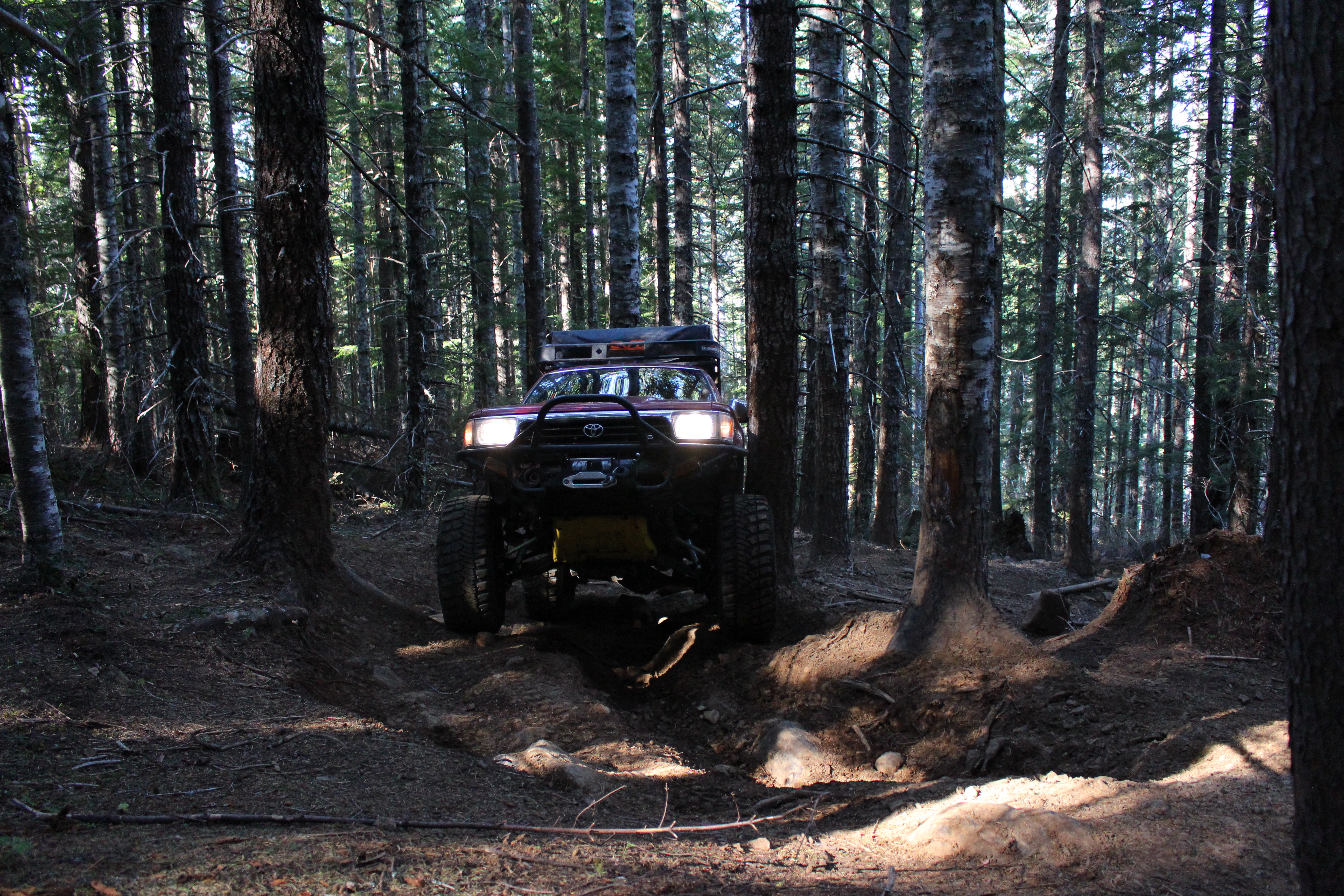

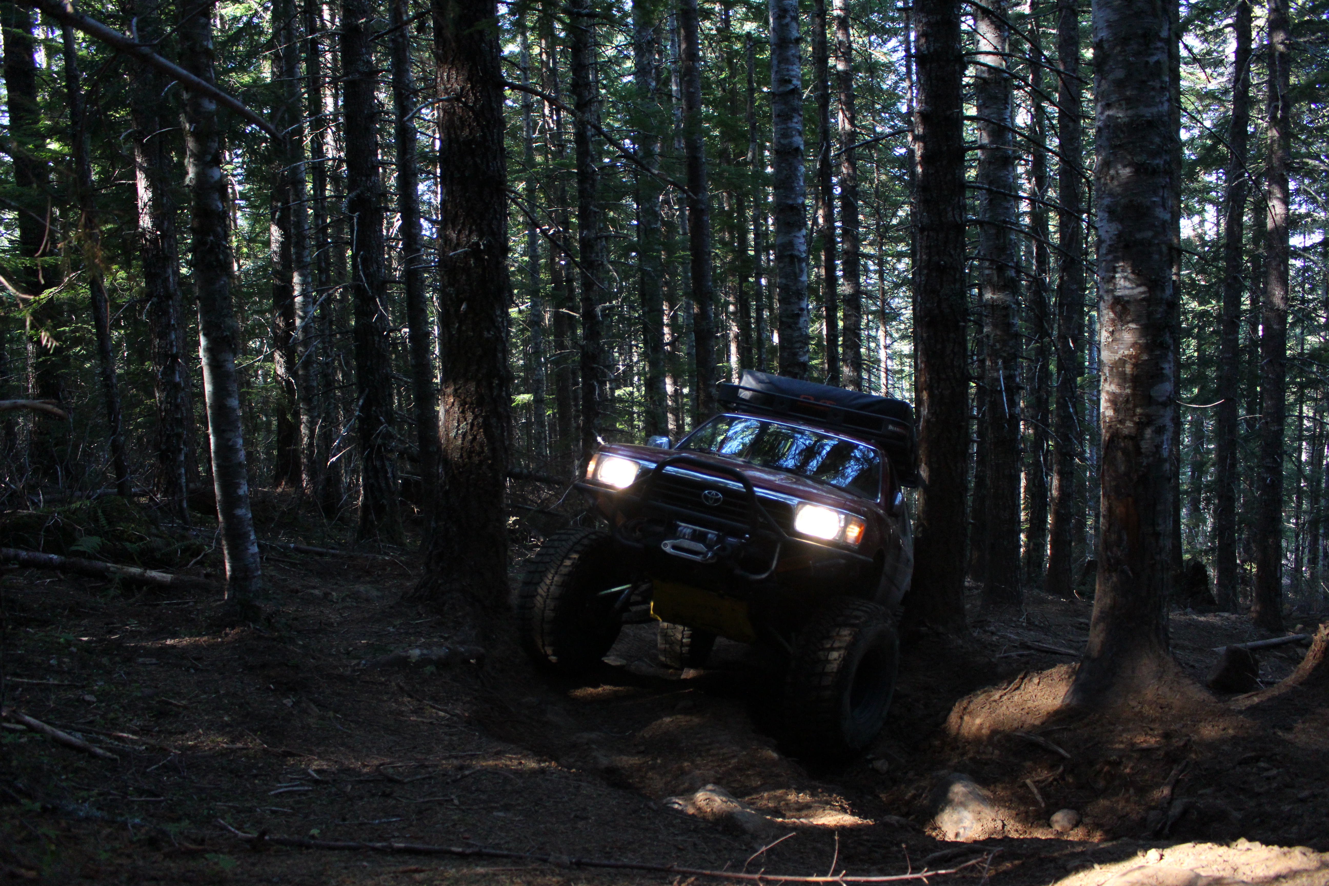

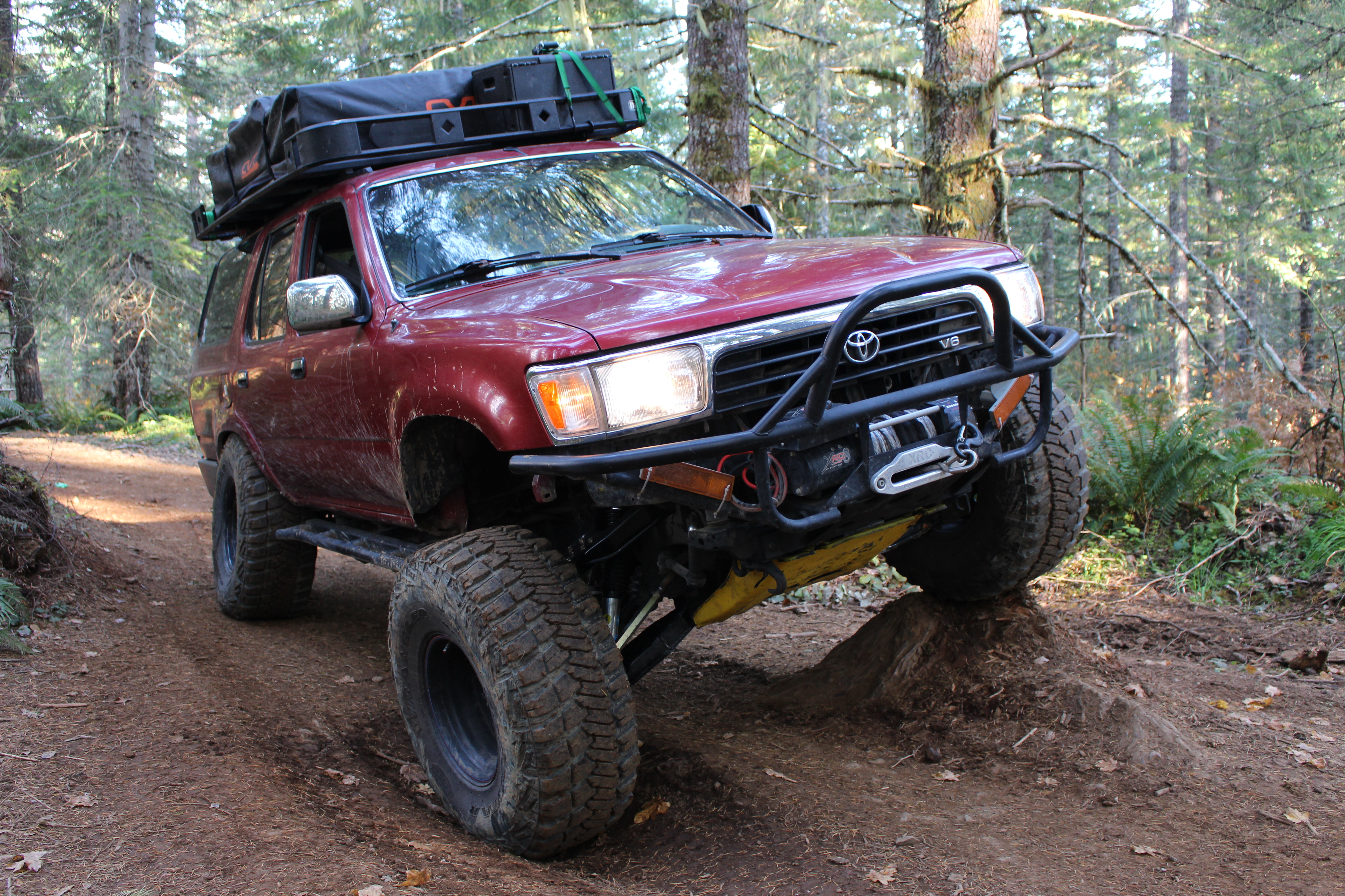

#616
Joined: Aug 2011
Posts: 1,507
From: Fraser Valley, British Columbia

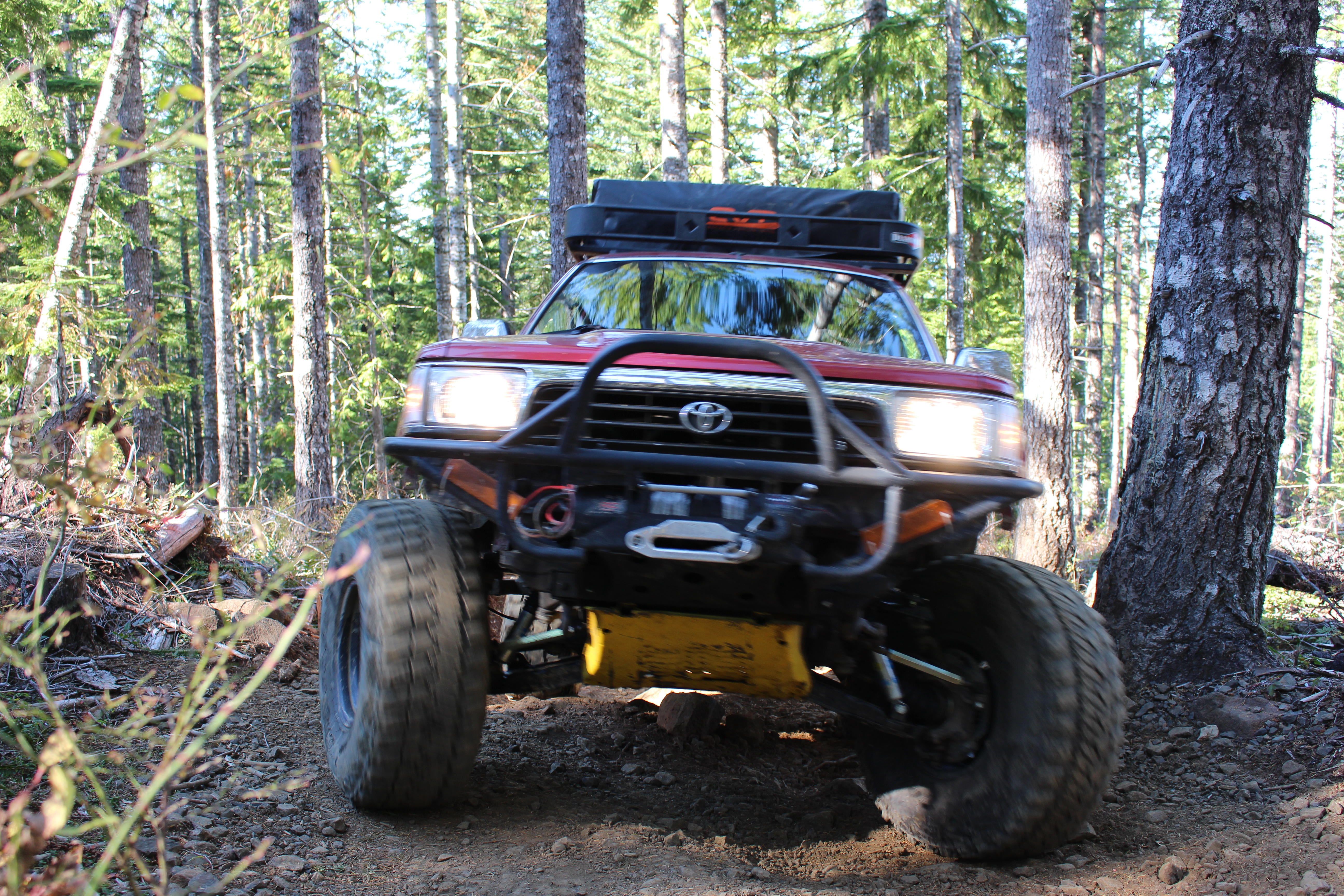

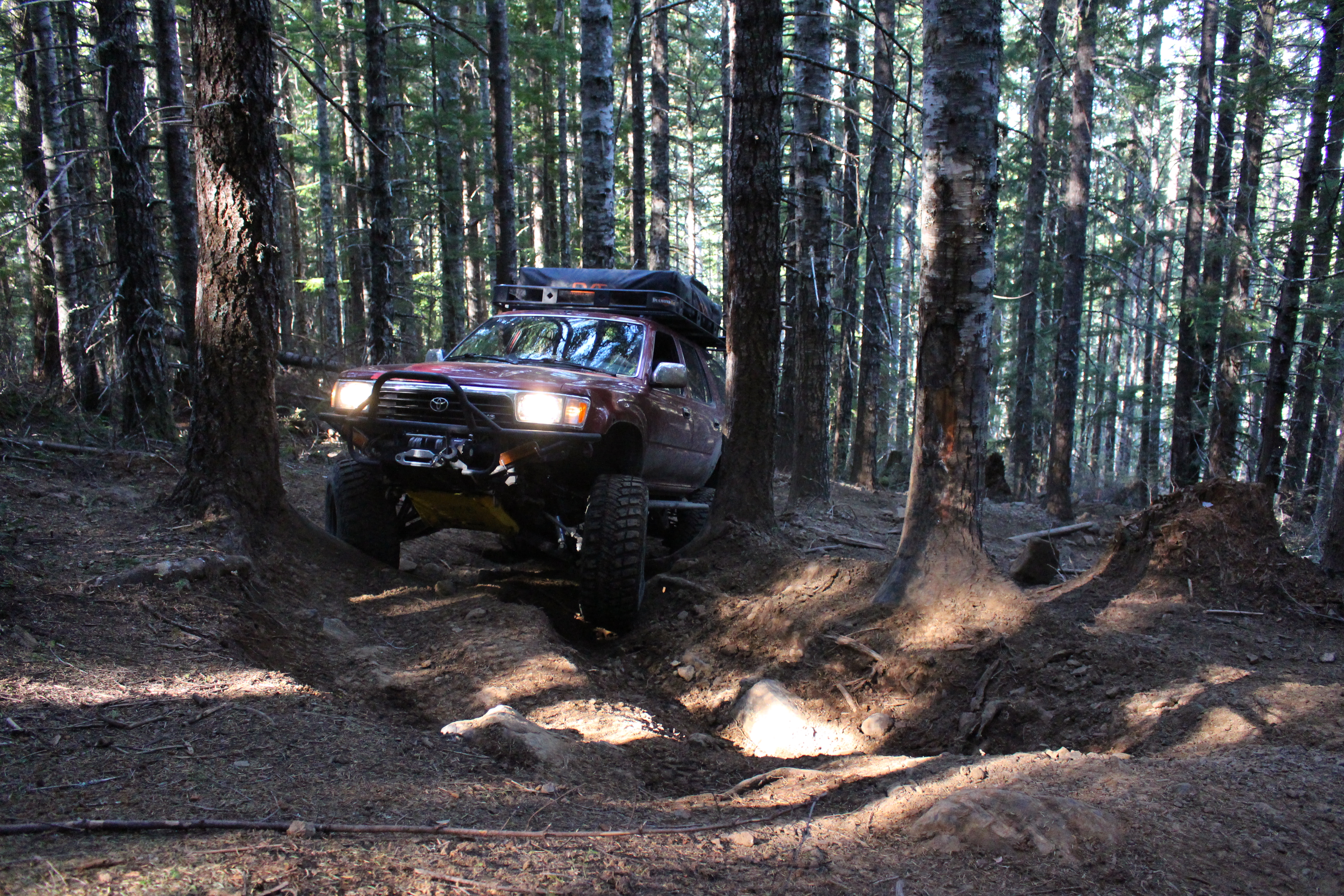

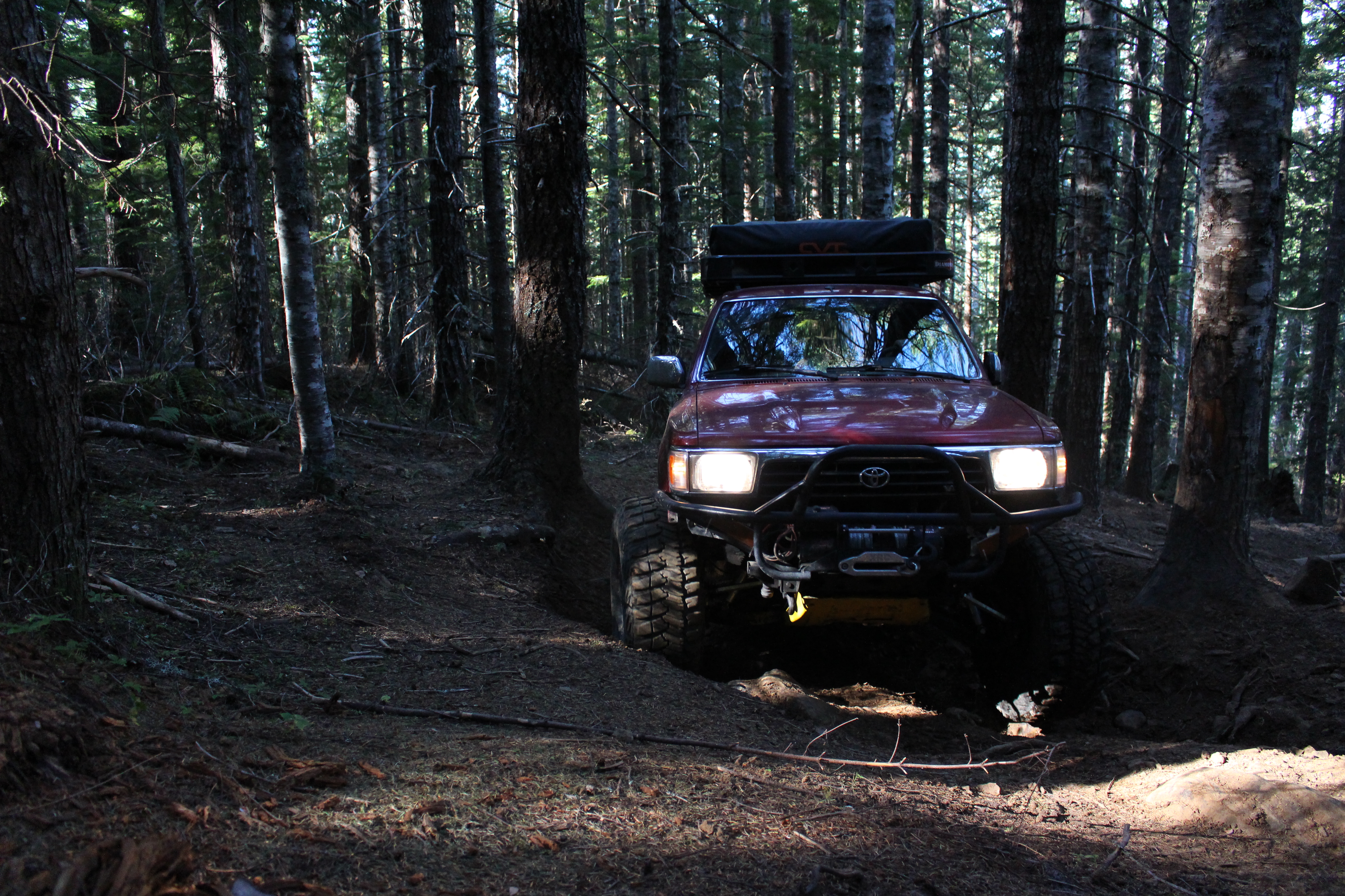

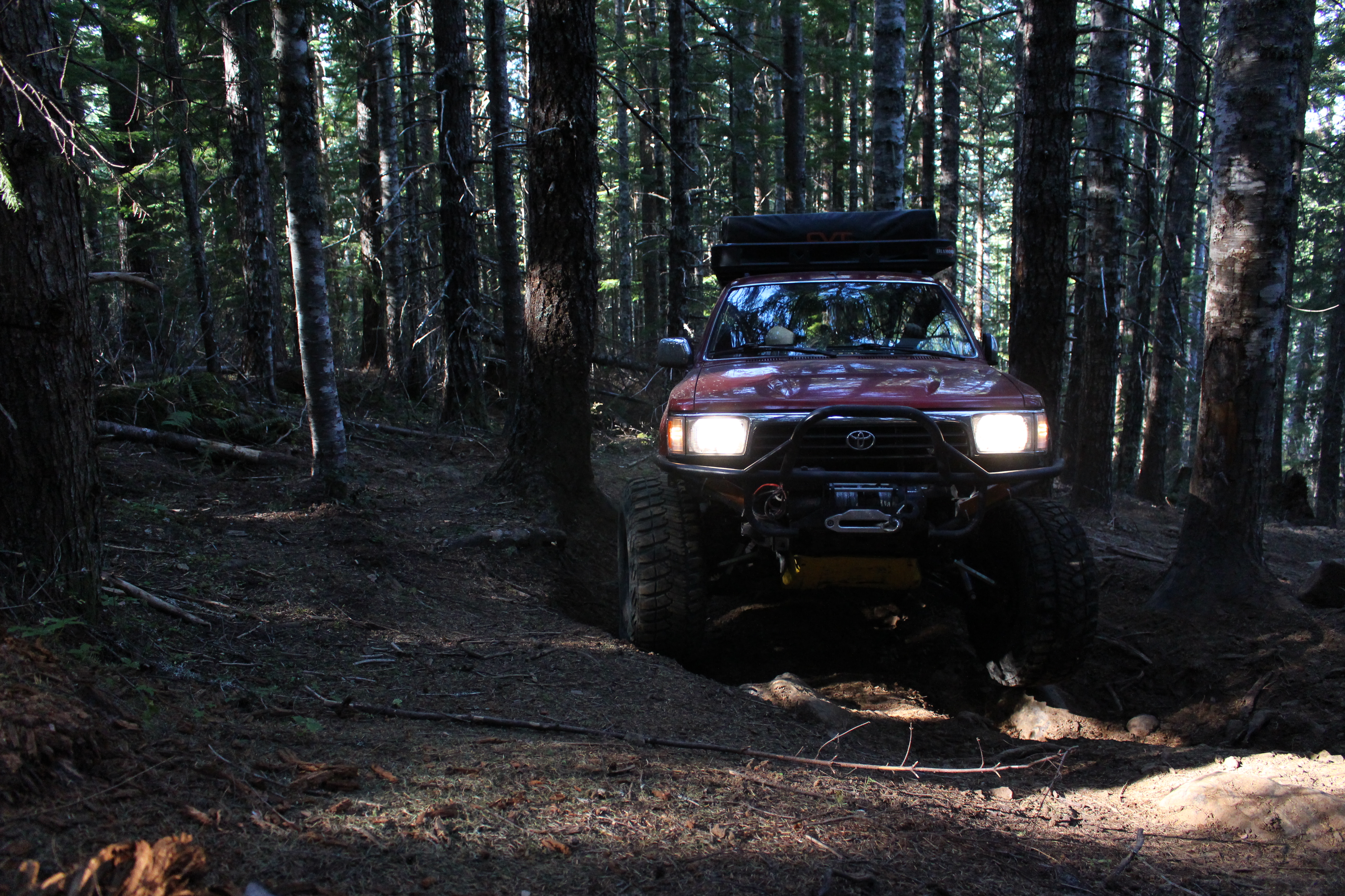

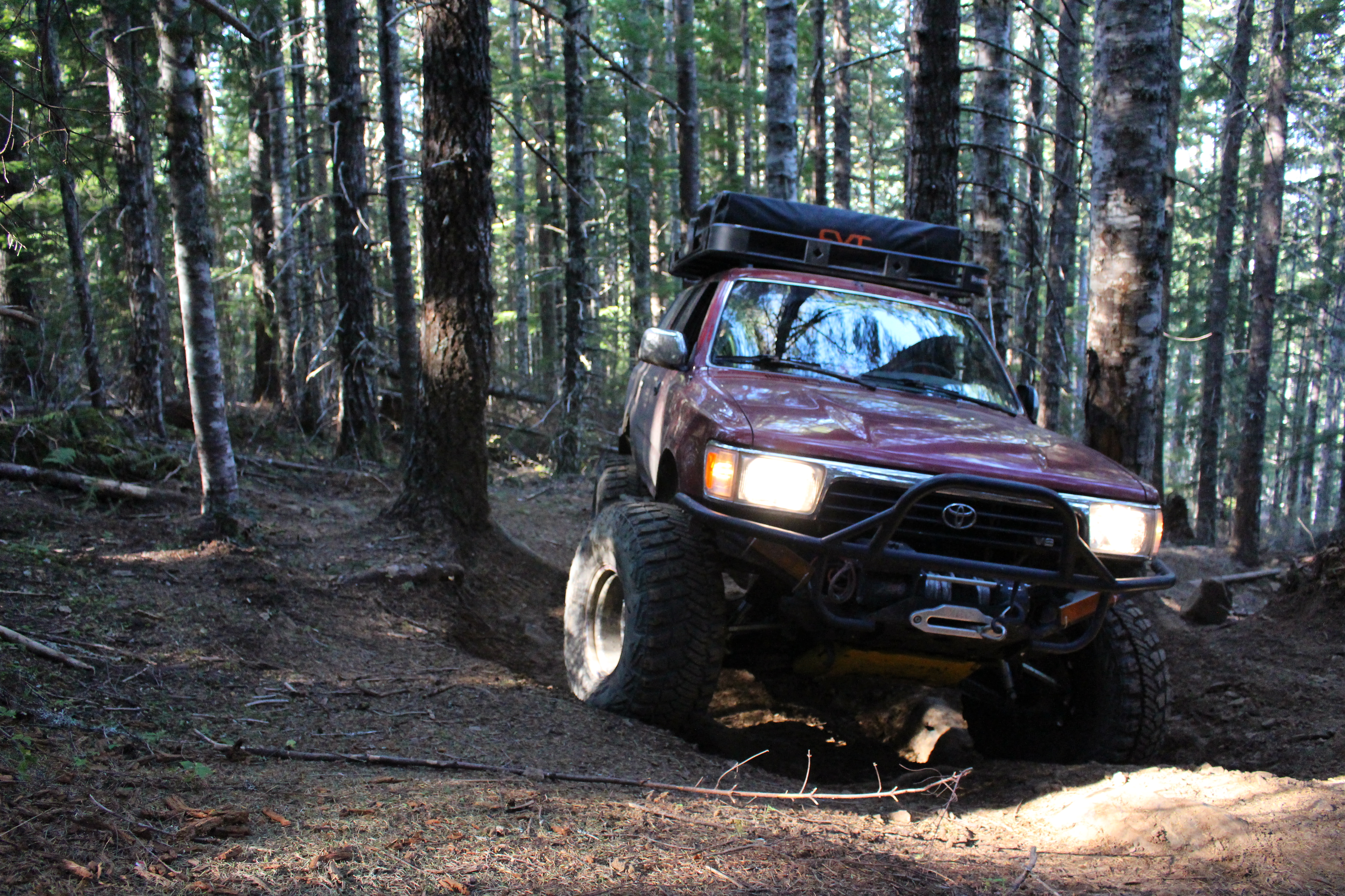

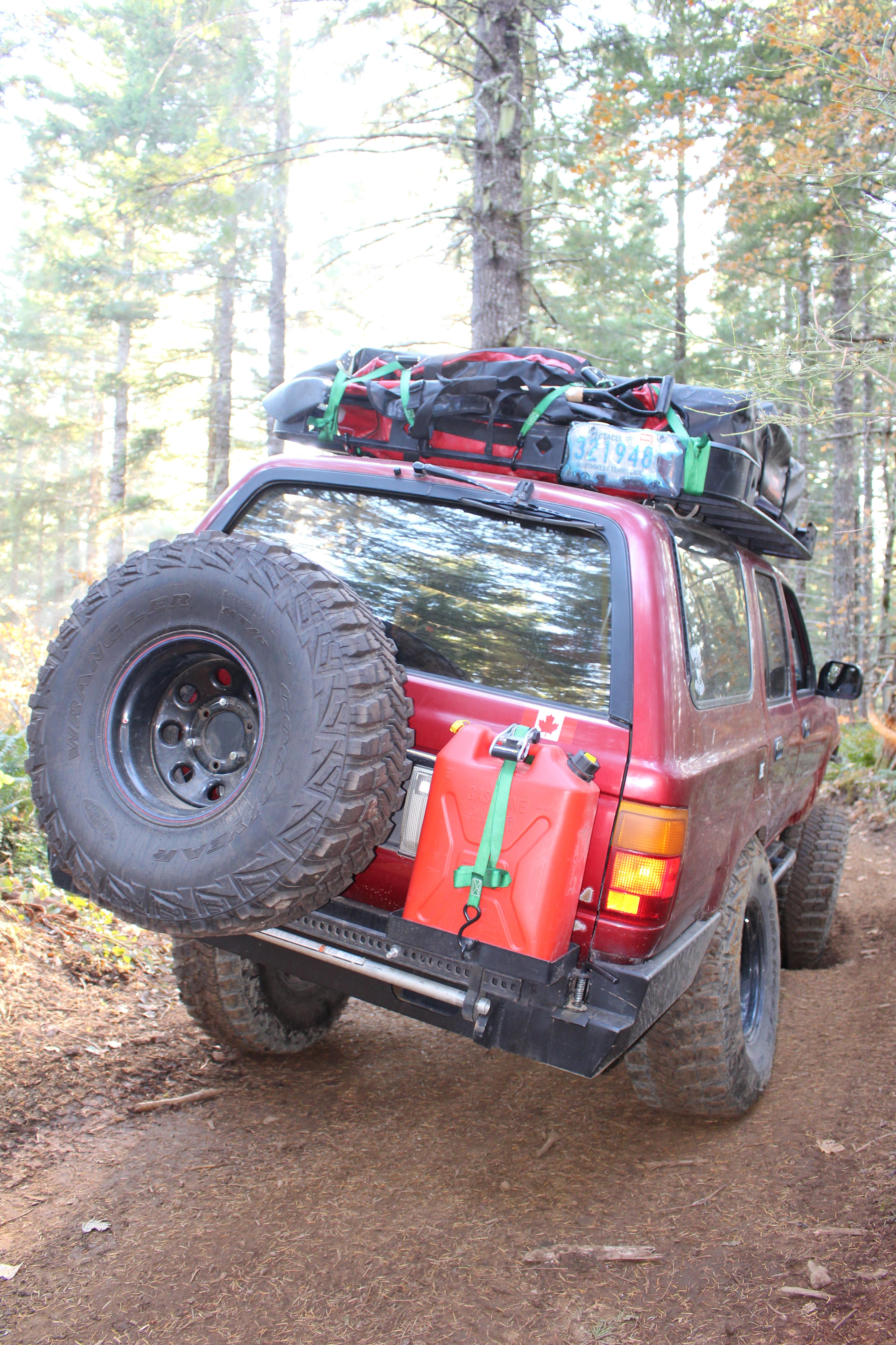

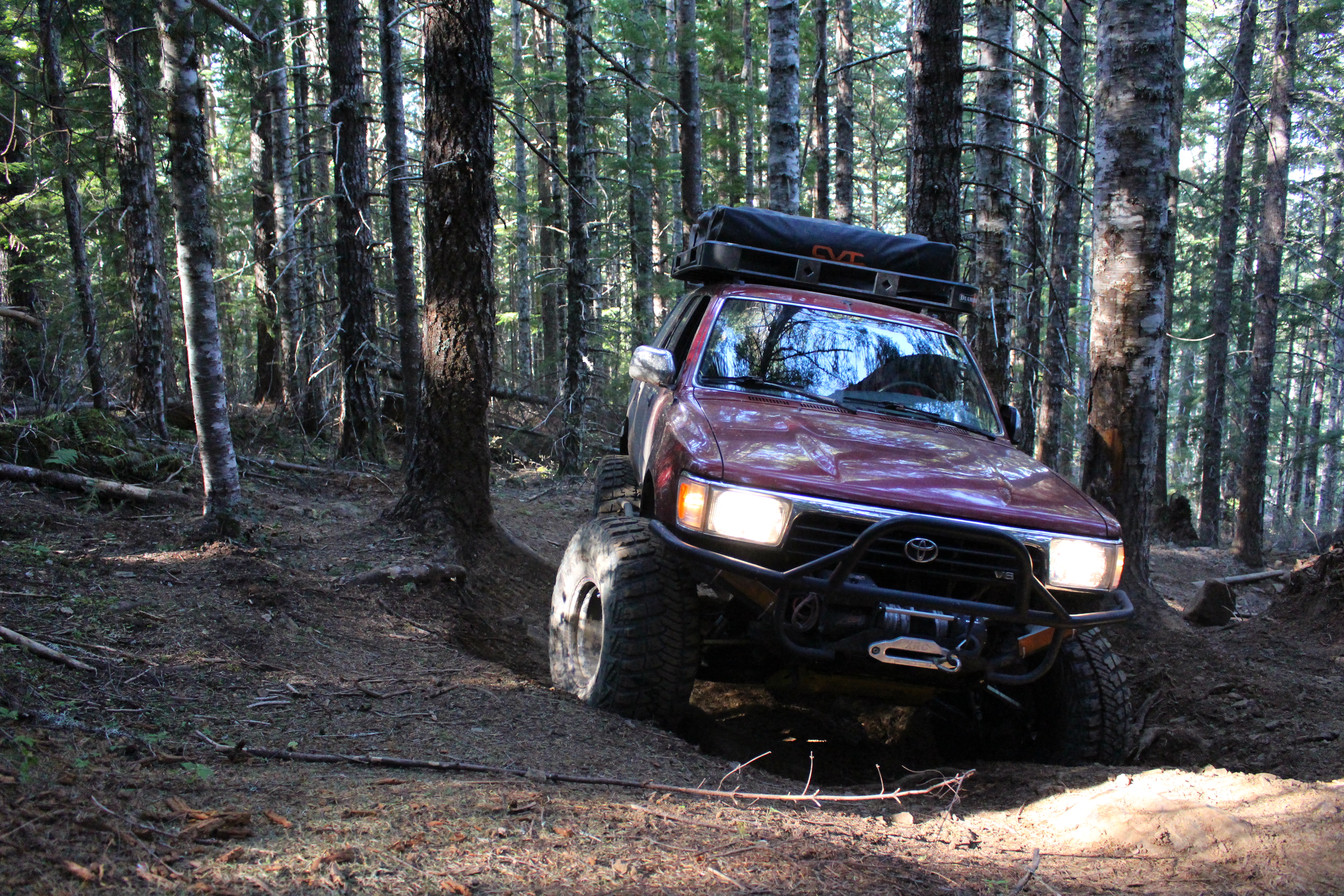

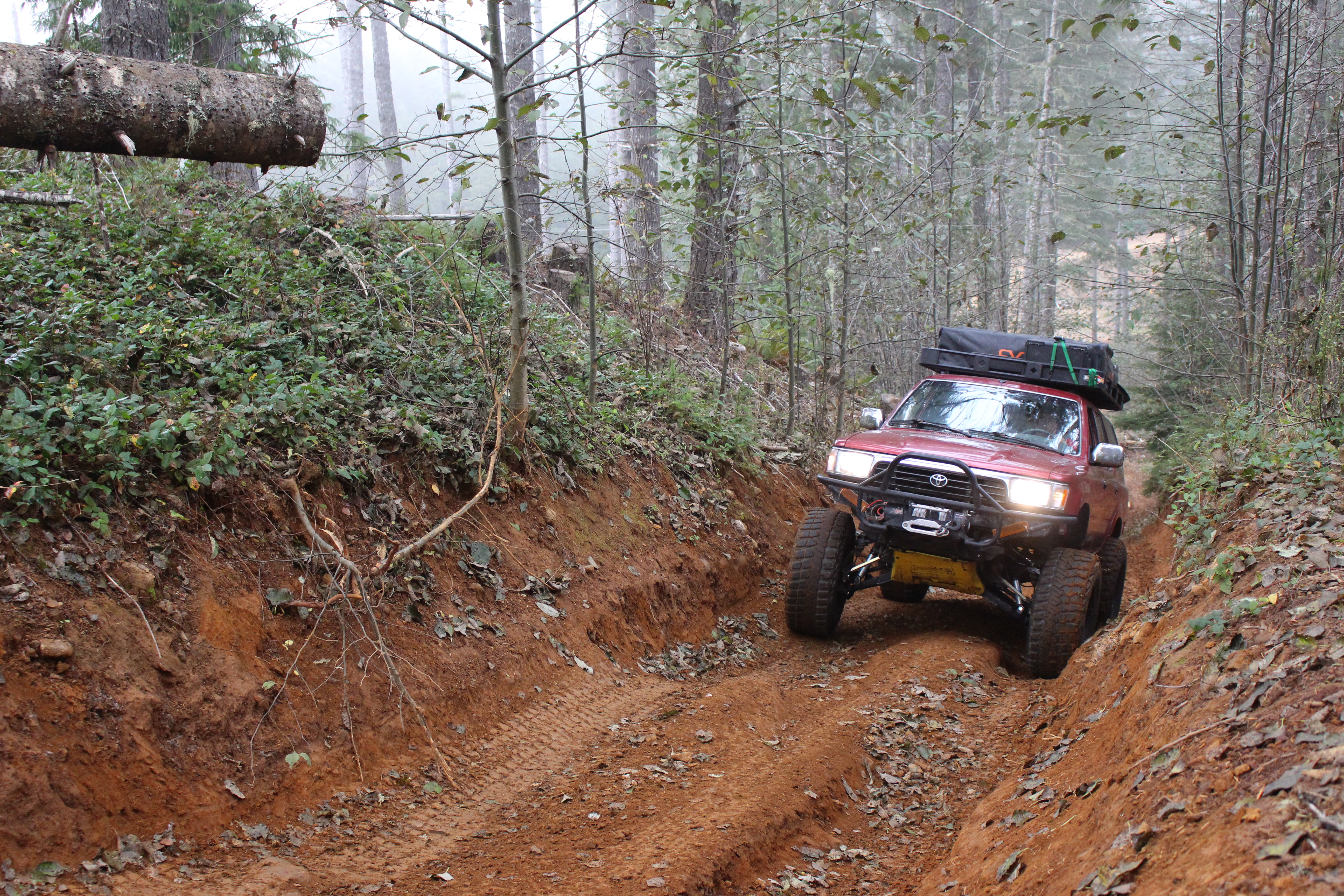

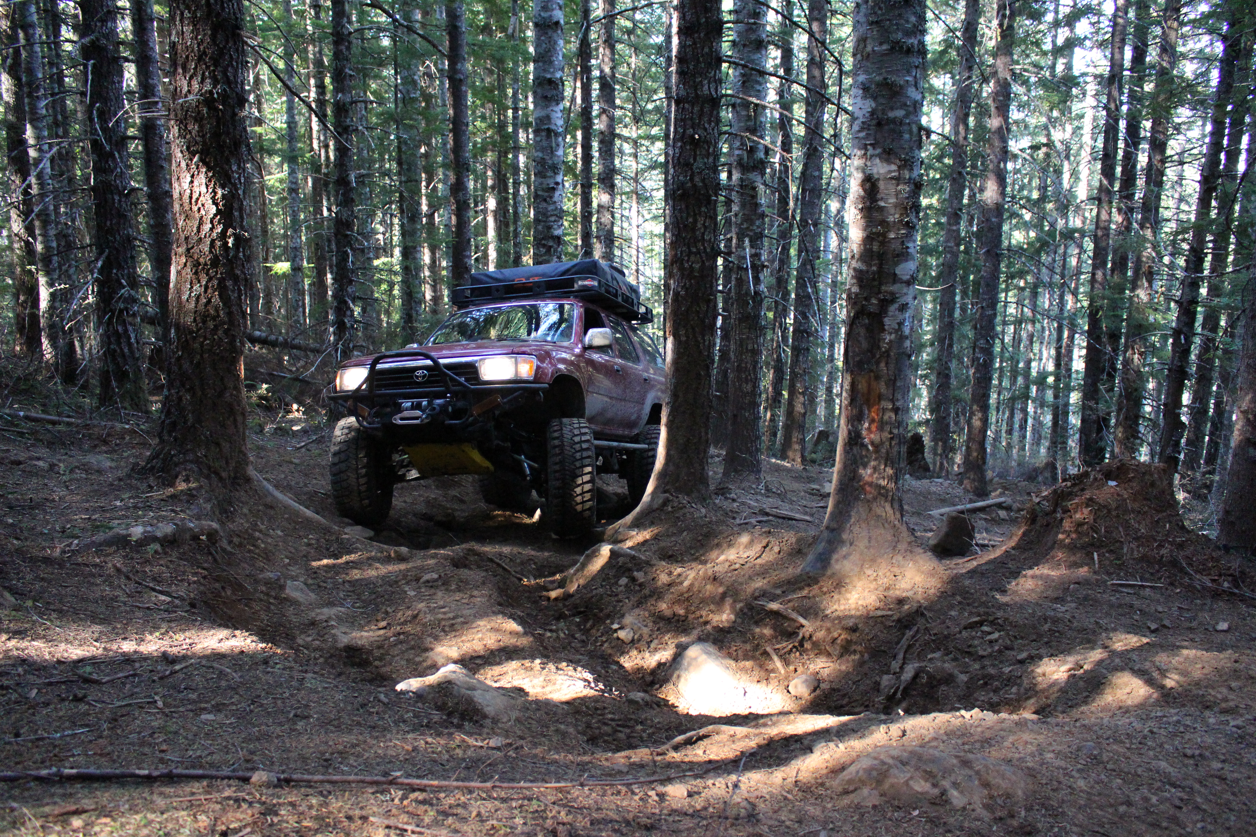

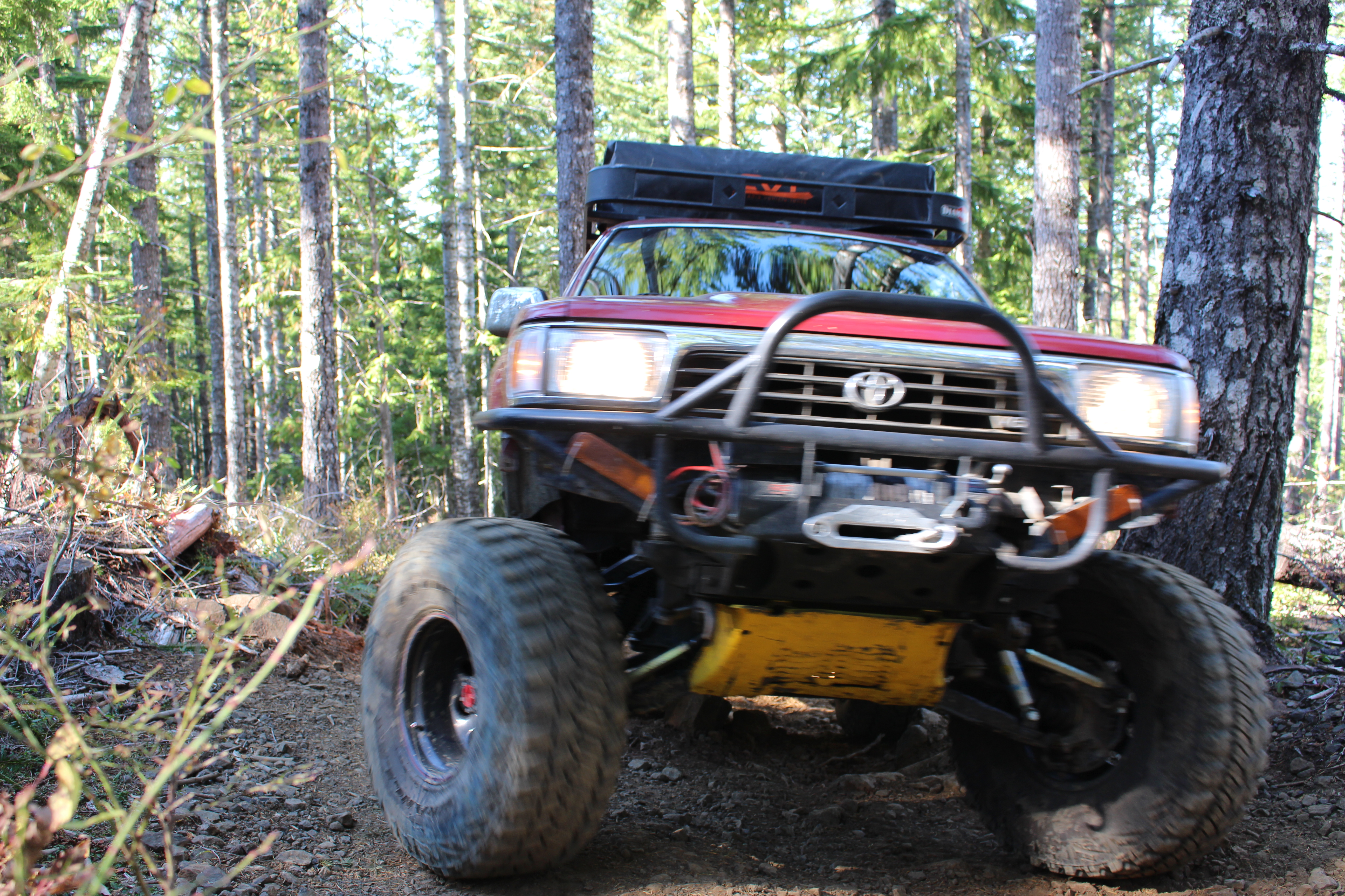

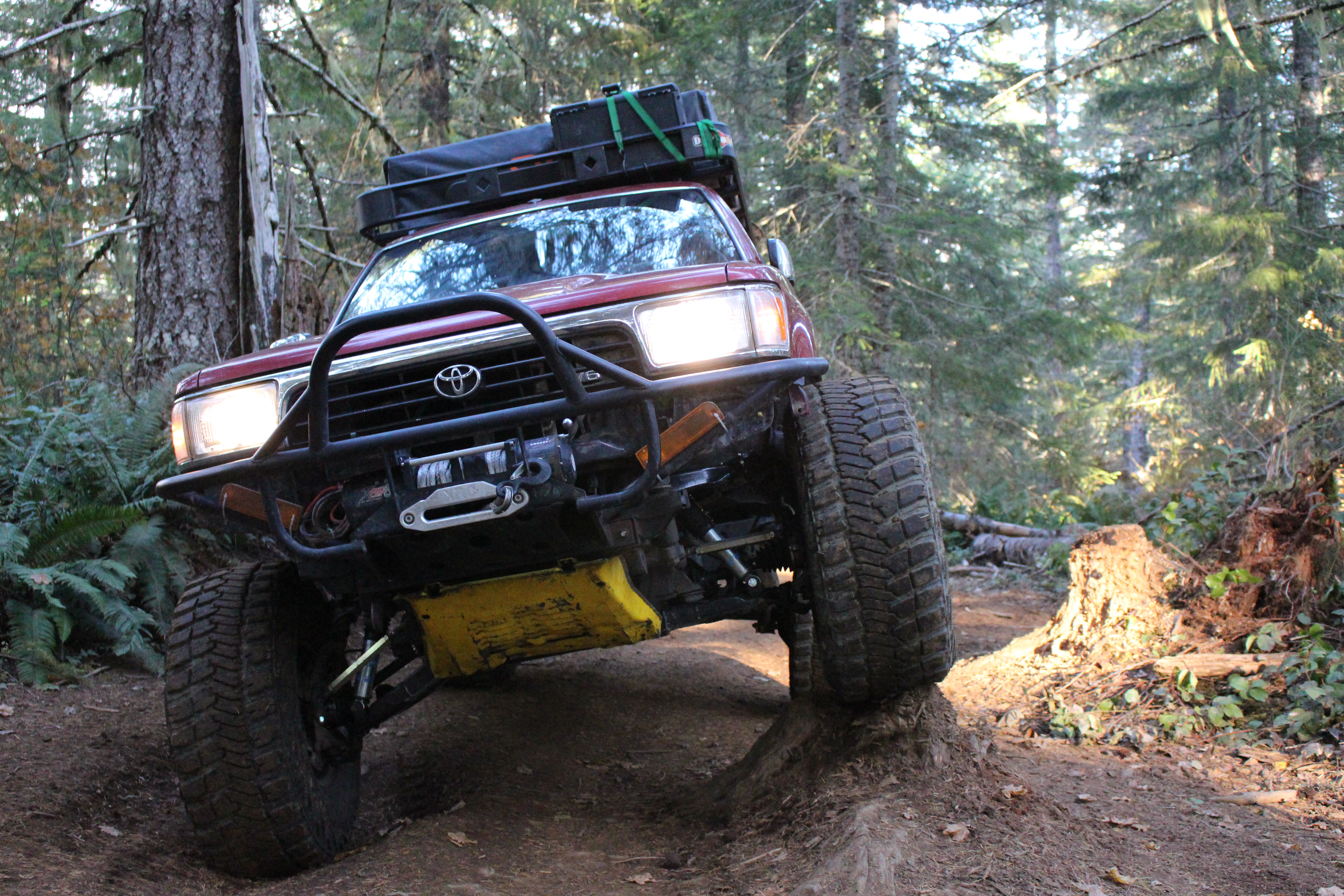

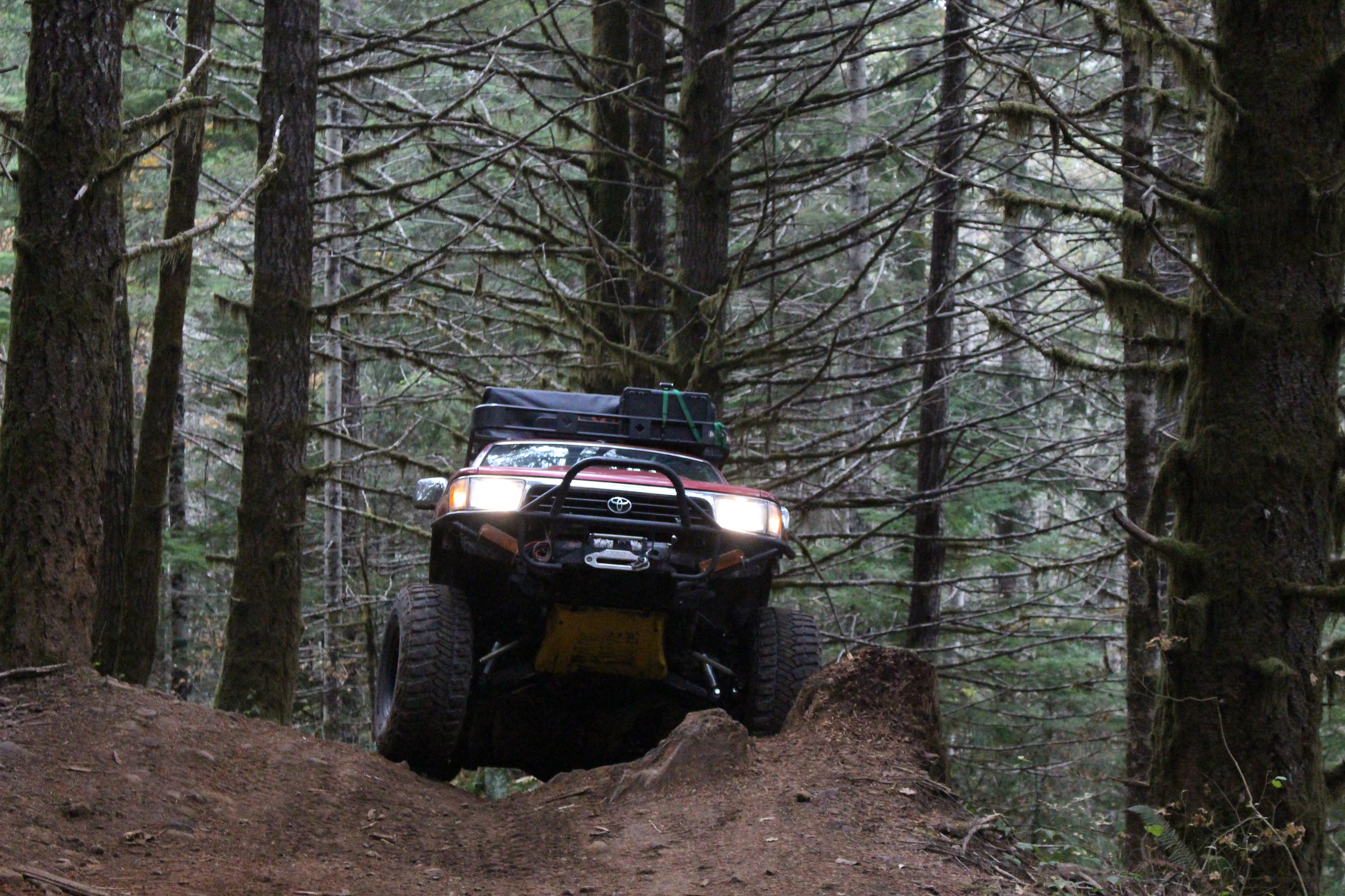

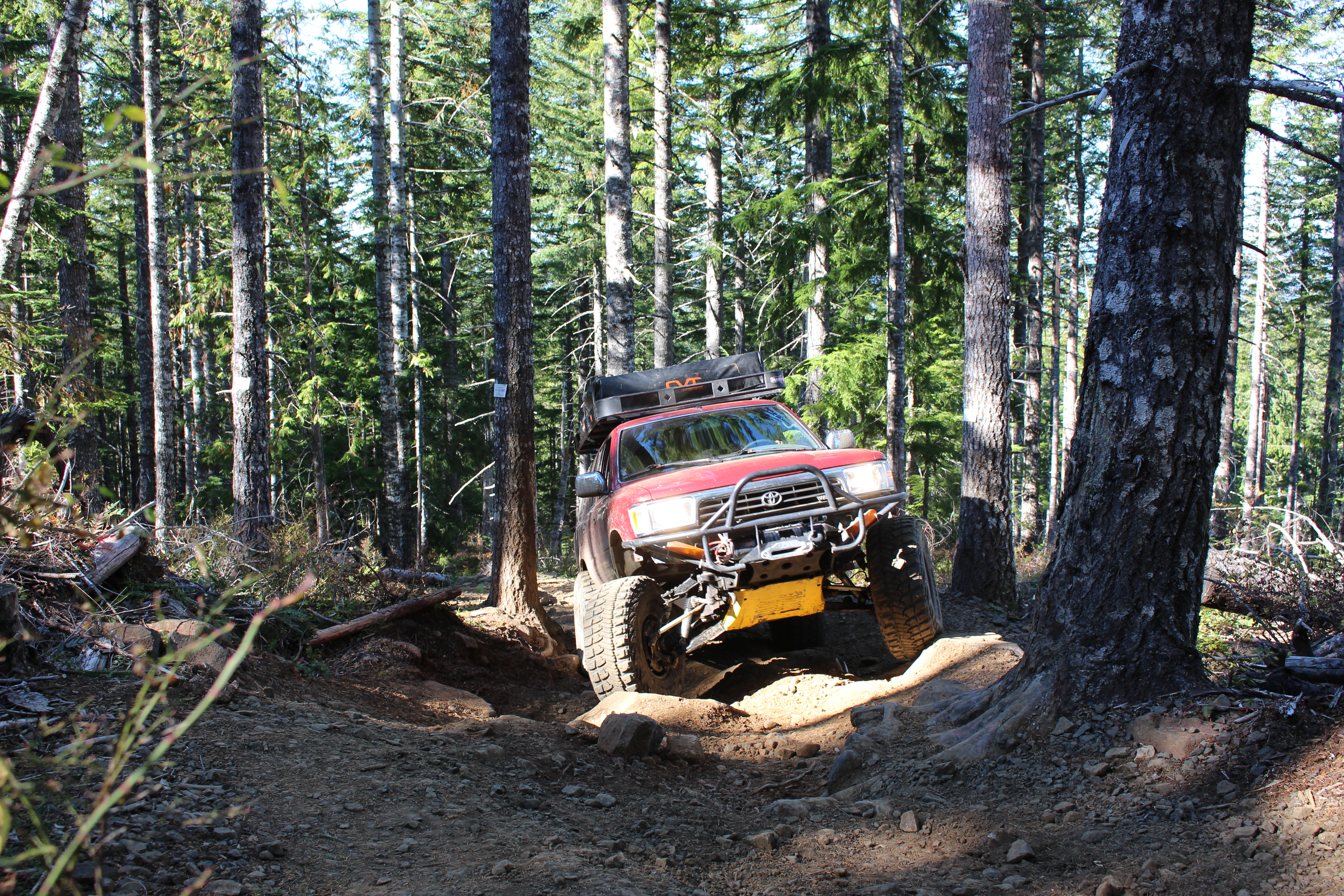

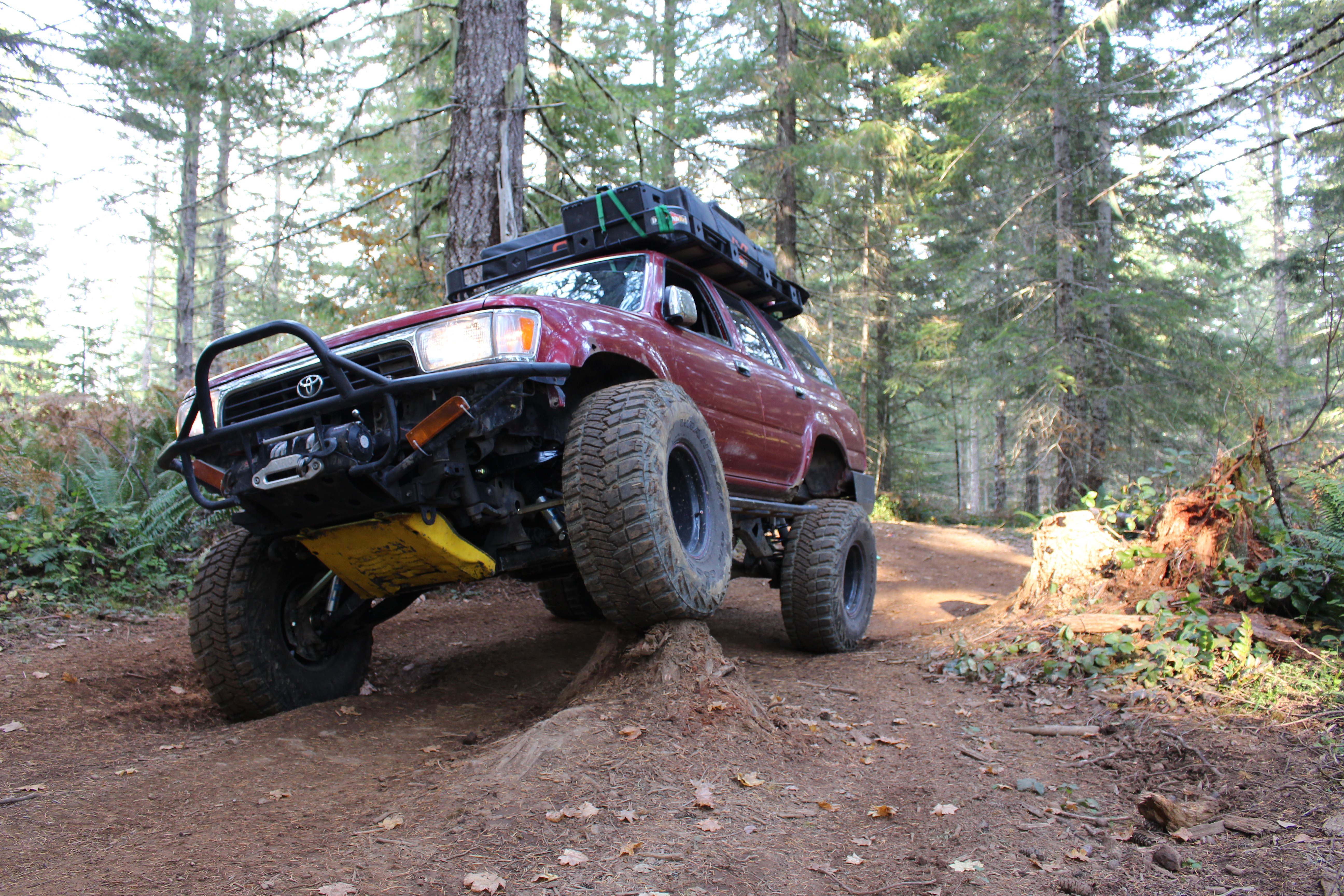

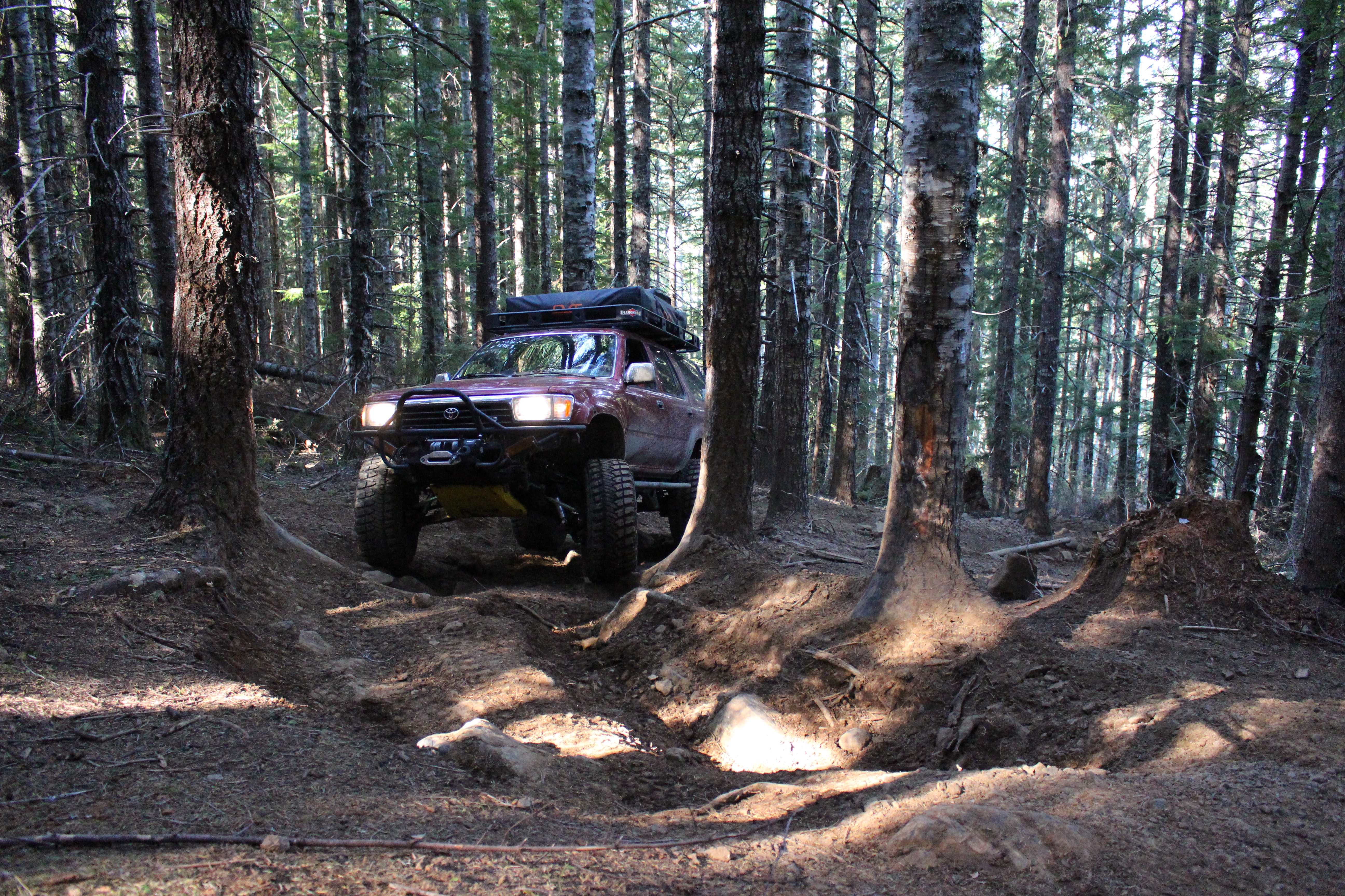

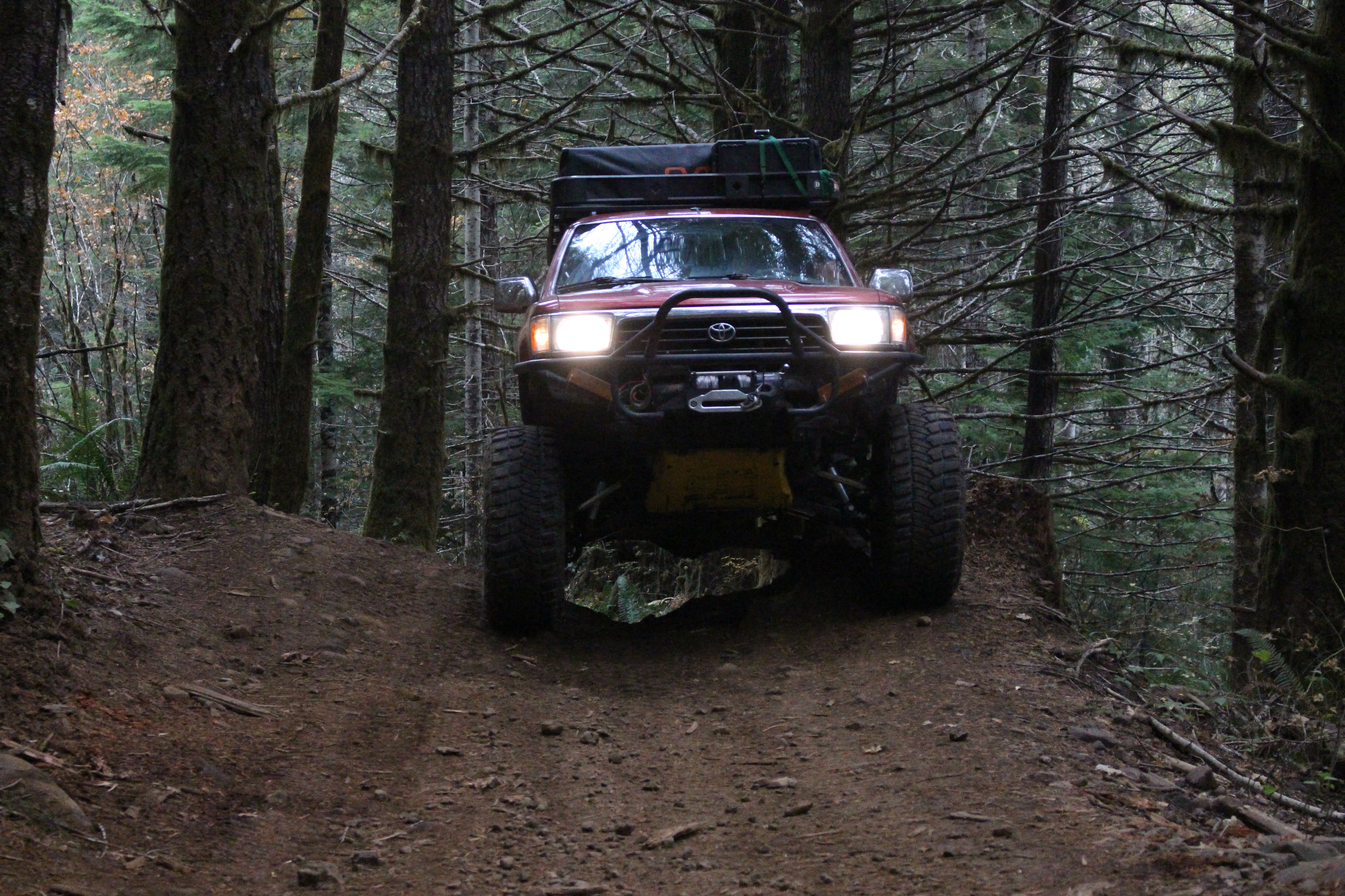

I just want to highlight this photo.
It's another example of my tires not facing the same direction like I've mentioned before and shown in video.
How do I stop this from happening? It does not seem to happen to solid axle steering from what I've seen. Does it happen with smaller tires or is something in my rig broken? It certainly kills my alignment destroying my tires on the pavement.
Sarah has watched it cause loss of control in difficult terrain while spotting me. We really saw it in Moab but this was the first sign.
I'd love to figure out a way of beefing that up if it's not going to cost a fortune. No idea where to start though. Something is bending I think.
There is no denying that the kit performs well off road. At this point these where the toughest trails I'd been on so far but the Blazeland kit helped it go easier than my starting trails from early on. Very stable with that wide stance and the flex kept me from feeling like I was going to flop on every off camber obstacle. Even with a roof top tent on!

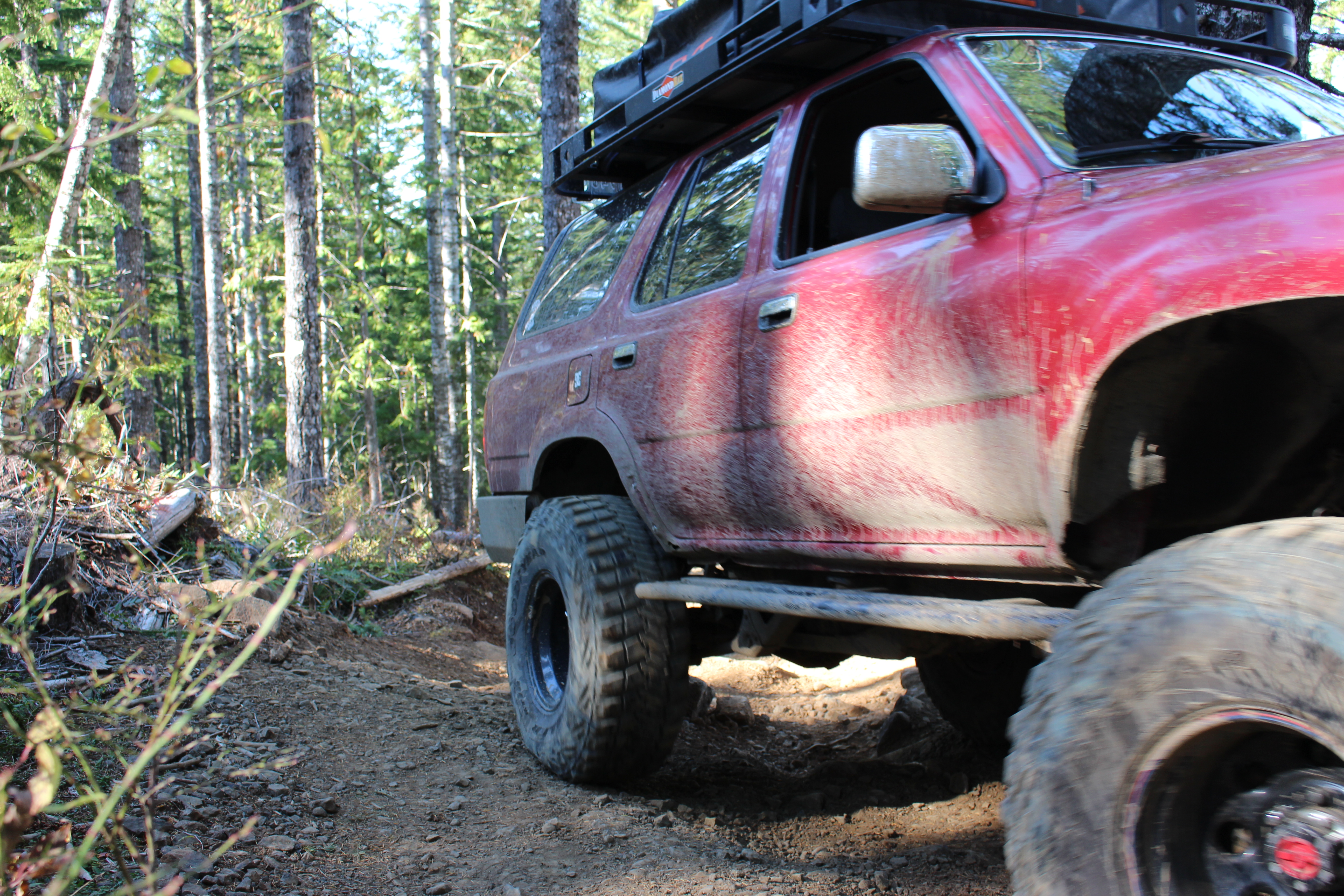

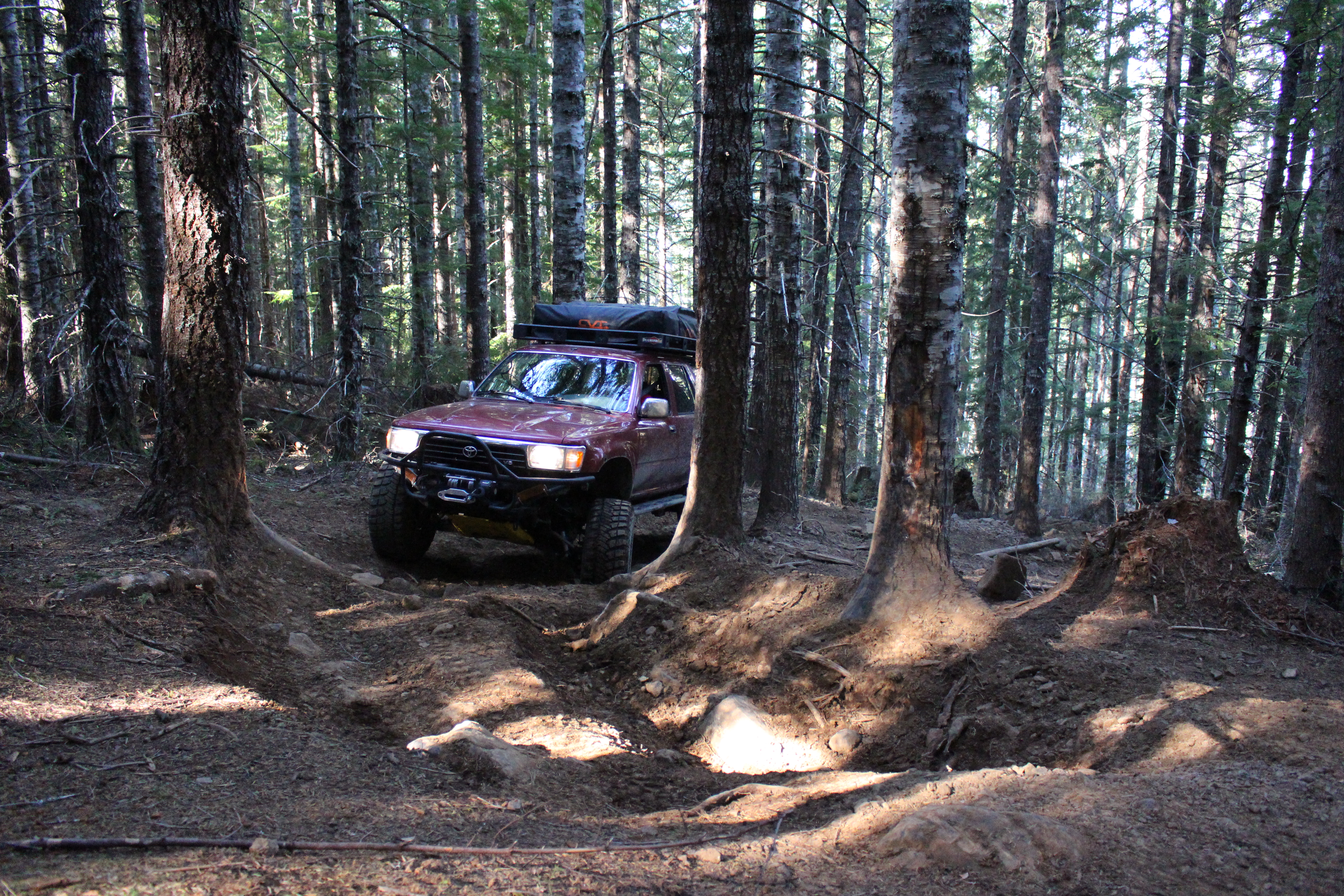

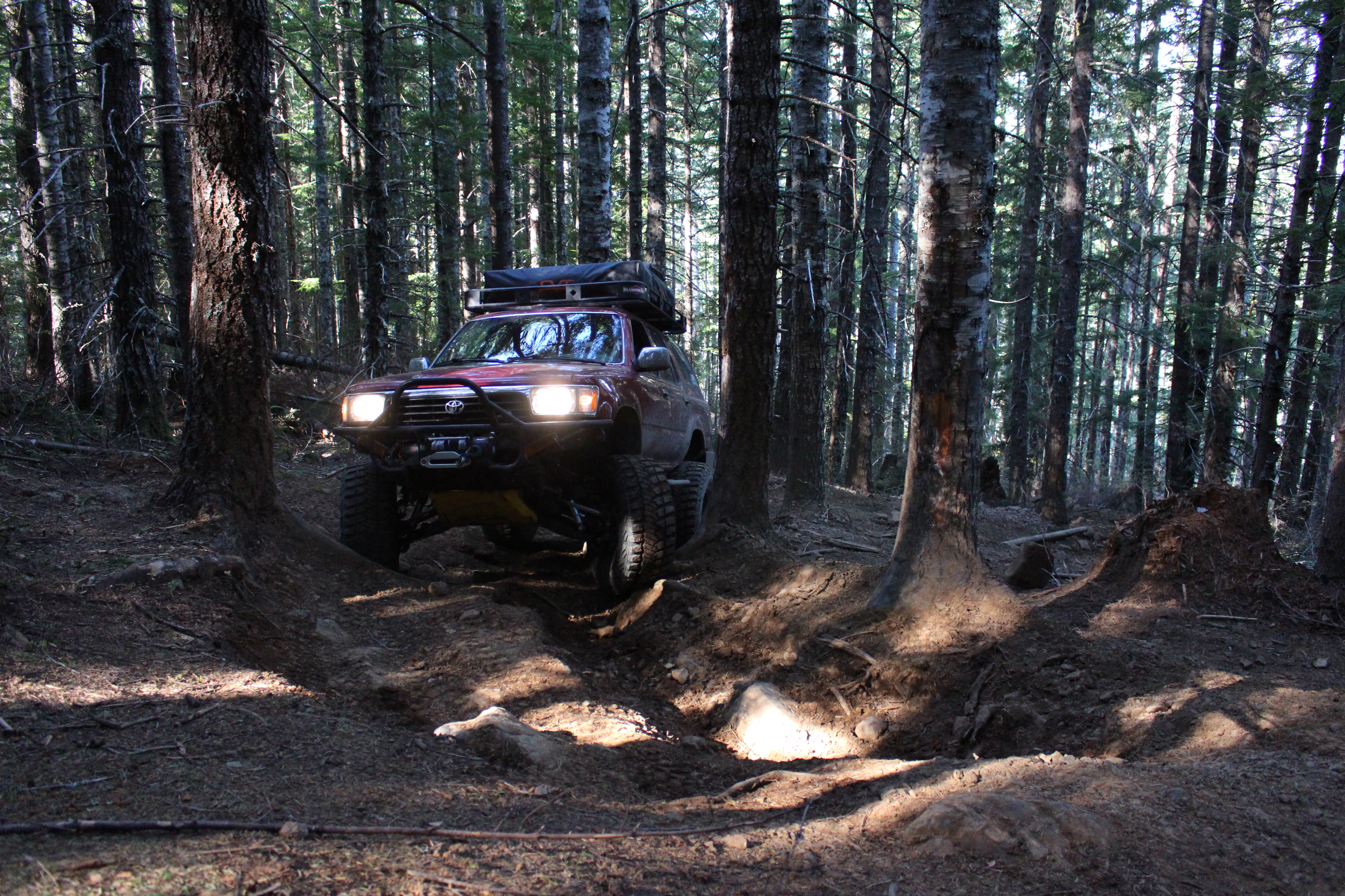

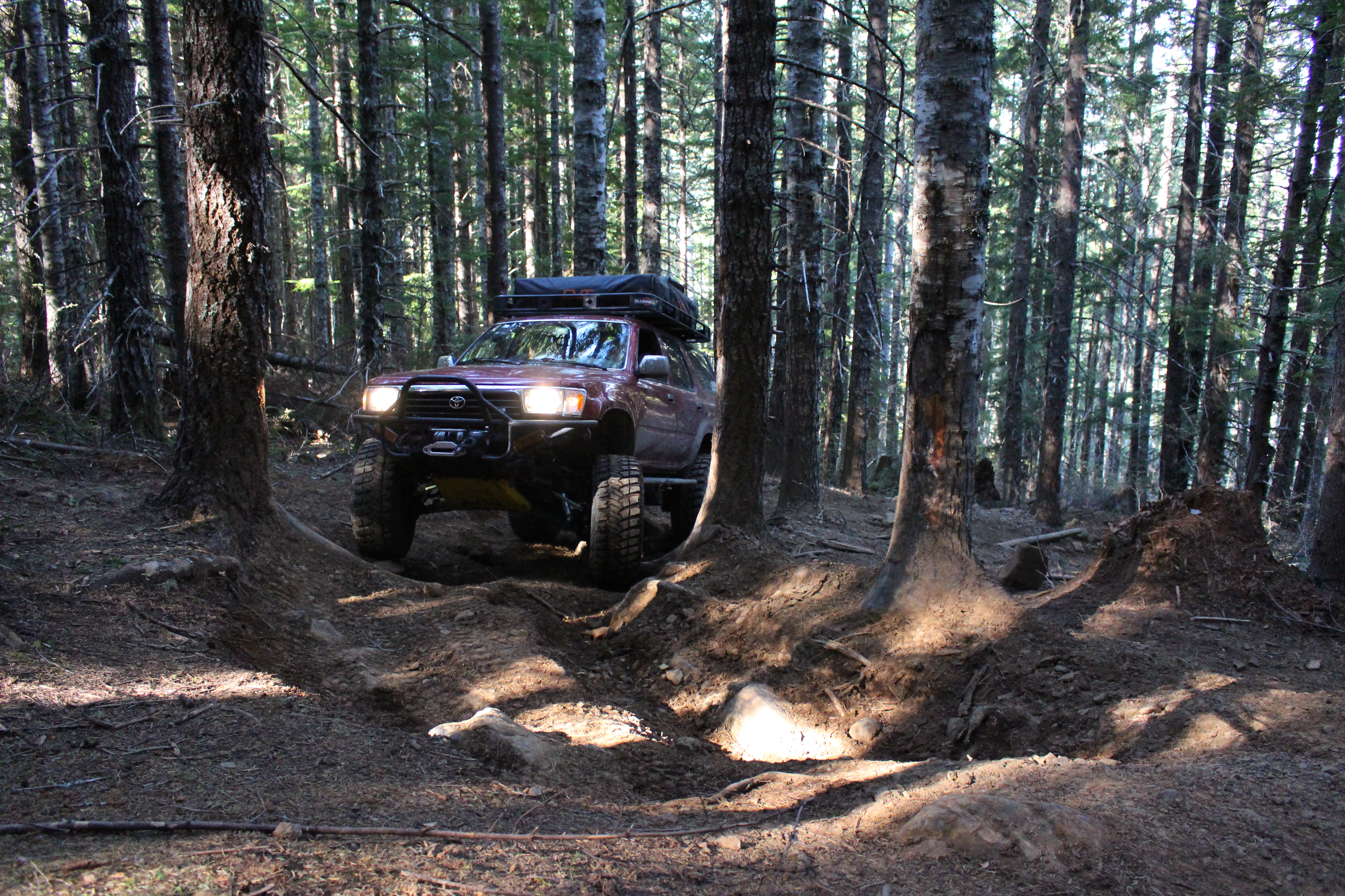

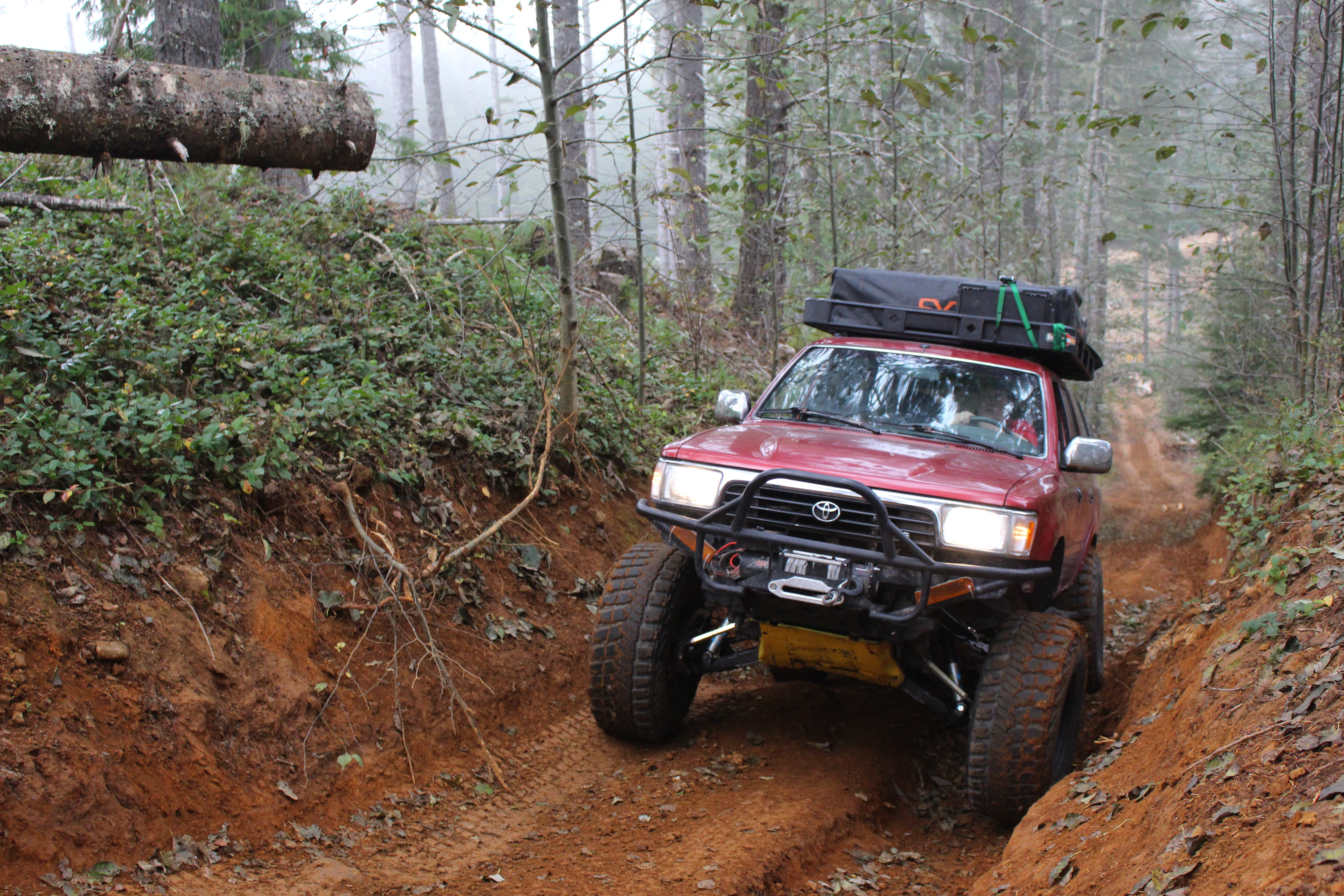

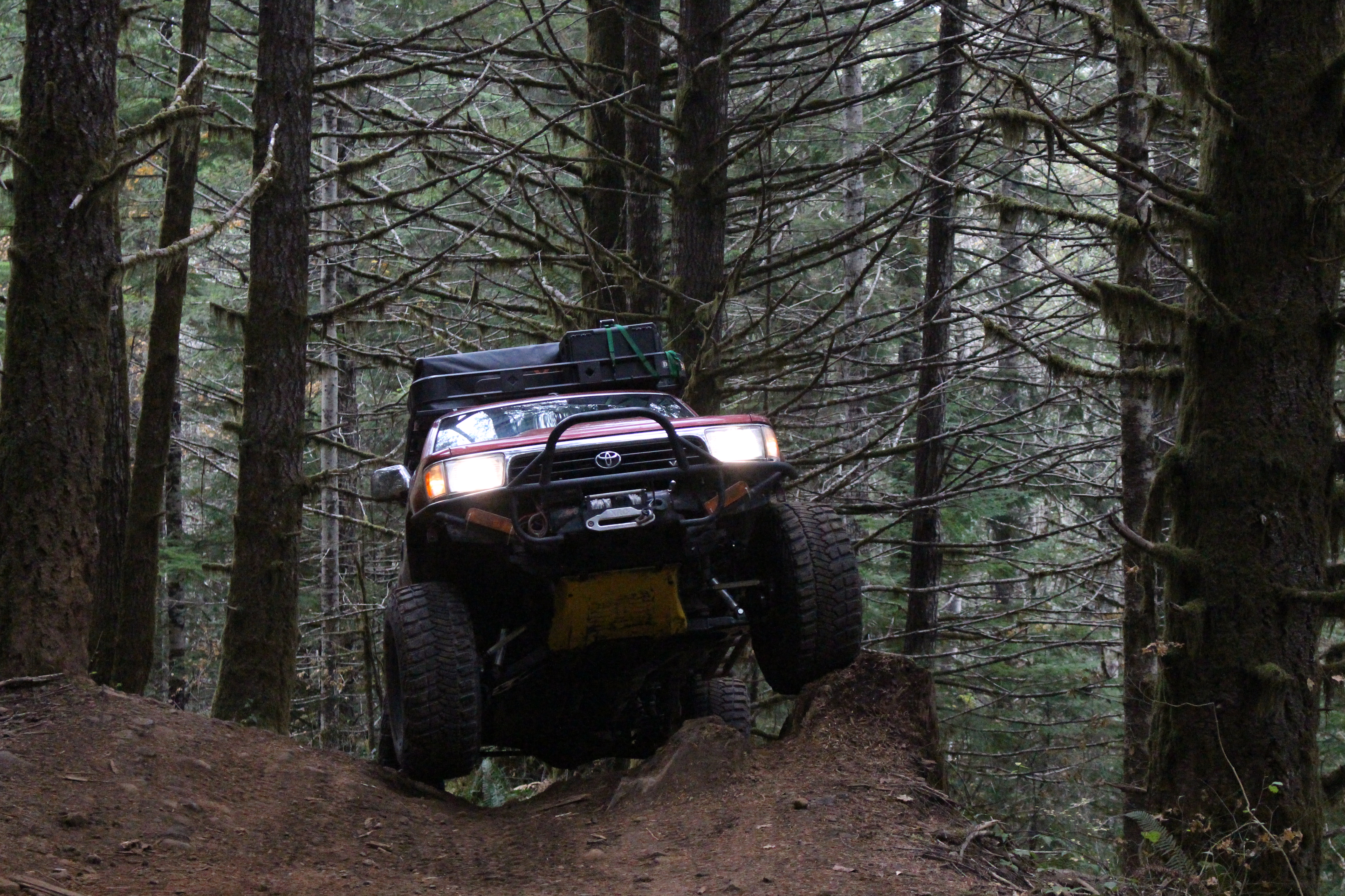

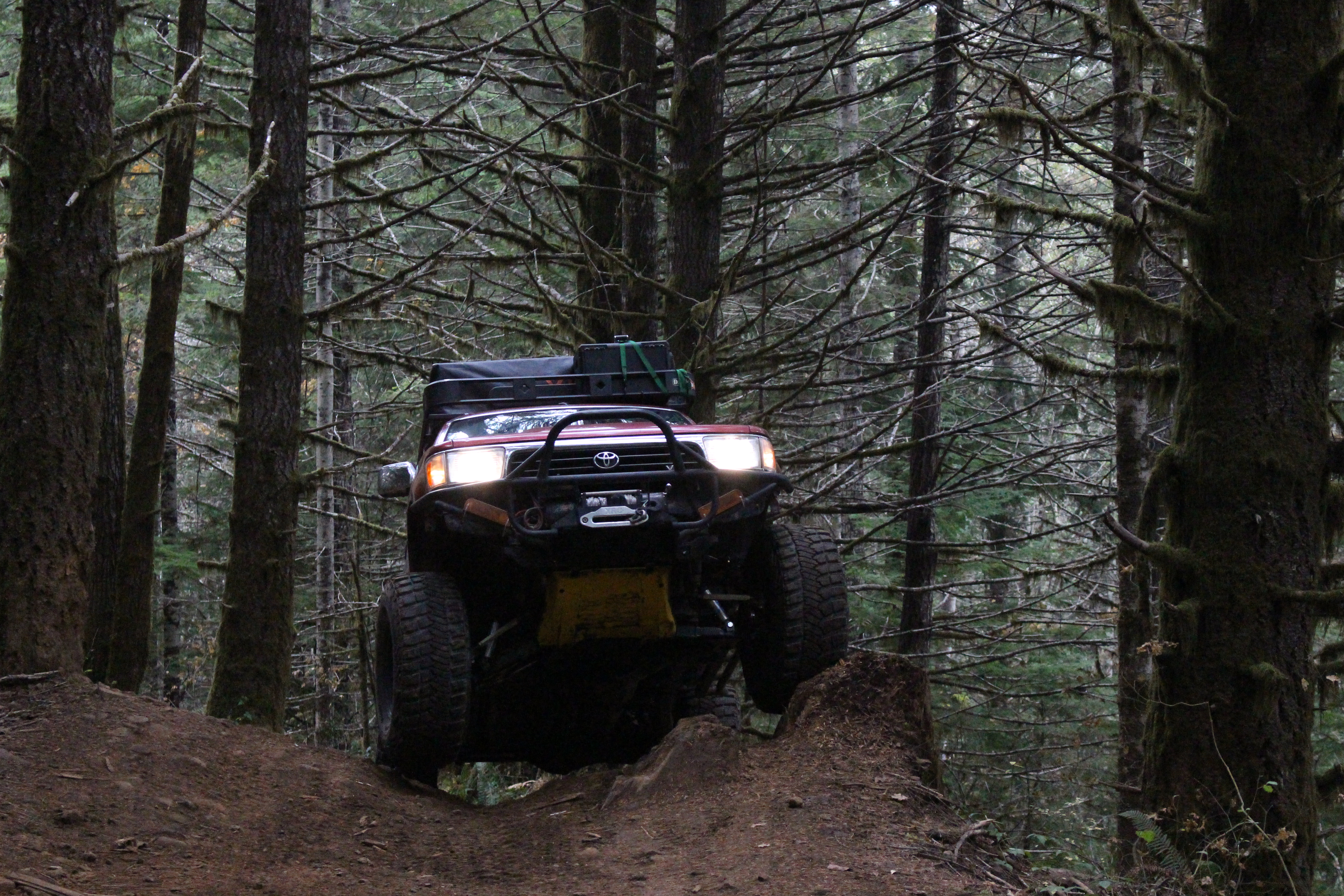

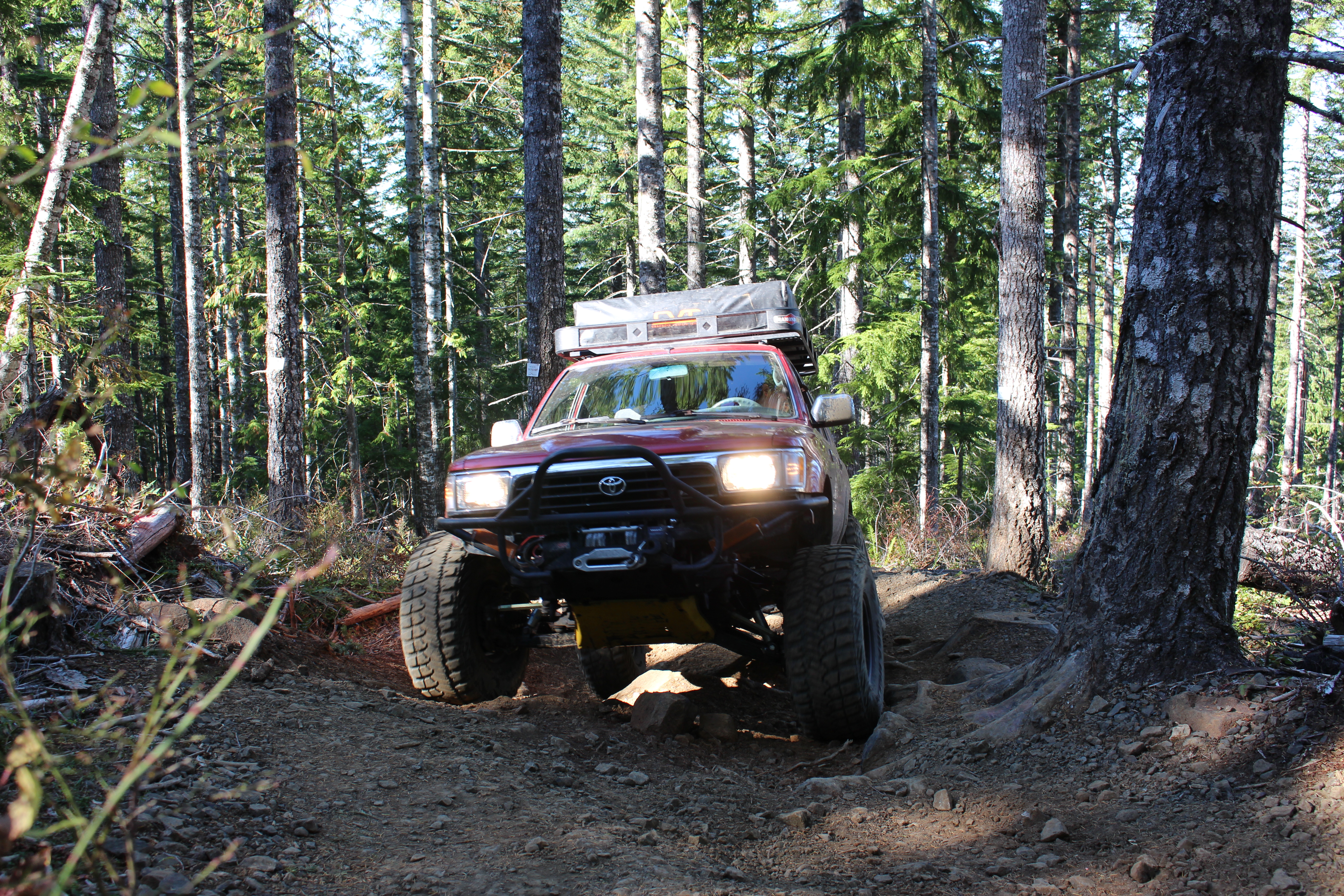

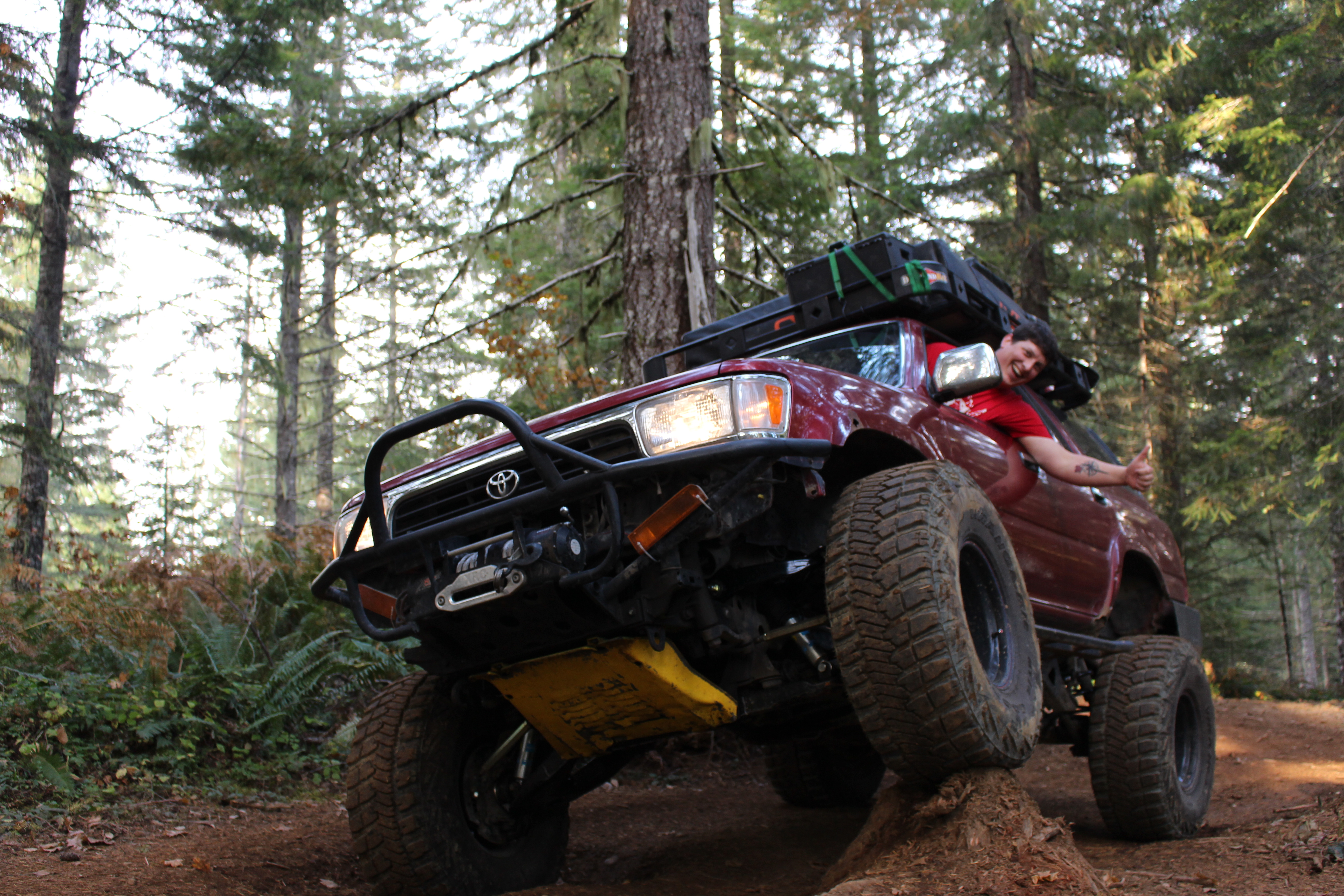

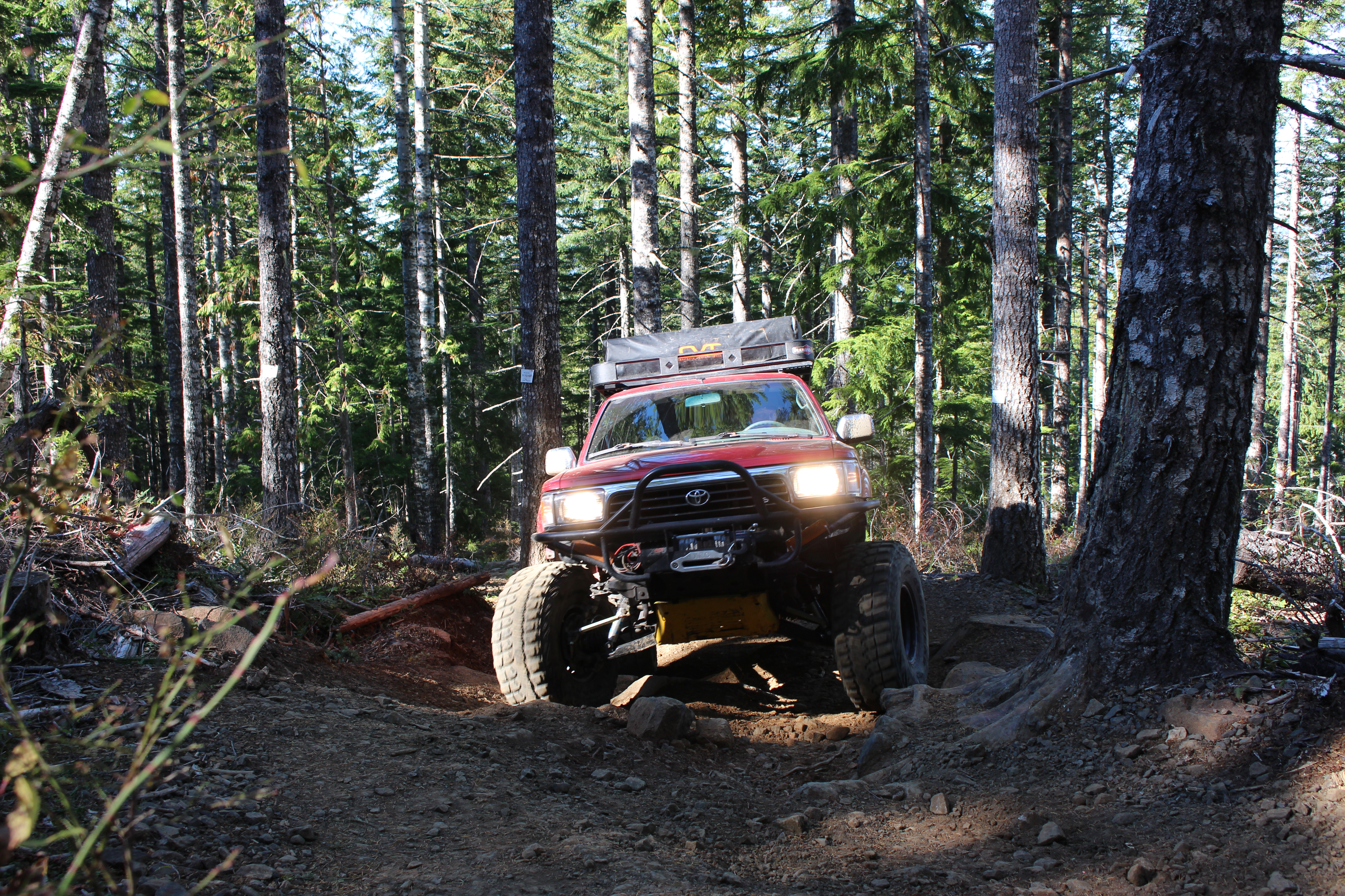

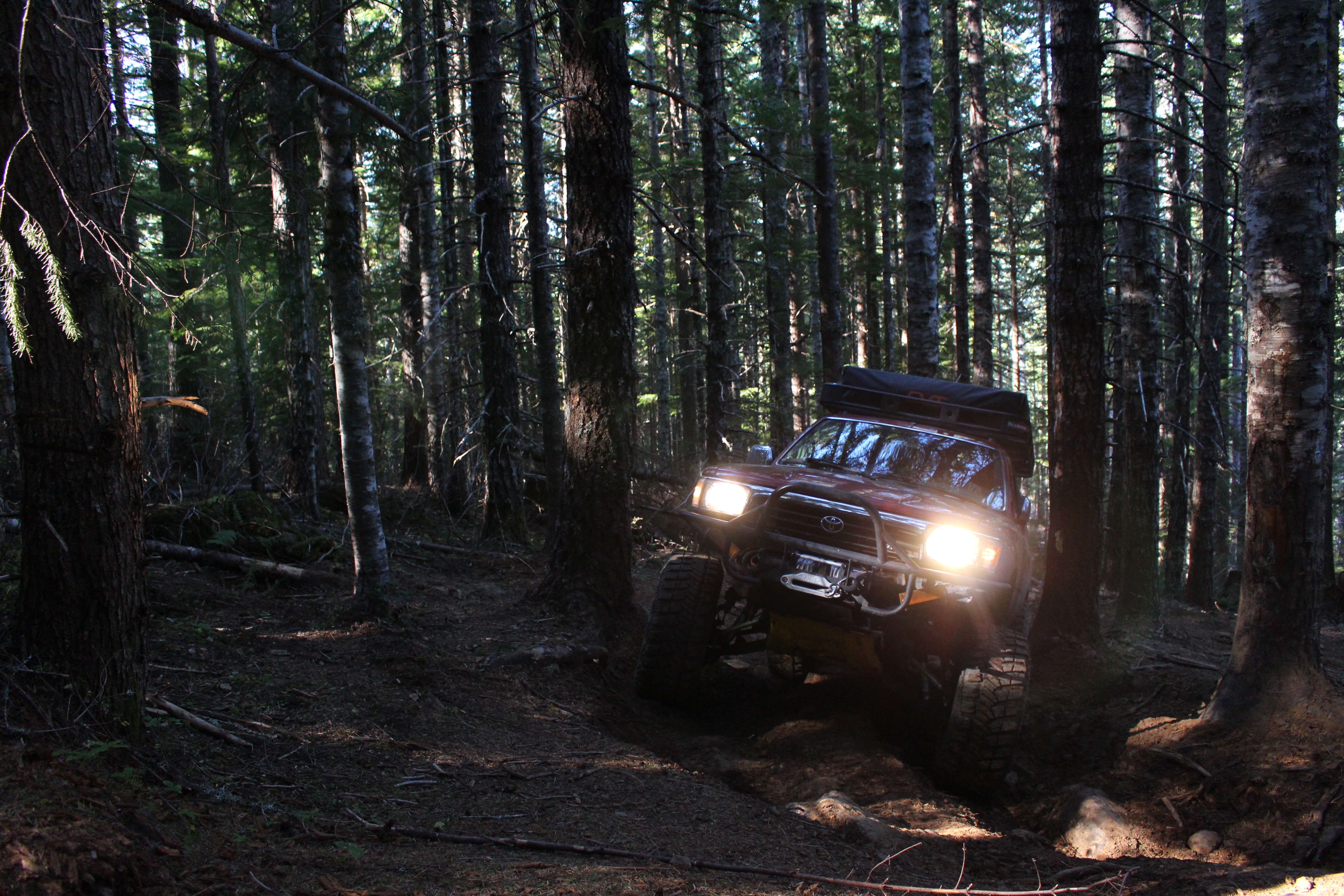

Nice photos man! About the tires pointing different directions - it happens to my rig too (even on 33s and without the blazeland kit). What happens is the idler arm is worn out and either flexes or gives in some direction when there is pressure on the passenger tire. On mine I've been trying to find the cure and what I've found so far seems to echo what BlazeN8 is saying: the offset rims are just super hard on those steering components.
Before buying a brace from Nate, I actually broke two idler arms - sheared off right at the joint. With the brace that is now virtually impossible, however I still get issues with the tires toeing in as the idler arm bushings give and are quickly worn out. The folks at the alignment place are always saying that I must jump it all the time lol...
It was so bad a couple months ago that I couldn't drive in the snow - when I put it in 4 wheel drive the tires would toe in like crazy and steering became almost impossible! Since then I have replaced the idler arm and tie rod ends which has been a temporary fix.
Brass bushings would probably help, at least for awhile - have you tried those?
It seems like the real solution would be something like the total chaos idler arm, combined with some less offset rims.
My offset is actually stock. It's just that they are 10" wide that makes them look that way. I only have about an inch of clearance to my outer tie rod end. Even if I bought new rims to suck them in it could only be 1/2 to 3/4 an inch. 3/4 might be pushing it even.
My whole front end steering other than steering box and steering stabiliser is new. Brand new in fact in the video. It was all put in the day before.
Due to the steering issues I'm getting pretty convinced that for my style of driving and wheeling IFS is not for me. The alignment issues has toasted $1400 in rubber waaaaaaaay before it should have. That is not pocket change.
Thanks for chiming i with your infor 90. It's great to know it's not an issue I alone suffer. Anyone with our years IFS who really like to beat the piss out of their rig do. agree with you on the weight and tire size. This is also why I'm starting to really consider the FJ62 axle I have again. I think it will pair up well with 35's or even 37's.

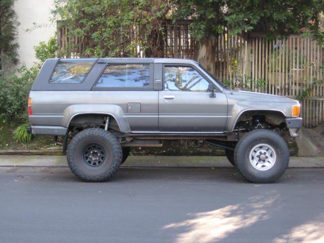

Pictured above is a factory rim that would be common on a 1986-95 4 Runner. It is a 15x7 and the backspace is 4-5/8" The tire is a BFG A/T size 35x12.50r15.
This size tire is not recommended on a 7" rim but I did find a shop to mounted it for clearance testing. I found the outer tie rod end did clear the tire, but with only with 1/8" to spare.
I found a rim that is similar to yours at 4WPH. Here is a link
http://www.4wheelparts.com/Wheels/Wh...ro+Comp+Wheels
The backspacing listed is 3.75" on two, there was one listed with 2.5" backspace but I highly doubt you have that. Your rim is going to stick out almost 4" further than the factory alloy.
Anyway, I don't want to hijack your thread with IFS technical. Its got such beautiful photos and narrative flow. However, I am taking note of your concerns regarding steering, alignment, and tire wear to heart. I do see the video and photo evidence of the quirks you are presenting and I appreciate it.
As far as finding solutions to keep up with your extreme wheeling goals I can understand your vision to go to the FJ62 live axle but you might want to go Dana 60 or 80 series Landcruiser. I don't see the title of your build thread as being accurate anymore. Its no longer a rookie restore!
