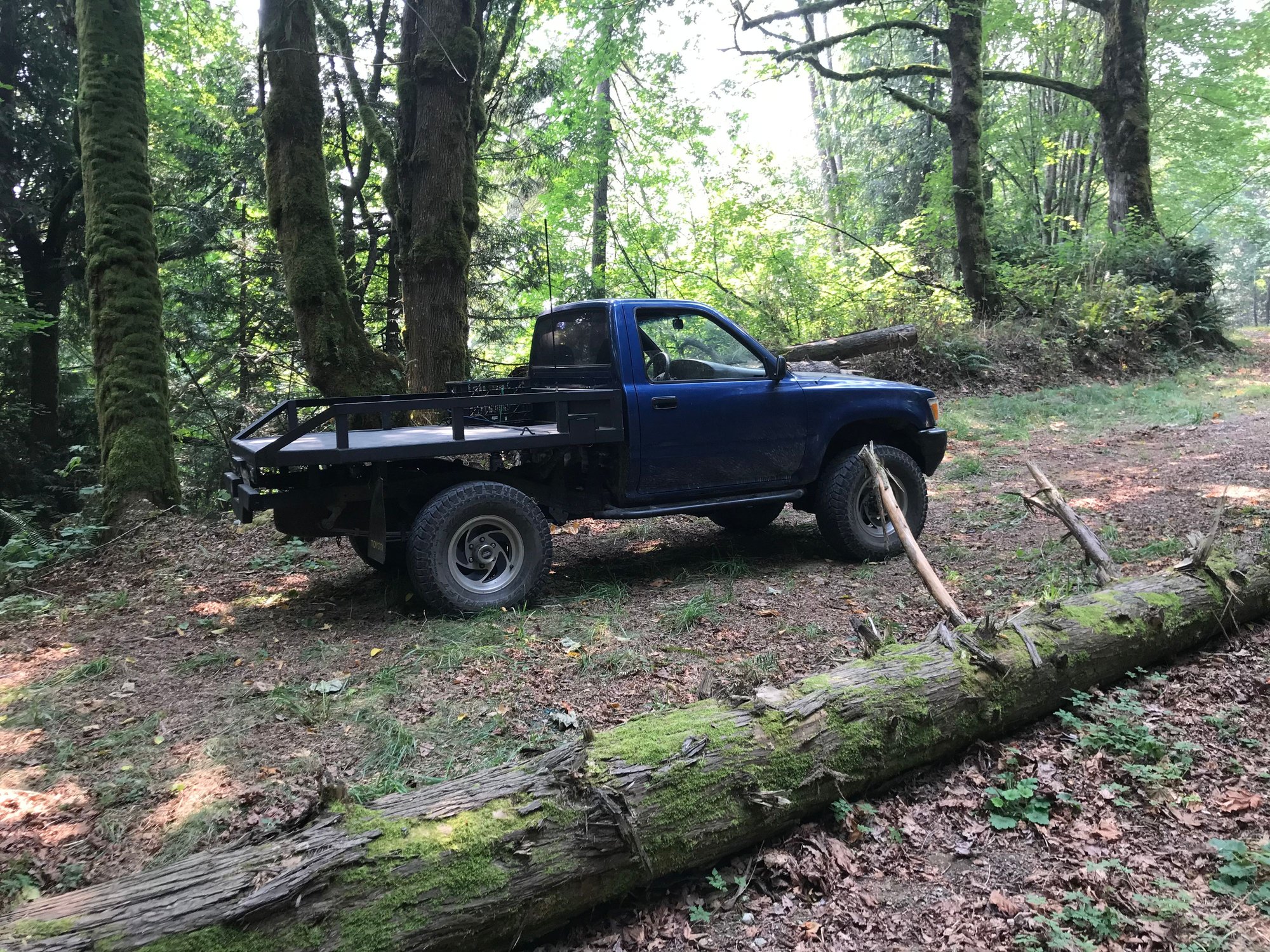

I've been using this forum as a source for knowledge, as well as inspiration and now I hope to document what I've done to my truck, as well as what I do in the future.

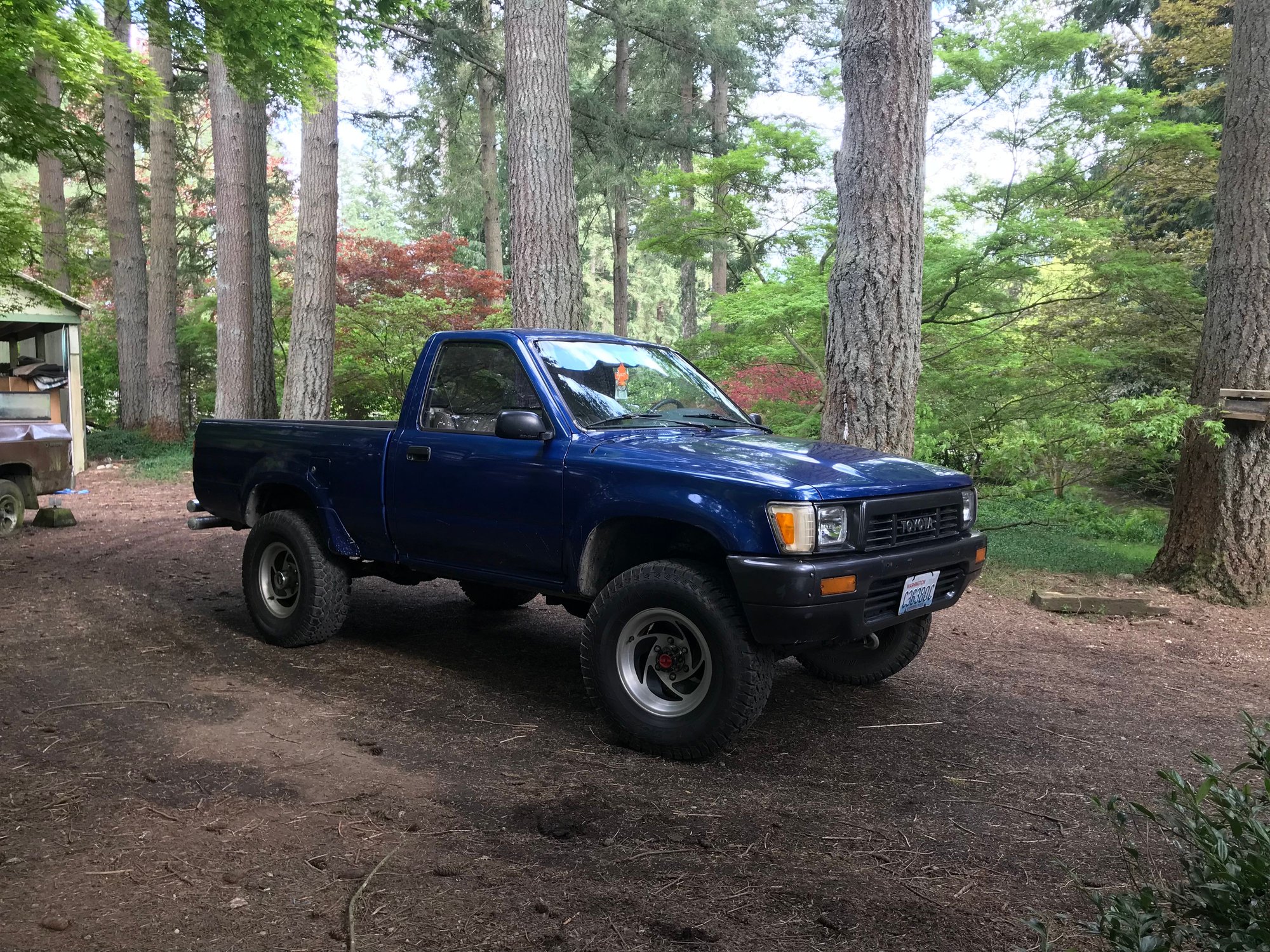

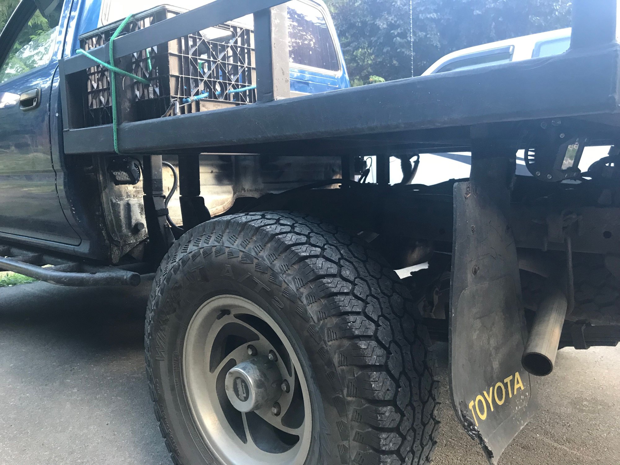

I bought this truck may 1st of this year and have been doing my best to turn it into my ideal work toy.
There was quite a bit wrong with it when I bought it. It still drove home, but the exhaust header was loose, radiator leaked, shifter tower needed to be entirely rebuilt, valve cover needed to be resealed, front brakes needed to be rebuilt, etc, etc,.

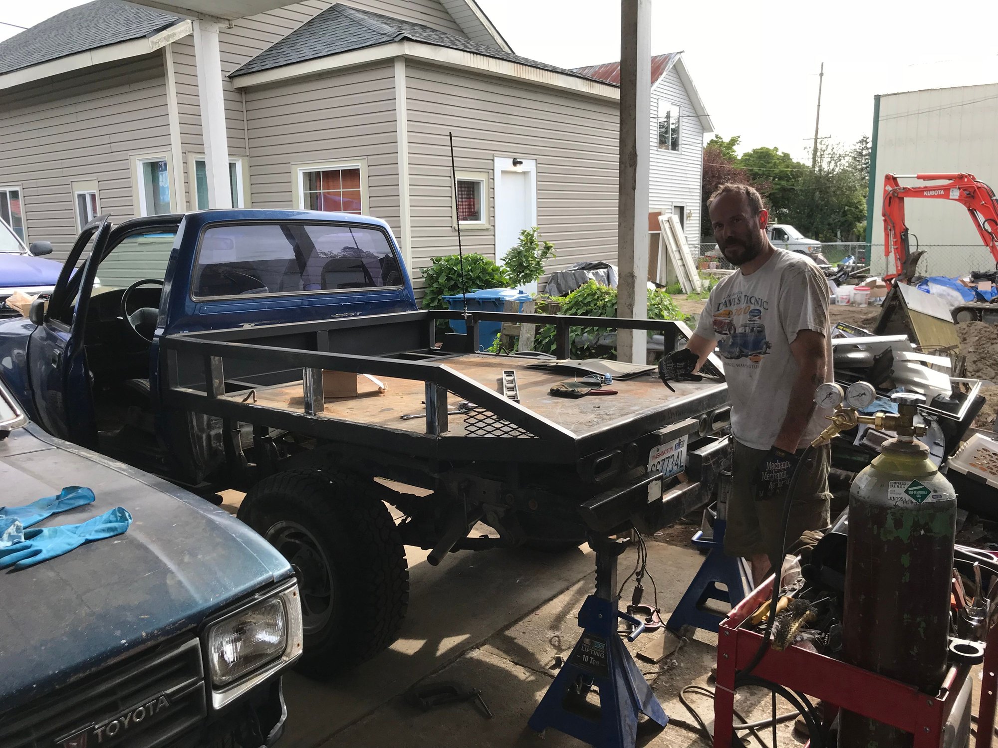

I took care of all of the problems I could find (not all of them though), found a bobbed flatbed that actually used to be my buddies 3 owners ago and about 100 miles away.
I got a different buddy who was looking for a clean 3rd gen bed, so we worked out a deal. He extended the flatbed for me, and I gave him the original. We also put some TG rock sliders on.

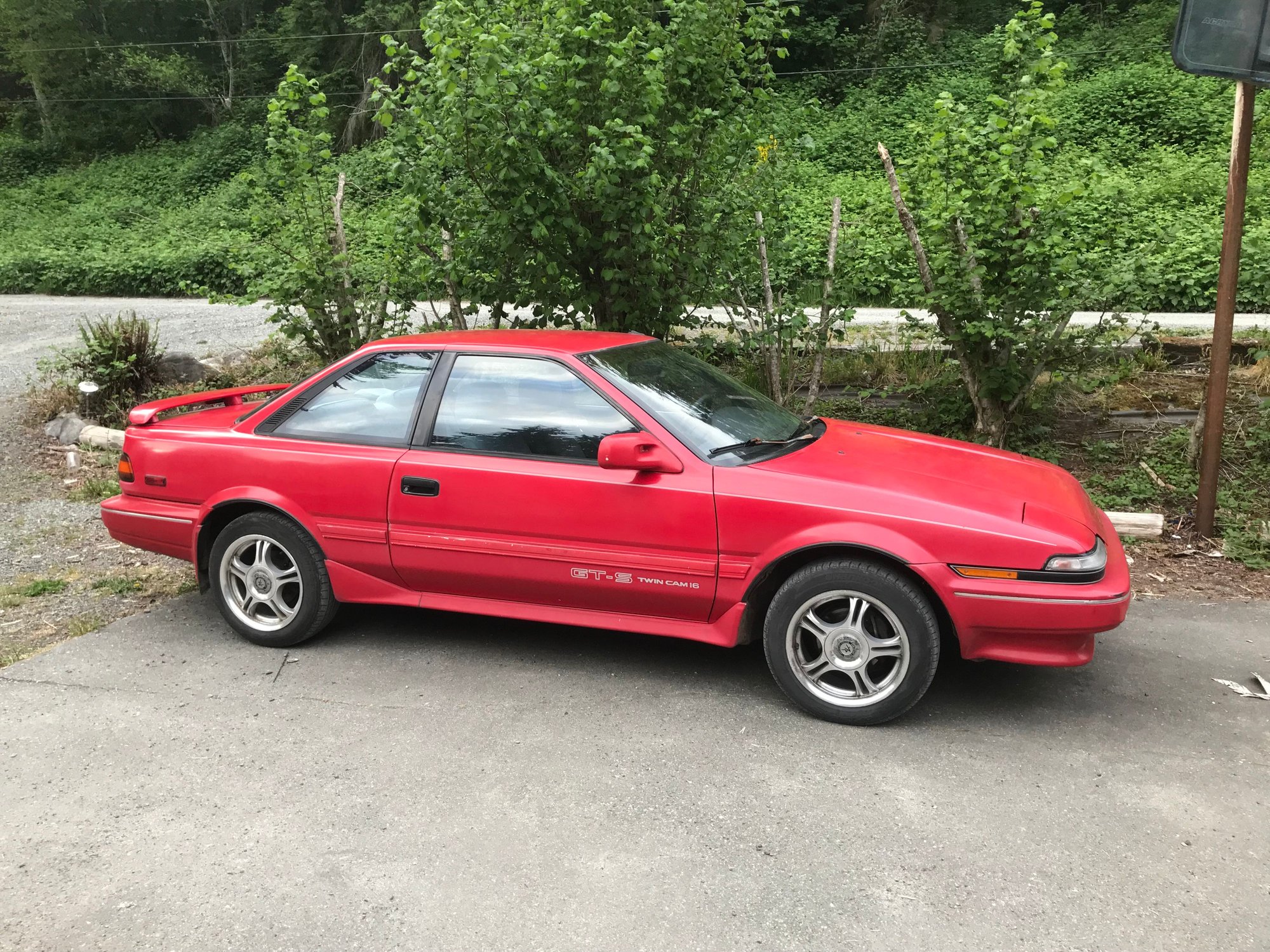

Got distracted by a 2 owner 1989 corolla GT-S that I found for $700!!! That thing became my daily.

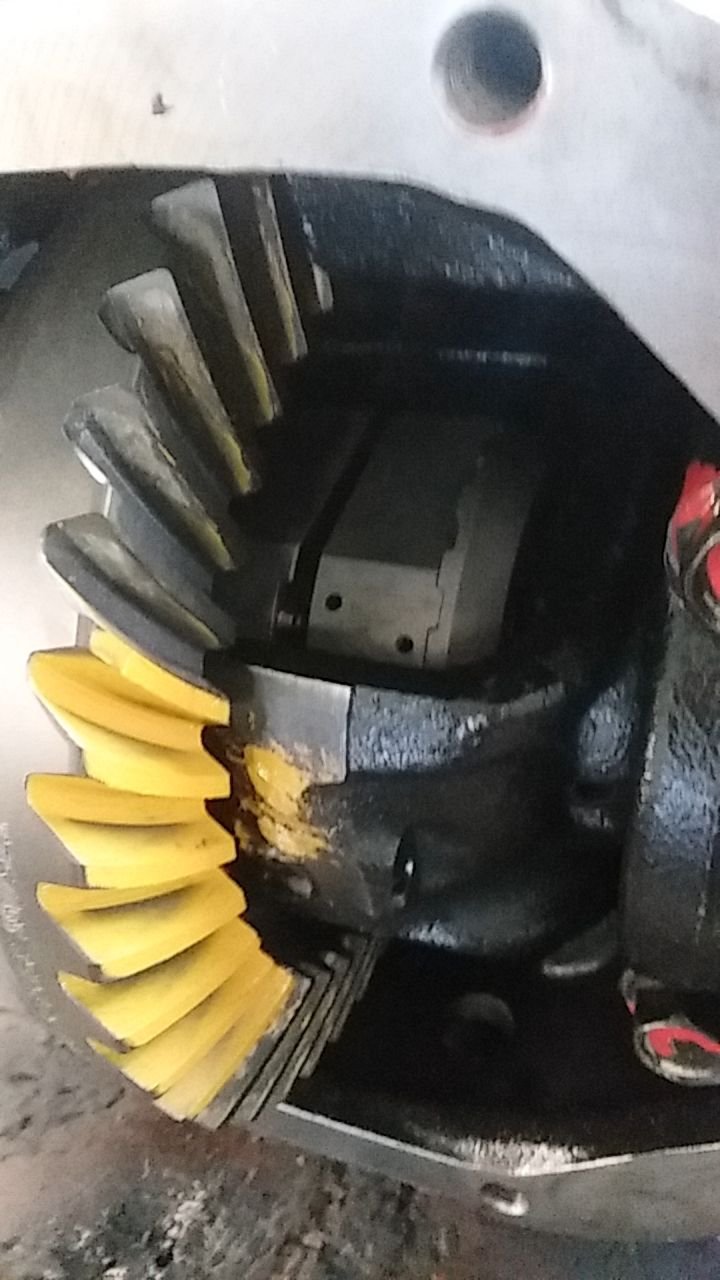

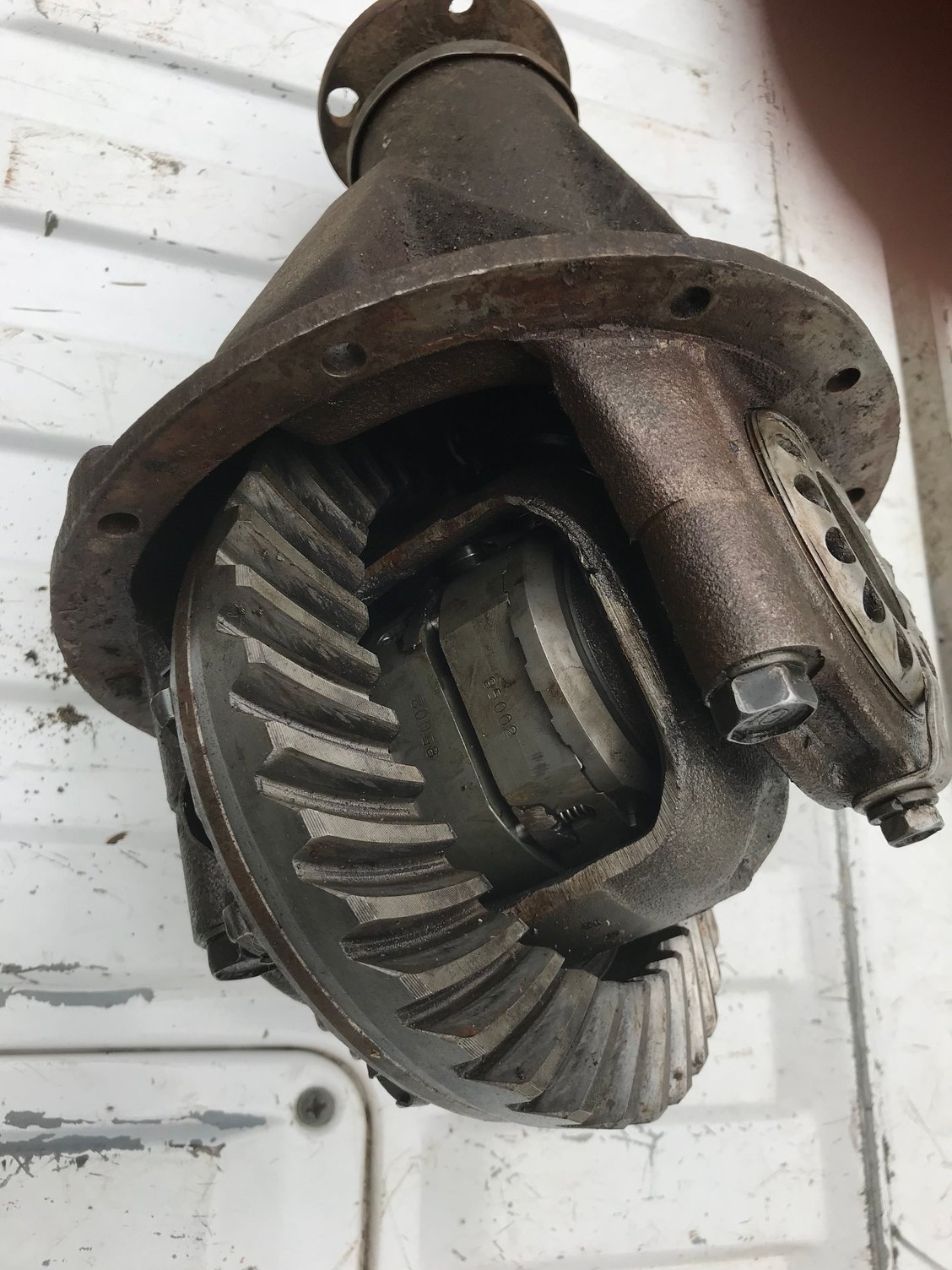

Found a Third with stock 4:10's bought it before I saw the lockrite was cracked,
so I bought a set of 4:88's for the front and rear, a Grizzly for the rear and a Spartan for the front.
Got those thrown in.
Don’t have a picture of the Grizzly in the rear.

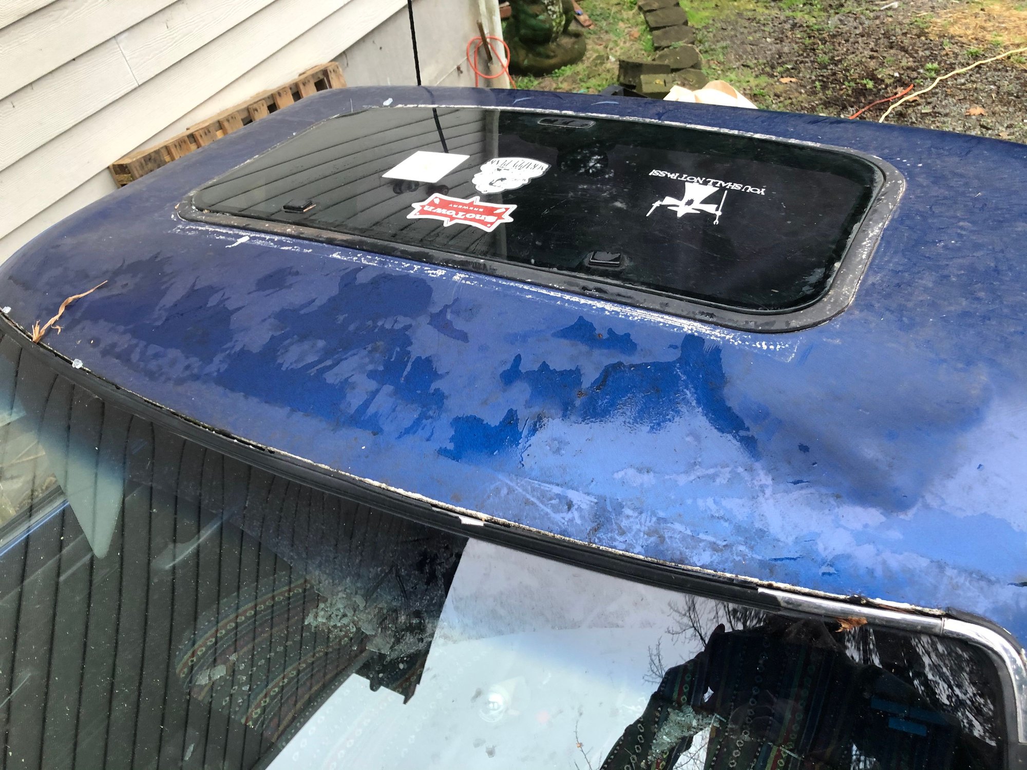

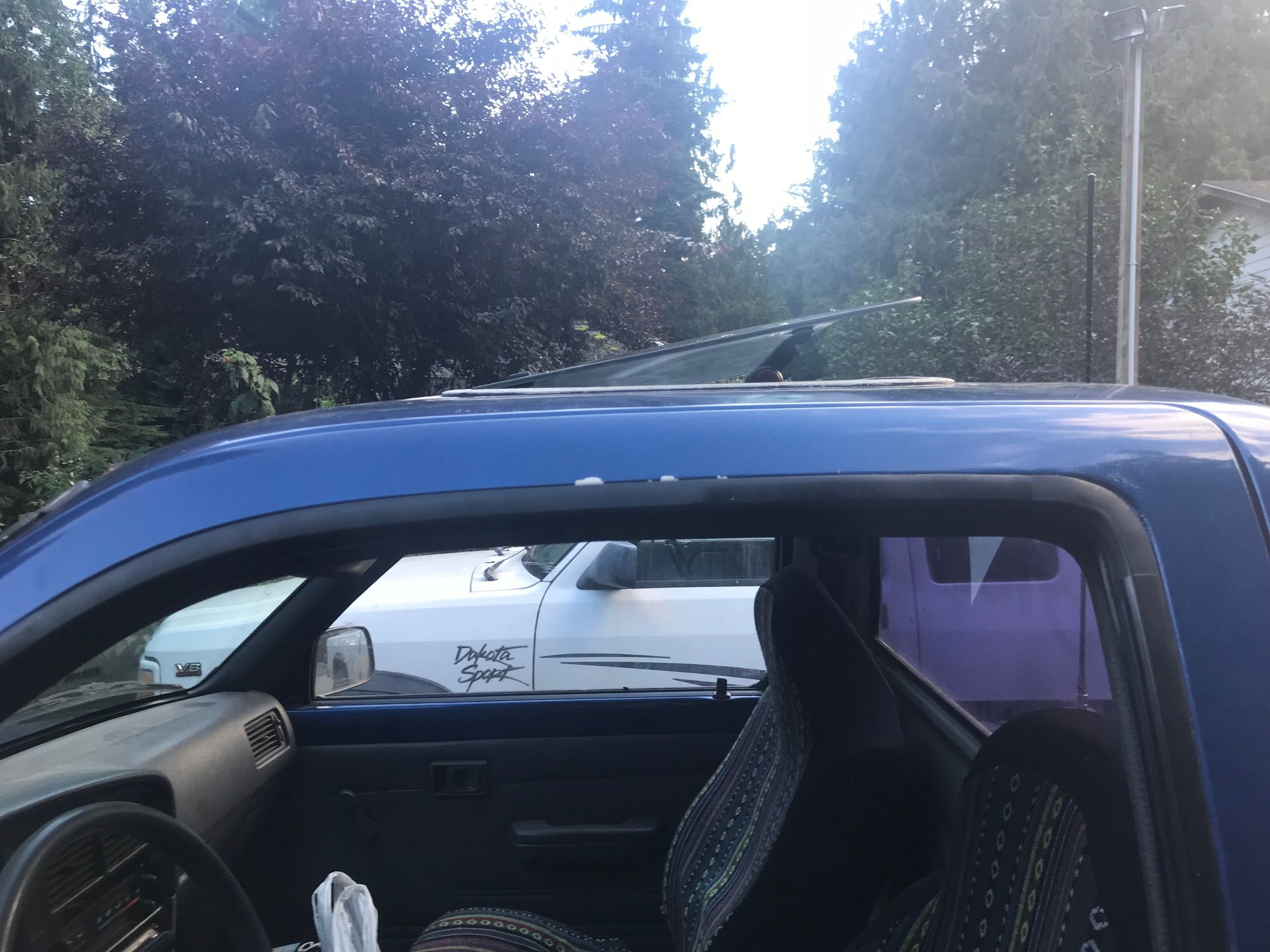

Finally wired up the spotlights underneath and put reverse lights in, found a sun roof, (it was a piece of plexi and a bunch of duct tape when I bought it), that made me feel better looking at the truck. The duct tape really killed me.

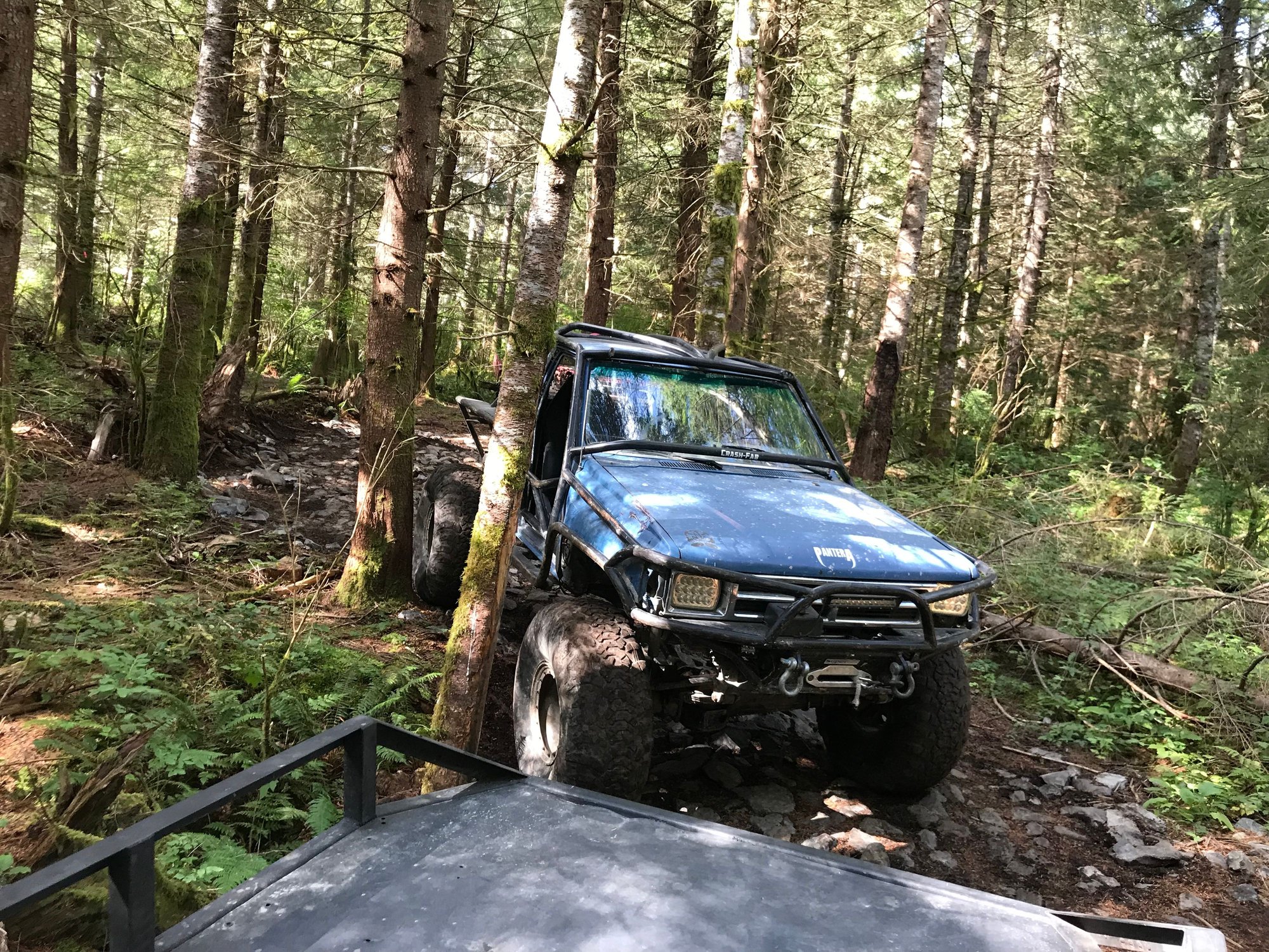

And bam. It wheels.

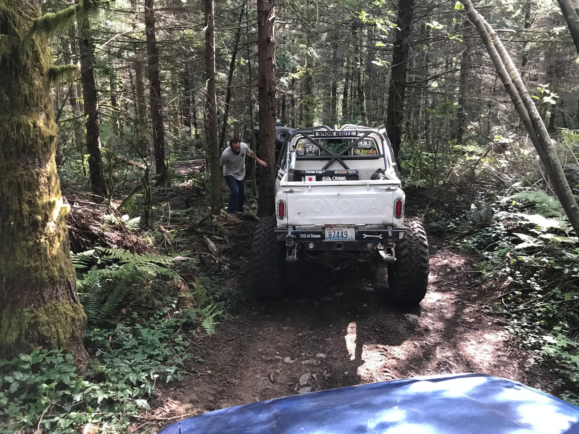

Those were the ridiculously built rigs I was between for my inaugural crawl, turns out I didn’t need a lick of help.
Meanwhile out wheeling we met a couple guys from B.C., down for a summer wheeling trip, with the rarest Toyota I’ve seen in person.
For those who don’t know, this one is a RHD turbo diesel. They’re other rig broke a driveline, so we took them down to one of our shops and got to drink beer while we all gaped at that yellow beauty.

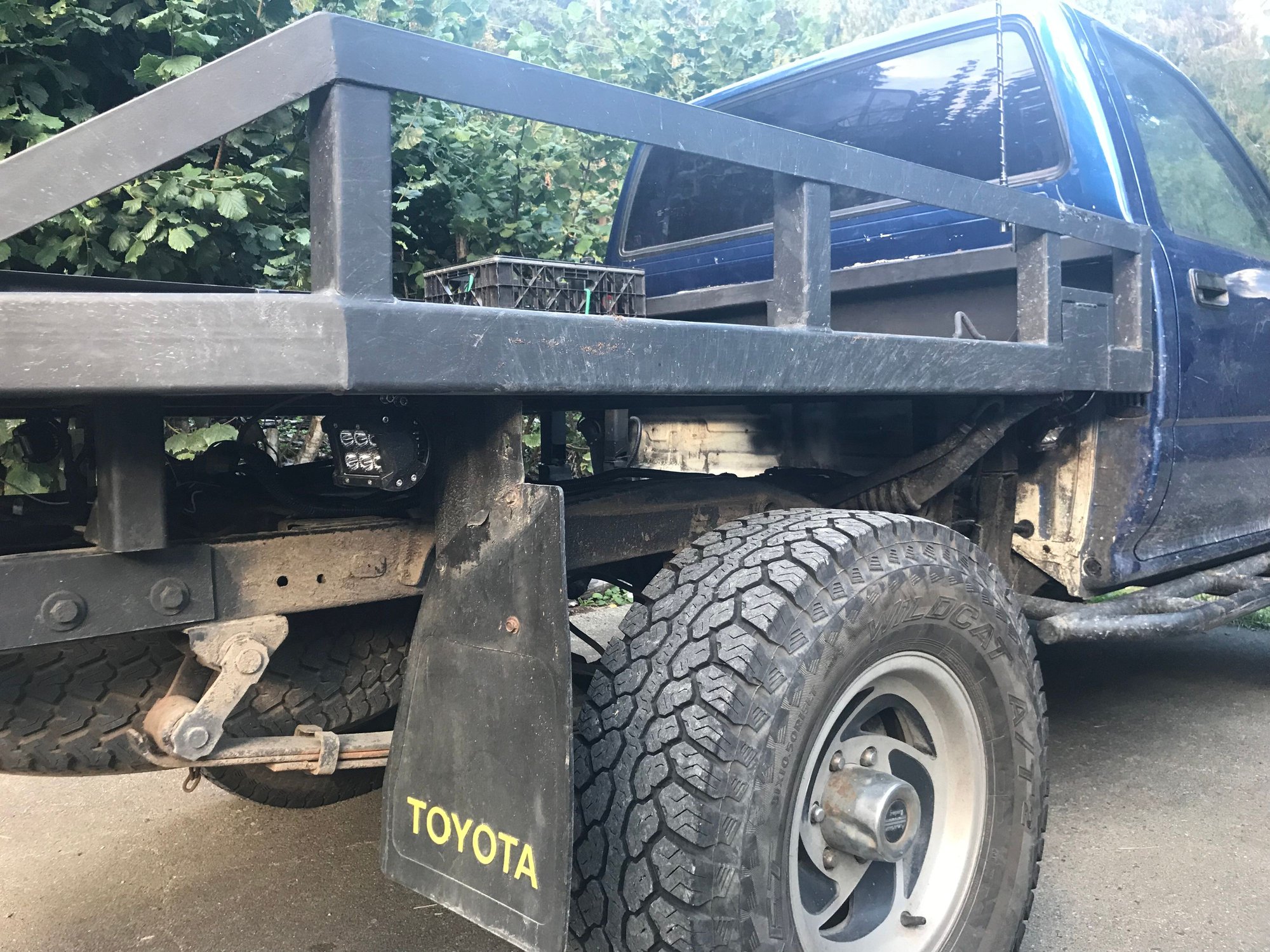

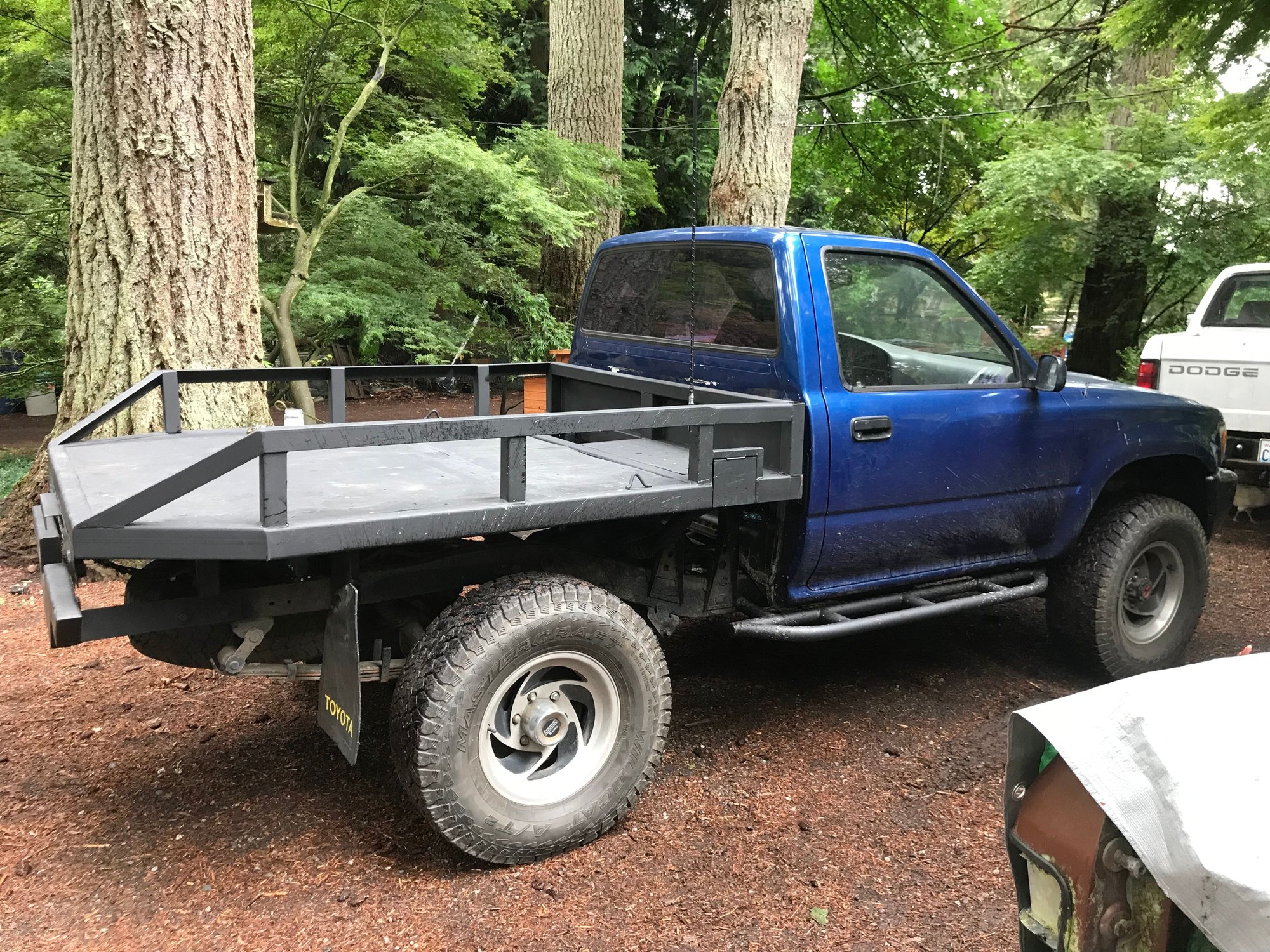

I've still got a lot to do on it, but I'm very happy with the progress I've made as well as how it performed on the trails, even on 31" A/T's

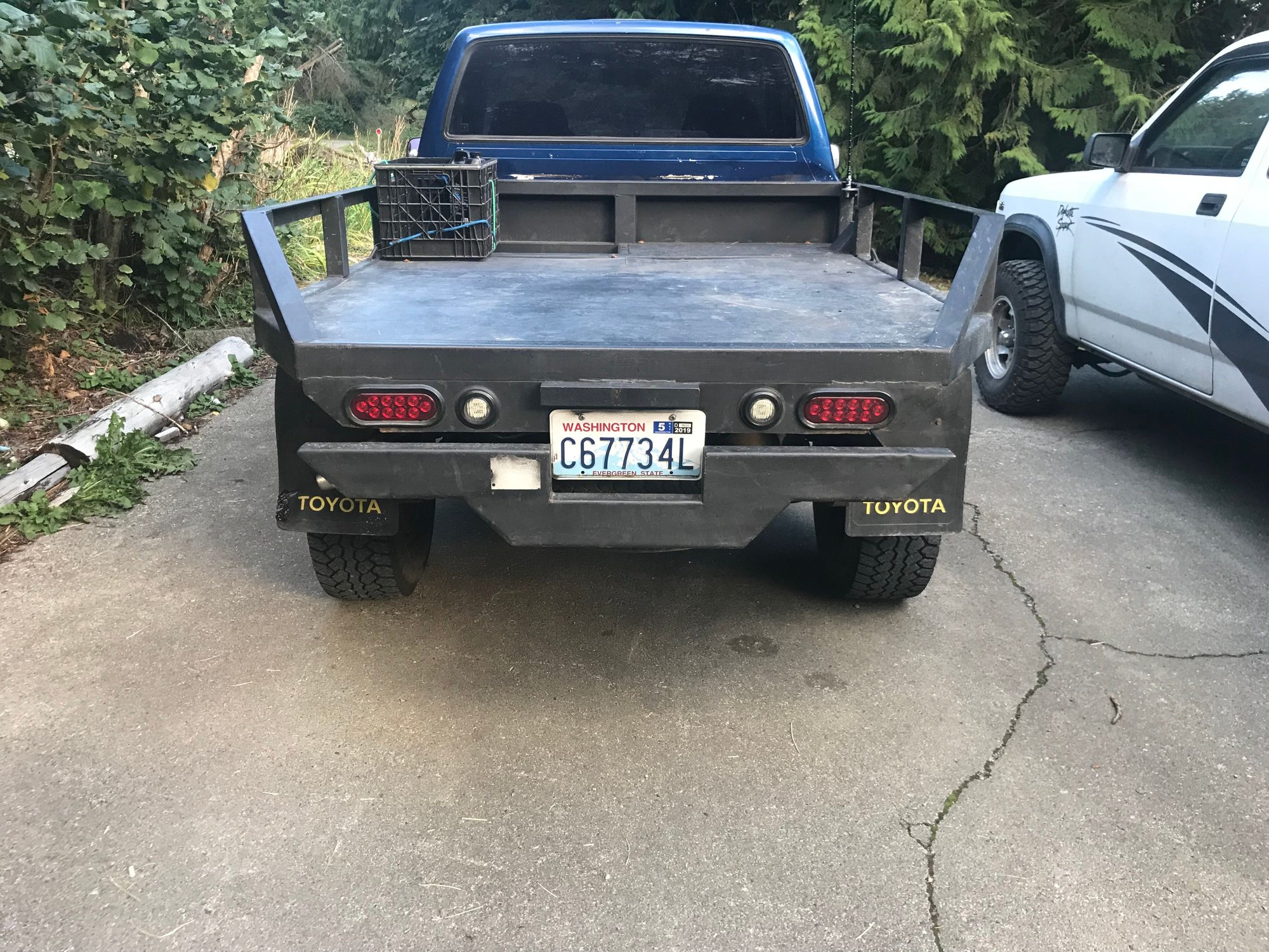

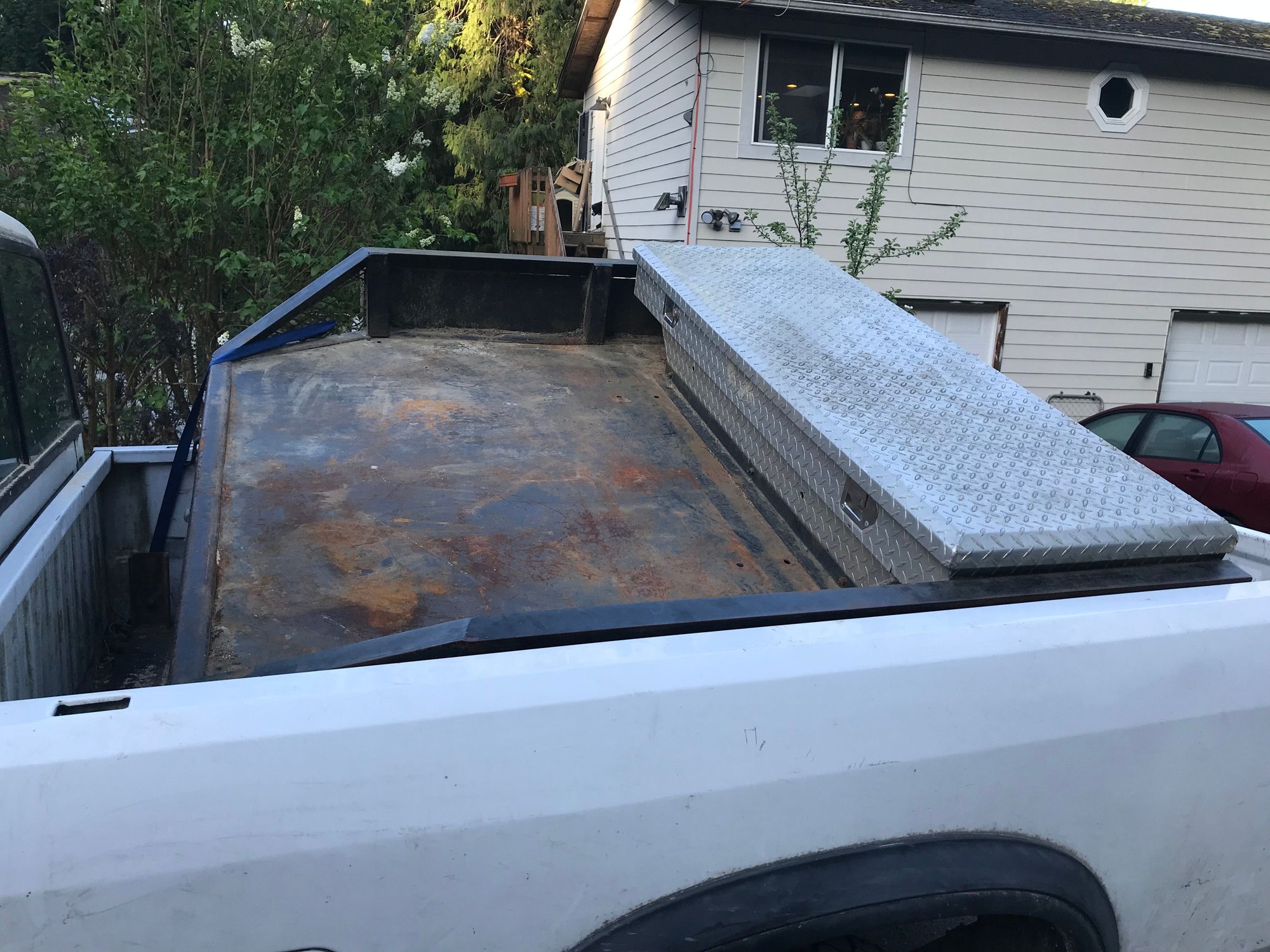

I plan on finishing the flatbed off with a drop in tool box, more strap mounts, a headache rack, and post holes in the back for a custom rack / camping shelter.
She still needs a lift, and a set of 33’s.
I’m also waiting on a tube bender to make my own front bumper. I want it to be incorporated into the stock one to keep it looking good up front.
I also need to fix the angle of the exhaust. On hot days when I’m at high speeds, it melts the mud flap.

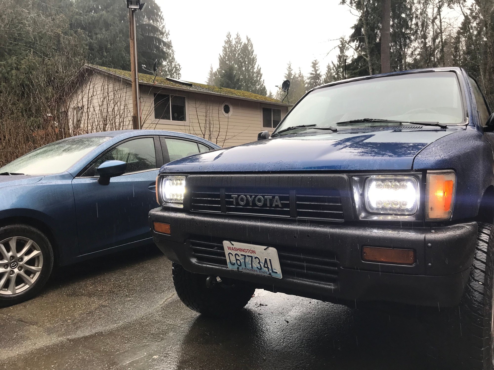

Got some pictures of it today.

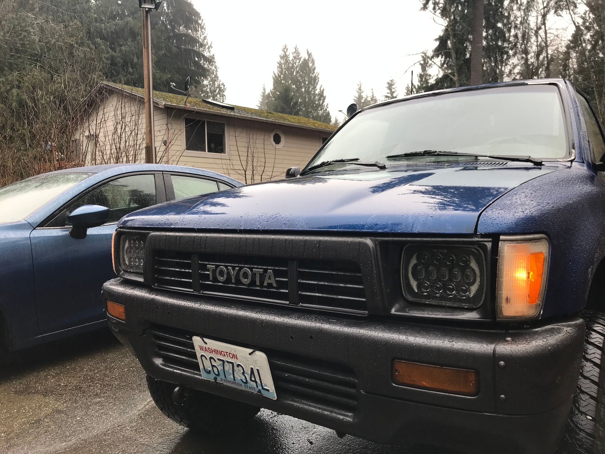

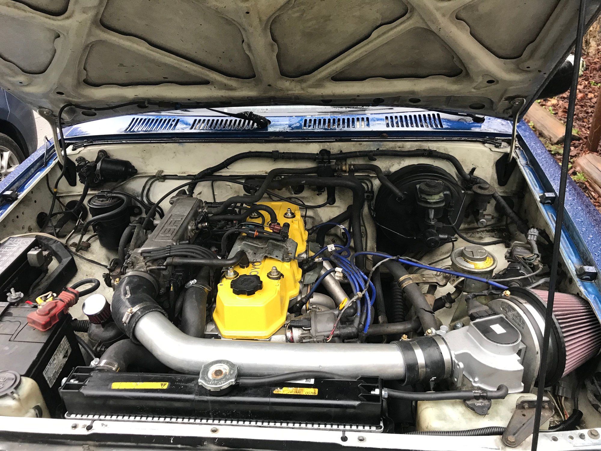

Here are the headlights. I’m rather happy with them. The relay system was very easy to install and there are no cut wires.
Here’s a picture of the engine bay. When all of the work was being done I went and got another valve cover and upper plenum from a buddy, I had the plenum powder coated blue, but I guess I wasn’t paying attention when I picked it up, because it was the older style and the angle was wrong.
Also as it happens they didn’t use high temp powder coat on it anyways, so the air injection plates are already tarnished.
Guess we’ll have to try a second time one of these days.

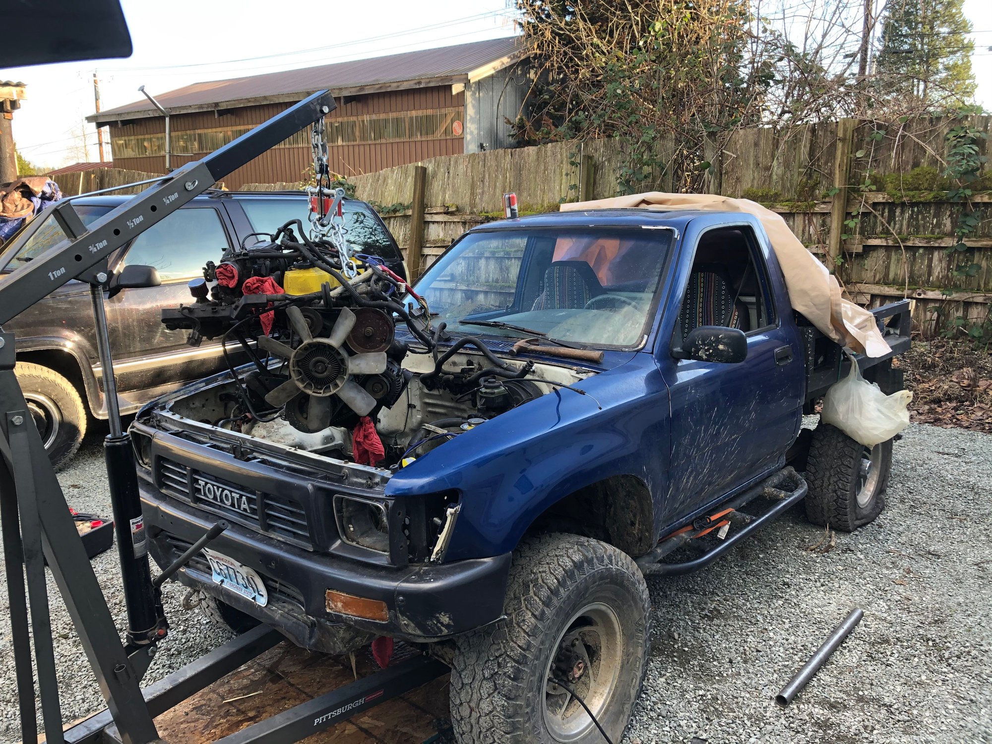

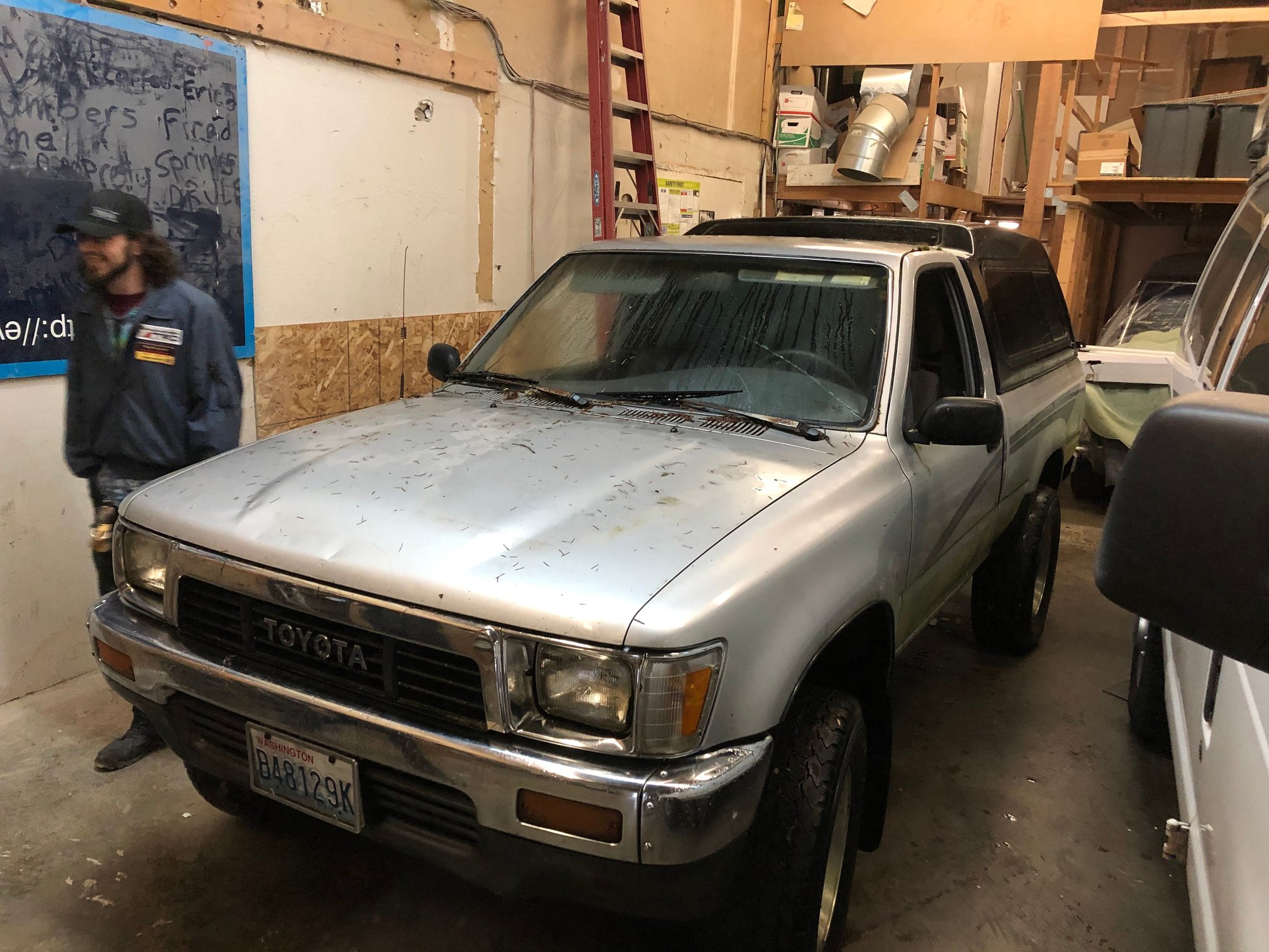

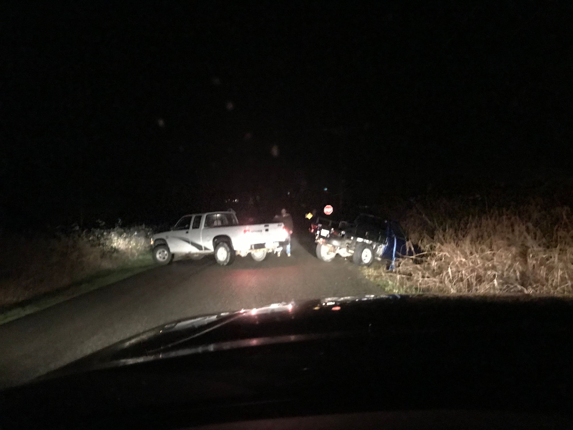

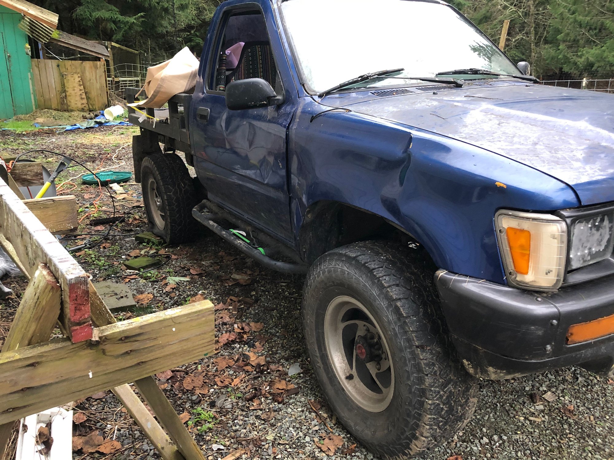

Well, I messed up. It was wet, I'd been drinking. I fishtailed around that corner, over corrected, caught the ditch with the driver corner of my truck and flipped straight over and landed in a flooded ditch. I couldn't get the doors open because I was pinched in the ditch and the cab was flooding fast, so I broke the driver door window and crawled out through the bushes. On the plus side we got to watch lots of fireworks while flipping the truck back over. but we wrecked the passenger side doing it. That glass is broken now too.

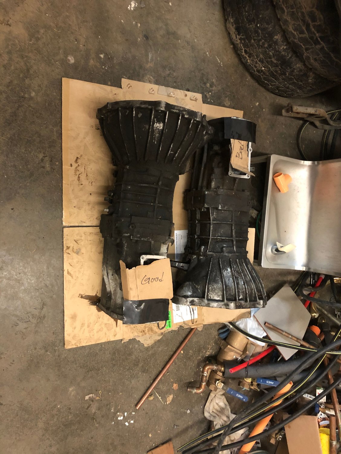

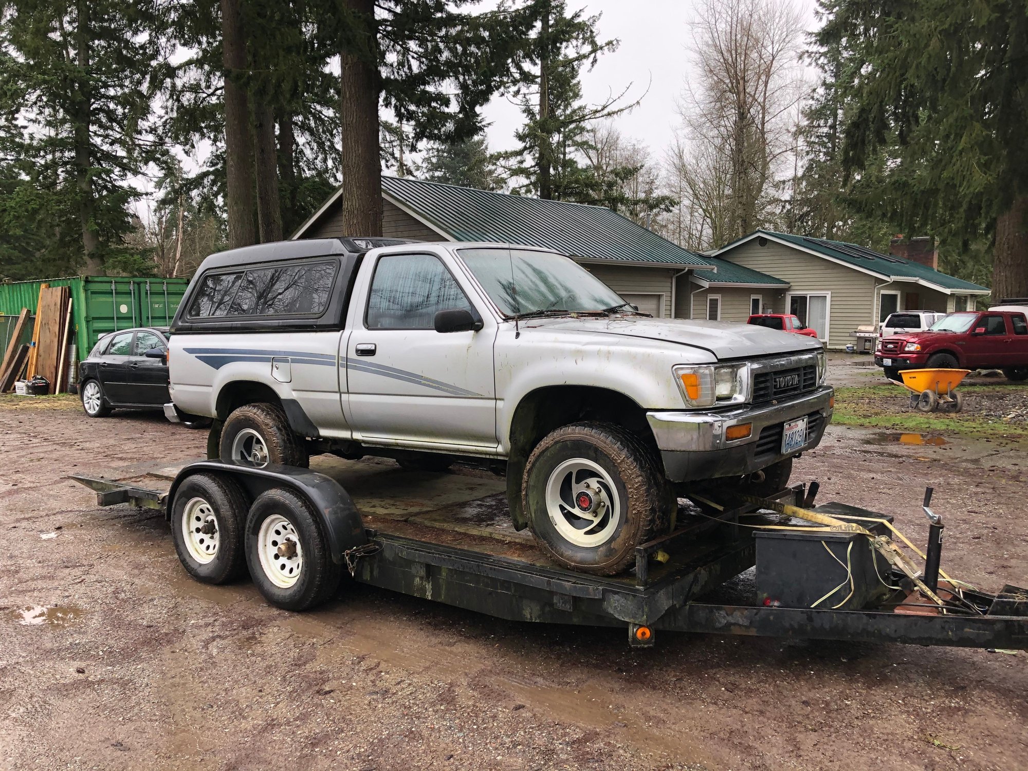

I spent a couple weeks looking for a good donor truck and I found this guy which had been sitting for 8 years in the mud and rain. It fired right up though, and it has a good w-56 in it so it looked like a great option to me.
At first I was going to just swap the whole cab and take the opportunity to rewire everything, but I changed my mind. We're gonna cut the sliders and extra bed mounts off and weld them to the new truck, pull the motor and diffs and swap them into the grey one, then I'm gonna take my T-case off and dual case it since were gonna be in their already.
I ordered the dual case adapter today and I'm gonna take a trip down south and start collecting a new clutch kit and hydraulics. probably some other stuff as well.
What I know is broken:
Driver CV axle
Both door windows
Relay for the led headlights is fried
Most fuses are blown
Something is draining the battery, I'm expecting the harness is pinched on the passenger side where it goes into the truck
I'm sure much more

But on the bright side, I have a fresh Tranny now, I get to dual case it and can eliminate the sunroof which always made me nervous.

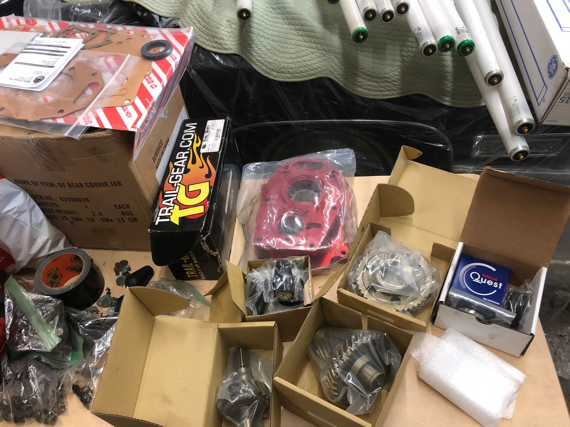

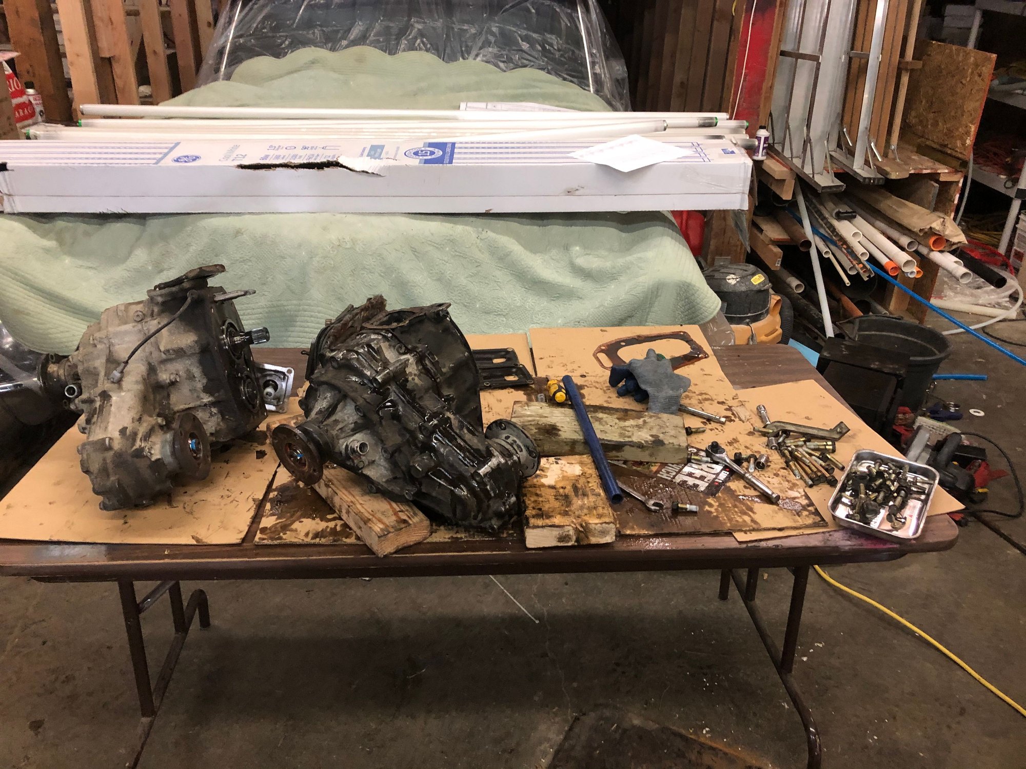

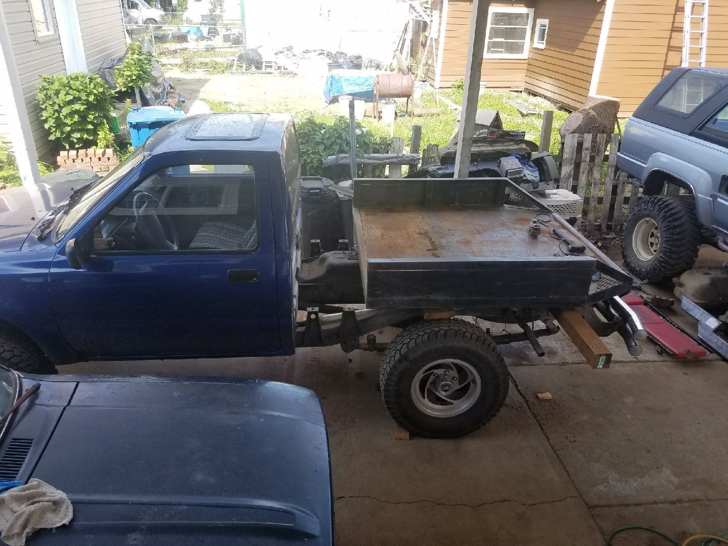

Making some progress!
I’ve been selling stuff off of the grey truck as I get it all out of my way. We got both motors and trannies pulled, I still need to get my diffs out and moved over.
There are still a bunch of things I need to do and get, but I’ve been trying to start with the transmission, just trying to divide and conquer as I go, but also strip down the blue truck to get it out of my hair.
