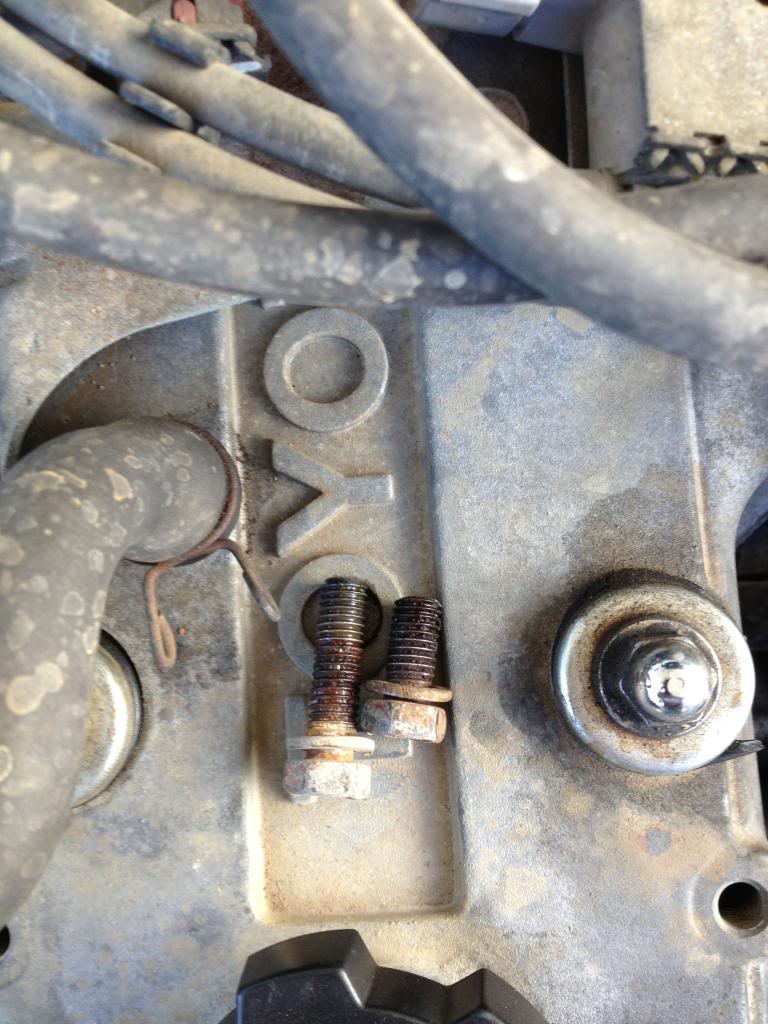

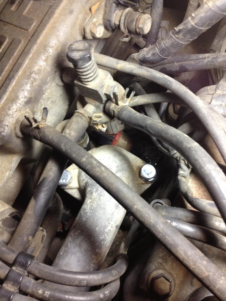

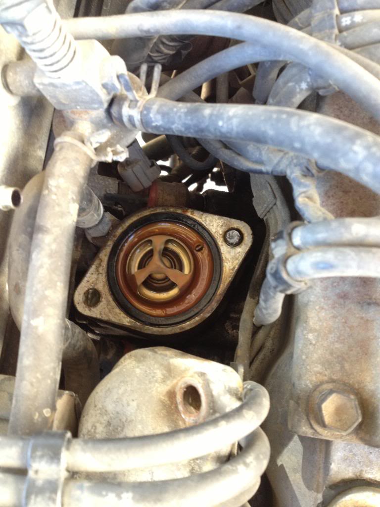

Narrowly avoided disaster. Attempting to replace the thermostat annnnnnd: Name:  AF099EAC-7834-4F0E-97D5-121984B3C8A3_zps0o8cwdp9.jpg
Size:  91.0 KB Snapped off one of the bolts. Name:  F405B8CE-63F6-4EC9-A315-3442D5A1AF95_zpsrpvznbmr.jpg
Size:  110.3 KB Was able to drill it and removed with an easy-out and pb blaster. Bought 2 new bolts and good to go:Name:  AA198CFD-C3F4-4EB2-BE04-5900AD2468B7_zpsztznhoqd.jpg

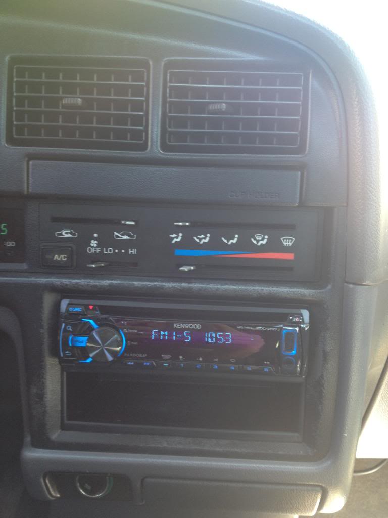

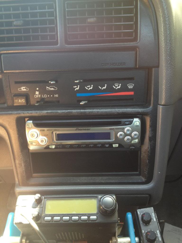

Haven't had much time lately but I did get new stereo in.
Before:Name:  BDC66362-E5EA-4045-9804-EEC8E8FFF5BF_zpsc5wme0gu.jpg
After:Name:  30757164-300B-4C87-964D-190767D720BD_zpsmzdiwoqx.jpg
Blew the dome light fuse but was able to solve that little mystery.

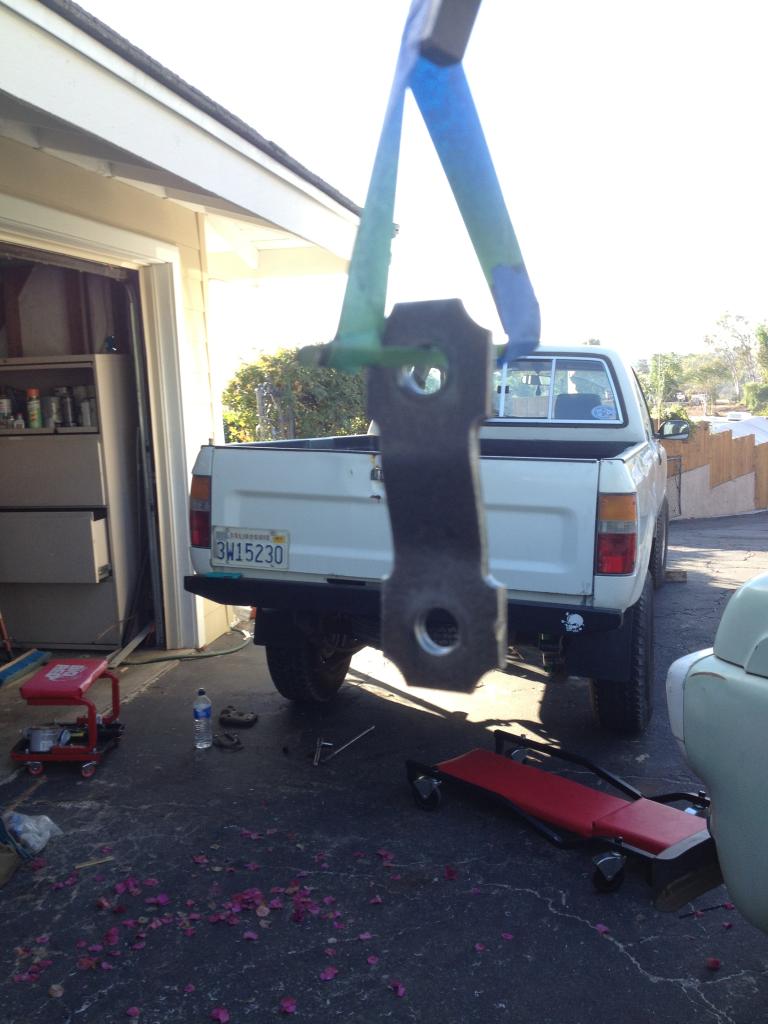

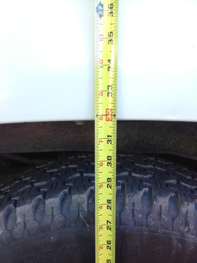

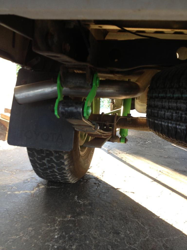

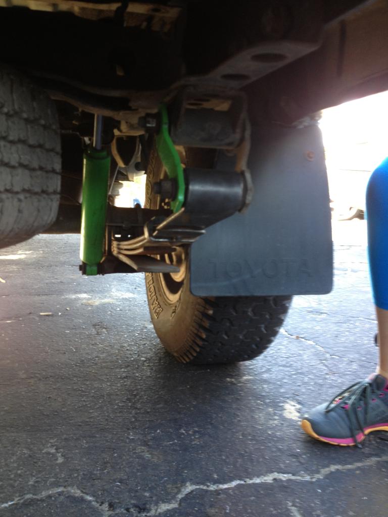

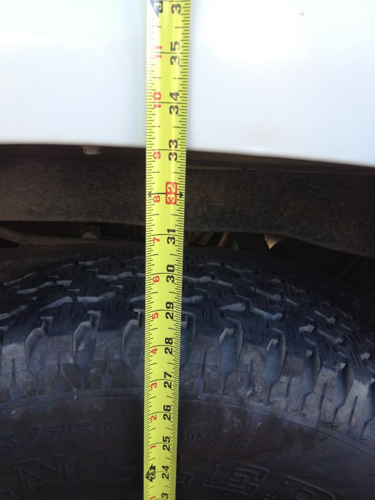

Well I decided that while on thanksgiving break from medic school, I would do something about my saggy rear end. Was able to pick up a set of used springs from a slightly newer extra cab on CL for 30 bucks. Score! They already had an AAL (add-a-leaf for those who don't know) that the PO had already installed. Double score! Did a quick wire wheel to knock some of the rust off and then got to it.
Here is the height the truck sits at before
This is where it sits now

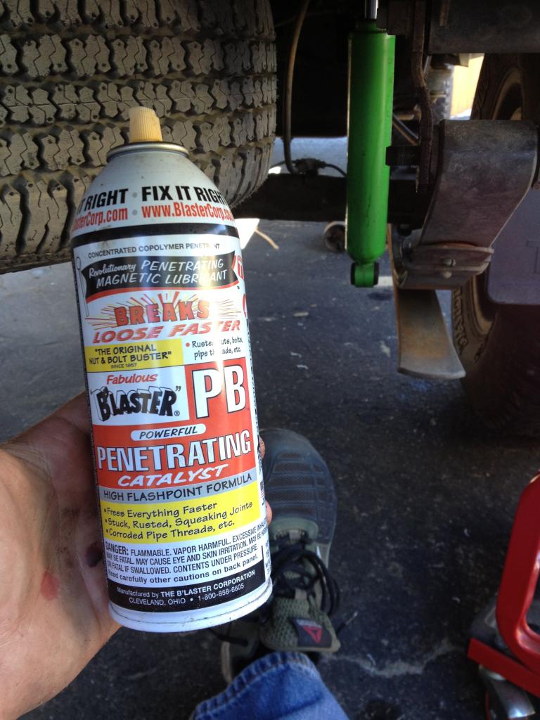

Didn't run into any real problems aside from a couple stubborn nuts. Just remember. PB Blaster is your friend!

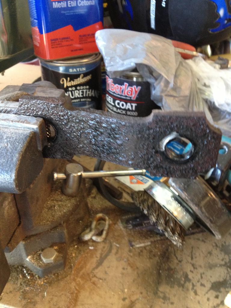

Inside half of the rear shackle had some major surface rust so I wire wheeled and painted.
Even got the wife to help paint!
Drivers side finished product

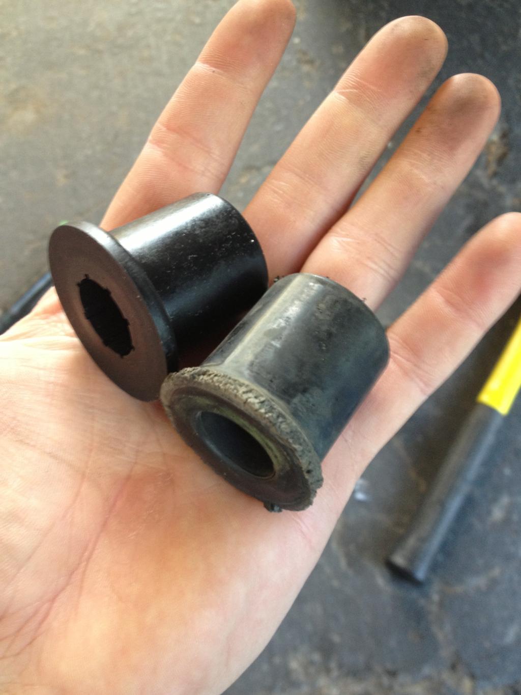

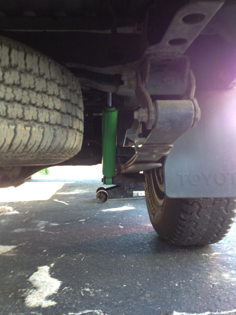

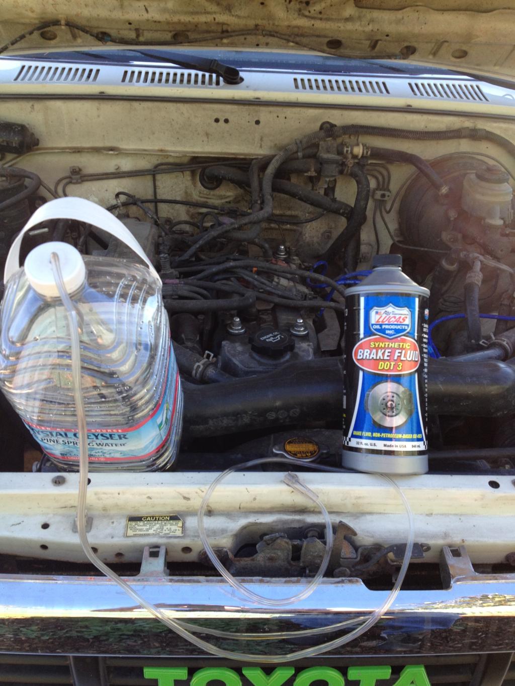

Alright so I have been slacking and haven't been updating like I should be. As far as truck work goes, been pretty basic, oil, air filter, bleed brakes, and energy suspension leaf springs bushing.
Also made my own brake bleeder kit. Nasal cannula tubing is the perfect fit!

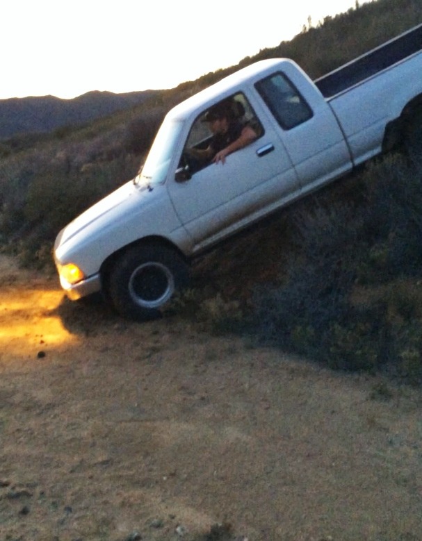

First was Indian flats. Had to improvise to get around the gate.
Made it with no damage or clearance issues.

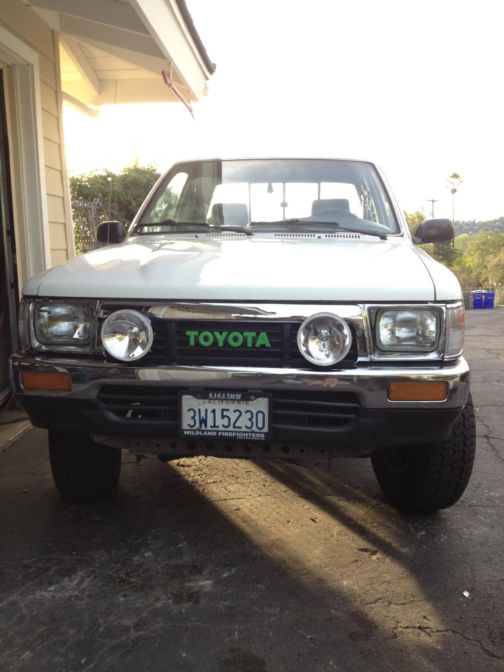

Oh yea. Also scored some piaa lights. Not sure which ones. They are 7" in diameter.
