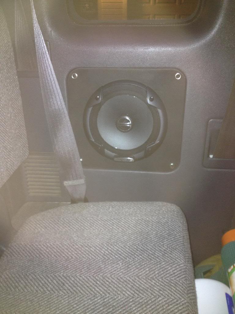

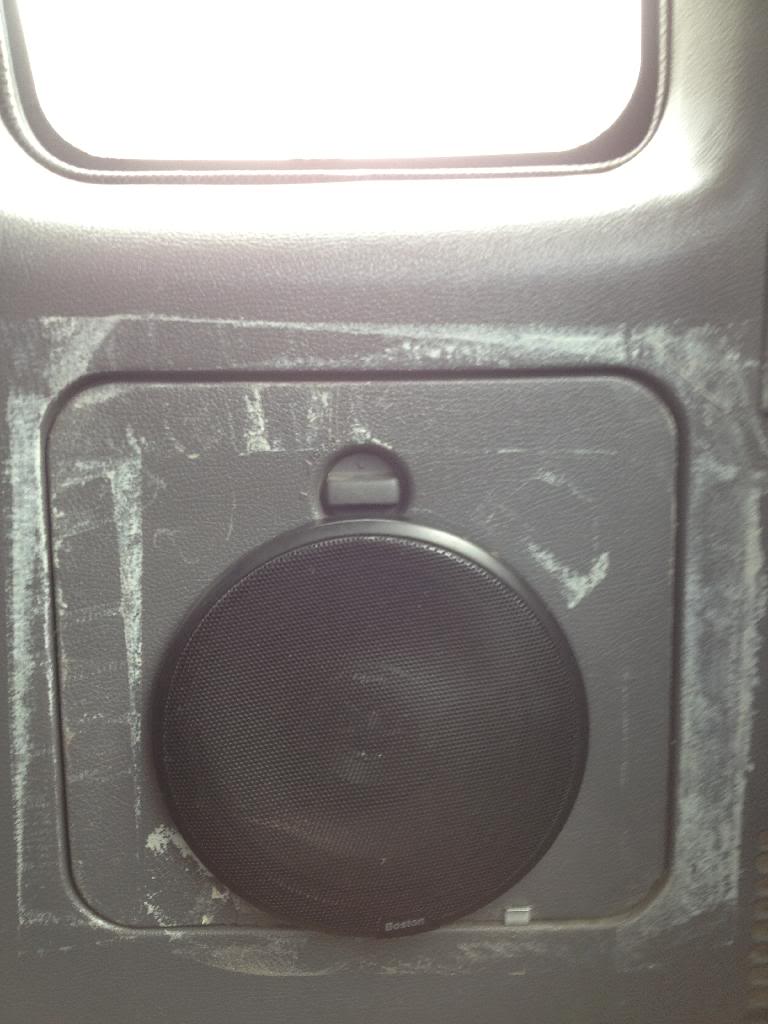

Alpine speakers
Before:
After:

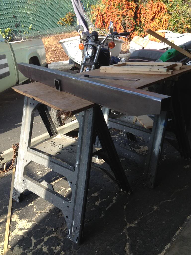

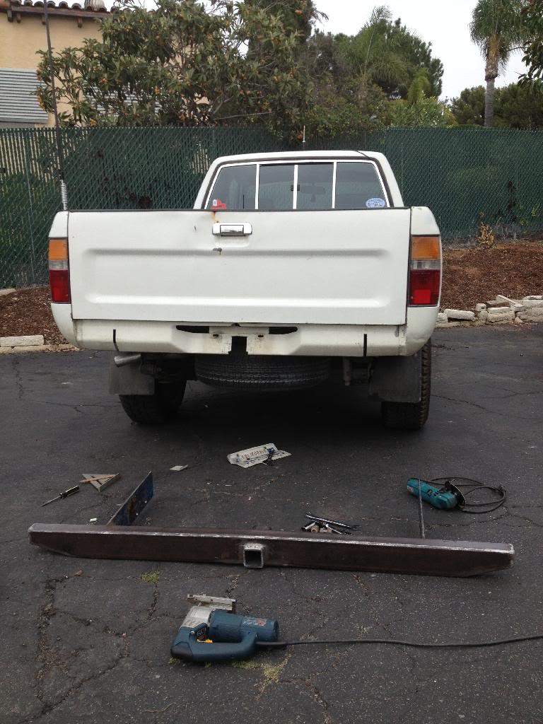

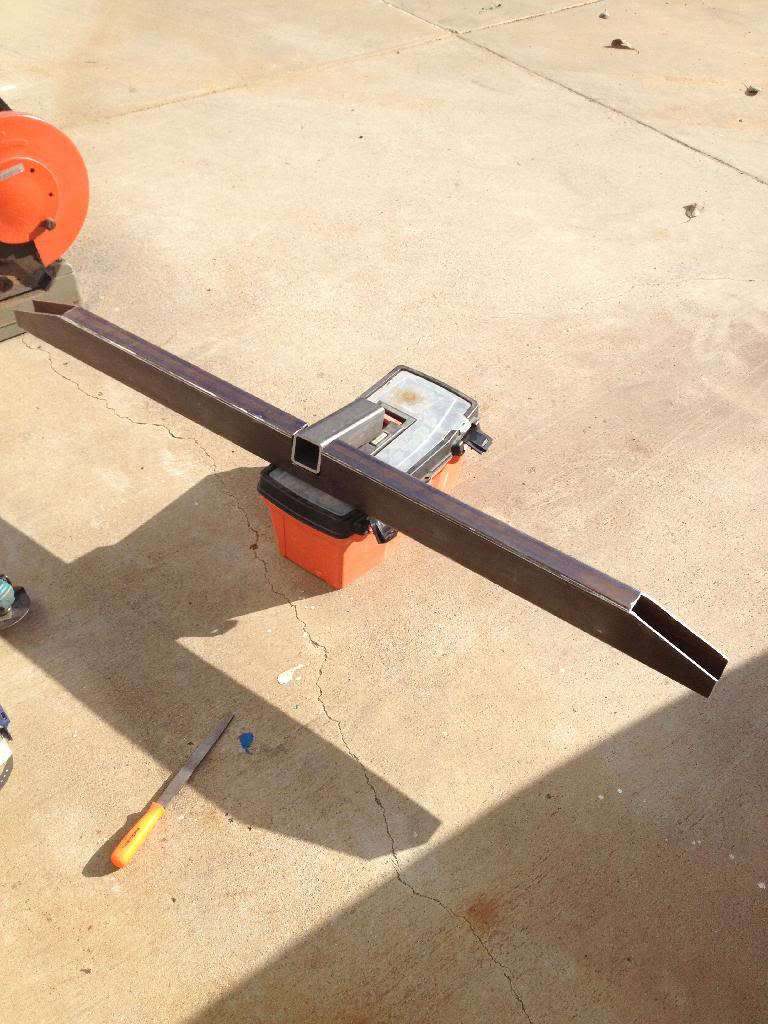

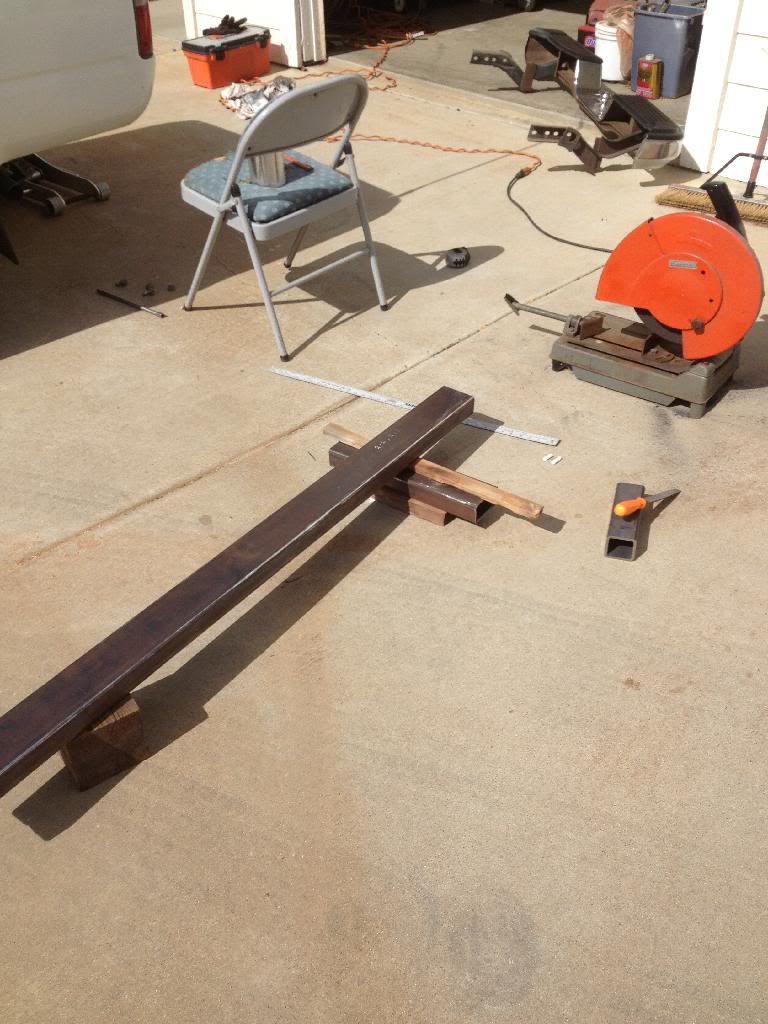

Rear bumper build
Should be a pretty awesome bumper for 35 bucks. Plus I got a ton of practice welding. Been a fun project. Just need to fig out mounts.

Well. I didn't quite get the bumper finished but 98% of the welding is done. Had to cut some notches in the sheet metal below the tailgate. Just need to get it positioned just right and drill the holes.

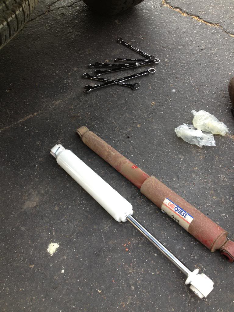

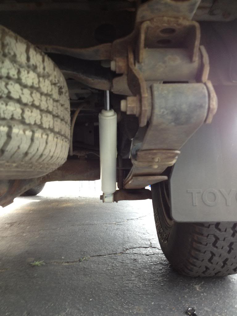

New shocks. Pro comp es3000s. Pretty happy with them so far. Much better than the old blown out ones.

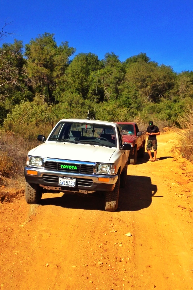

Did a little wheelin out in Julian last Friday.
Just above devils punch bowl.
Low trees kept knocking the mag mount cb antenna off the top.

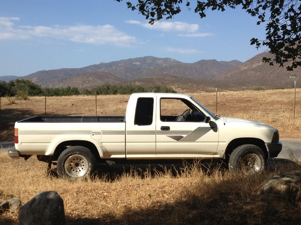

Looking good. We need an updated side shot so we know what it looks like now. Also are you running 31s?
Old Apr 6, 2014 | 10:42 PM
89pickup-pablo's Avatar
Joined: Oct 2013
Posts: 122
From: san luis obispo, Ca
Side shot of truck or bumper? Not sure exactly what it translates into but they are 235/75/R15s.

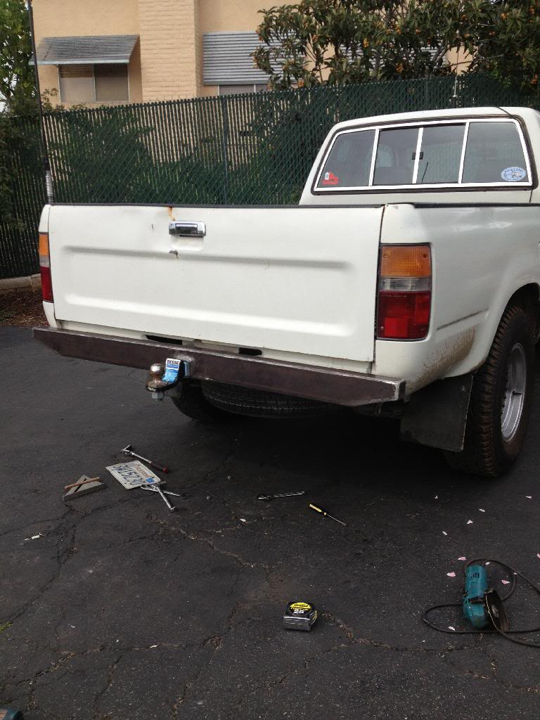

Old Apr 10, 2014 | 10:25 PM
Joined: Oct 2013
Posts: 122

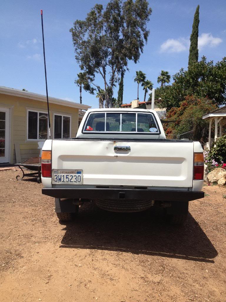

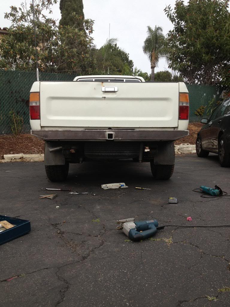

Well finally got the rear bumper installed! Still have some sanding and then primer and paint but really happy with it so far.
Mounts
With hitch in place
Did almost all the work myself and learned a lot! Can't wait to start the front bumper! Or maybe swing out tire carrier instead?

Looks good, how is the offroad ability being a 2wd truck. Also that picture I meant a side shot. Sorry for the confusion

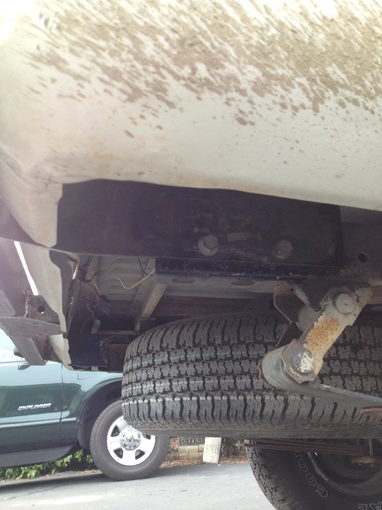

Looks really good! Any side bracing? One hard side tug on that bumper might bend those brackets.

I will try to get that side shot up.
What would you suggest for side bracing? Like where to where would you connect? I will try to take a pic of the whole underneath.
I do plan on drilling a third hole in the middle and slightly higher than the two in the pic that shows the mount.

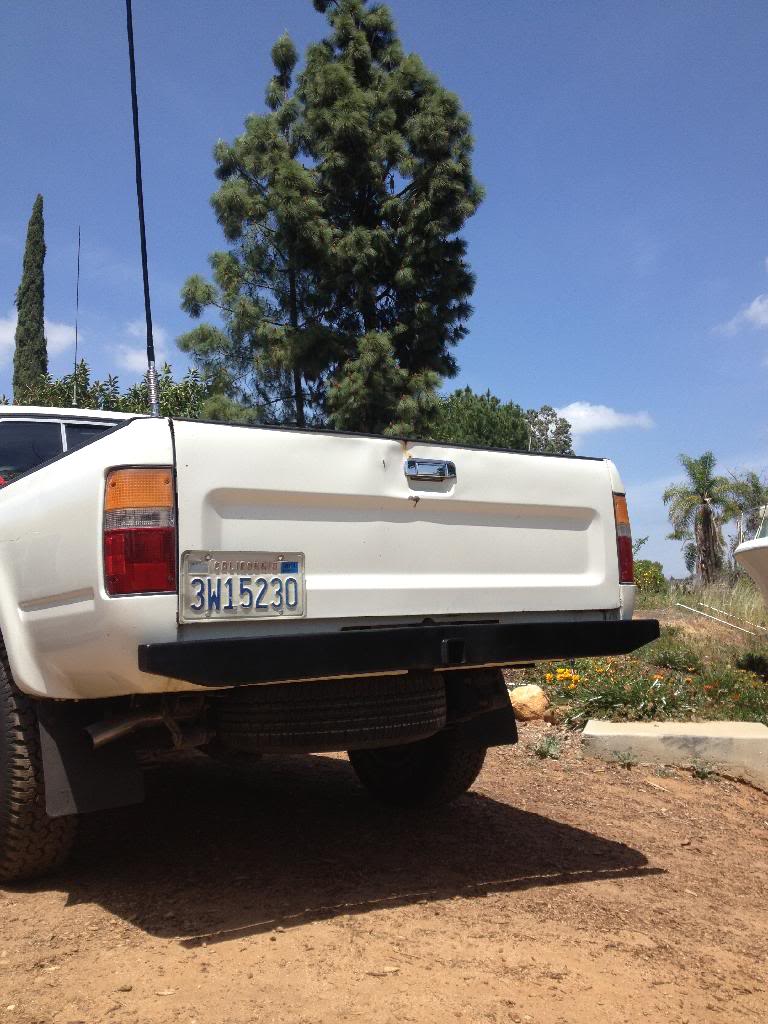

Well finally finished. Paint didn't come out quite as smooth as I would have liked but pretty decent for a rattle can. Went with a satin black rustoleum.
Now what to do with that beat up and rusting tailgate? Suggestions???

Originally Posted by 89pickup-pablo
Mounts
I would add a triangle gusset horizontally in the corner where the frame brackets meet the bumper, perpendicular to the faces of the bracket and the bumper (if that makes any sense. I'm not good at explaining things). As rattlewagon said, if there is any large amount of force applied from the side, the brackets might have a tendency to bend.
Otherwise, as I said in the other thread, the bumper looks great! I like how you trimmed the bed for the brackets to go through. That's how I was planning on doing mine, whenever I get to it...
