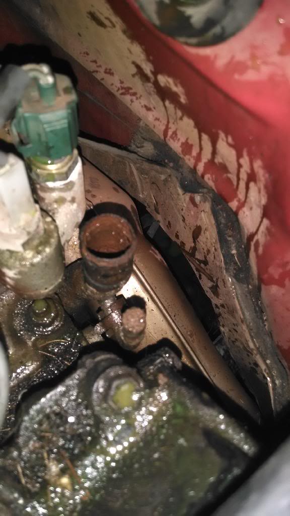

Well I've accomplished all of that. Turns out the feed line for the coolant passage in the throttle body was indeed blocked. The previous owner tried all the wrong ways to fix this problem. They backed the throttle stop all the way out, they turned the idle adjust all the way in, "adjusted" the TPS, and then sold it to me. I pulled all the coolant lines and found my leak, cleared it out and cleaned it up, I eliminated my rear heat for now, I re routed the heater houses so the drivers side feeds right into the driver side heater core inlet "outlet" and vice versa. Essentially running the heater core in reverse. My heat works great! Then re installed the TB, reset the throttle stop, adjusted TPS, and the cold and warm idle. Runs like a champ.
This was the culprit to my high idle and surging.

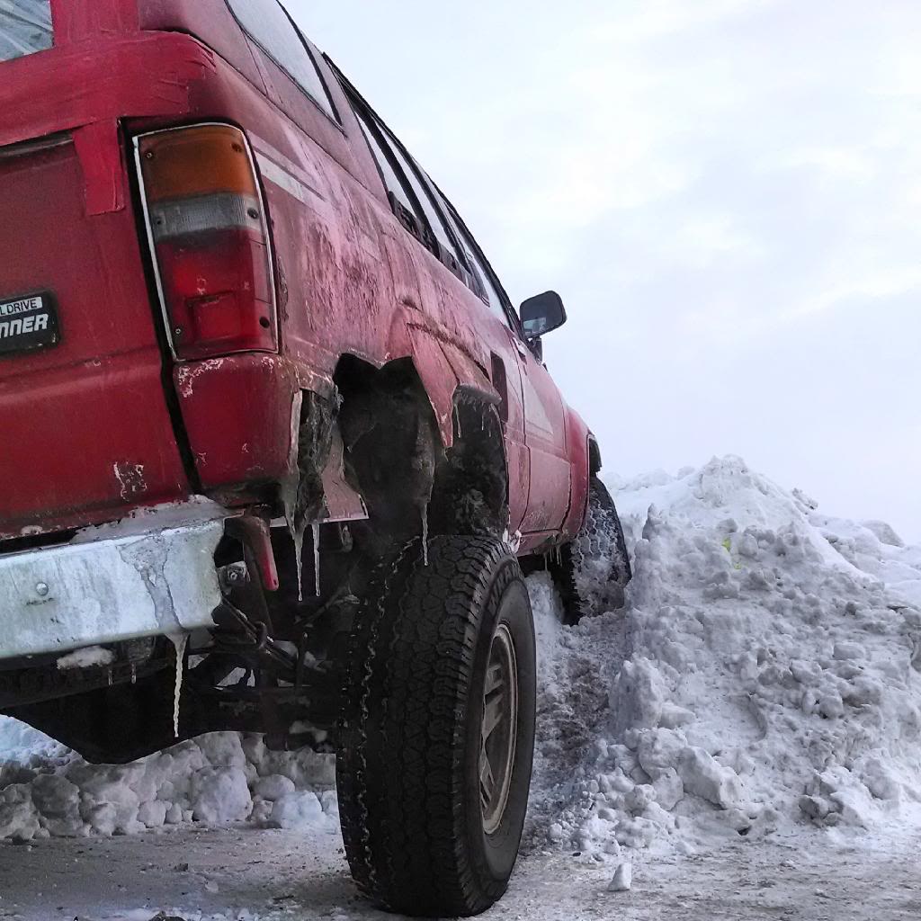

This is the flexy situation that broke my rust spring mount away from the frame.
