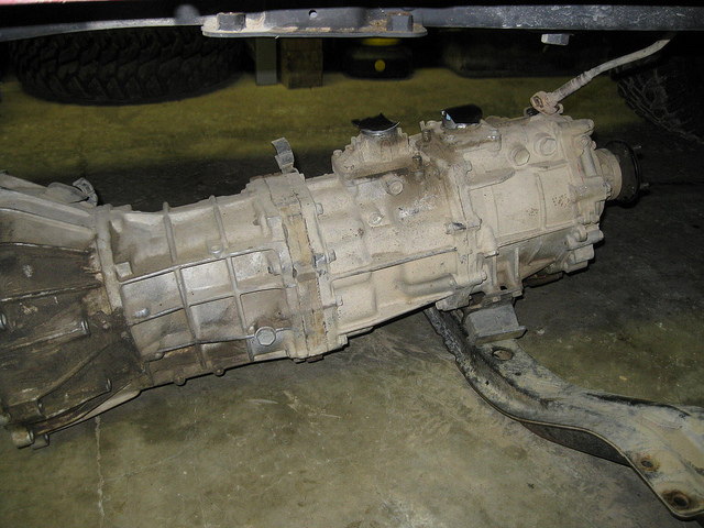

https://www.yotatech.com/attachment....1&d=1355881809
R150 going into auto 88...
