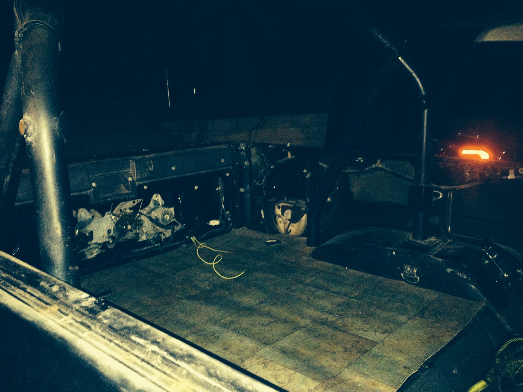

To really start this buildup I wanted to see how deep the rust issue really went. I stripped the seats, carpet, and rear interior panels. It was pretty bad! I found wires going to nothing, wires spliced incorrectly, ton of rust, and like a 1" layer of funk and what appears to be grease mixed with maybe rotted carpet glue covering everything. I even found some housing insulation stuffed in one of the rear quarter panels.
I went to costco and got the economy pack of WD-40, and sprayed generously. I then got a scuz brush and killed like two days of my life.
As any 4runner owner has likely experienced, the rear window relay was shot, so I jumped it down so I could remove the top
