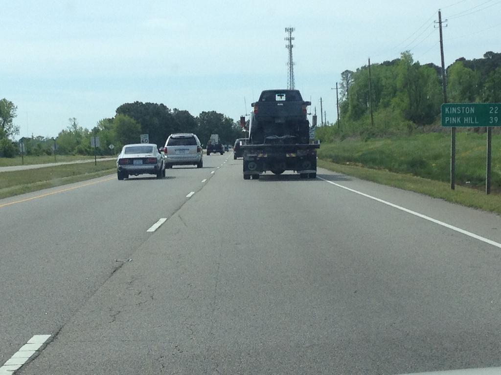

Okay, my first day updates
So, the tow guy shows up and my baby is gettin loaded up.
http://i436.photobucket.com/albums/q...FCD3CF5369.jpg
Then as I was following truck to destination I was thinkin "gee, so now I'm gonna have a truck, what could I have as a second car?" Since Me and my sis share a car. And low and behold...

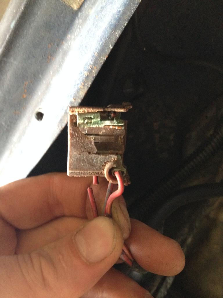

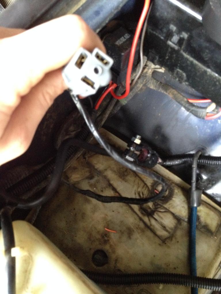

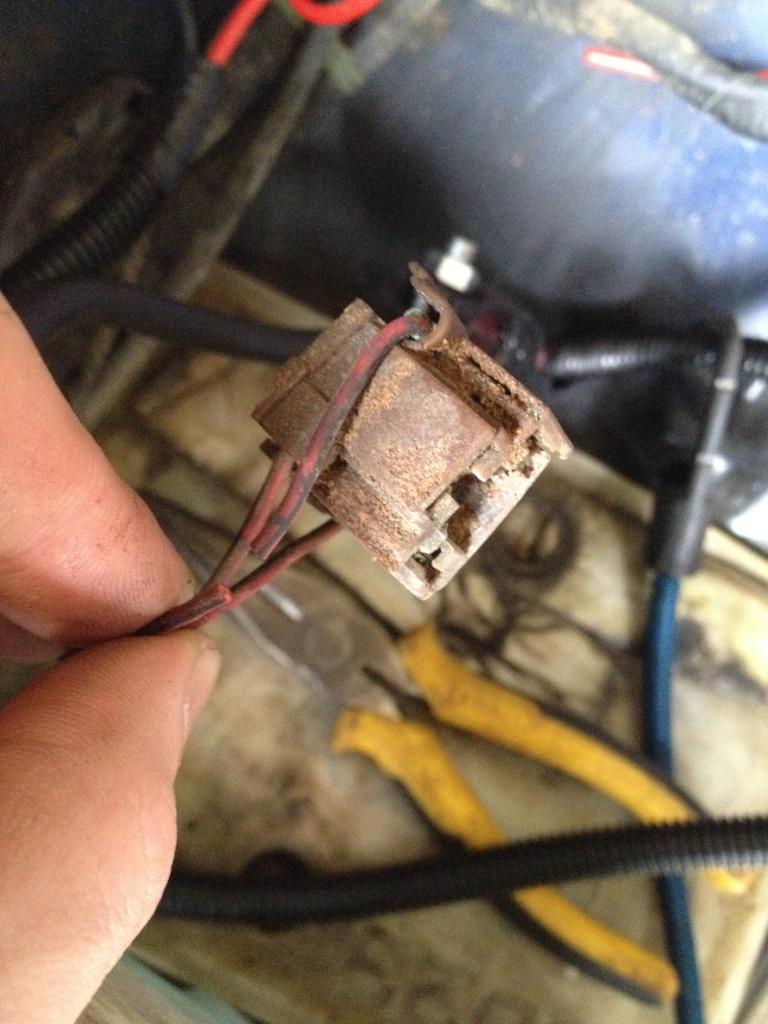

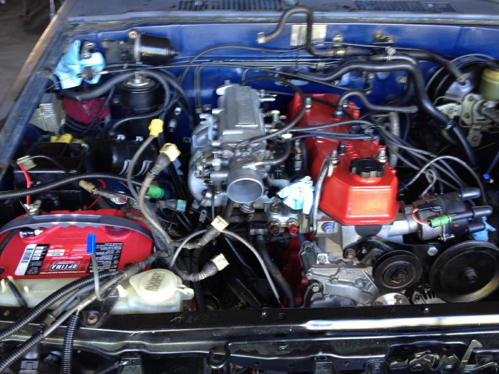

Possibly really good news! Got to the shop today, and figured I would do some wiring, the headlight conectors were in pretty rough shape
PO had some ragged wiring job right by the battery so I went ahead and redid it as well

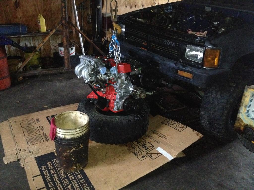

After some light electrical work I got busy taking the engine out
Went to remove the large crank bolt on the crank pulley, and noticed a sharp PING metal noise, as I slapped the breaker bar. Investigated... Front of pulley, that is held on with the 4 smaller bolts, was loose. Tried wiggling it and just wasn't sure if it was the culprit. So I grabbed a belt and gave it a try Video of crank pulley "knock" http://s436.photobucket.com/user/ori...C5576.mp4.html About 90% sure this is it. Contemplating taking a look at the bearings just to be safe. Probly will since I'm already this far.. So I was really very happy with this finding. Hopefully that's all it was! Restore my hurt ego lol. I figure I'll take the crank and stuff and start building a secondary engine, or just have spare parts.

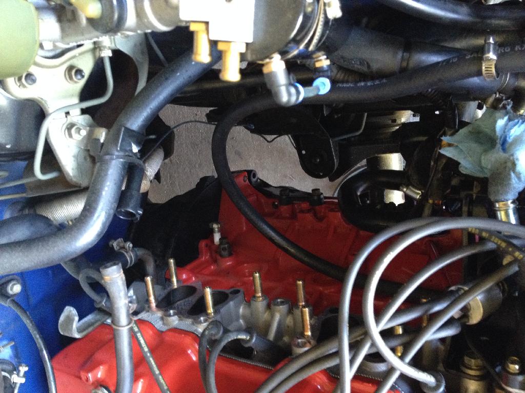

the mystery knock was indeed the crank pulley. took a look at the bearings, 1st connecting rod bearing was looking like it had been oil starved a bit on the initial startup. so i replaced it with some spare bearings.
Engine is back in and running, been working out driveability issues. the gas is >1 year old, put some seafoam in, seems to help.. only 7/8s full now... lol it was full when i first began this whole fiasco. looking forward to seein it run with some fresh gas in her.
big step was putting exhaust on it, gave it alot of its torque back and probly alot less annoying than an open piped four banger trying to turn 33's to the locals. haha. only drivin it a couple times down the street, at 30 miles im gonna change the oil and take it on a much longer test cruise, at 100-150 im going to change the oil filter only. switching to wix 51348 since its got the check valve and is smaller, until i get the oil cooler set up properly ( i have some qd fittings to install, new filters, and still need to do some wiring for the fan relay)
truck is running good, had to adjust the afm a bit. just did the valve adjustment and retorqued the head studs to 95lb-ft. adjusted to .006 IN and .010 EX, i know this is really tight, those were the closest my cheap feeler gauge could get. engine runs SUPER quiet, and smooth.... maybe too quiet. lol i took a video of it, will upload as soon as YT mobile works again. next is timing, to really dial it in, ordered timing light.
when i drive the truck home, its about a 30 mile drive, im gonna get it new tires, to appease the car gods of course. I want to go with goodyear duratracs since its a daily driver and from what i read they are great all condition tires. cant decide between 31x10.5x15 or 33x12.5x15 tho.. leaning towards the 31's since the truck is in the beginning of its build and by the time i wear the 31s out it should be more capable offroad, while improving mpg and power.
its finally looking like its coming together tho, and im too excited. ready for the beach! might be its first long trip!
