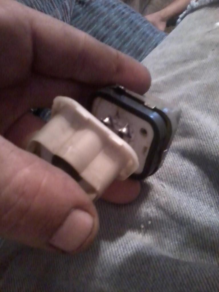

I am not sure of the neutral safety switch but here is what I meant to say about taking the cover off of the Starter Relay and cleaning the contacts.
Getting cover off, I used wire cutters to bend the tabs up on the cover. The rubber seal really makes it tough to get off. Luckily the wires are soldered on real well, I used a screw driver to work around the edges of the seal to help free the cover.
Here is the contacts that need cleaned.
