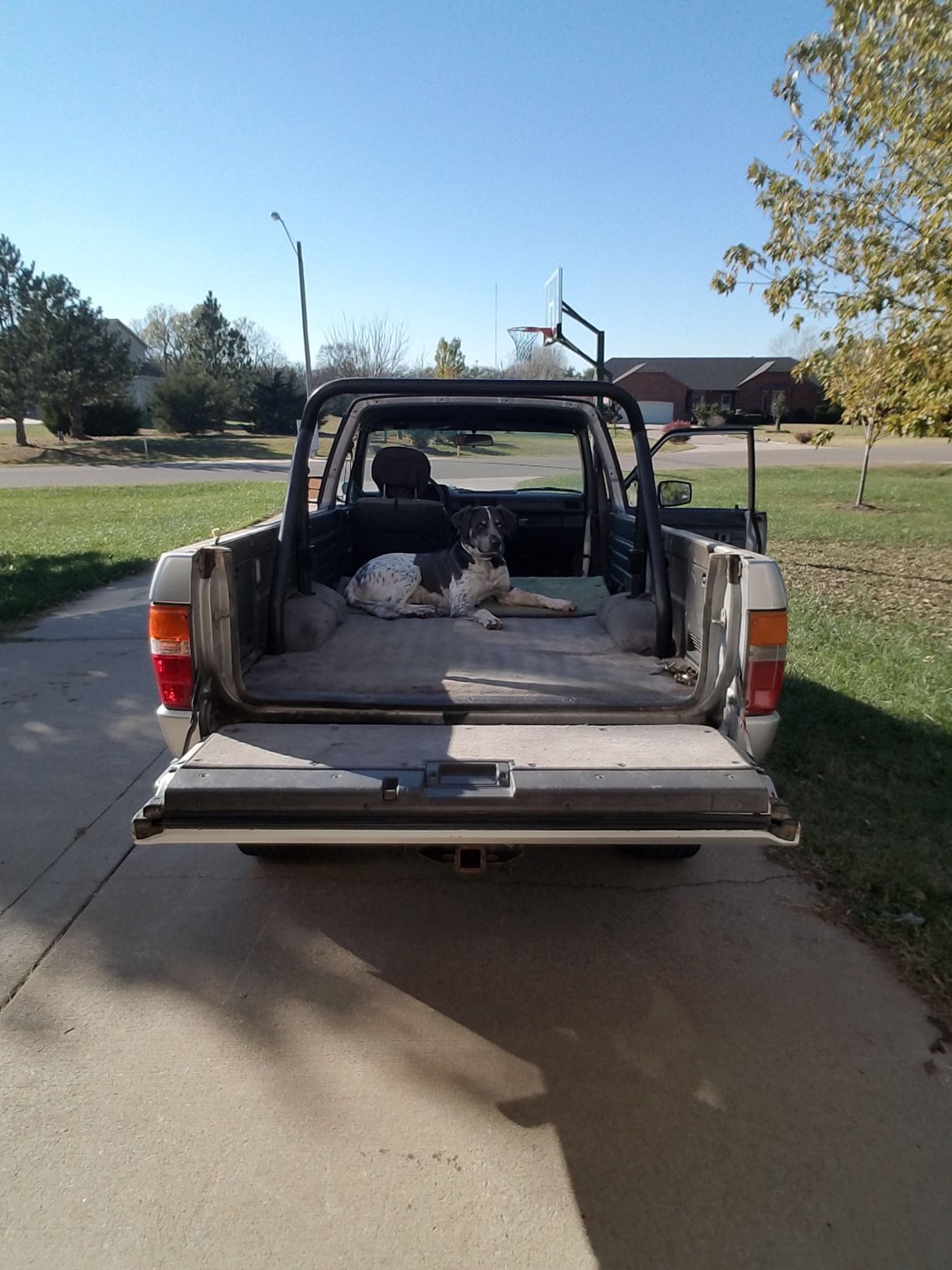

Hey guys! Figured id update. Got the opportunity to replace a failed clutch slave cylinder in a parking lot this last weekend! And also i took the top off for the first time today! First time its been off in over 20 years!

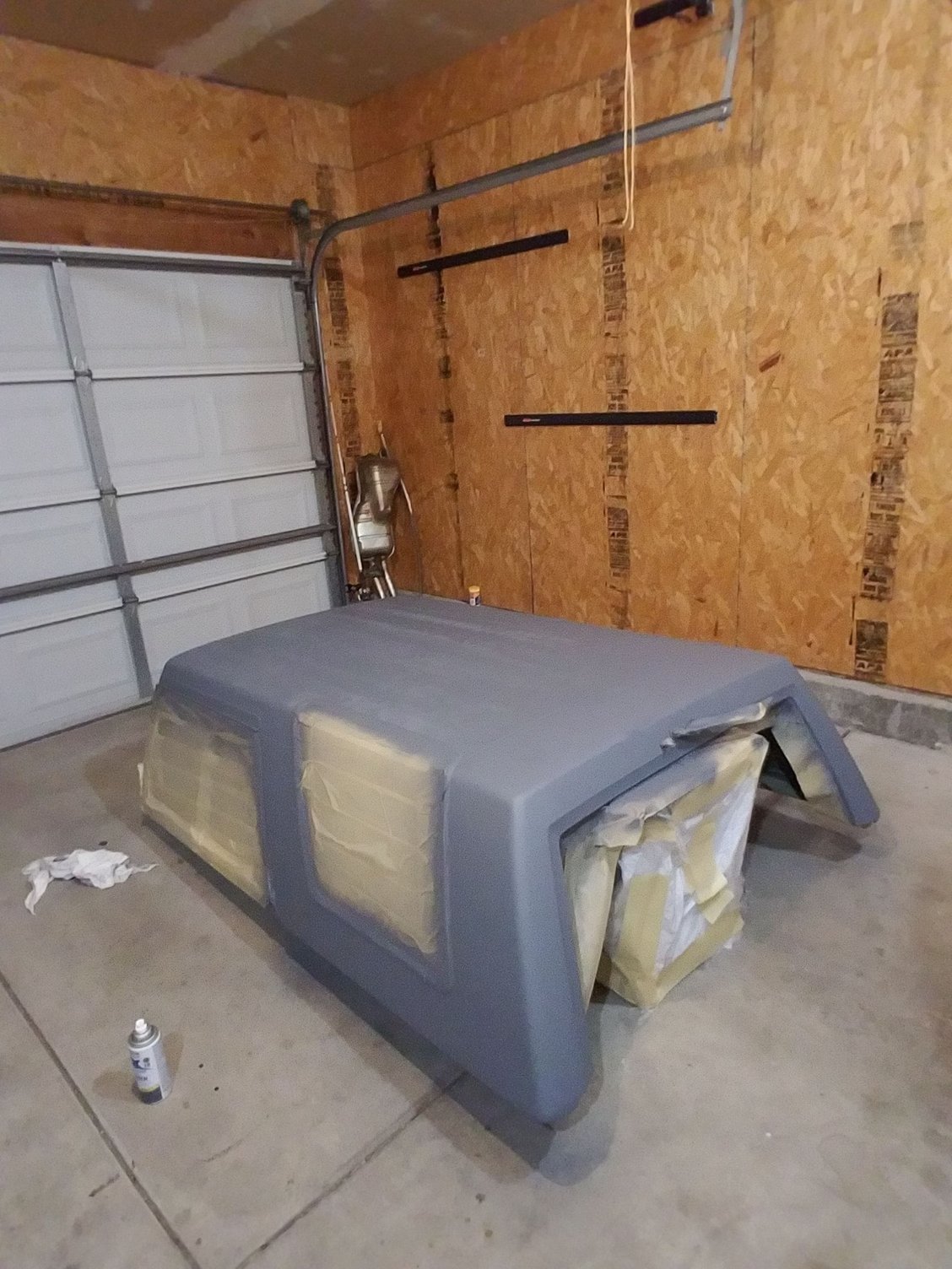

Decided to work on the runner today. Heres how far I got
