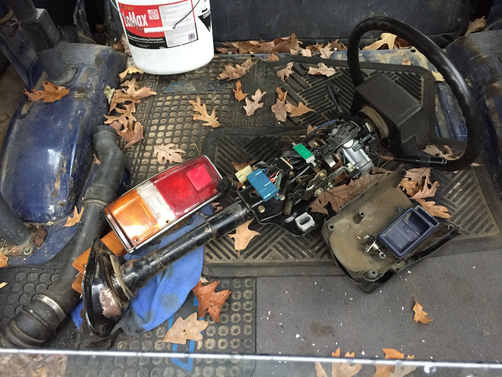

Scored some parts this weekend to keep myself busy for a while. Skirt, fender, door, grill, front bumper, and skid plate.
Air tube, steering column with tilt and key, interior handle trim, steering wheel trim, cold start injector, and rear passenger lens.
