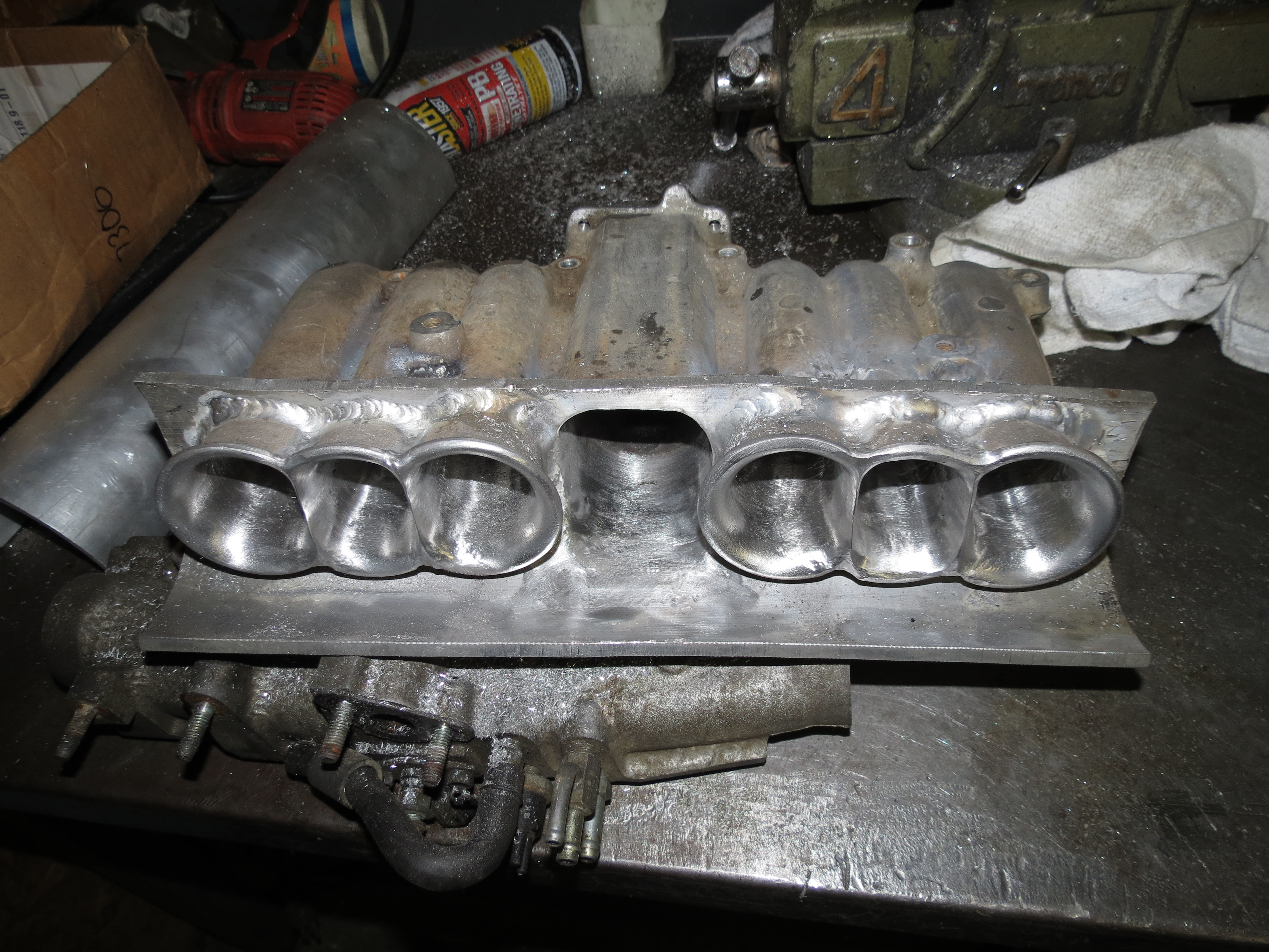

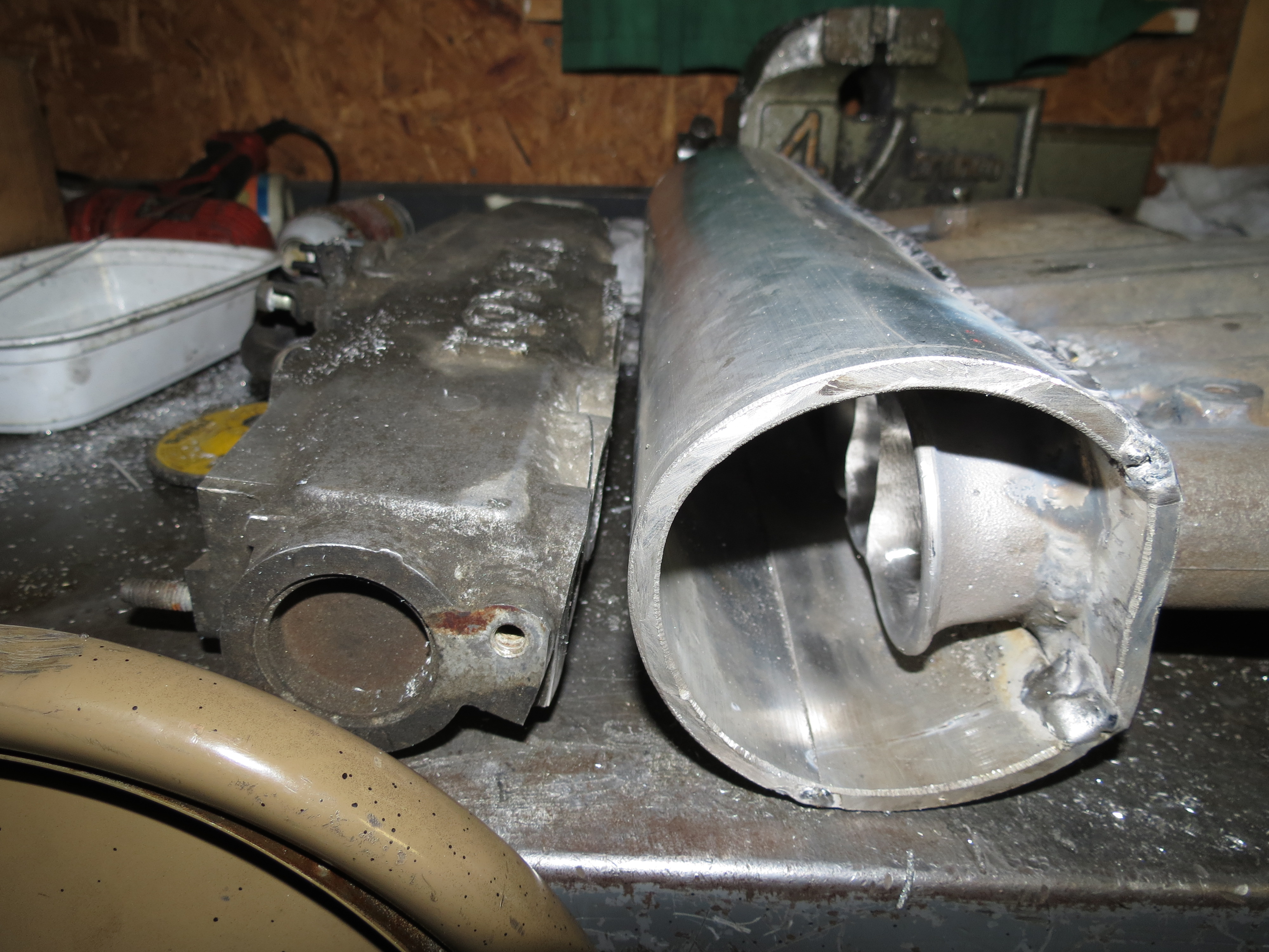

update. slowly getting stuff done.
been working on the intake manifold. not the prettiest thing but Im hoping the upgrade plenum tank will help.
