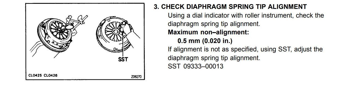

I think I'm pretty confident about everything I need to do, but I have a question about "Checking the Diaphragm Spring Tip Alignement" Page CL-19 in the service manual instructs that after re-installing the clutch cover I should:
3. CHECK DIAPHRAGM SPRING TIP ALIGNMENT
Using a dial indicator with roller instrument, check the diaphragm spring tip alignment.
Maximum non−alignment 0.5 mm (0.020 in.)
If alignment is not as specified, using SST, adjust the diaphragm spring tip alignment.
SST 09333−00013
I'm totally lost as to what the diaphragm spring tip is, how I'm going to check it and what the SST is that I will use to adjust it. I'm a handy, but not that skilled mechanic - is there some advice people have for me.

This adjustment should not be necessary when using a new pressure plate.
An Aisin clutch kit would be a good choice.

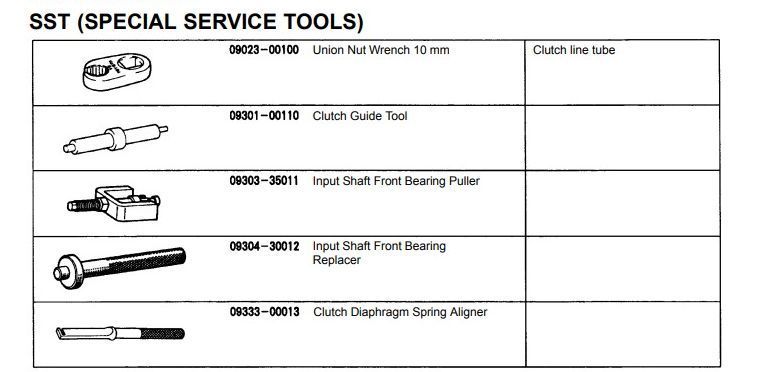

My FSM had pictures, so here the two that apply are for you. Hope they help a little!
Pat☺

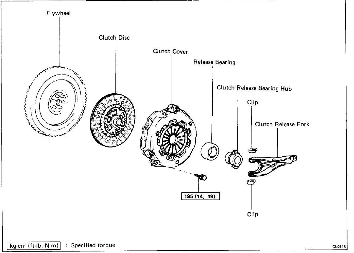

Should I be able to get to the flywheel and remove it once the clutch plate is removed? I am struggling to find that in the service manual, but it seems like I should be able to get to it once the clutch is out.

Yes, when the clutch is removed, the bolts that fix the flywheel to the crankshaft will be revealed.

You may need a good impact driver to get the flywheel off. Not only are those bolts on tight, the engine will want to turn as well.
Again, FSM picture, if it helps:
Once you get it off, run it to a good machine shop. They'll resurface the flywheel rapidly, and for a reasonable price.
Good luck!
Pat☺
