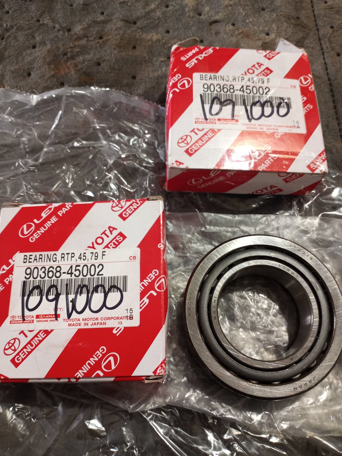

Friday I pressure washed the differential housing and drove in the pinion races. I installed the pinion with the stock shim under the bearing but no spacer yet. Then I drove on the new TIMKEN bearings on the carrier and that is when things started falling apart again. The bearing included with the Yukon setup kit are not stock Nachi bearings, they are a different Timken bearing. The difference in width is about .5mm. When I was shimming the carrier in the housing to get a pattern, I couldn't get a preload, I still had about .007" of gap between the shim and the housing. That's when I measured the bearings in their races and found the difference.
Stock Nachi:
Setup kit Timken:
At this point I shoved in some shims just to set a good backlash and checked the pattern. The pinion is a little deep. I'll remove the pinion shim, install a thinner one, and go at it again another day when I can get more accurate measurements. I washed my hands and went home to eat some homemade pizza the wife was making and drink a cold Irish Red Ale. Then I started researching. I found some dimensions for both bearings and they concurred with my measurements; the Timken bearings are too narrow to fill the gap. Then on one of ZUK's pages on gearinstalls.com I found this little snippet:
So today I sent him a text message to ask about buying some shims and he said I'd be better off with new Nachi bearings as the shims tend to mushroom over time. Thanks for the help, @ZUK .
NAPA couldn't find the 17831S cup, only the 17831 so I did some googling and decided to order the stock bearings (Toyota's number) through LCE Performance. So now I wait.
Why is it that these setup kits/builder kits are sent with parts that don't fit? I would have rather spent the extra money up front for bearings that fit rather than spending less on the setup kit and then having to spend $100+ on bearings TWICE.
