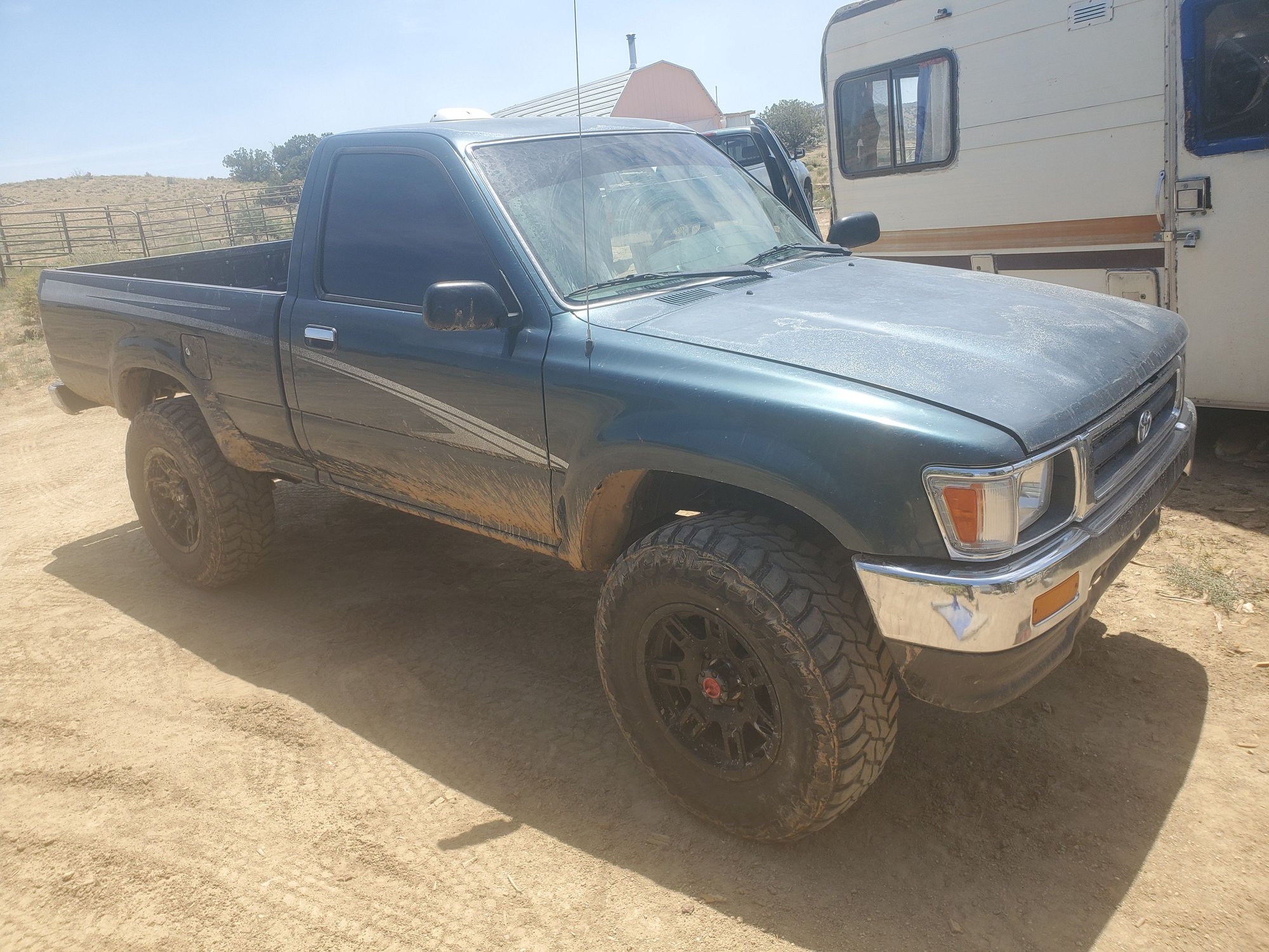

Im pretty sure these are 31s. Previous owner had them on the truck. I pulled them bc the sidewalls were all cracked. Im assuming theyd rub at full lock. Stock suspension.
ive got narrow rims, so Im rocking a 30x9.5x15 tire right now. Looks wise, its eh. But I got a good price on a set of BFGs and after commuting in hills with a tired 22re for half a year, I liked where the gears and rpms sat with this combo.

So I just checked those tires in the 1st photo is 265,75,16s so its around 31.5in.
No body lift to my knowledge. I never checked but the body and frame seem like the right height. Trucks getting a new motor now so I cant make 100% sure.
Were just outside of Santa Fe, so youre pretty spot on with your eye for desert terrain. Thinking of moving to Albuquerque next year so my wife can go back to school.

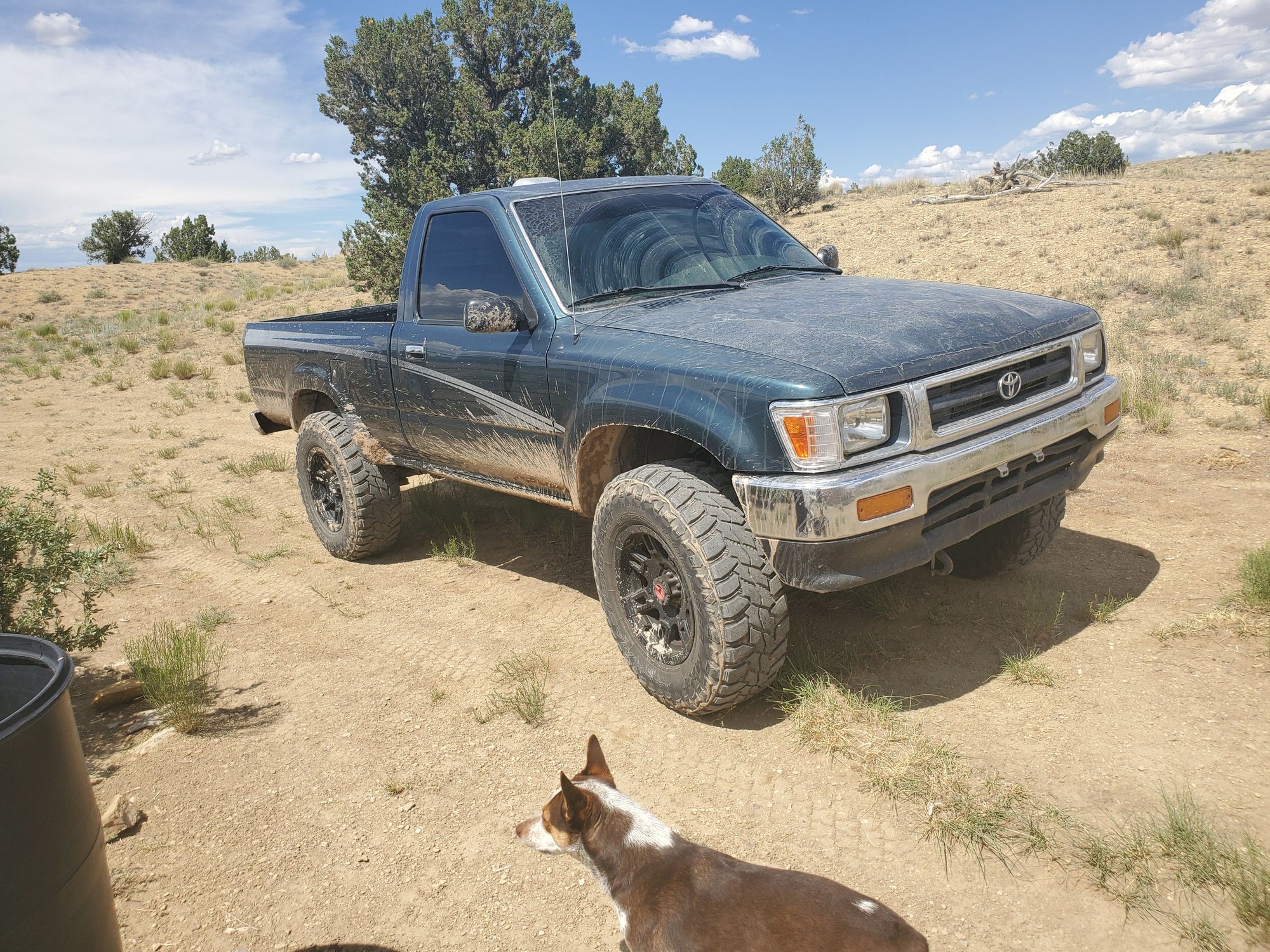

This is the only other photo I have of the truck with the old tires

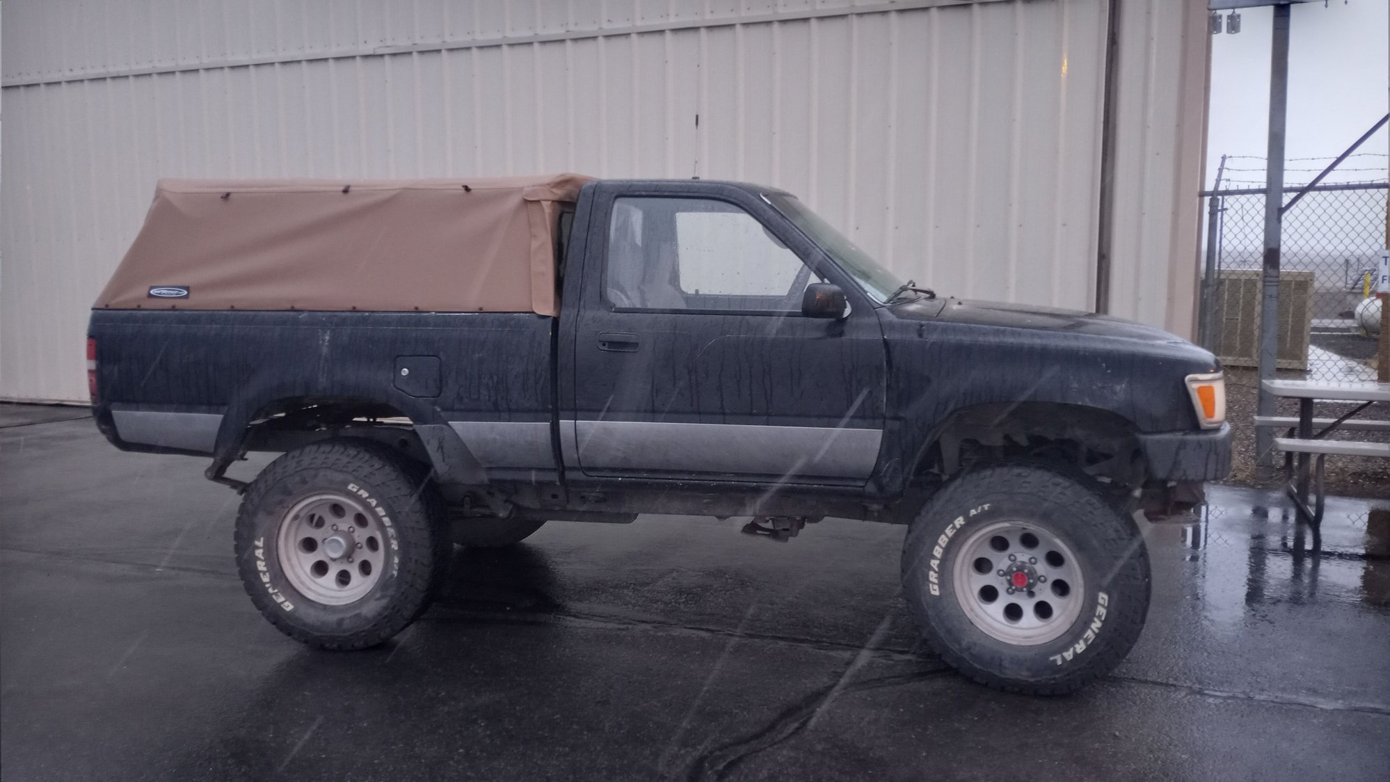

I appreciate the photos, @swampedout . I decided to stick with 33" tires since I have a 3" body lift. I think it would look silly on 31's.
So, quick update with a photo.
Ordered a used front diff with stock gearing (4.10:1). Disassembled, cleaned, replaced oil seals, reassembled and reinstalled.
(I had thrown the old carrier housing out when I swapped some parts to the new one but when I installed the new-to-me diff, it was missing the right side mount! I dug it out of the dumpster and was good to go.)
New gear oil in both diffs, transmission, and transfer case.
New right CV axle.
New right side spindle bushings and inner spindle/CV seal.
Packed right side wheel bearings.
Tightened left side wheel bearings.
New steering idler arm.
New tie rod end on left side (will do the right side someday, already bought it.)
Installed POWER STEERING!!! WOOO!!!! This makes a world of difference for the truck.
Upped right side torsion bar. I was leaning right.
New radiator. (Bottom fitting was cracked)
Fixed left front blinker.
New parking brake cable.
Adjusted rear brakes since the parking brake didn't work for many many years.
Removed parking brake cable (cheap junk broke first day.)
New rubber between steering box U-joint and lower steering shaft.
New windshield.
New General Grabber A/TX 185/75R16 tires on allow rims I got from a co-worker for $50. I thought they were 15" but the 16" doesn't bother me at all.
I am really liking the look of this truck now.
I have a Toyota parking brake cable and steering shaft -> firewall dust seal waiting for me in town.
Driveshaft bolt, fan switch, CV end circlip and spacer, rubber for fuel door stops, and washer reservoir pump are all on order.
I have four ball joints, two wheel studs, and one tie-rod end, and the right side spindle bushings on hand and ready to install. I'm commuting in the truck right now and my enthusiasm has waned a little this week as I spend several whole days working on this thing.
I'm pleased with how it is running and driving. The 4.10:1 gearing with 33" tires is a little high but I am not changing it yet. If it works well offroad, I will leave it. If not, I'll change to 4.56:1.
Things still to do/order:
Rear bumper
Change front bumper to something lighter
Front fenders
Fix dents in bed
Interior carpet
Radio
Fix hole in driver's side seat
Spartan locker(s)
Shocks
Need A/C compressor

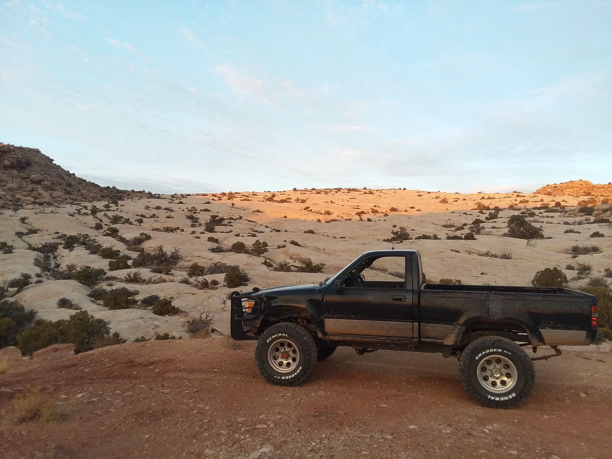

Been meaning to do an update here but haven't been motivated to sit down and write. But here we go!
After I got the truck back from an alignment it drove straight and nice but... my left tire looked to have excessive positive camber. I didn't like the look of it but kept driving it a few more days. One day after pulling in to work I got out and looked at my tire. There was still some dirt remaining on the inside corner of the tread. The tire was definitely over cambered in. Also, later on while wheeling on Fins and Things here in Moab, I started getting some creaking from the right side suspension. The lower a-arm had started moving. The nut wasn't tightened enough. I don't particularly like other people doing maintenance on my things since I have more attention to detail than a shop. I read through the alignment process on this site and did an alignment one day after work. Now it is properly cambered, not overly castered, and sufficiently toed. I will be doing my own alignments on this truck from now on. Lastly, the shop that installed my tires (same shop that did the alignment) put 40 psi in my tires. That's why it was so stinking rough on the trail!
While on Fins and Things I realized a few upgrades I still needed.
1. Bambi slayer needs removed. It sticks out way too far and kills my approach angle.
2. I need lockers.
3. I need a slower crawl gear (4 low)
4. I would really like some armor
So... I lopped off the Bambi slayer last week. The truck looks better without it and my headlights are a little higher (I carry a screwdriver to re-aim headlights; I hate headlights in my eyes.). But now I really need to build my own front and rear bumpers. I plan to use square or rectangular tubing and keeping them high and tight. I'll also build some rock sliders.
The locker dilema has solved itself. While heading down the road a couple miles to find more dirt and explore some old homesteading cabins I heard about, I felt and heard low frequency hum. I got out once I turned off the highway and moved my rear driveshaft. It has way too much backlash and I can see the pinion move in and out just a little when I rotate it. So on order tomorrow are 4.88:1 front and rear rings and pinions. Since I'm going that deep, I'm also putting a Spartan up front and an ARB in back. There went all my savings!! I wanted to regear already since I live at 6000 feet in mountainous terrain with a 4-cylinder and 33" tires. 4.88:1 will put me only a couple percent lower gearing than stock. 5th gear with 4.88 gearing is within 30 rpm of 4th gear and 4.10 gearing. I've been driving around in 4th gear to check mileage, RPM, and torque. It feels right.
At the wife's request, I purchased a tan Softopper. Looking forward to that showing up.
The armor is not in the works yet... it's on the short list though.
The crawl speed is furthest down the list. I can make due with what I have right now. I am thinking of the 4.7:1 low range gearing to fix that issue. Dual cases is cool but I feel like it is excessive. If I find the 4.7 gearing is too low, I can still get dual cases and I'm not out anything as then I can have 2.3 and 4.7 gearing in two separate cases later.
Also, I drove part of the 3D Safari route then decided to risk Mashed Potatoes one day after work. Wasn't bad at all and lots of fun. I'm really enjoying this truck.
Gone fishing for HF contacts.
Poor approach angle on Fins and Things.
Homestead finding.
