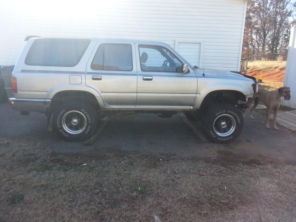

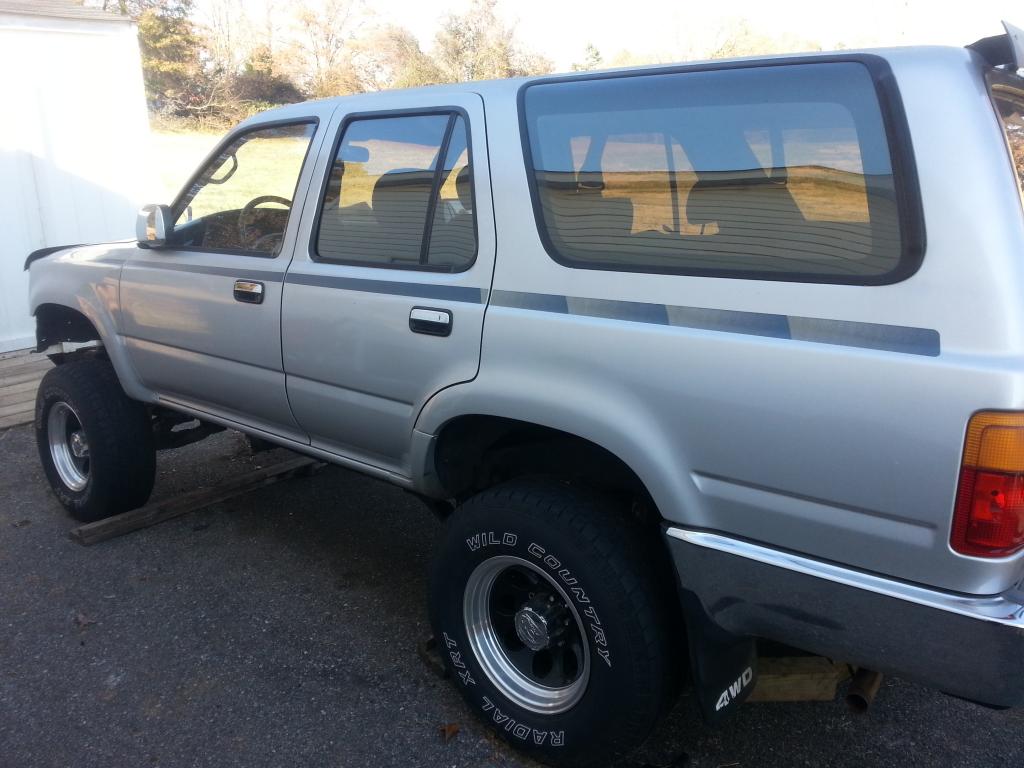

Got the 4Crawler 2 inch body lift installed today. It took longer than it should have but it was cold and I was moving slow. At least its done though.

What's the story on those rims? Pretty slick

http://www.jegs.com/i/Detroit+Wheels...FXES7Aodf1kAFg
Yeah I liked them too. They were on it when I bought it with 31s. Paid 1000 for the whole rig. Came with a blown headgasket too so I've never driven it. Just hope they hold up to trail use. Jegs sells them.
